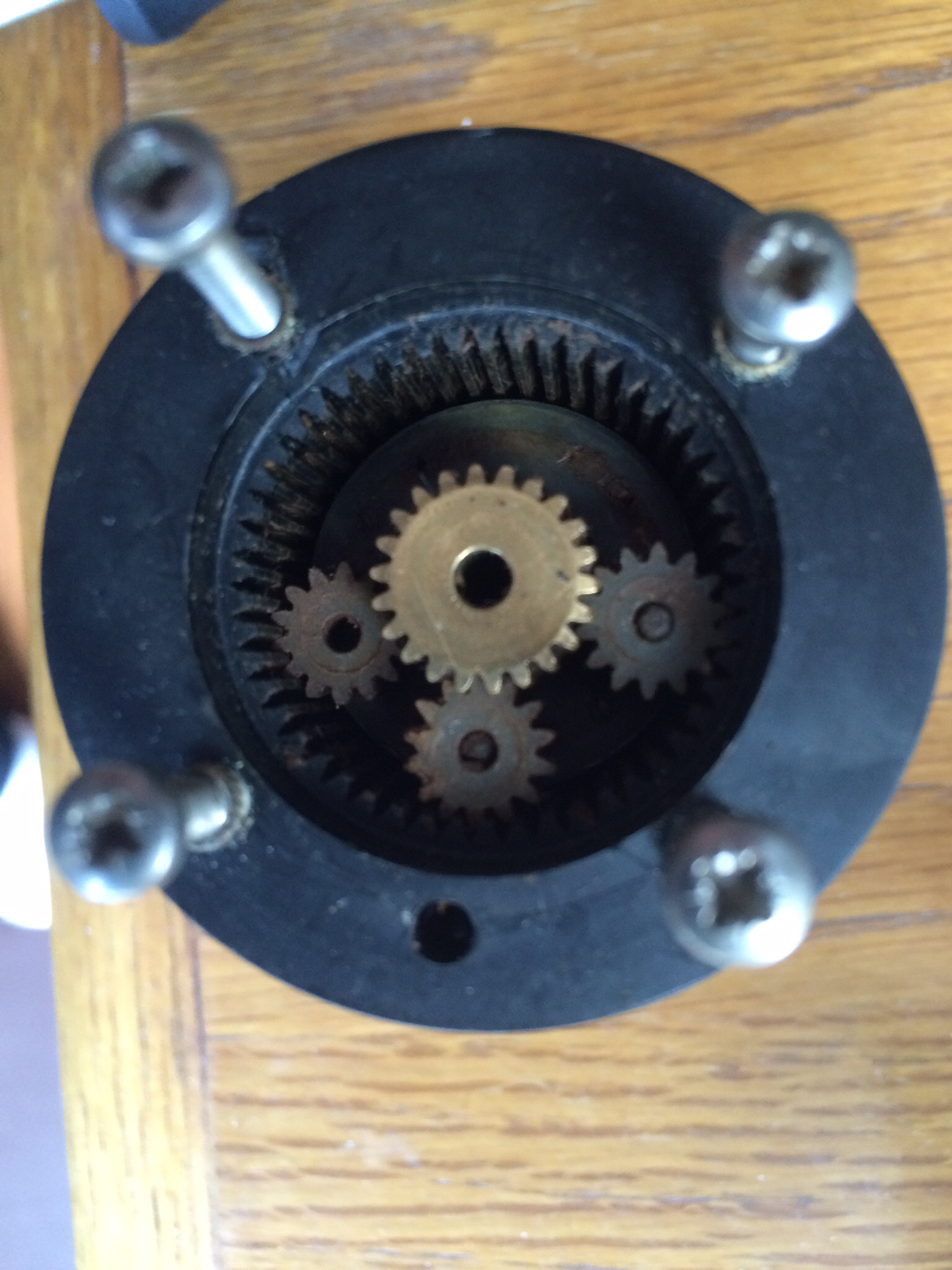

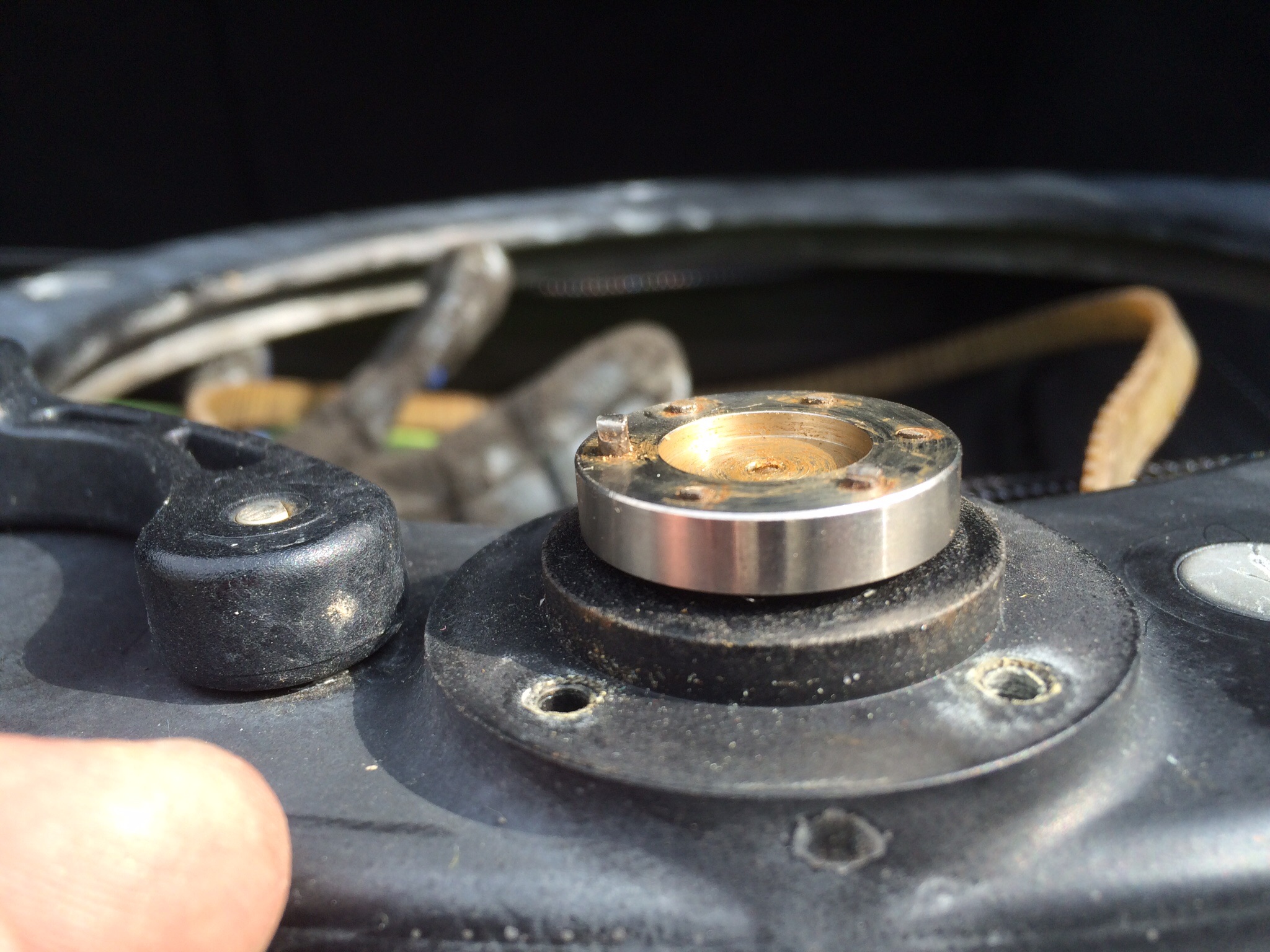

I finally got around to checking out the autopilot for my new to me (last Spring) Cape Dory 30B. I had checked it out while bringing her down from NYC to the Chesapeake and thought I needed a motor. Tearing it down I discovered bad planet gears in the gearbox as well as sheared pins (six) on the driveshaft.
Anybody know of a gearbox or a source of planet gears? I've heard that folks have had new gears made of brass that would certainly make the gearbox more robust. Recommendation for lubication? Old grease had become solid which I believe resulted in the failure. Recommend those that have an Auto Helm look at lubication as preventative maintenance.
Anyone ever have to replace pins on driveshaft? Do they unscrew from back? Suggestions for removing drift pin?

Sheared pins on drive shaft/carrier assembly
Bad Planet Gears
Bad Planet Gears
