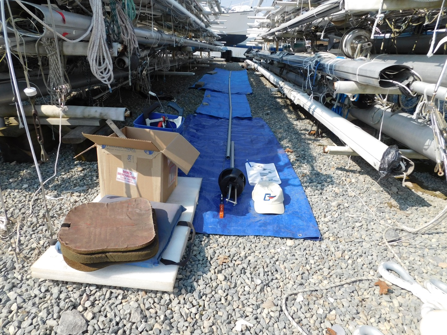

It was unseasonably warm today so I removed my staysail stay from my mast and tackled the assembly and installation. My mast is stored in a rack for the winter so removing the stay was a bit of a challenge. Two other masts were on the same shelf and, of course, mine was the furthest back. It was also over 6 feet high so I got lots of exercise climbing up and down my ladder. I set up my workstation on three plastic tarps on the ground which actually provided a decent surface upon which to work.
The actual assembly took three hours. I was being very cautious and followed the assembly instruction to a "T". I discovered a couple glaring discrepancies in the instructions and I'll be sending Harken an advisory email. There's no excuse for a company which prides itself on quality and product integrity to have instructions which are not similarly world class.

- Just getting started. New stay stretched out.

- Components all laid out.

- Done! Ready to attach to the mast.
