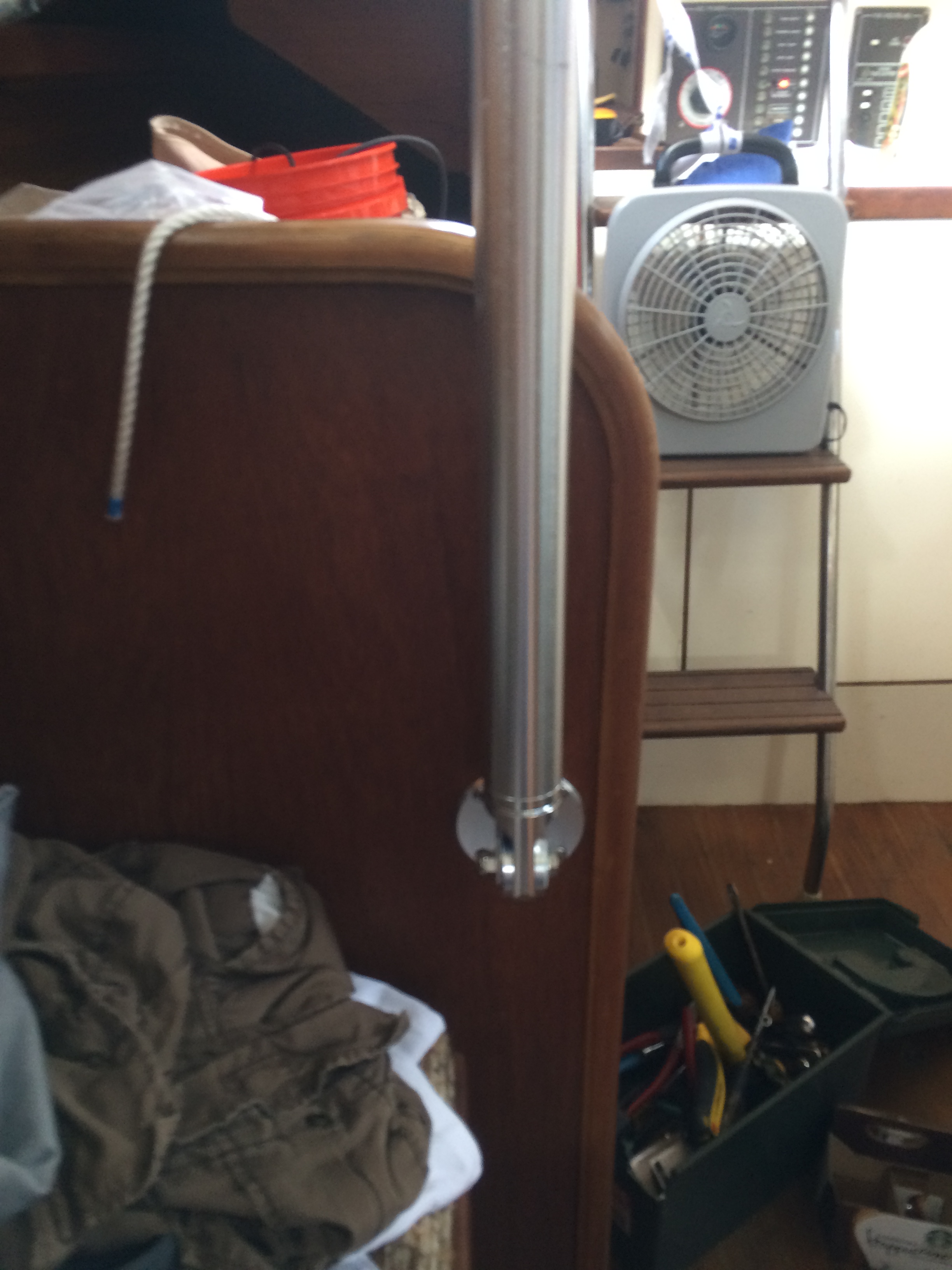

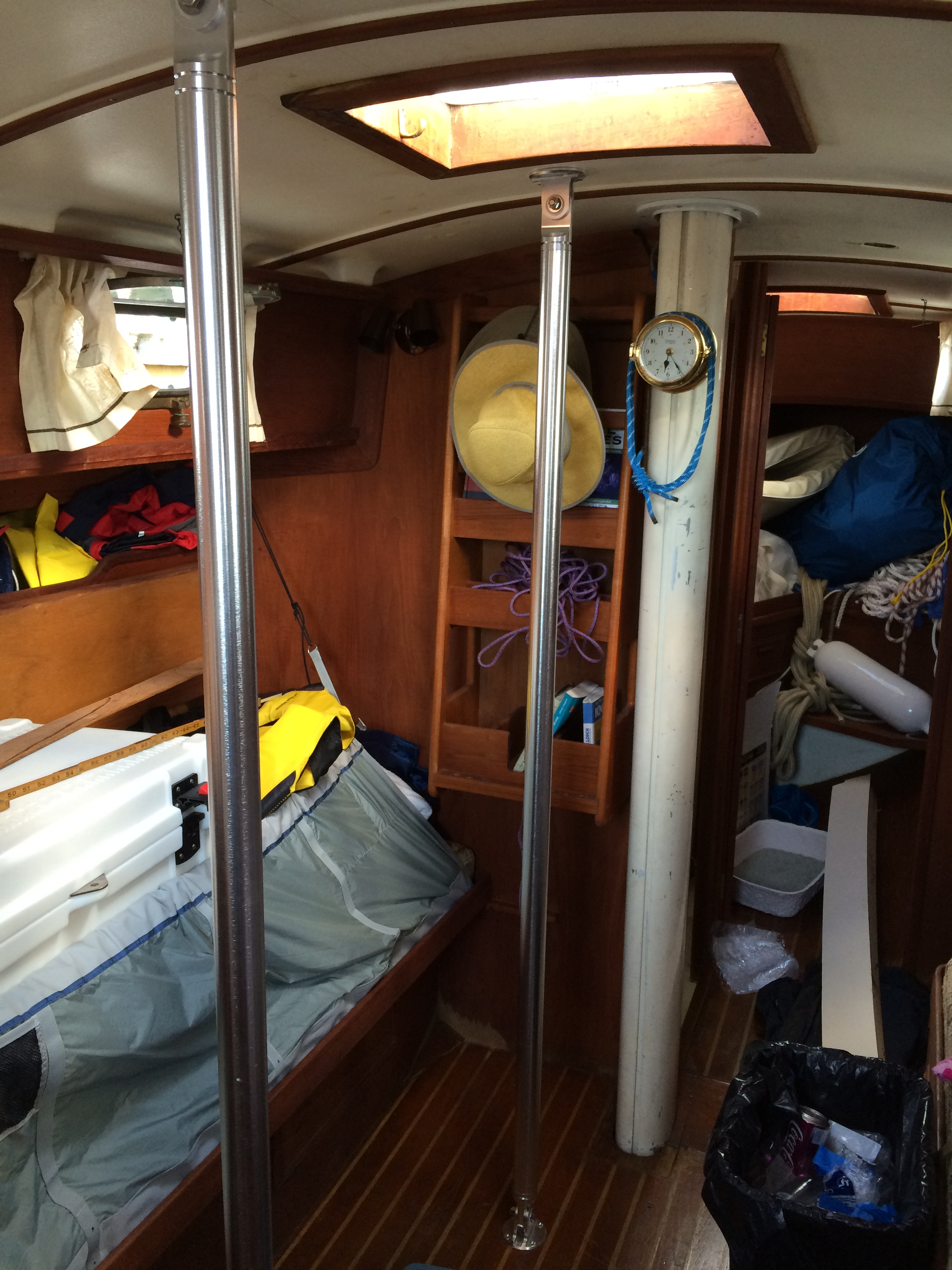

Limiting open space below on my 33
Vincent
Posts: 146
Joined: Mar 2nd, '13, 20:10
Post by Vincent »
Using Atlantic Towers aluminum pole system, (I also installed their arch for some solar panels), I installed some vertical handholds in the main cabin. Now to see if I can download some pics. I have no financial interest in that company, but 10k was too much for me for an arch in stainless steel. This arch seems pretty solid. Below, I plan to add a hardwood horizontal between the 2 sole to overhead verticals. And then I will put half of my table back, folded down when not in use. My wife is only 5ft 5in, and on a heel she has trouble reaching the overhead handholds. The horizontal at waist high will be good to lean on when heeled.
