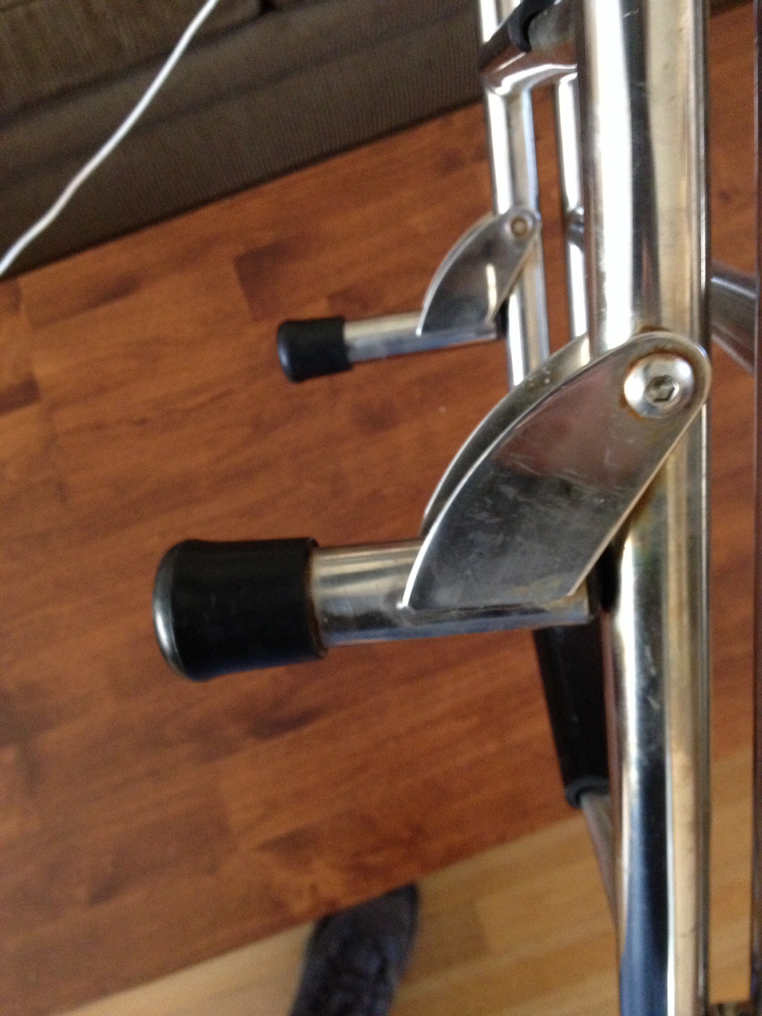

- Original configuration
- image.jpg (838.11 KiB) Viewed 989 times

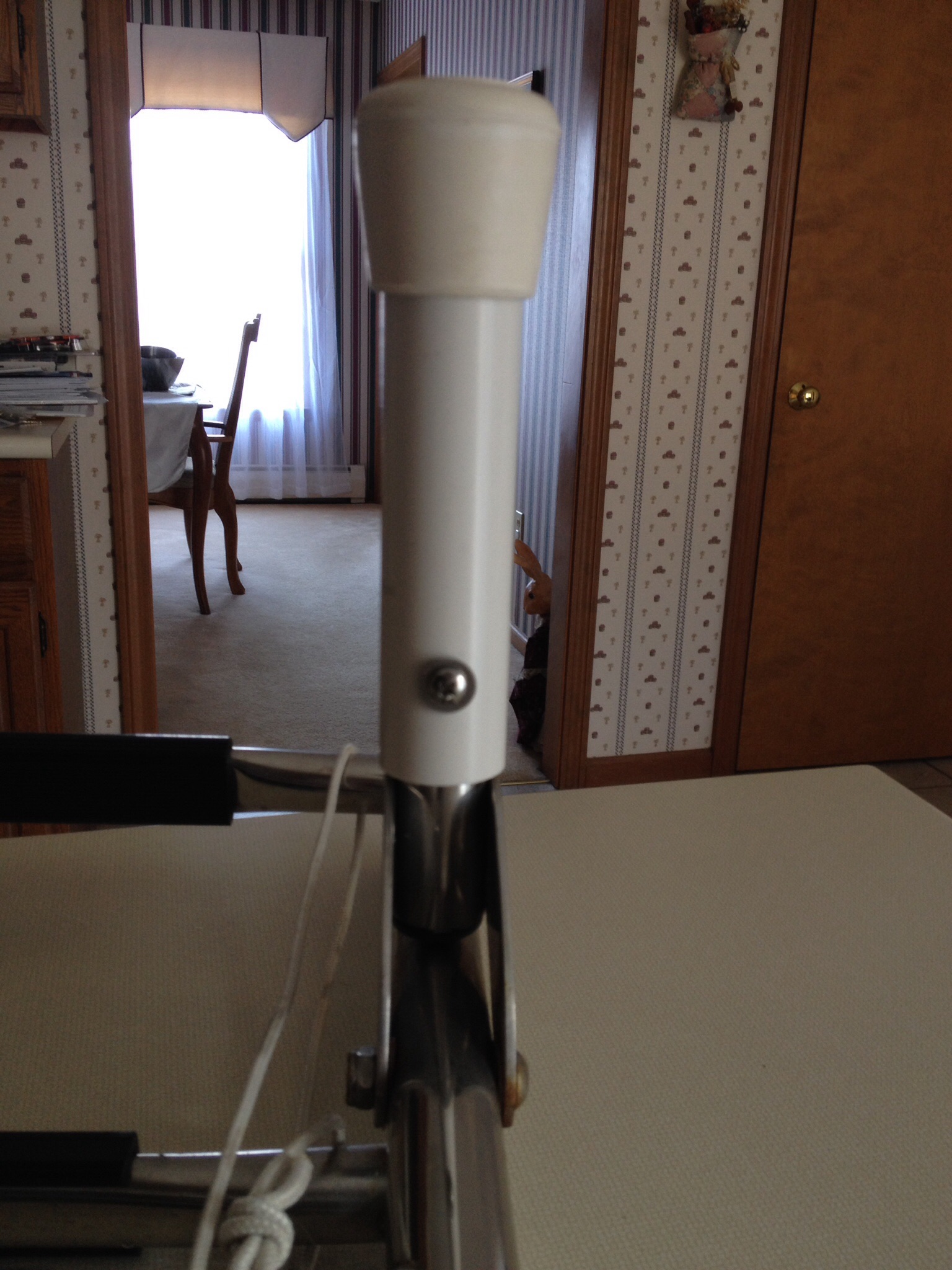

- PVC extension
- image.jpg (583.54 KiB) Viewed 989 times

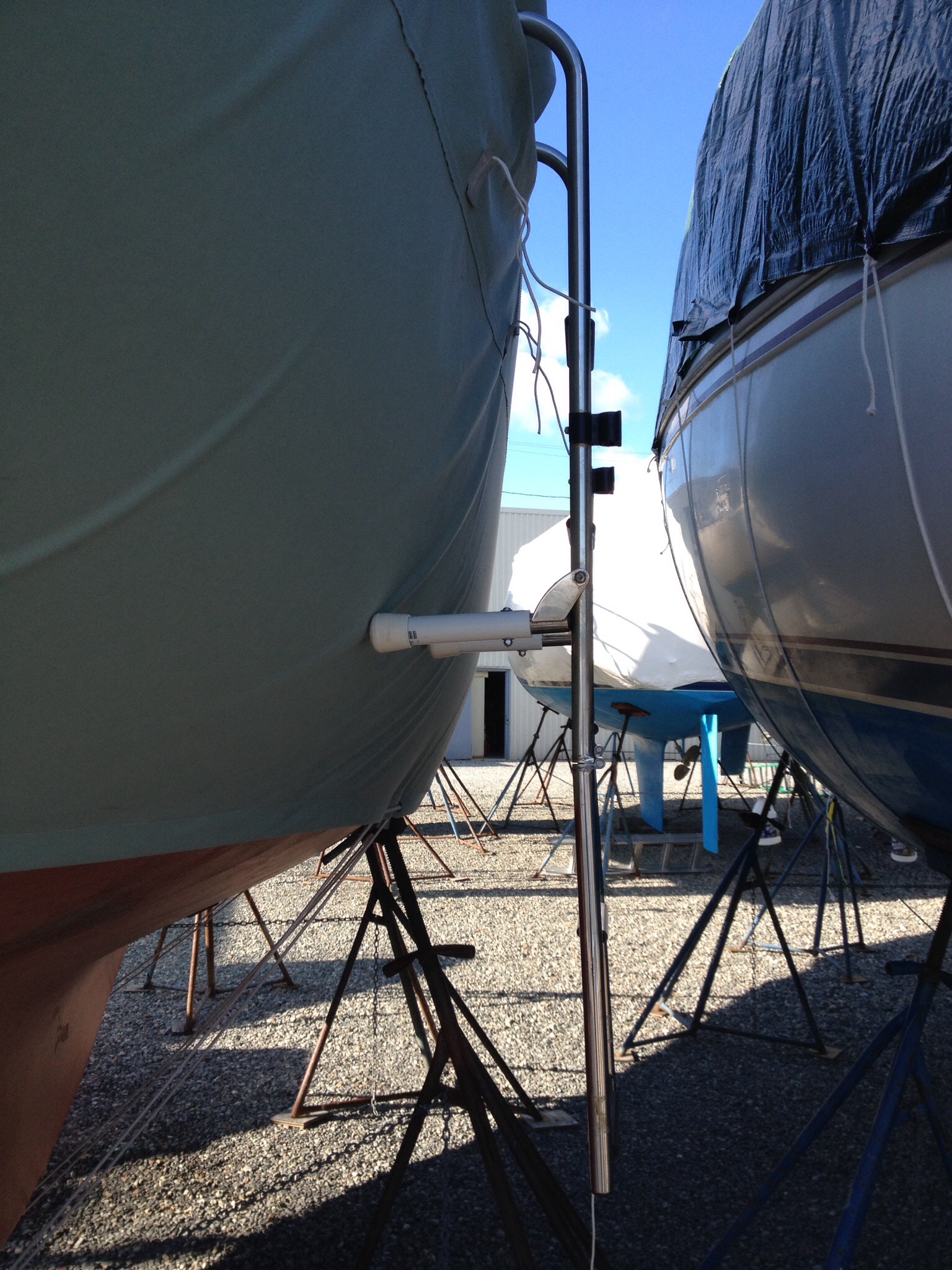

- Final result
- image.jpg (882.42 KiB) Viewed 989 times

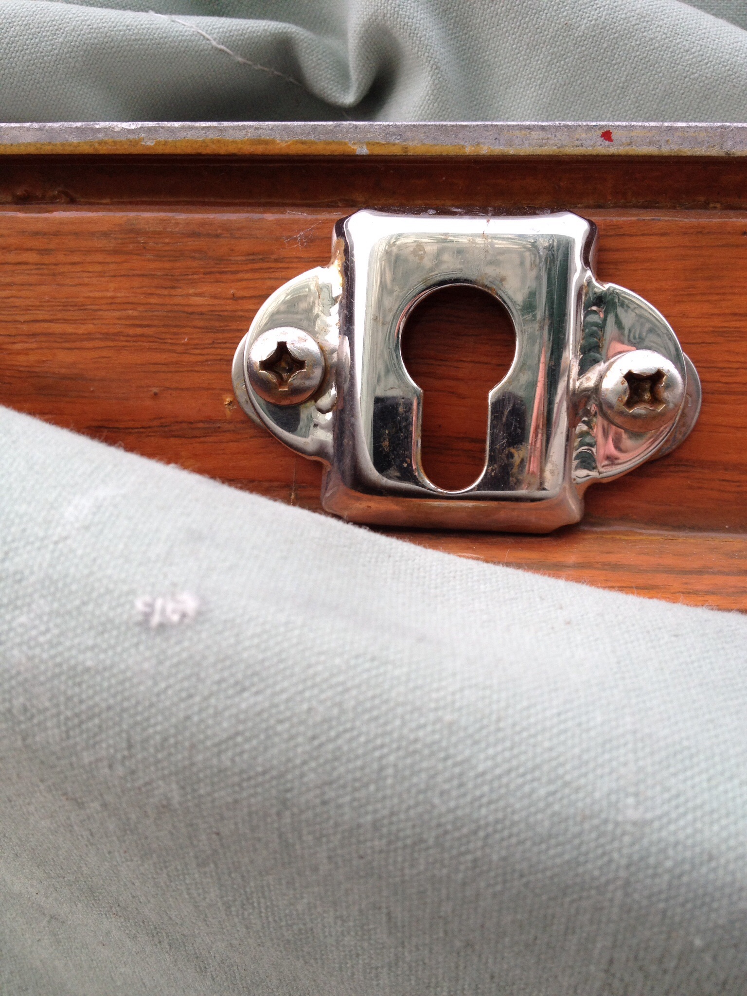

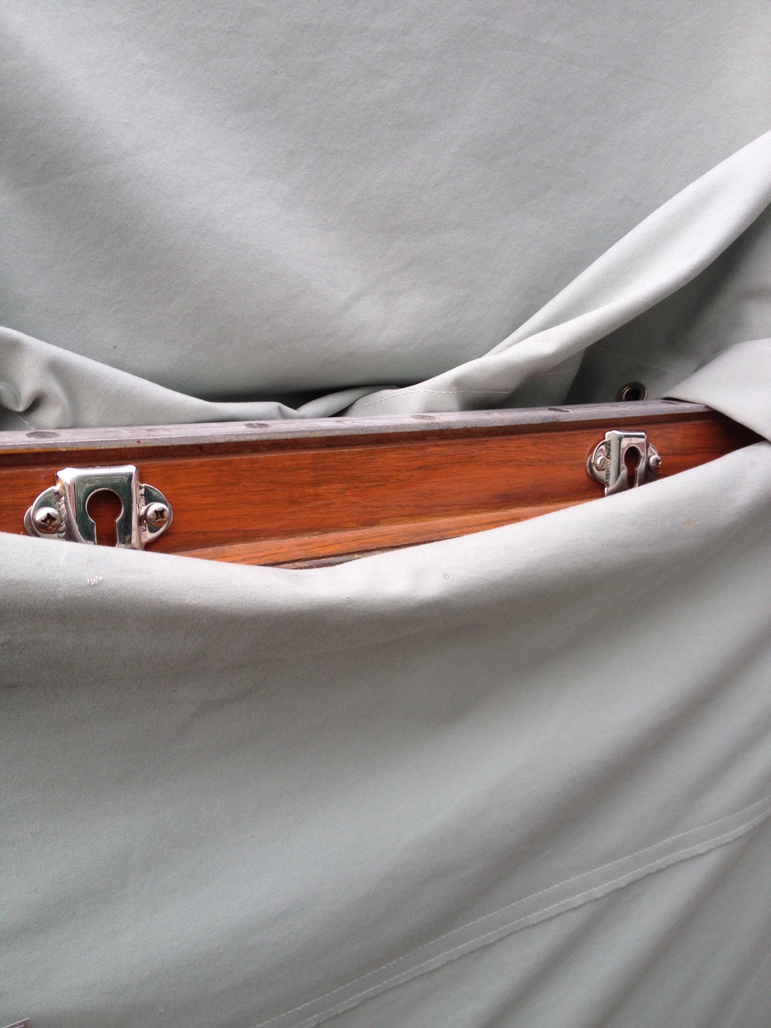

Jim, Wouldn't mind seeing a photo of the attachments at the toenail. Thinking about doing something similar with Danusia.
David
David

Re: Boarding ladder modification
David,
As requested. The tabs with the holes had been vertical, I had them sliced off and re welded to a horizontal orientation to accommodate where I wished to mount them.
