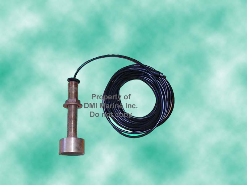

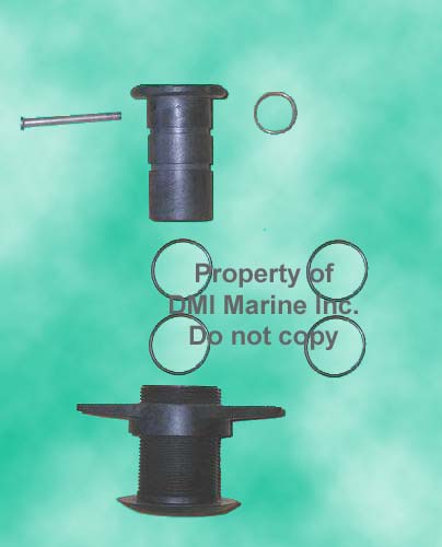

Re: depth transducer removal question
Now that I look back at your question I realize we had different style transducers. The one I removed was an integral long stem bronze transducer, no separate thru-hull.karonoko wrote:Thanks. It sounds like all of you removed the thru-hull - I was hoping not to. Any thoughts on that?
The following pictures are courtesy of DMI Marine:
This is what I had:
I believe this is what you have (only in bronze):
Depending on who made you existing transducer you may be able to just replace the core.
