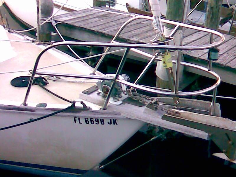

mgphl52
Posts: 1809
Joined: Feb 6th, '05, 14:15
Post by mgphl52 »
While not a CD30... here's a pic showing KAYLA's windlass. This was done by a PO after he had removed the jib club. A CD30 should have room ahead of the stay sail club for a similar installation, I think...
