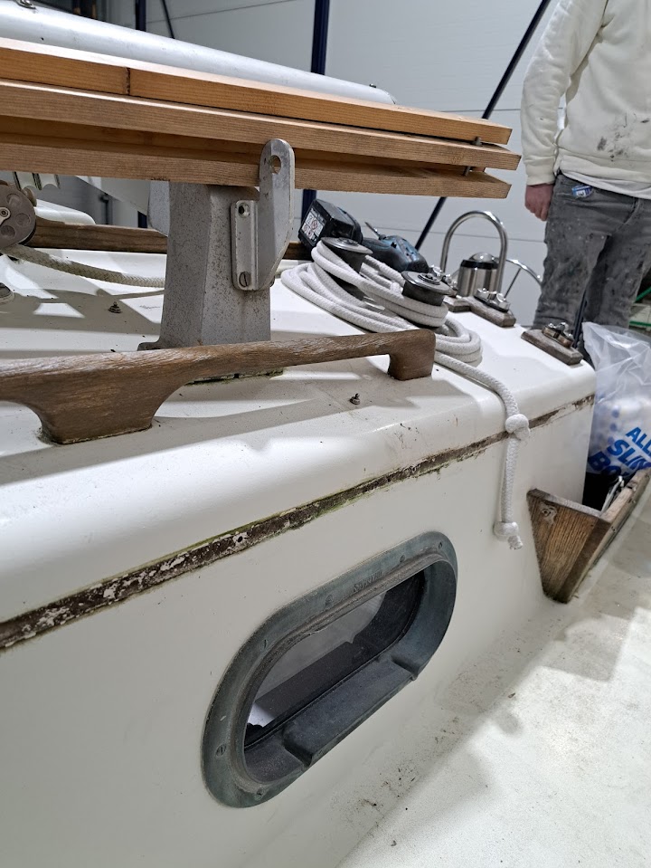

She had teak rubrails covered by nailed on rubbers.
That first year we removed 100's of nails ourselves to remove the ugly rubber "bumpers".
It was a bad install and there was always water between the wood and the rubber, dirt and green would collect and seep through. Showing the damaged teak rubrail behind it, although dented and damaged, it looked better.

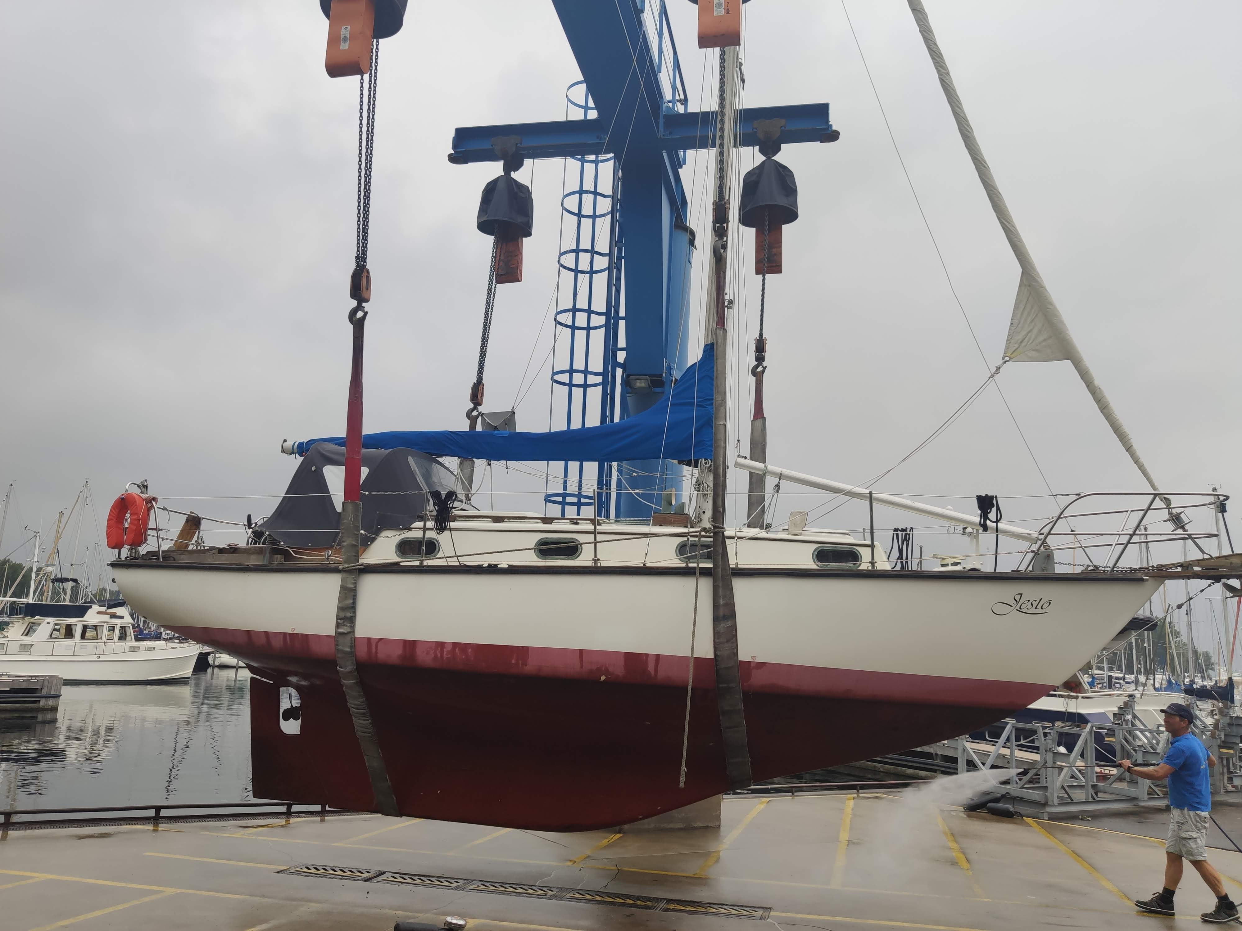

This is what she looked like the day I bought her in 2020

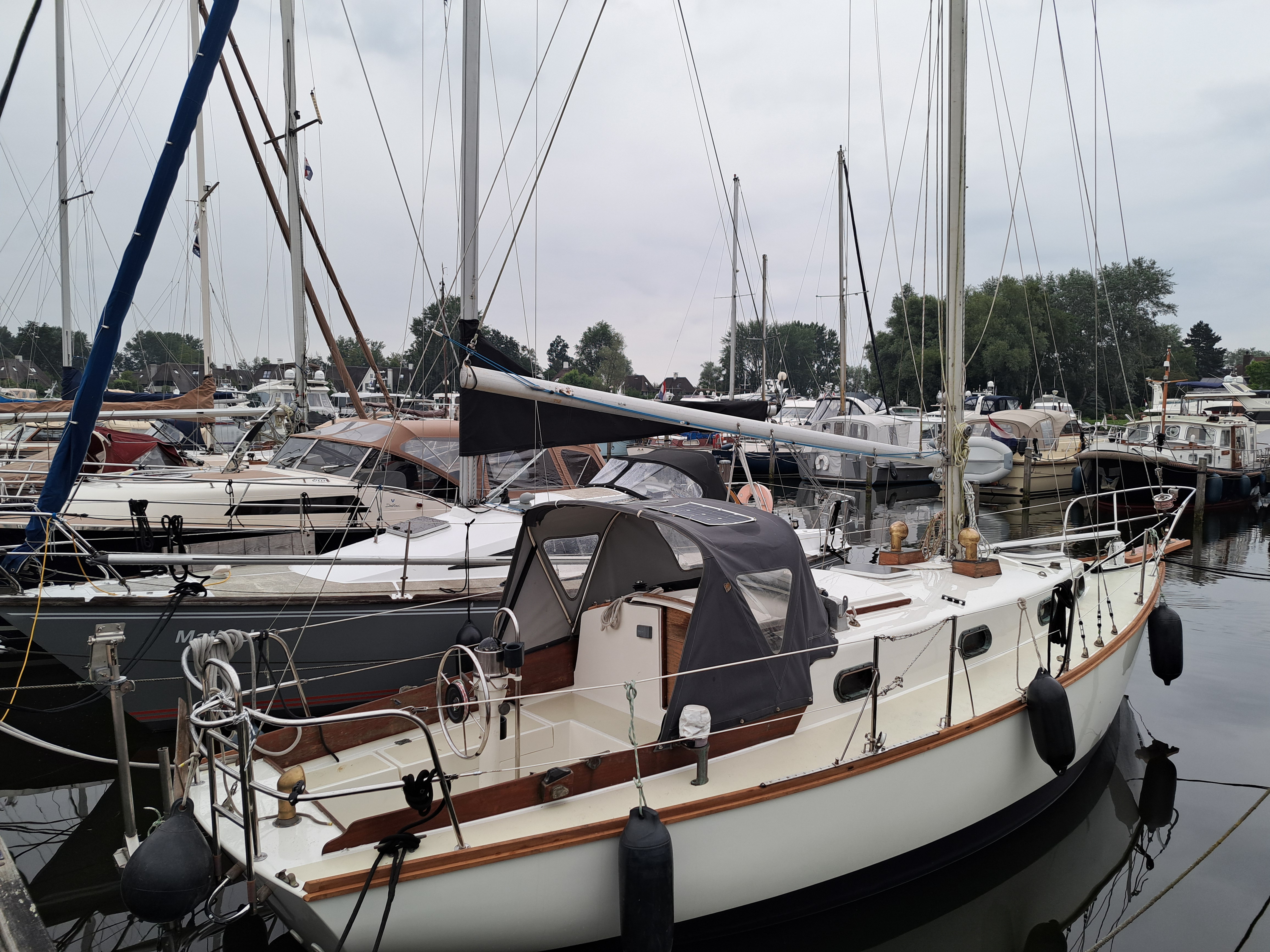

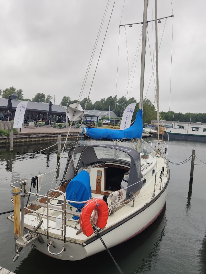

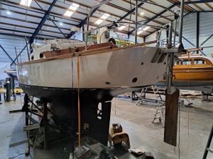

This is what she looks like today

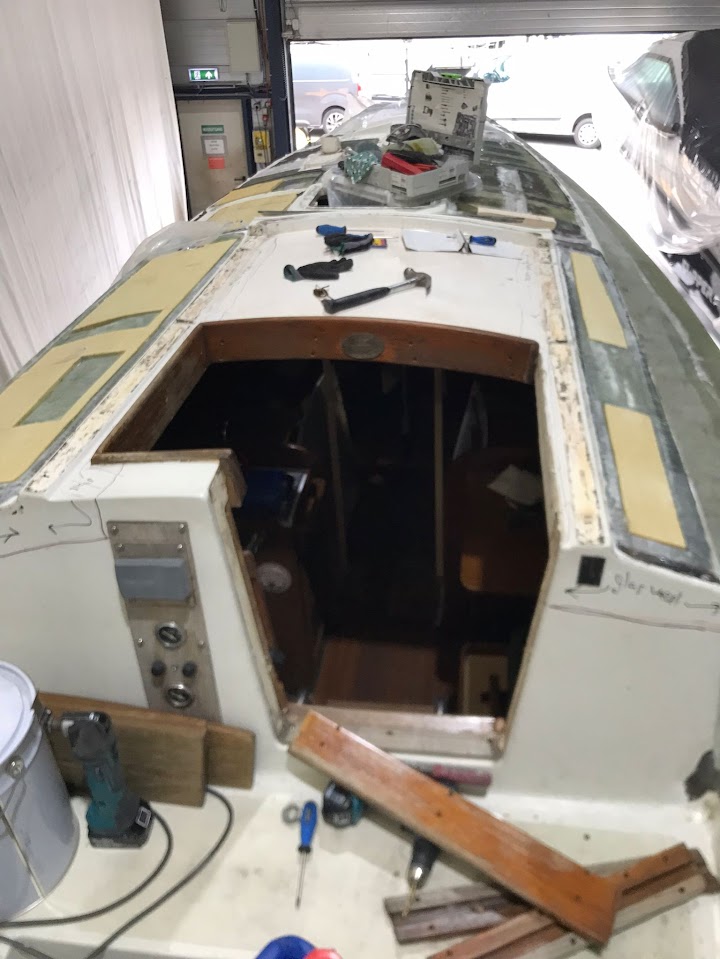

The list of jobs tackled this winter/spring is extensive and I will share some pictures later of everything tackled.

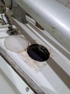

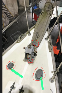

- close off 3 out of 4 (why did someone need 3?) anchor chain holes in the deck fibre glass. You will notice the bowsprit was damaged as well.
- repair old hull damages fibreglass & keel

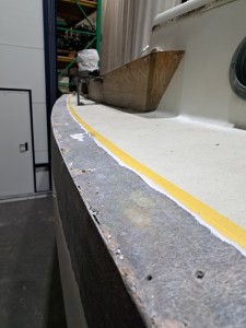

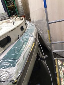

- hull deck joint, glass over 3 layers

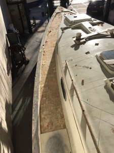

- remove old balsa in deck & cabinroof
- remove teak eyebrow, fill holes
- remove old instrument panels, fill holes
- redo decks
- repair hatches
- reinforce cabin structure

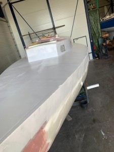

- repaint hull, deck & upper structures

Some more pictures of the process

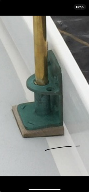

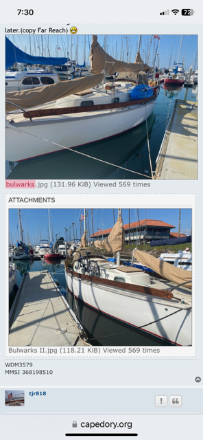

I plan to do the same hull/deck joint reglass starting December 16. I dont think I will replace the teak rub and toe rails. I have temporary bulwarks lashed on to the stanchions. I will probably afford the metal work to modify the stanchion bases etc but will not afford the woodwork yet. So I will install the tempory boards again for a while. I count at least 5 deck mounted hardware pieces I can eliminate : nav lights can go on the pulpits, don’t need water fill , and a stand up spring block that I never use.

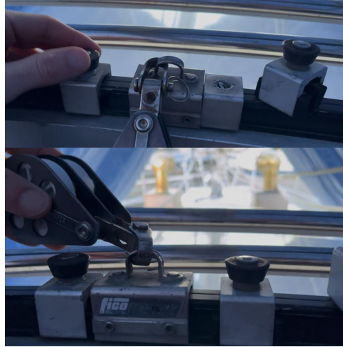

After three years of living with a "workaround" I could finally source a traveler stop :)
Small but significant upgrade.

Excellent. Sometimes it’s the small things which are most satisfying.
