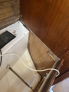

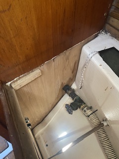

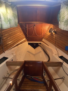

I dissassembled the V-berth to inspect the bulkheads today.
There is plenty if moisture down at the bottom but I think it is OK. I tried to move it with a flat bar and it is secure. I hope it gets enough circulation to dry and does not deteriorate any more till I reseal the deck seam in December
The the plywood for the berths is ok. Not necessary to replace. There is some moisture on the outboard edges and around screw holes. I replaced the old screws and set them in new locations.
I pulled the water tank The hose was so dirty. I replaced it with new. I capped off the filler port since I dont want it and will eliminate the deck fitting soon
I wish I could toss the holding tank and that hose and valve. I think some marinas require it.
