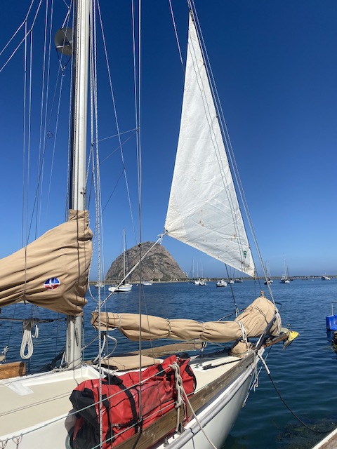

I didn’t get a chance to test this setup with a storm jib on the club boom but It might be ok. This way I don’t have to get out separate sheets. Also the sheets fray on the shrouds.
Dang. I lost the photo. Anyway. I hanked on the storm jib and used a strap as outhaul on the club boom so I can control it using the traveler track

Here are the photos. I want to try the storm jib like this

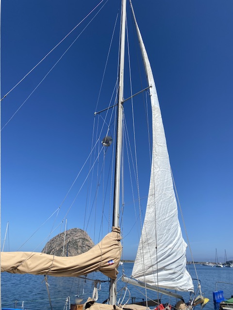

Here is the club footed jib built for this boat. I think it’s called 100%. It seems too big for winds over 30 knots. It goes all the way up to the top and back as far as possible. It blew out on the approach to Hawaii. About 300 mi out. I started getting squalls

Thanks for sharing your experience perspective. I can't really offer much other than the photo you posted of the jib suggest the jib is in very bad shape. Maybe it's not fully hoisted and that's why it looks so baggy.
Your storm jib rig might work. You may have trouble sheeting it in snug. Did you use it as shown after your jib blew out? How did it work? Did you sail with it and your mains'l or with the mizzen.

Thanks for responding. Yea. I didn’t it hoist it up tight. I just wanted to show the size. Ive been thinking about putting a reef in that one. I have another jib from my previous boat. Never used. It’s cut high. I think you call that yankee. But again I have to get out the jib sheets.
No I didnt get to test the storm jib yet
