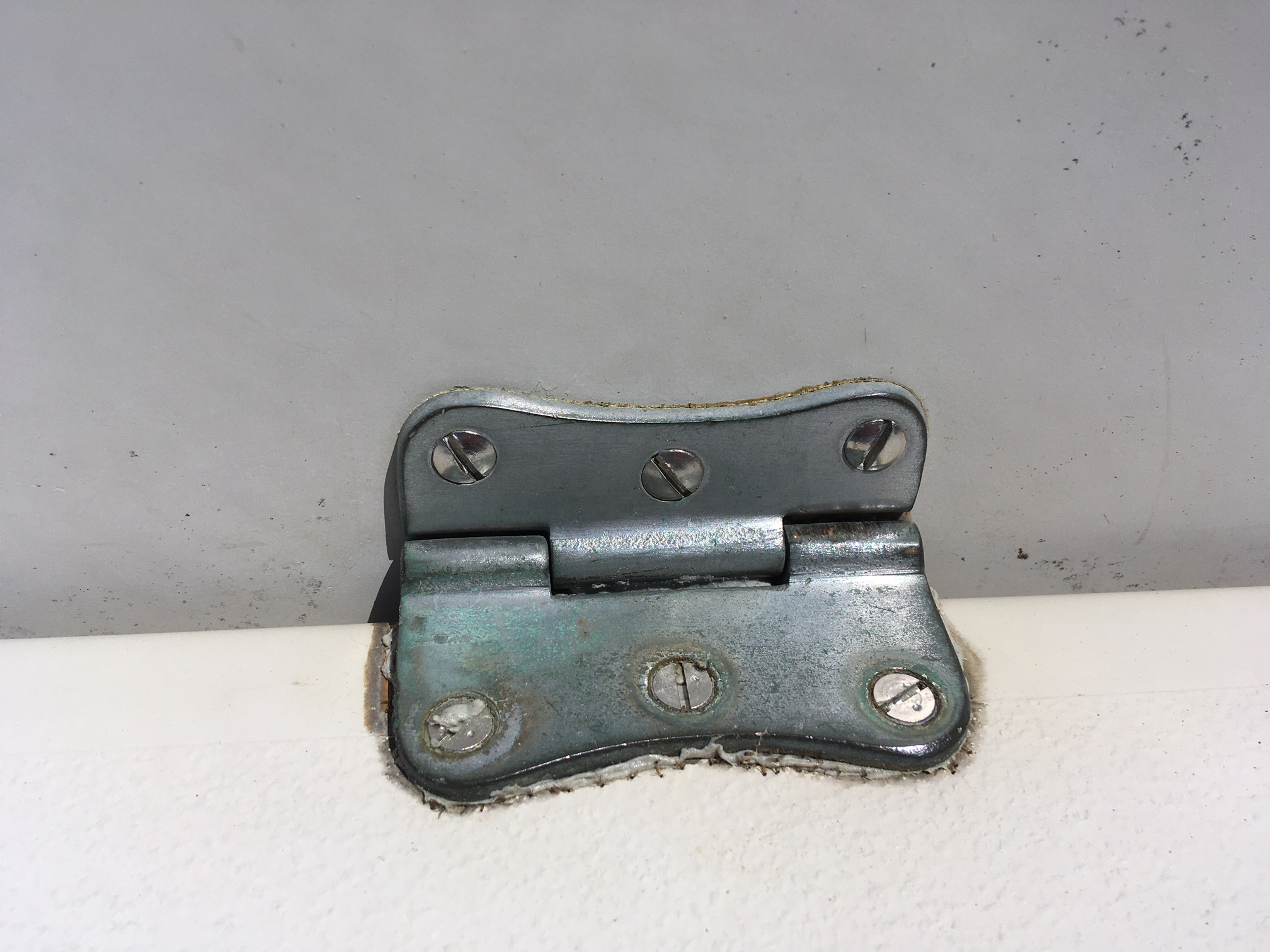

After reading a recent article about things to check during Spring Commissioning I gave my cockpit locker hinges a quick check.
The hinges are bolted to the top of the locker.
Some of the bolts had rusted such that the nuts had fallen off and there was evidence of water getting into the core.
I removed the bolts, chamfered the holes and cleaned out the holes as best I could. I did find some rotten core.
I was surprised that the top of the locker was cored. It is pretty thin but is cored nonetheless.
I was also surprised to find no evidence that sealant was used to bed the hinges.
I cleaned up all the surfaces and put it back together using new 316 stainless steel fasteners and butyl tape.
I did have to use a hacksaw to trim off the ends of the bolts. Any extra length would prevent the cover from closing.
Hopefully the core had only minor damage. They do seem to be very solid.
Picture of one of the hinges here: Wonder if any of you have had a similar experience and if you have done anything more extensive to remediate the cover.
It seems very solid on my boat and I'm hoping that now that they are sealed further damage will be prevented.

Thanks for that info Jim. I hadn't thought to test the old machine screw before I tossed them out.
I've seen write ups from other Cape Dory owners about recoring the tops of their cockpit lockers after they got rotted by water getting in. I had thought that mine were not cored until now. Fortunate that they are not on your boat.

Yes. Common problem. I removed all the hinges. Then, over drilled through all the bolt holes, filled with epoxy, then after the epoxy cured re-drilled for the bolts. Chamfered the top of the holes. Bedded with butyl.

I did the same as John. On my CD30 there does seem to be core in the hatches so it seemed like a prudent idea. I also found oversized washers, about 3/4in diameter.

Thanks for the replies.
I guess this Winter I'll take them apart and bring them home to dry out.
Then remediate the holes as you've described and rebed.
Probably some water trapped in there still. Might take a few months for them to dry out.
