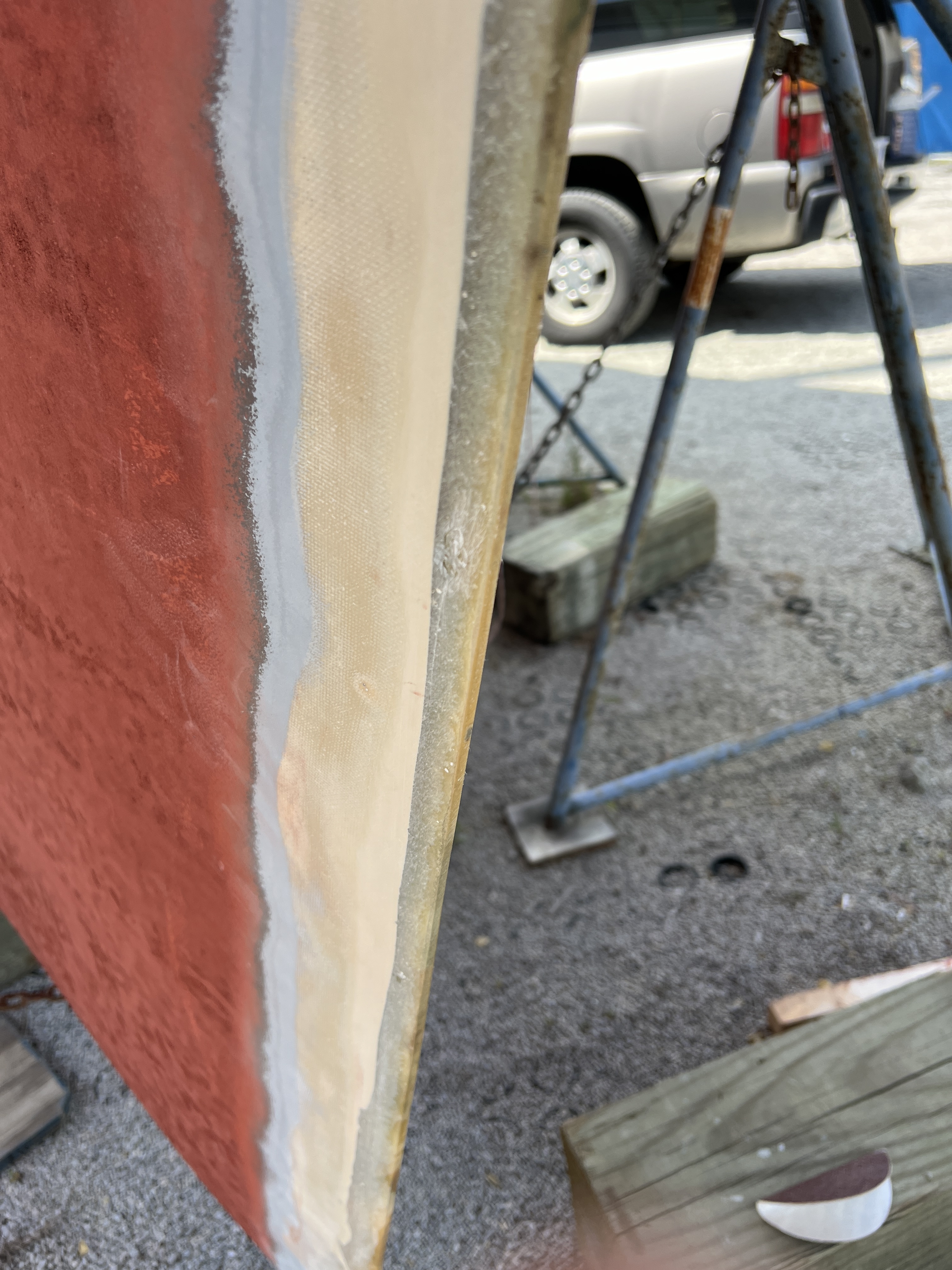

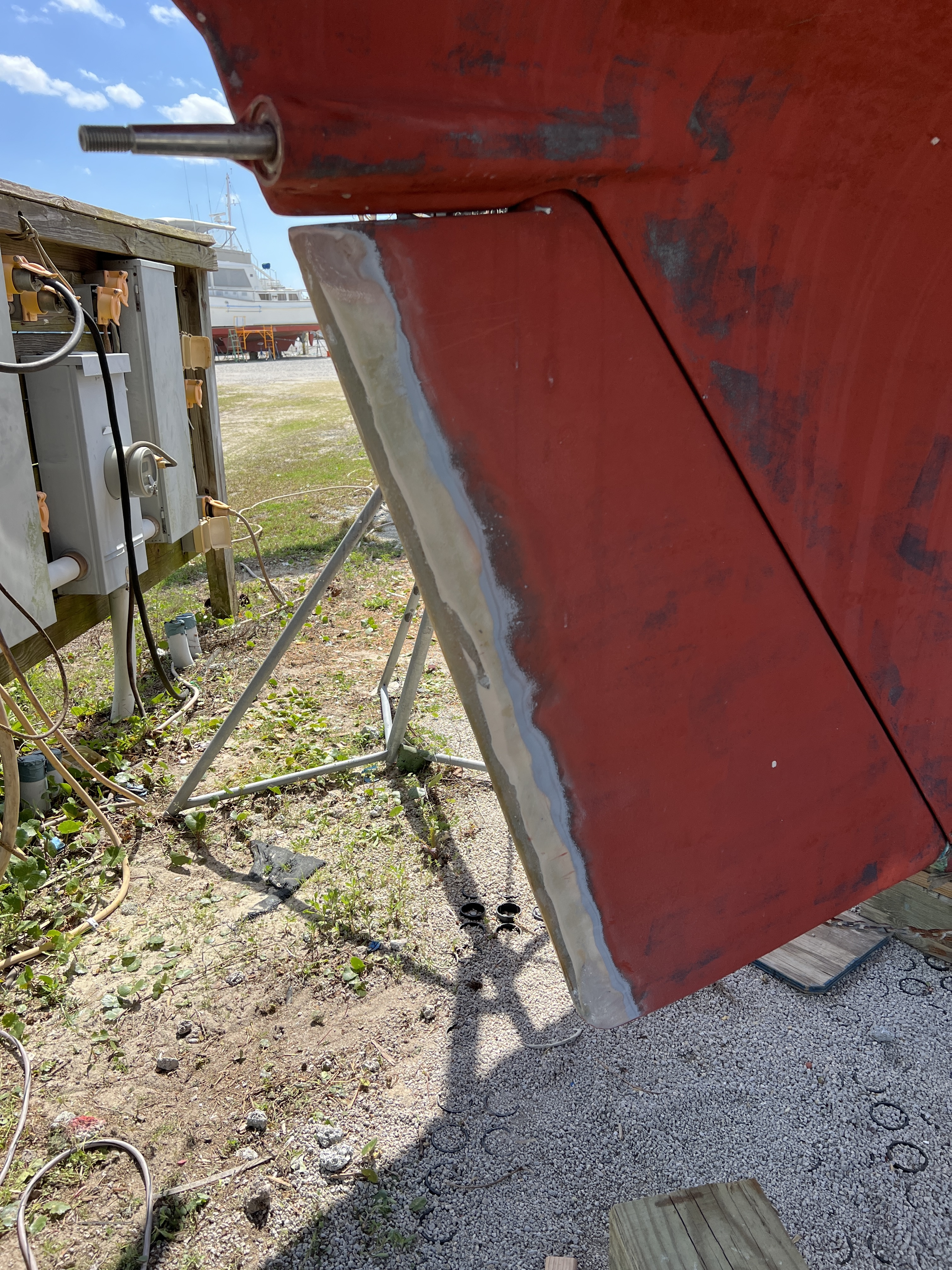

When I installed the Beta engine in the Far Reach a couple years ago I also flush mounted the four through-hulls. The only project left to make the underwater profile as smooth and fair as possible is to fair the trailing edge of the rudder from its fat 5/8" rounded profile to a narrower squared off edge.
Yesterday, I used a porter cable DA 5" sander with 60 grit to sand down the profile to a smooth 3/16" squares off edge. This is supposed to be the most efficient trailing edge profile for rudders.
I still need to fair in a few spots before I cover with barrier coat and the bottom paint. At that point I think I have done all I can do to make the underwater profile as smooth as possible to reduce underwater drag and unwanted turbulence. I plan to stay with ablative paint for now.

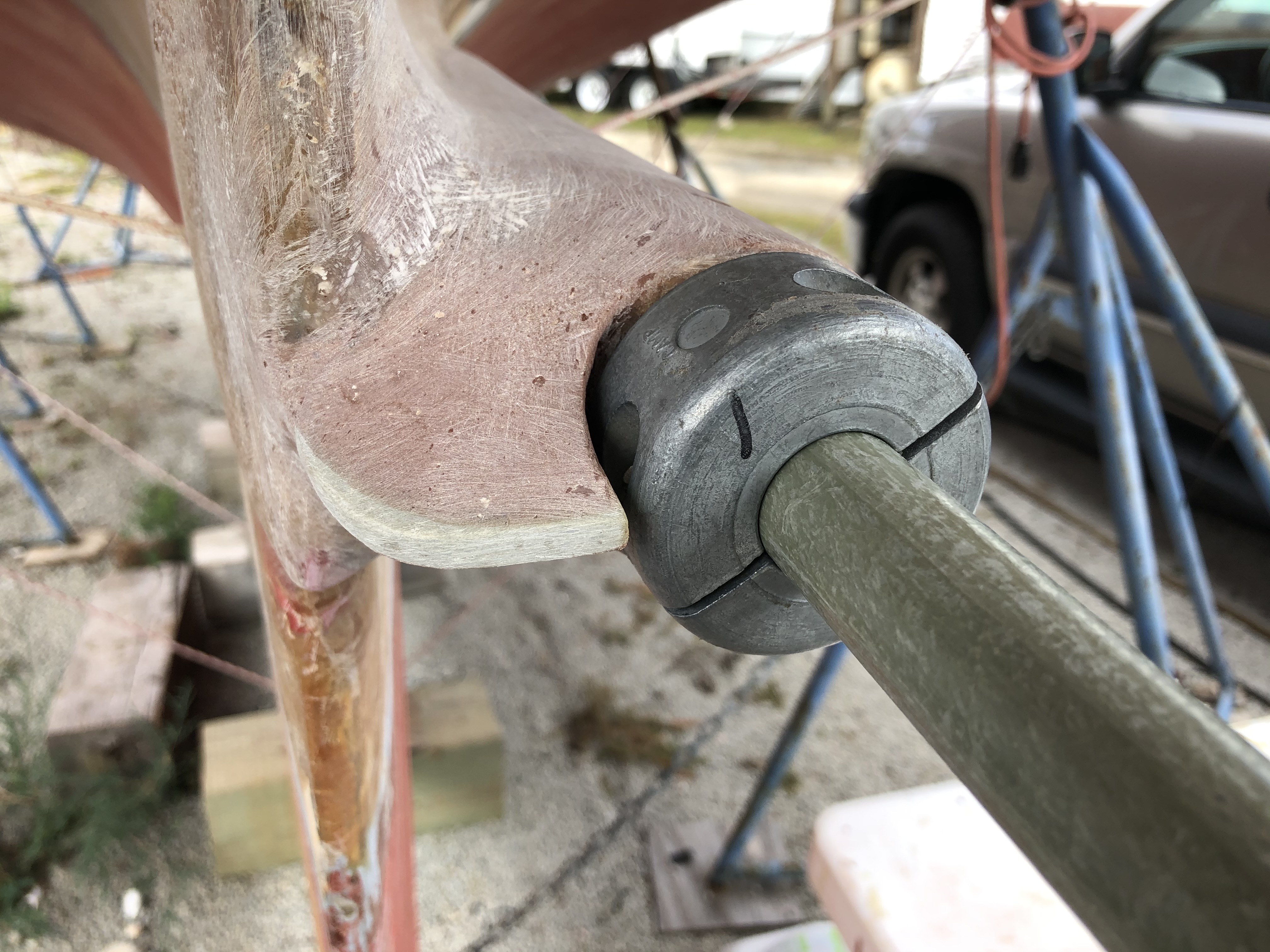

I also include a photo of the prop shaft log I installed during the engine built. You will see on the trailing edge I also added a small streamlined squared off edge there too.
This is the fairing around the shaft log.
