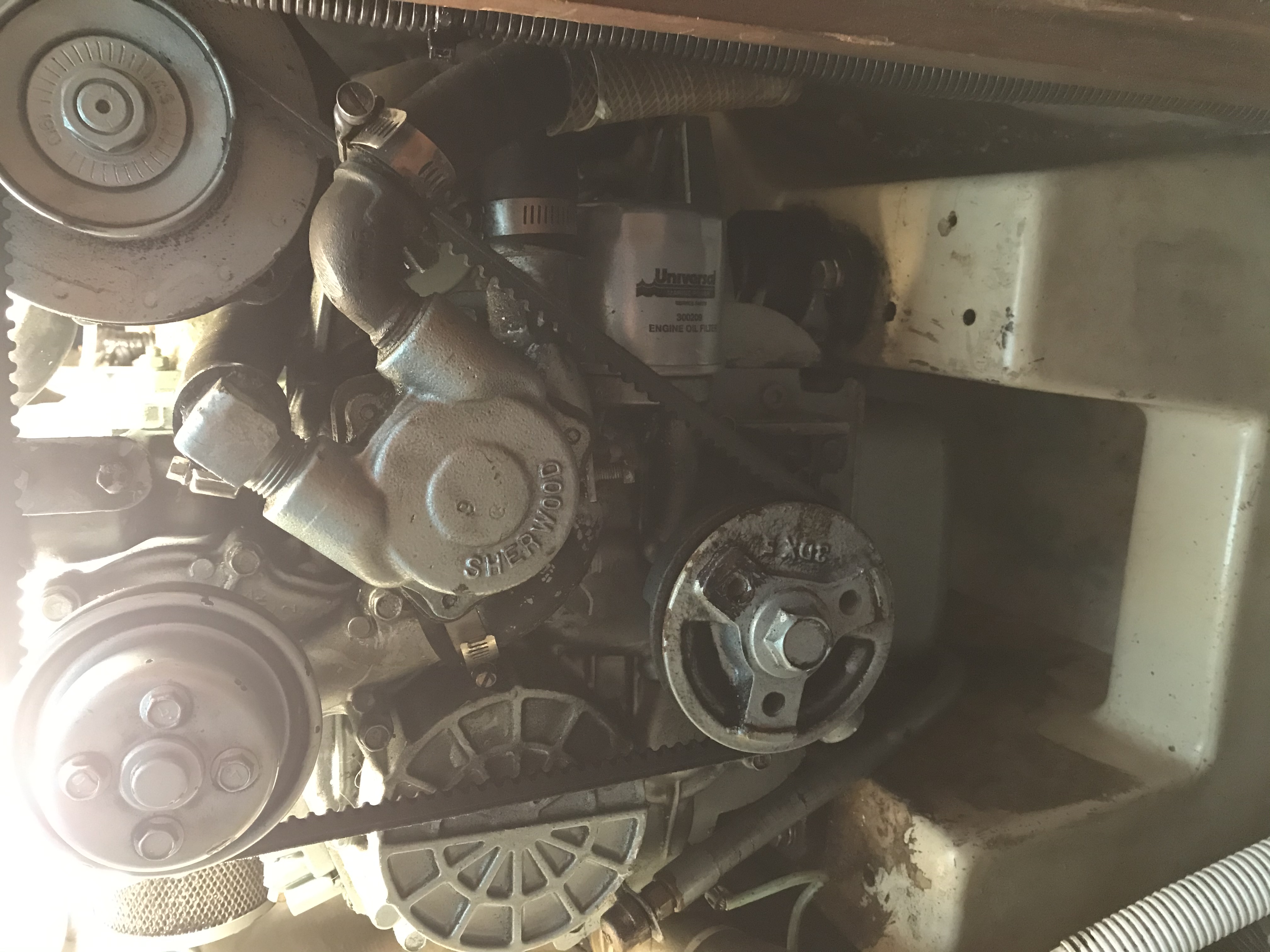

Finally, after 16 years of use, the pump bearings let go. Yes, I know the pump can be rebuilt, the problem is that I would have to continue to live with it. The Sherwood pump is, effectively, facing aft, in that the impeller housing must be removed with bolts only accessible from behind the housing. It was never en easy job, even 16 years ago.

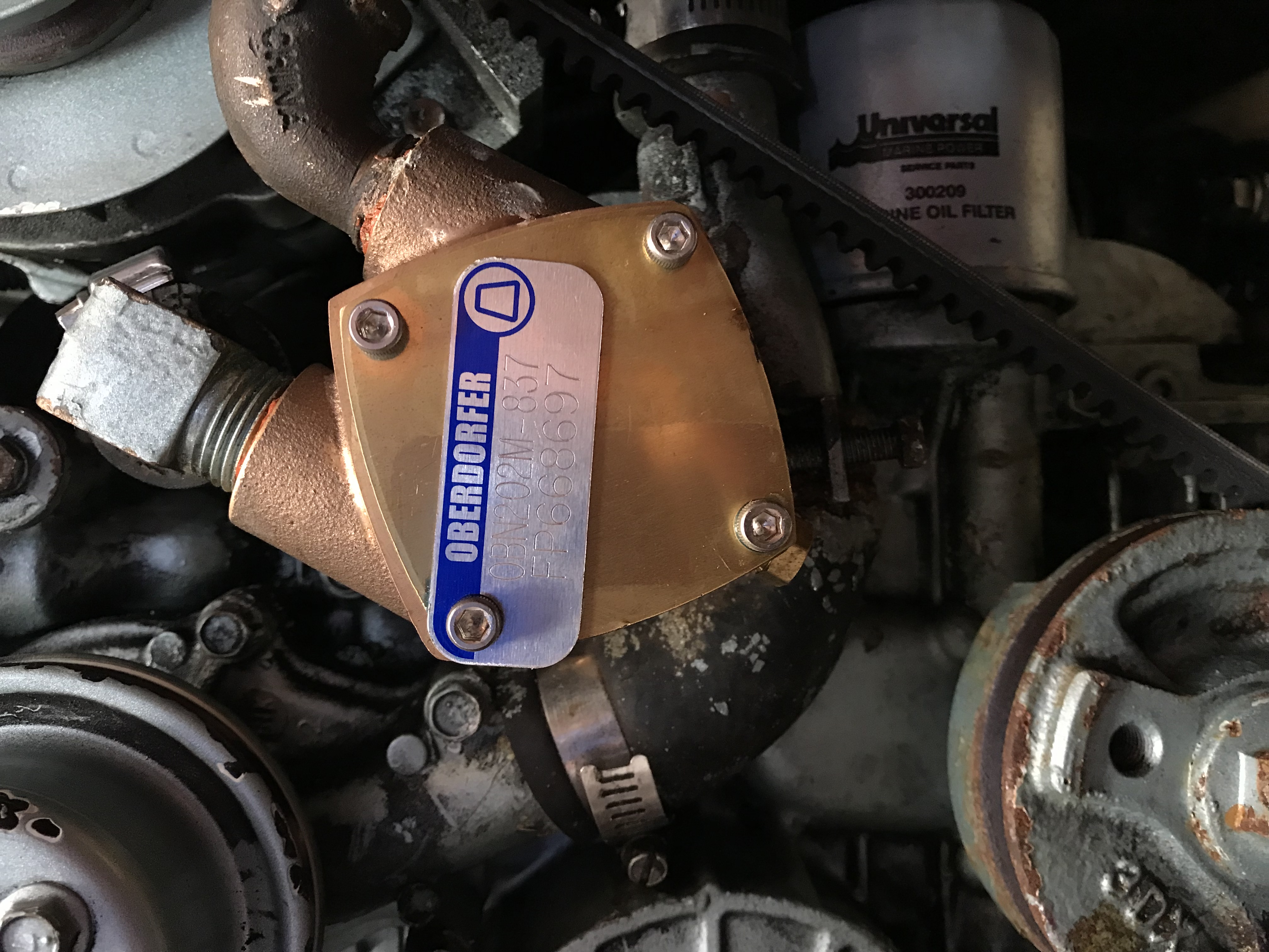

I have known for several years that an Oberdorfer pump was available as a retrofit and that is what I have chosen to do…to maintain my sanity. The new Oberdorfer N202M-837 was a simple install and I can now change my impeller in five minutes, on a slow day.

The original equipment Sherwood pump in place. The hex screws are on the aft side of the impeller housing…out of sight and extremely difficult to access.

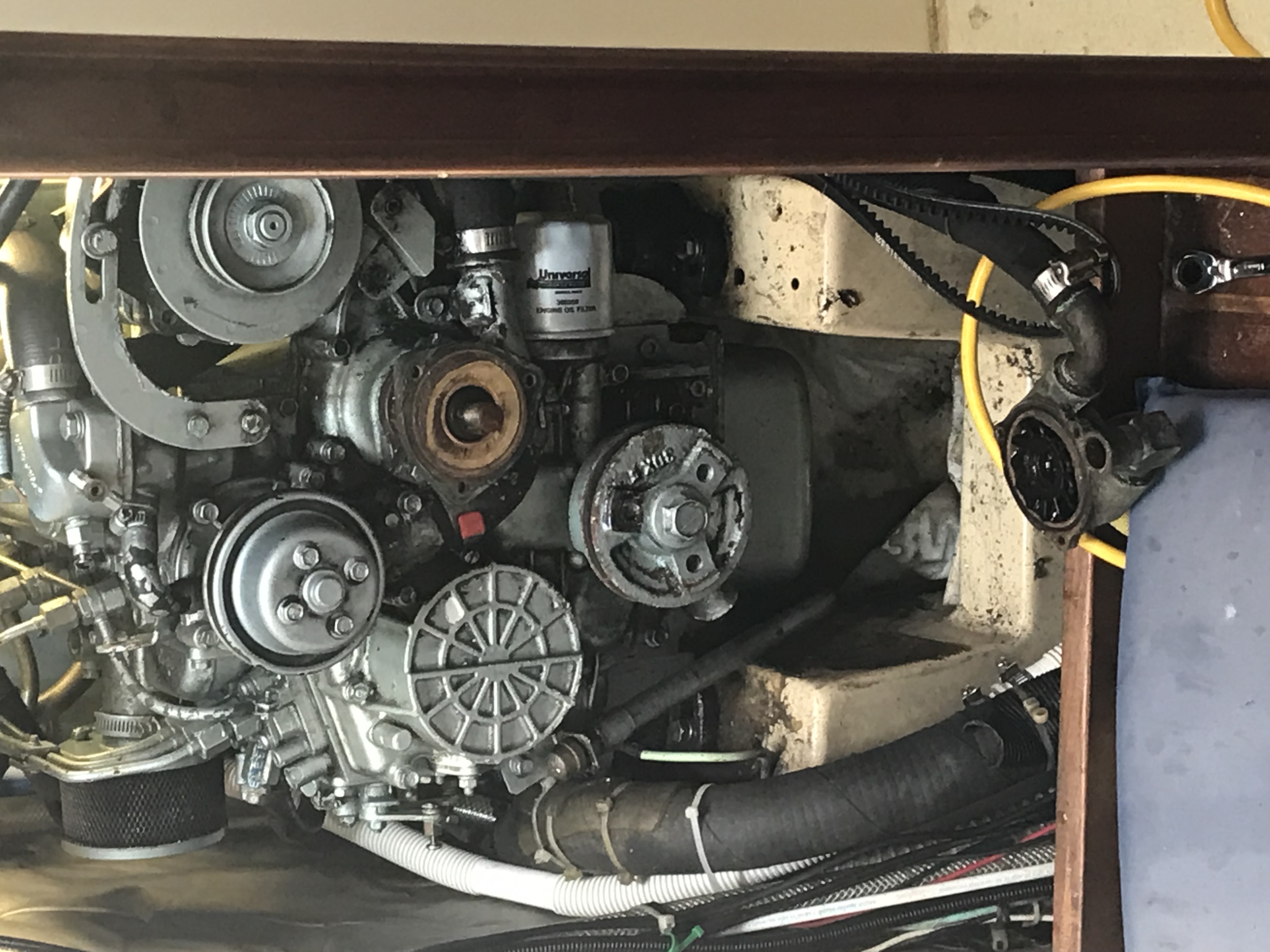

The Sherwood pump impeller housing removed from the pump body to access the impeller for replacement. Not at all convenient!
The new Oberdorfer pump.
