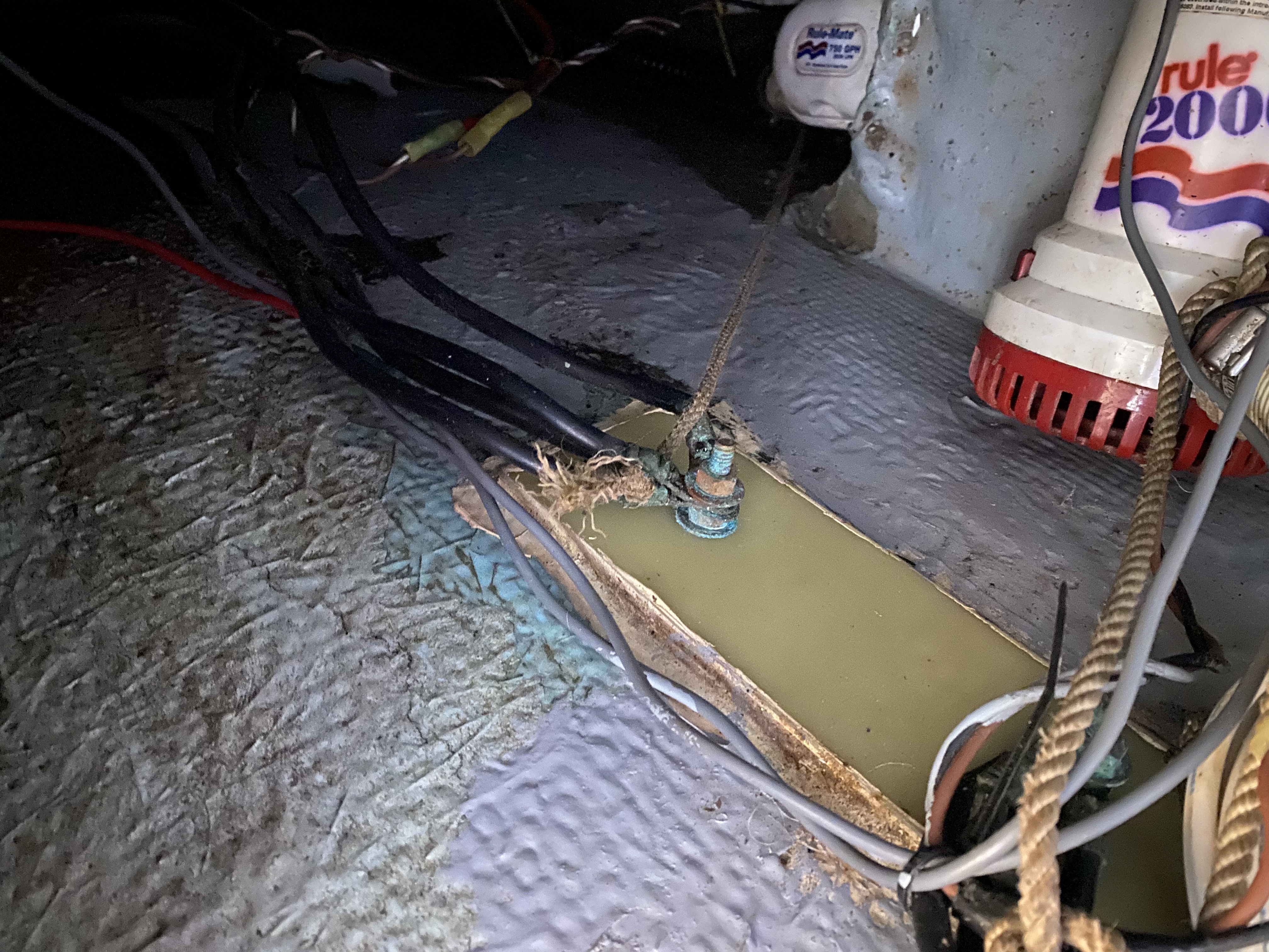

Re: Bronze Dyna-Palte and leaky bolts
Mine is 1/4” g-10. Seems fine
- 46F59DA8-C995-4240-B28C-B63B4257883D.jpeg (4.31 MiB) Viewed 7068 times

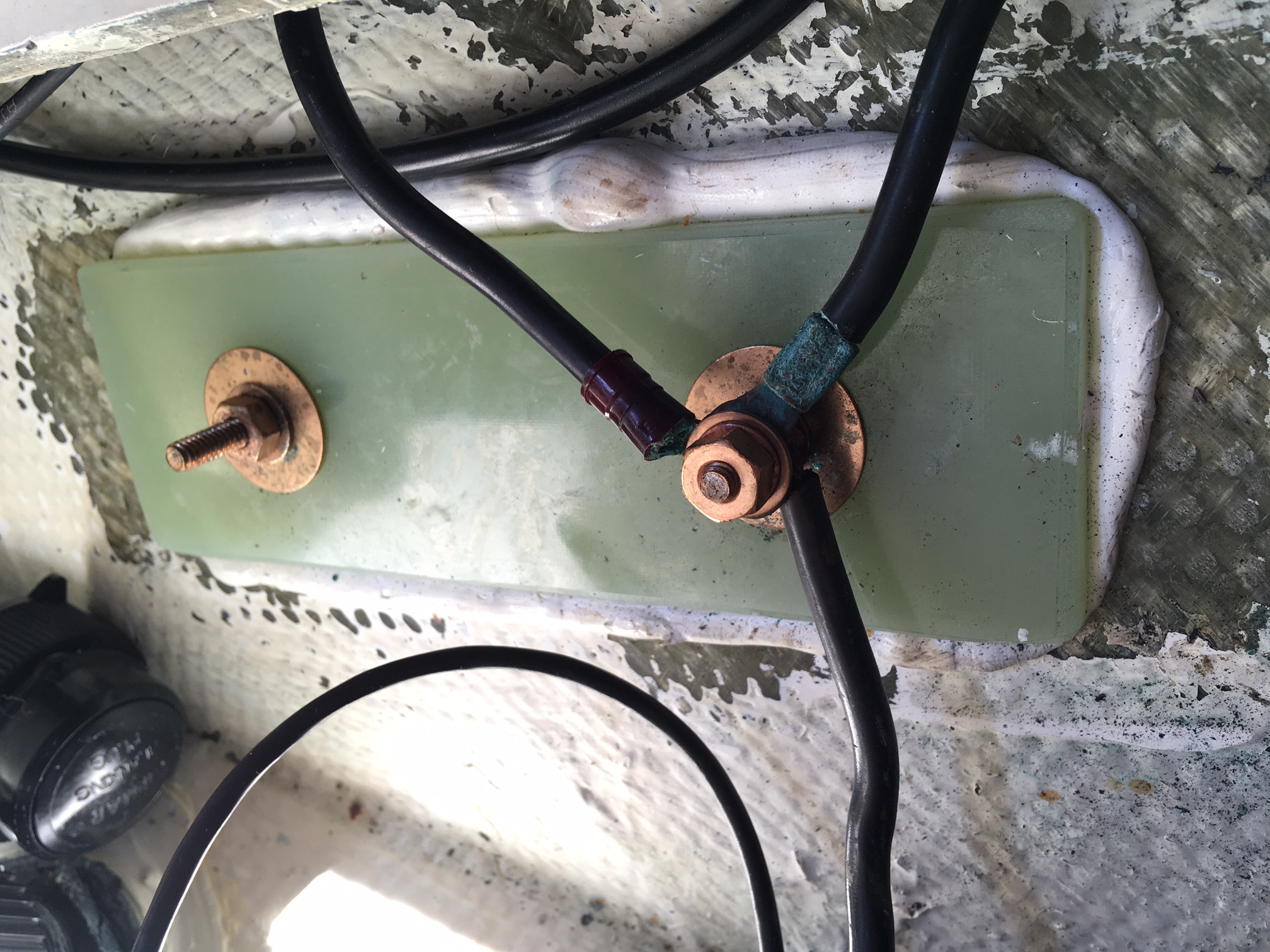

I ended up replacing the backing board with a piece of 3/8" G-10.
Slightly easier to cut than 1/2'.
I cleaned up the old dynaplate with an angle-grinder fitted with a 120 grit floppy disk.
I used new silicon bronze bolts, nuts and washers from Fair Wind Fasteners.
I chamfered the holes in the hull where the bolts enter - the outside surface and the inside surface.
I used Sikalfex 291 on the hull and the bolt holes to bed the dynaplate.
Not too neat of a job but it doesn't leak a drop now.
Nice job. A little squeeze out is a good thing, a little more squeeze out is even better.
- Posts: 3663
Nice work Ken. You can trim the squeeze out with a box cutter.
