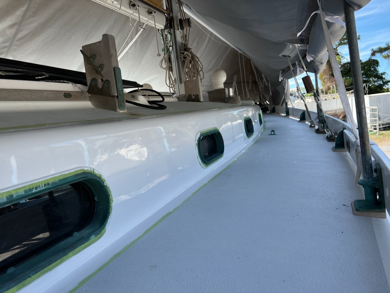

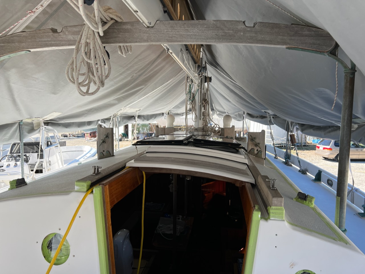

- Tapped off, sanded, and ready to go.
- 23E5B8EA-D783-4328-B98D-C37AD3CFBB49.jpeg (307.68 KiB) Viewed 1204 times
- Starboard side looking forward.
- CF941DA7-D656-45BC-8A86-CF8E8AB1D584.jpeg (287.64 KiB) Viewed 1204 times
- Port side looking aft.
- 38E893A8-3C62-47B6-9E53-FE7D9823701B.jpeg (258.66 KiB) Viewed 1204 times

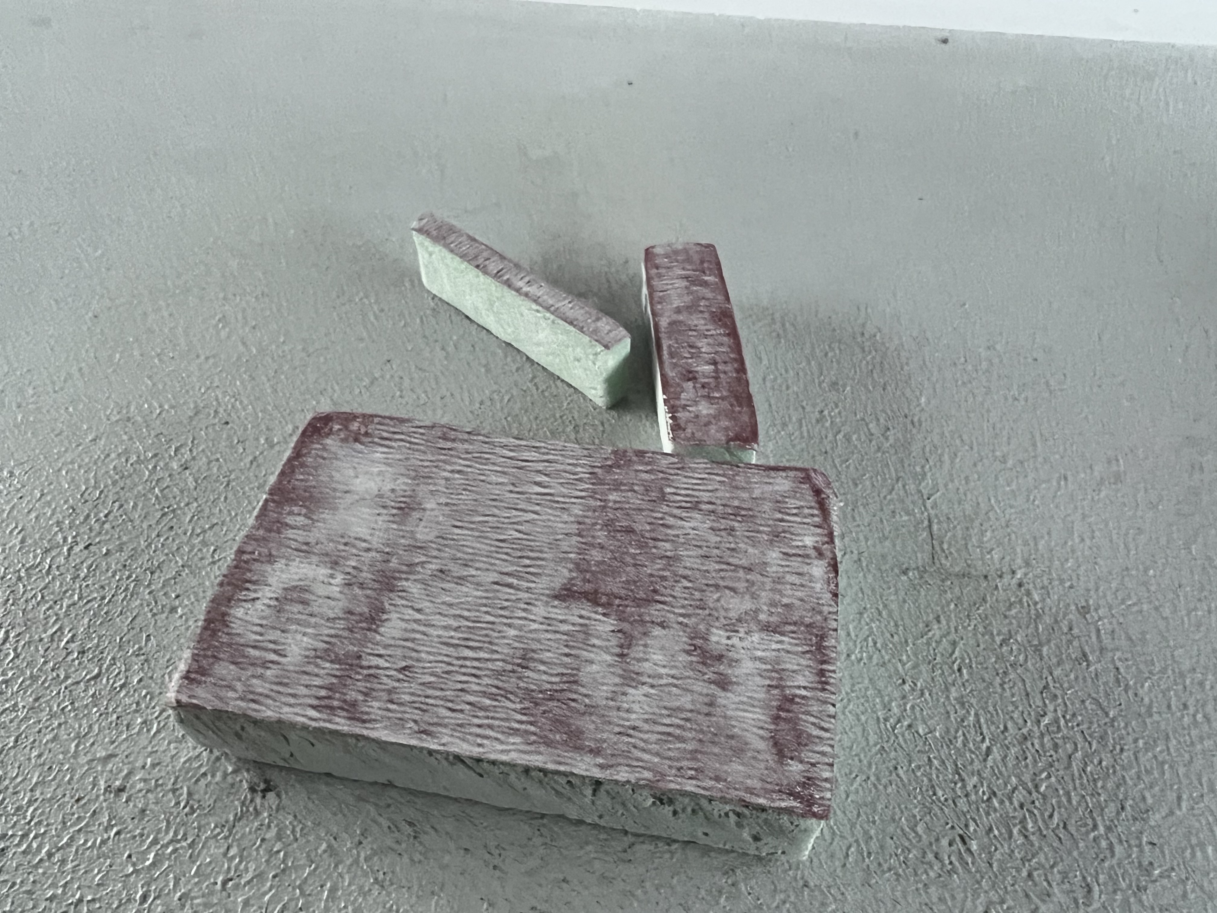

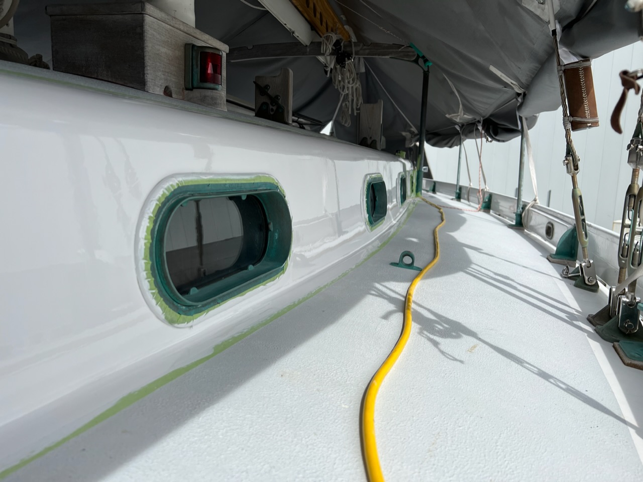

We finally got a sliver of decent weather. Gayle and I got the second coat of Awlgrip applied. It went on nicely. Yesterday I pulled the tape. It looks great. By the time I got the tape off it was too dark for photos. I'll take some later in the week.
For Jim, attached below is photo of a couple sanding blocks I cut on the chop saw. I used adhesive backed sand paper made for long boards. Rip the blue board 2 3/4" wide what ever length you need then chop to desired length. You can bevel cut them to get into a tight spot. Easily customizable.
Another trick is to apply the adhesive backed paper to the surface you are sanding and then file that profile into the block by working it back and forth over the sand paper. Then remove the sandpaper and apply it to the foam block and sand the surface with exact shape required to evenly abrade the target surface.

Thanks, John, but when I Google "blueboard" I get two different products. One is styrofoam insulation and the other is gypsum drywall. My guess from the photo and desired handling characteristics is that it must be the styrofoam kind.John Stone wrote:...

Blue board at Lowe's and pink board at Home Depot. Same thing different color for different store.wikakaru wrote:Thanks, John, but when I Google "blueboard" I get two different products. One is styrofoam insulation and the other is gypsum drywall. My guess from the photo and desired handling characteristics is that it must be the styrofoam kind.John Stone wrote:...
