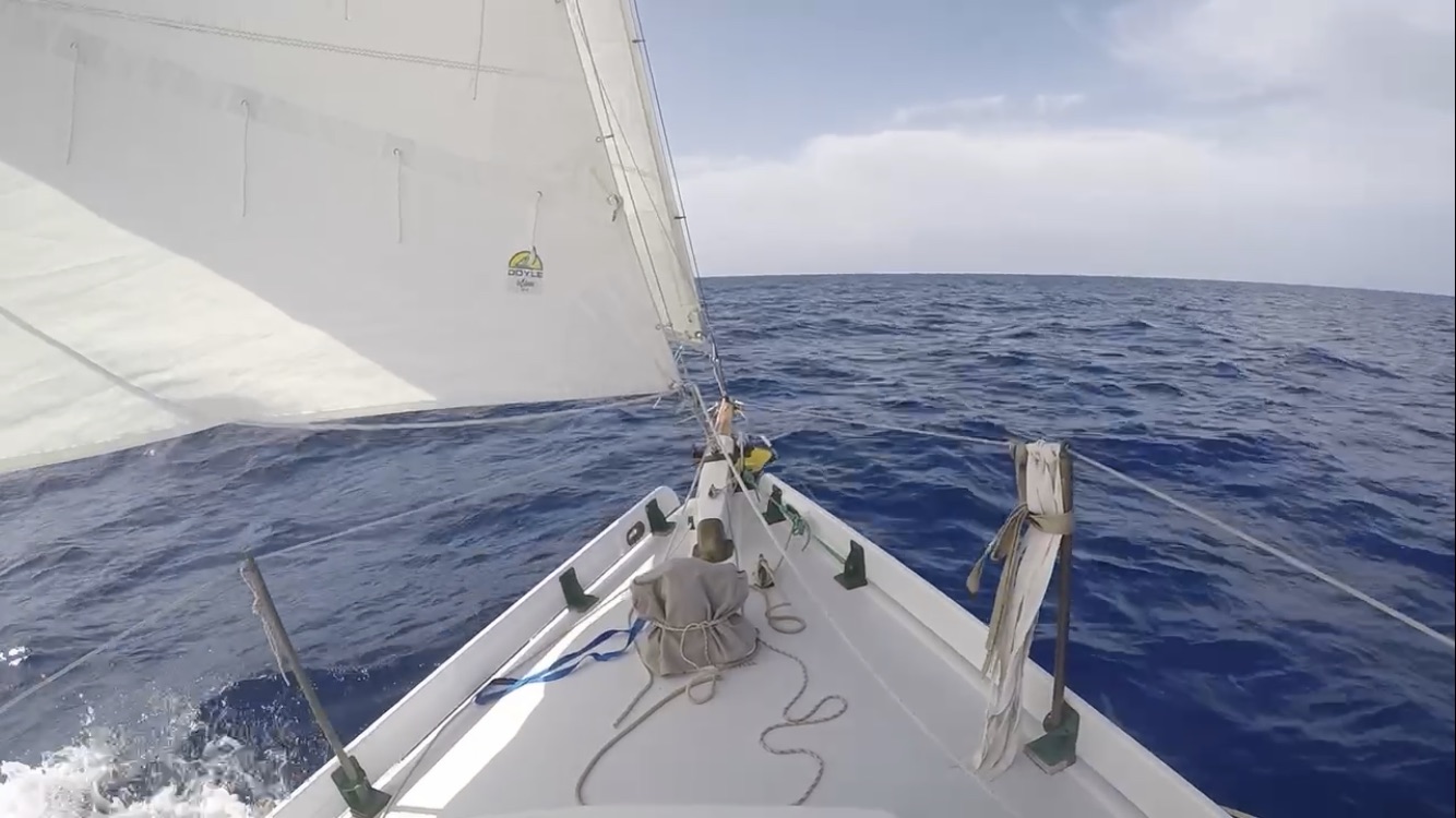

I short tack all the time without difficulty. I have made several changes to my boat to making tacking as effortless and as simple and reliable as possible. First, I replaced the wire stays'l with one made of dyneema. It's slick and reduces friction. Second, I removed the hanks and replaced them with brass luff rings. Once again, less friction. Last, I made the dyneema forestay easy to detach. I leave the stays'l on the stay (remember those luff rings). I release the forestay via a 2:1 dyneema pendant and pull the forestay with stays'l still attached and in the bag, aft to the side deck or cabin top. Then, the fore-triangle is open and the big jib tacks as easily as a sloop.

Re: Staysail Sailing on a CD 330
No. I don't think so. I also moved the tack of the stays'l to the gammon iron on the stem of the boat. So about the same I think.wikakaru wrote:And you also added a much longer bowsprit than on a stock Cape Dory, so I would guess that the slot that your headsail has to go through is much bigger, too.John Stone wrote:I short tack all the time without difficulty. I have made several changes to my boat to making tacking as effortless and as simple and reliable as possible. First, I replaced the wire stays'l with one made of dyneema. It's slick and reduces friction. Second, I removed the hanks and replaced them with brass luff rings. Once again, less friction. Last, I made the dyneema forestay easy to detach. I leave the stays'l on the stay (remember those luff rings). I release the forestay via a 2:1 dyneema pendant and pull the forestay with stays'l still attached and in the bag, aft to the side deck or cabin top. Then, the fore-triangle is open and the big jib tacks as easily as a sloop.

- 5E99F189-F793-4EA1-8F36-DAC03AAEF3FD.jpeg (174.97 KiB) Viewed 750 times
