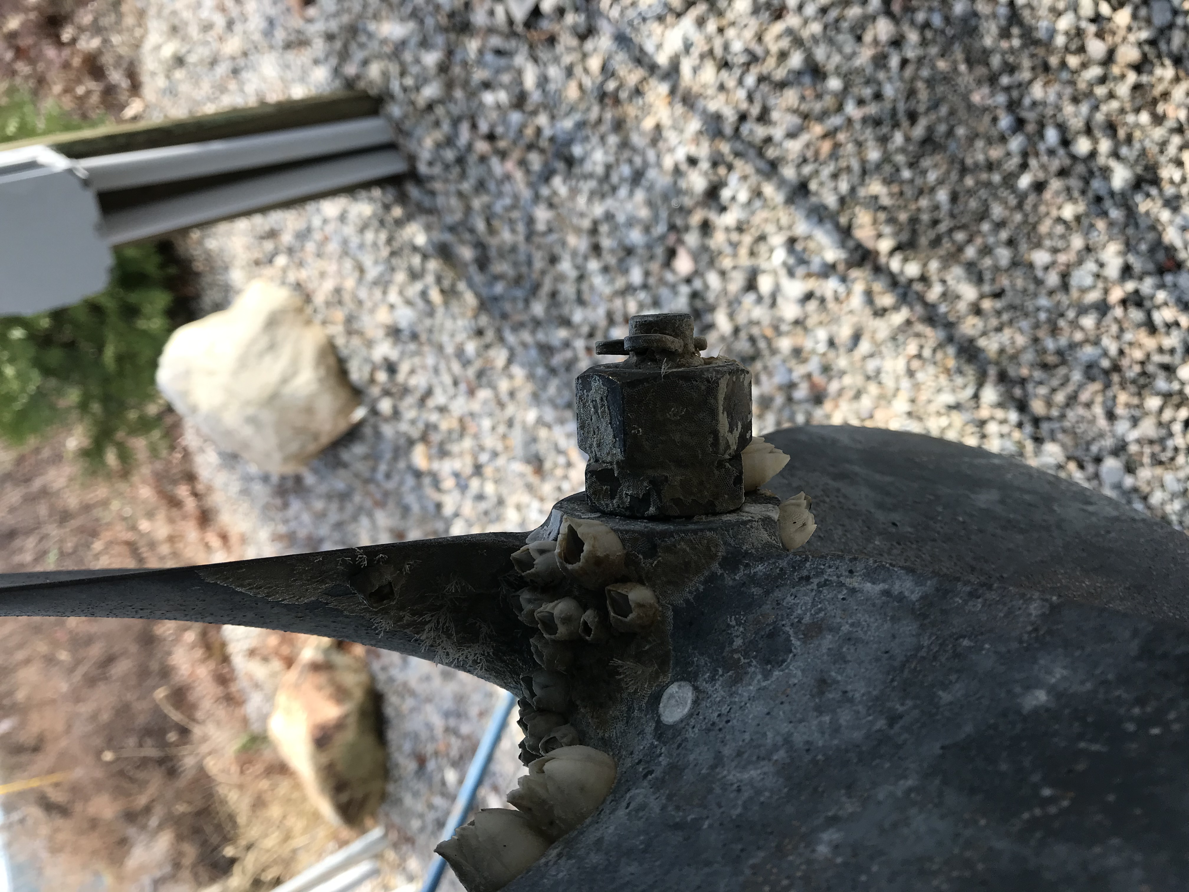

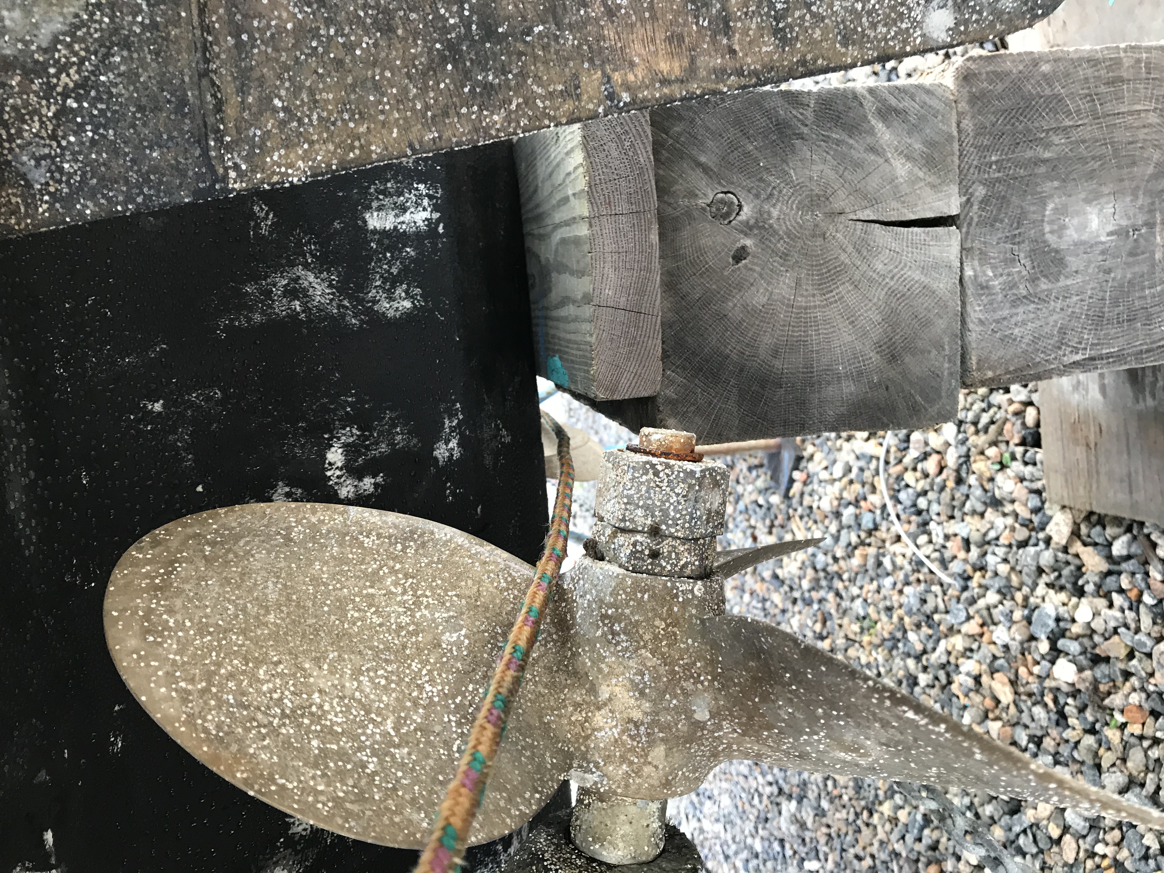

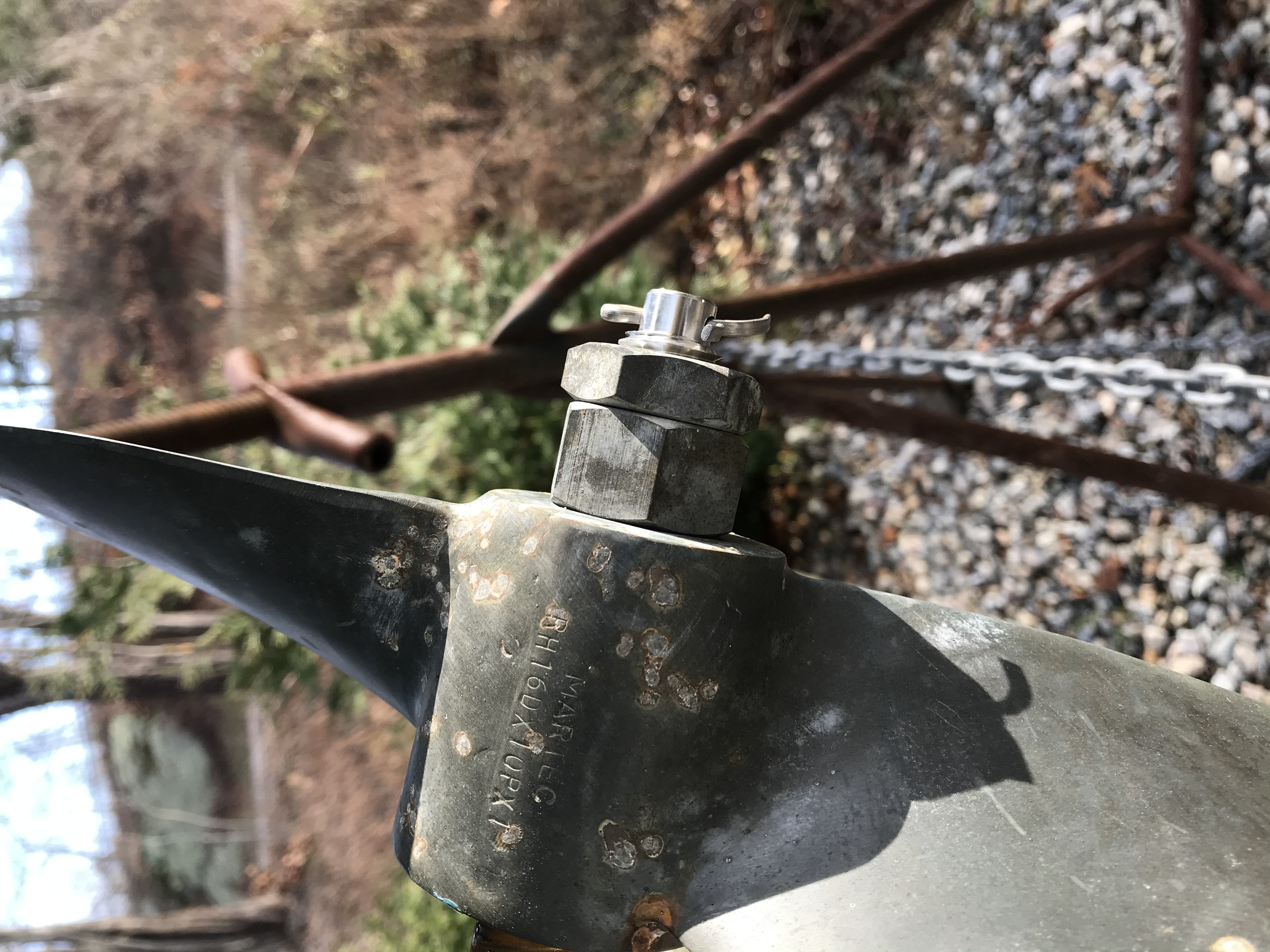

I took three random photos of props today on boats which are hauled close to Orion. Anyone notice any issues with the methods used to secure the props to the shafts?

The first one is corroded enough that it will never come off. The second one looks like a new boat so it must be right. The third one needs a little something more. Maybe bigger barnacles.

Jam backwards on the first, the second the pins are not tight to the shaft so they can snag stuff. The third, is that a c clip or nothing I can't really tell and the jam nut is backwards. Dennis

Also I think there should be a flat washer against the prop. The third needs to bend the cotter pin and don’t see a zinc.
OK, I just looked it up and found that the jam nut goes on first and they have no flat washer.

Steve is correct in that it seems counterintuitive but the proper sequence is the half height nut goes against the prop hub and the full size nut goes on last. I encourage everyone to look at the attachment and take a peek at how your prop is attached to verify it is to standard.
