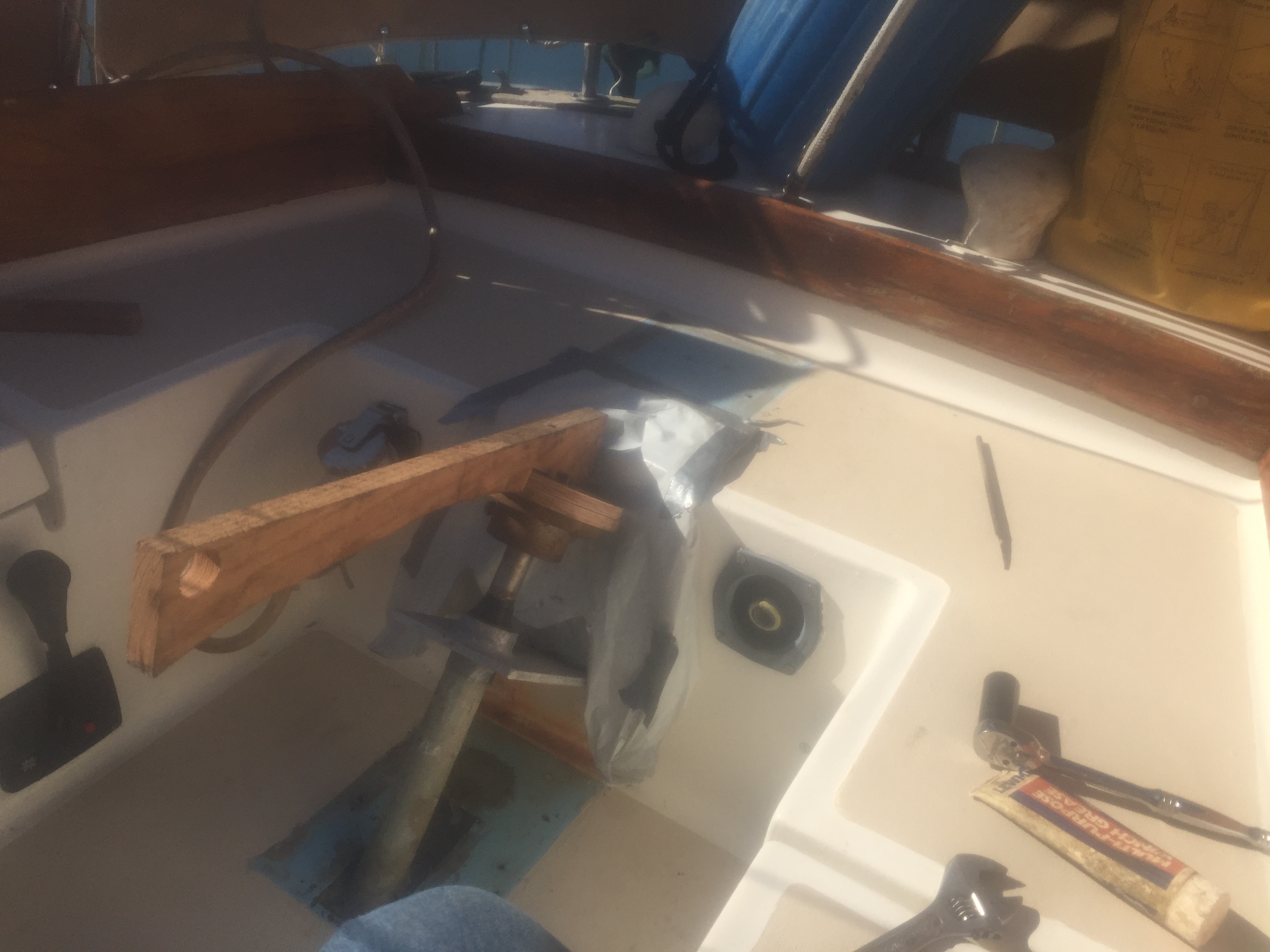

Since the boatyard is so busy and "Leoma" will be disabled for a few weeks I decided to send the worm drive steering gear in to Edson to be remachined . I've been waiting three weeks and haven't heard from them so I called . I was told they bundle all the worm drive gears up to work on in Jan and Feb So they can do all their casting at the same time. I wish they would've told me that before. So I'm putting together a temporary tiller. Here is some photos of a wood mock up. I wonder what I should make the real one with. I don't want to spend much but I don't want it to be too crude. It does have to be pretty Skokum. I know if I ever need it again it will probably happen in rough weather One good thing : I can easily hook my windvane steering to it.
I just ran into a neighbor and he said he owns a machine shop and will build it for me tomorrow no charge . I told him I will help him solve some plumbing problems he's having on his Catalina 30. I thought of bolting a 1" disc to the existing flange and weld a 1-1/2" pipe for the tiller. He mentioned something about carbon fiber. I don't want to get carried away . I don't expect to ever use it again.

Everyone must think I'm really dumb. That's not the tiller. It's just a mock up showing the angle and the bolt pattern that I need.

Axe handles and scythe handles ( called snags) can be converted into very nice tillers.
