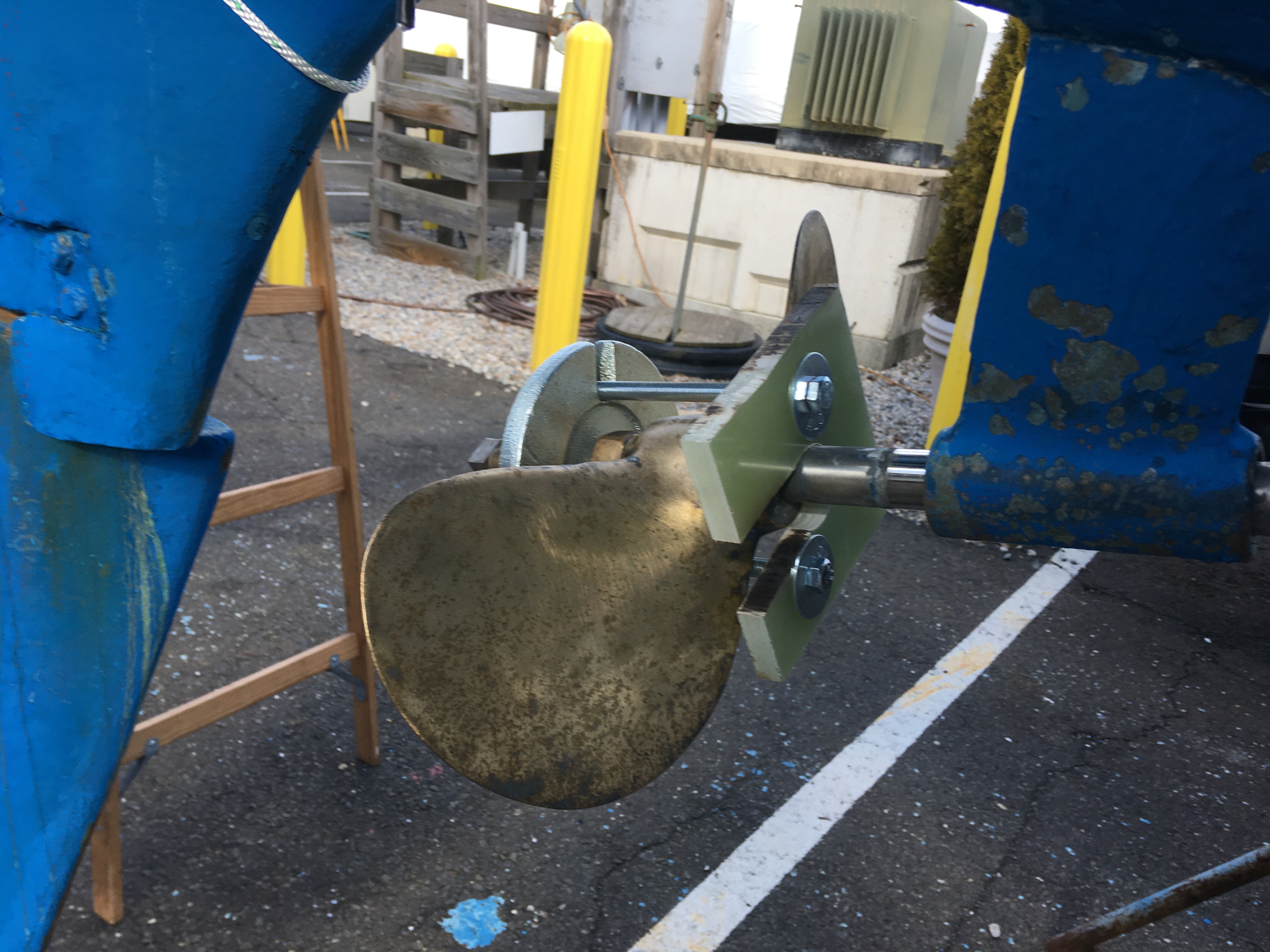

Did the propeller puller shown in your picture work?
I tried a similar one on my prop but it wouldn't budge.
And I tried a homemade one (see picture) but it failed also.
Different boat, different prop but just curious as to how it worked.
Ken Easley
