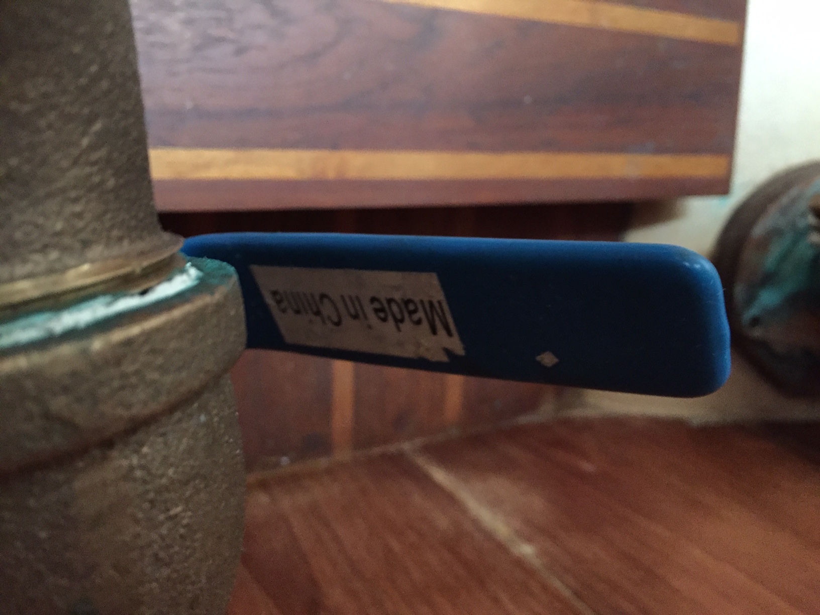

I went to check on my Typhoon Senior at the marina today since the temp was an uncharacteristic 55F for mid-Jan here in Southeastern MA, and when I looked closely at the seacocks discovered that they were Buck Algonquin bronze ball valve seacocks made in China. I'm going to go out on a limb and guess they were selected because they were less expensive than quality domestic alternatives such as Spartan. Does anyone have direct, first-hand experience with these seacocks? Are they any good (i.e., will they last)? As a critical piece of equipment that could cause a boat to sink if it failed, I wouldn't hesitate to spend money to replace them with a more reliable seacock if the group consensus is that there are better alternatives out there. Thanks! JD

As noted in the attachment I had identified the brand. I have no experience with that particular brand of ball valves, but Buck Algonquin does not market poor quality products. I would have no issue with then on an overnighter but I would want them properly installed.

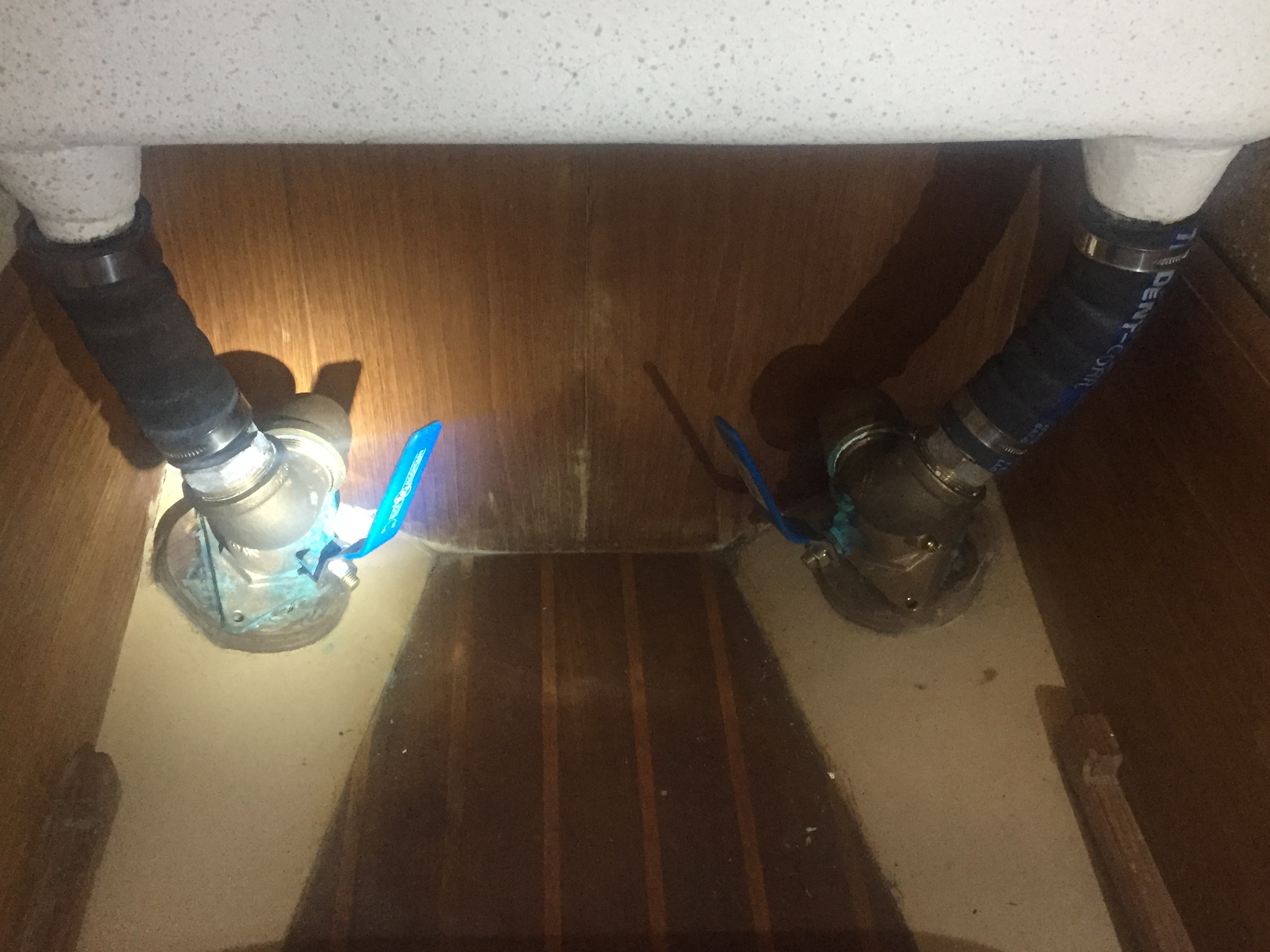

To Jims point of being properly installed. I notice that they are not bolted thru the hull. You might want to remedy that situation.

Yes the plan is to reinstall them to correct several deficiencies seen in the current installation. Given that, my thinking is that would be a good opportunity to replace them if there are better alternatives to consider (of course that gets into the ball vs. tapered cone etc. seacock arguments). To me, this isn't a part to cheap-out on - I want the most reliable seacocks for peace-of-mind even if that means paying more for them. Within the most reliable group, those requiring less maintenance would be nice. I've edited my original post to seek input from members who have direct, first-hand experience with this brand and type of seacock, and how they compare to traditional choices like Spartan.
