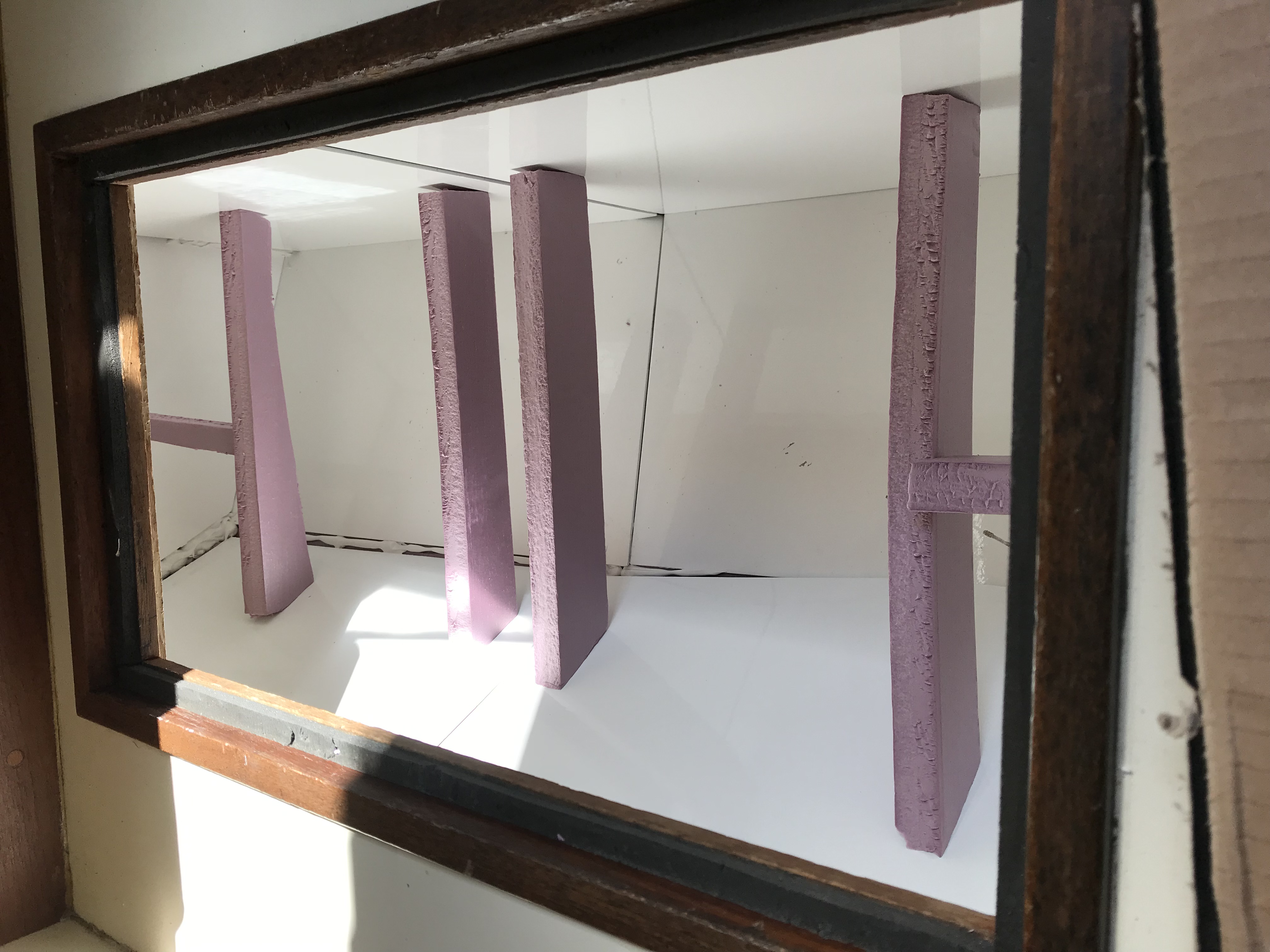

I purchased a sheet of 1” closed cell foam from Home Depot and spent a couple days lining the inside of my icebox, through the top loading hatch, and I had to resist any urge to bend any piece since the final fiberglass liner was essentially incapable of taking any bend at all unless I was going to introduce mechanical fastenings....which I wasn’t. It took a lot of finessing since the inside of the box had no straight flat surfaces. When I was done it was faceted....nothing but straight flat surfaces of foam awaiting the fiberglass outer layer. Any voids between the new closed cell foam and the curved surfaces of the ice box were filled (to the best of my ability) with pieces of closed cell foam shaped with a wood rasp and lots of cursing.

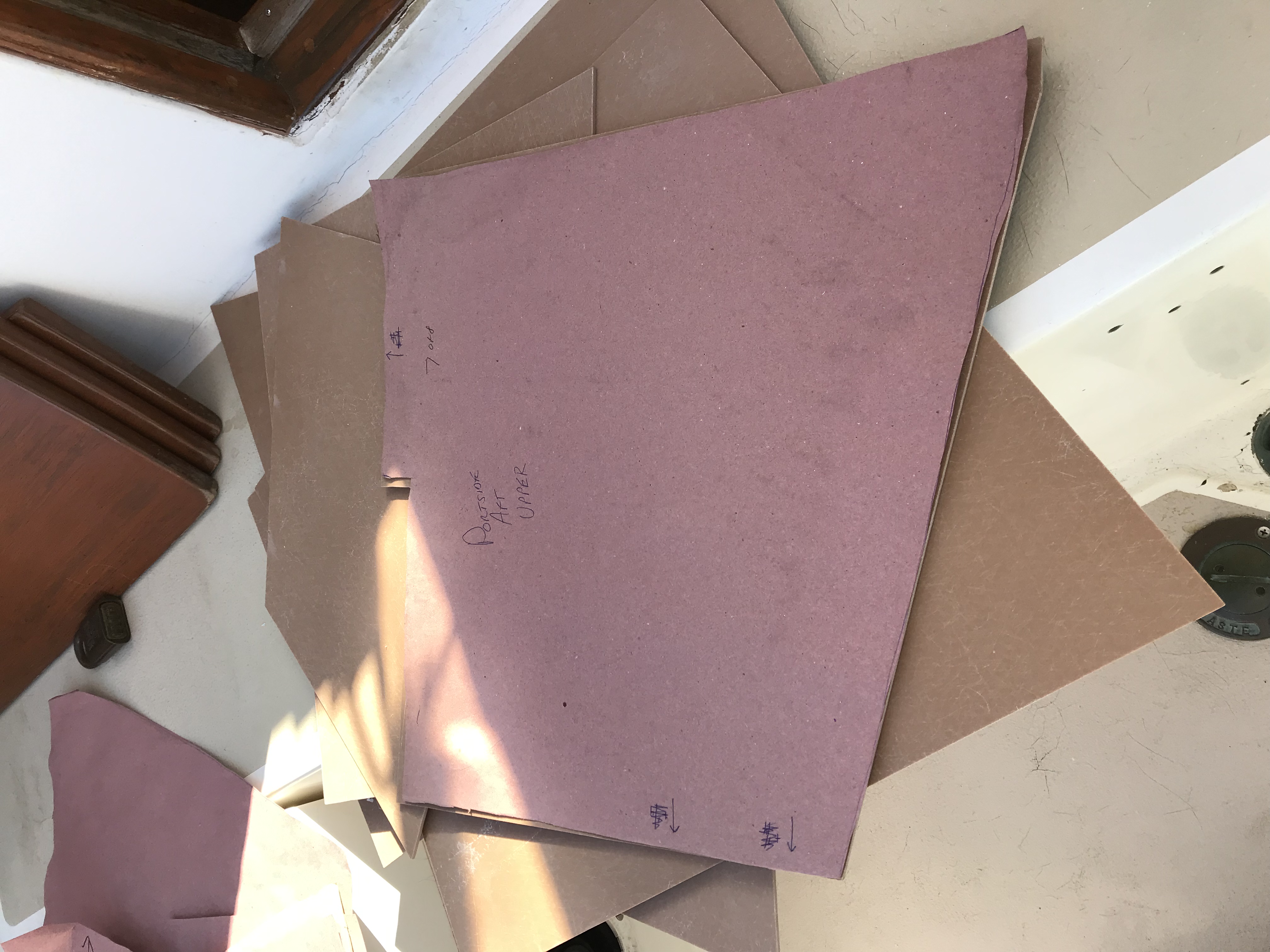

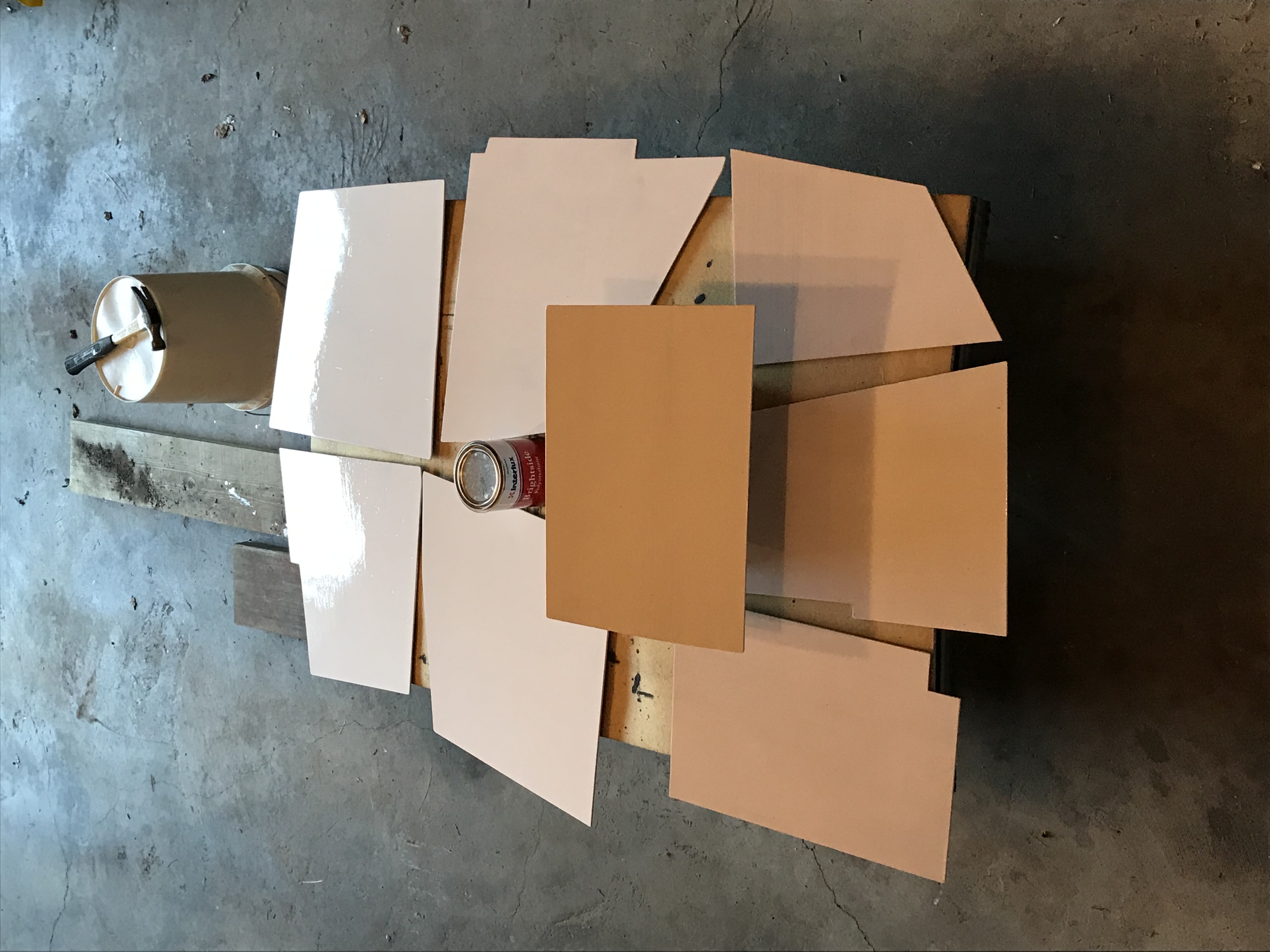

Now that the foam board was in place I made patterns out of rosin paper (the old hardwood floor underlayment) and I brought those to LBI to purchase a sheet of their 3/16 GPO1. I had heard that if I supplied the patterns they could water jet my material. It was a bit pricey but I had them water jet my material to the patterns I supplied and I only had to lightly trim two of eight pieces for an exact fit. In my case exact fit is a euphemism....I’m not skilled or talented enough to put “exact” to practical use.
I took my fiberglass pieces home and applied two coats of Interlux Brightside. Next I used a notched trowel to spread 4200 Fast Cure onto the pieces and pressed them into place. I wanted some squeeze-out between the pieces and it varies from “some” to “lots”. I cleaned up what I could but there is a point where you go from making something neater to making something worse....I was indeed pressing the envelope. I used odd scrap pieces of the foam as props while the 4200 cured overnight.

- Rosin paper patterns and 3/16 glass panels
- 3EF5DC7A-DC5D-4600-BD87-543C7CA9F4E6.jpeg (2.18 MiB) Viewed 1834 times
- Panels painted with Brightside
- 0DCE4449-2A2D-4B3B-93F2-A821A863AFA8.jpeg (1.78 MiB) Viewed 1834 times

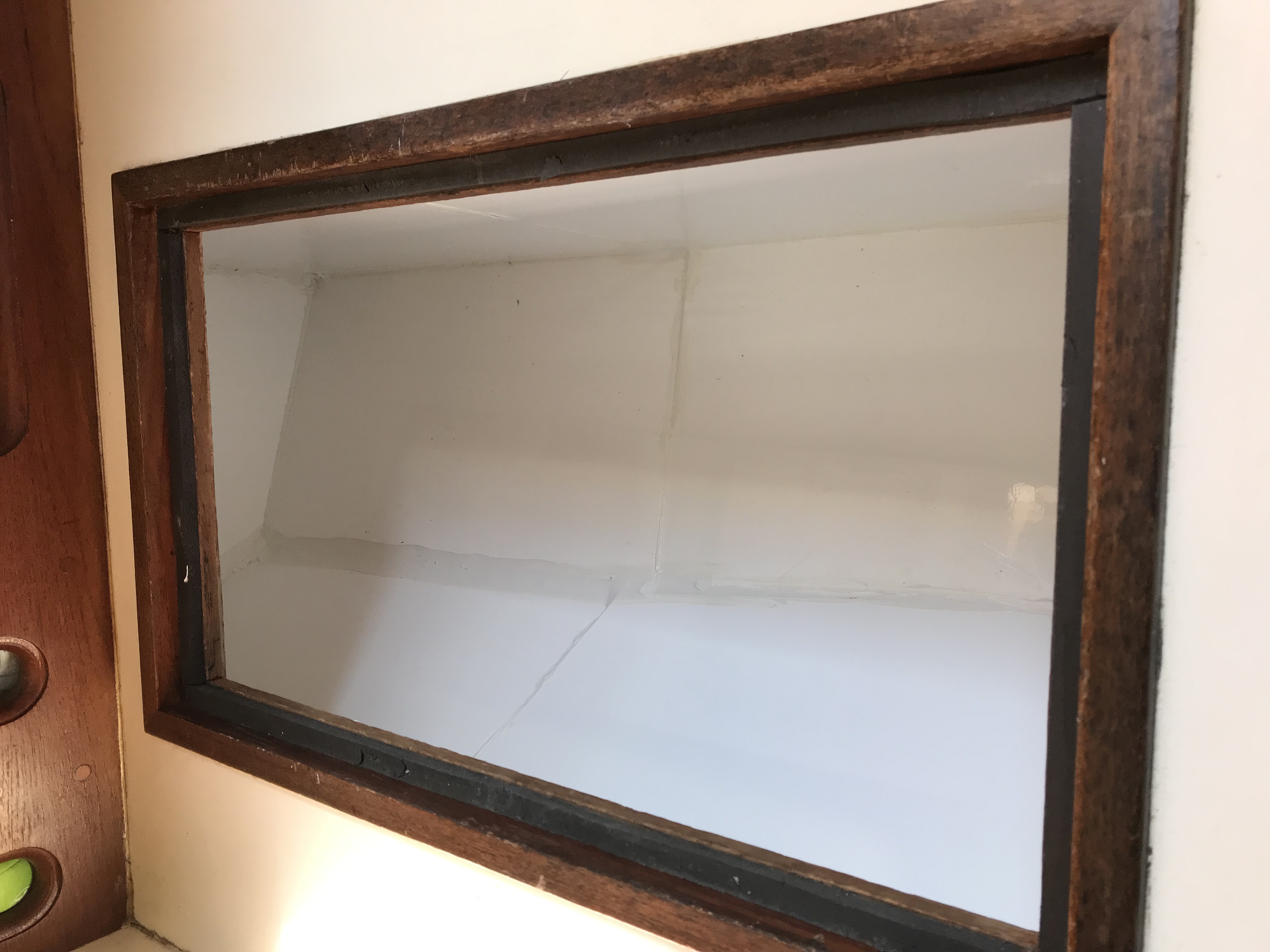

More pics.
- Reinsulating and relining icebox complete.
- FA59FC8D-90B5-49DE-9B58-71698FEB801F.jpeg (1.78 MiB) Viewed 1833 times

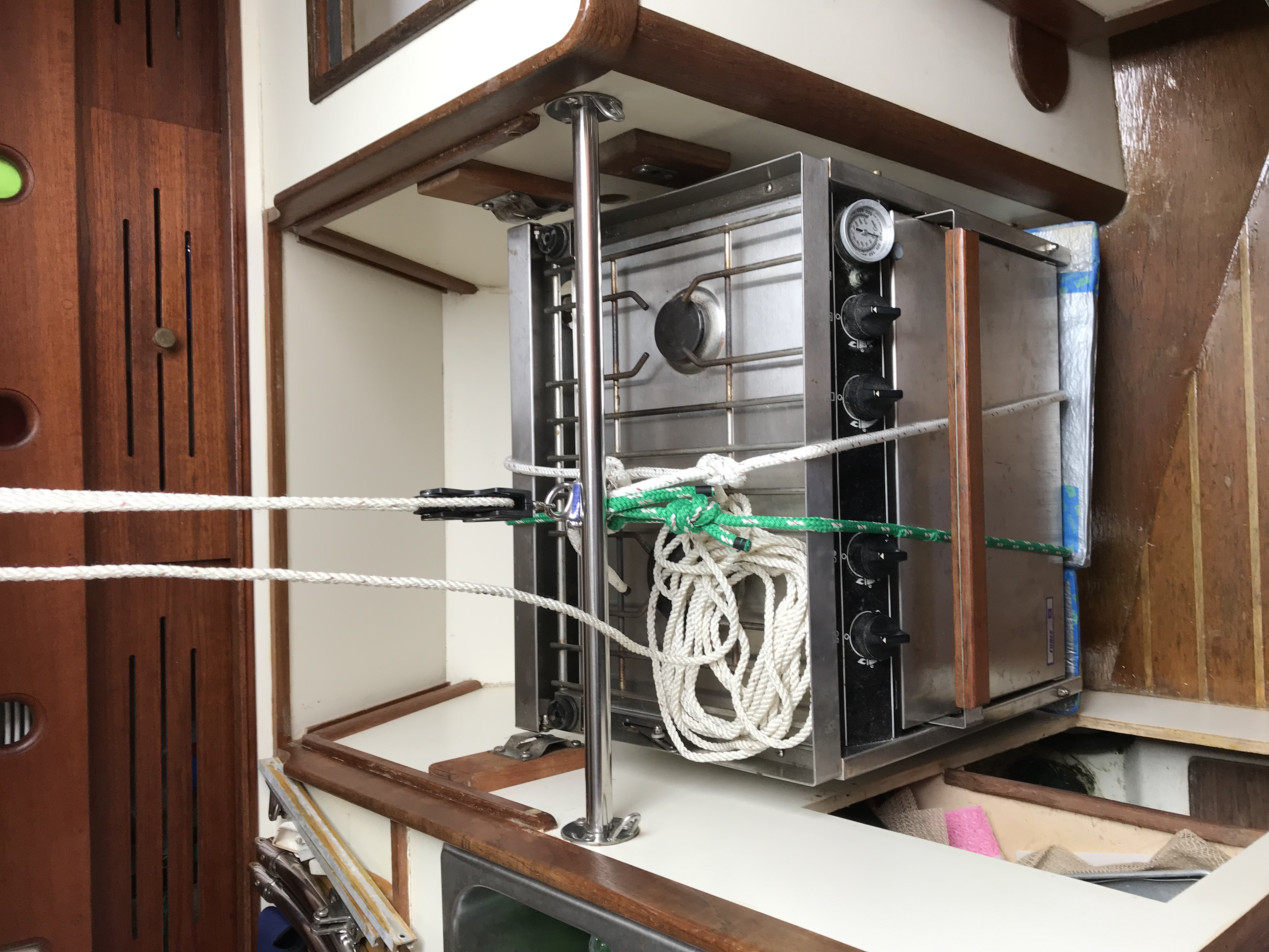

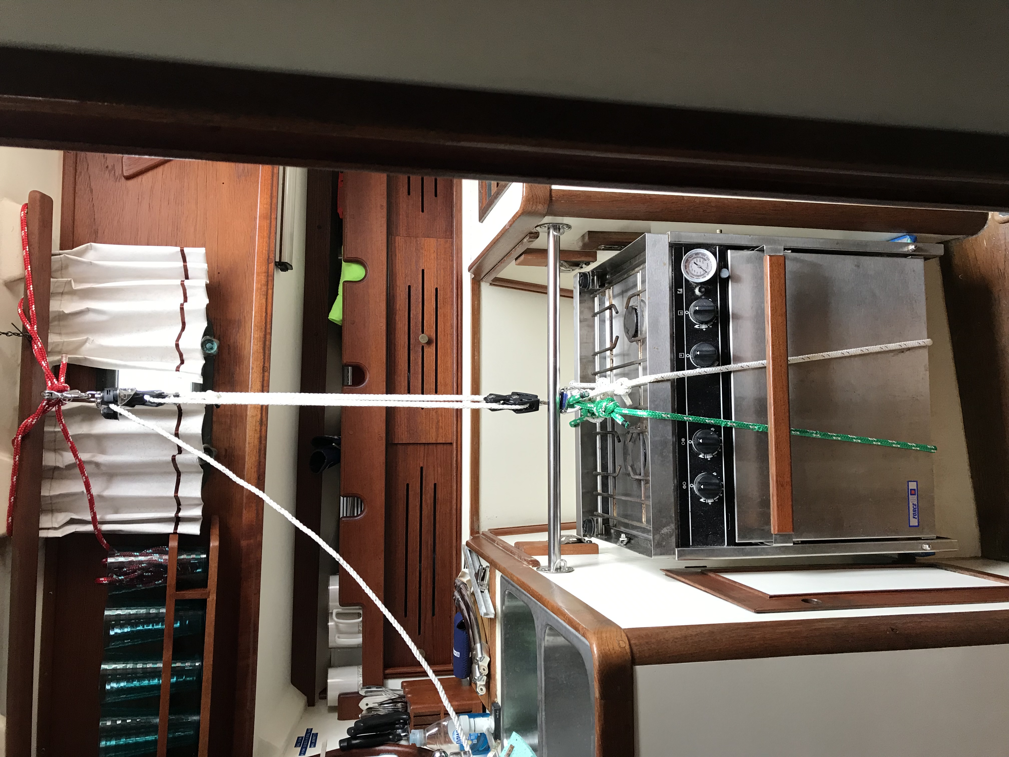

- 4 part tackle used to lift stove off gimbal.
- 1B305C36-5D12-48BB-9917-EDE88779D620.jpeg (2.8 MiB) Viewed 1833 times
- Stove moved as necessary to run evaporator lines.
- 7AB05B9D-E159-4691-85FF-5CC9A765A362.jpeg (2.68 MiB) Viewed 1833 times

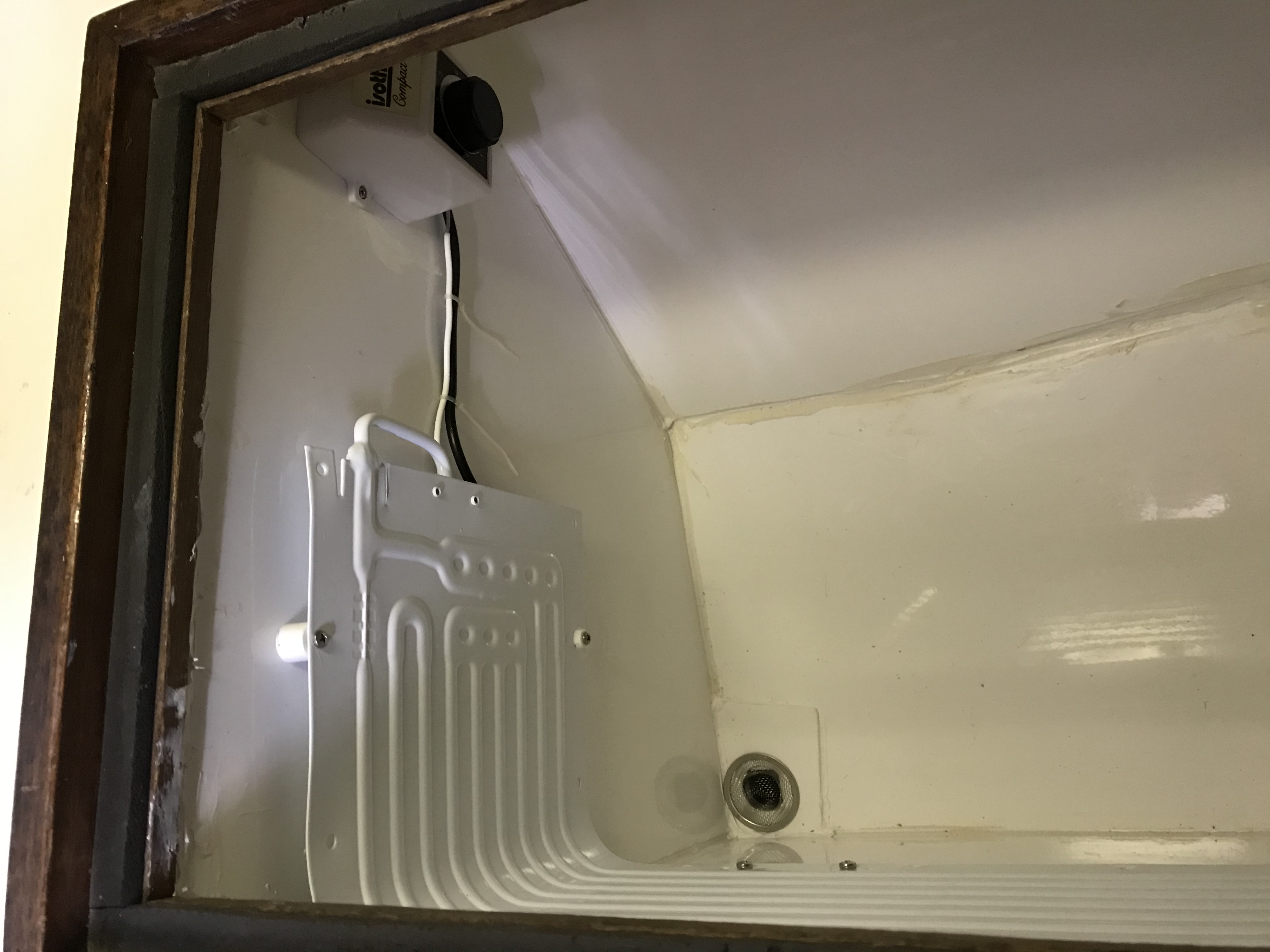

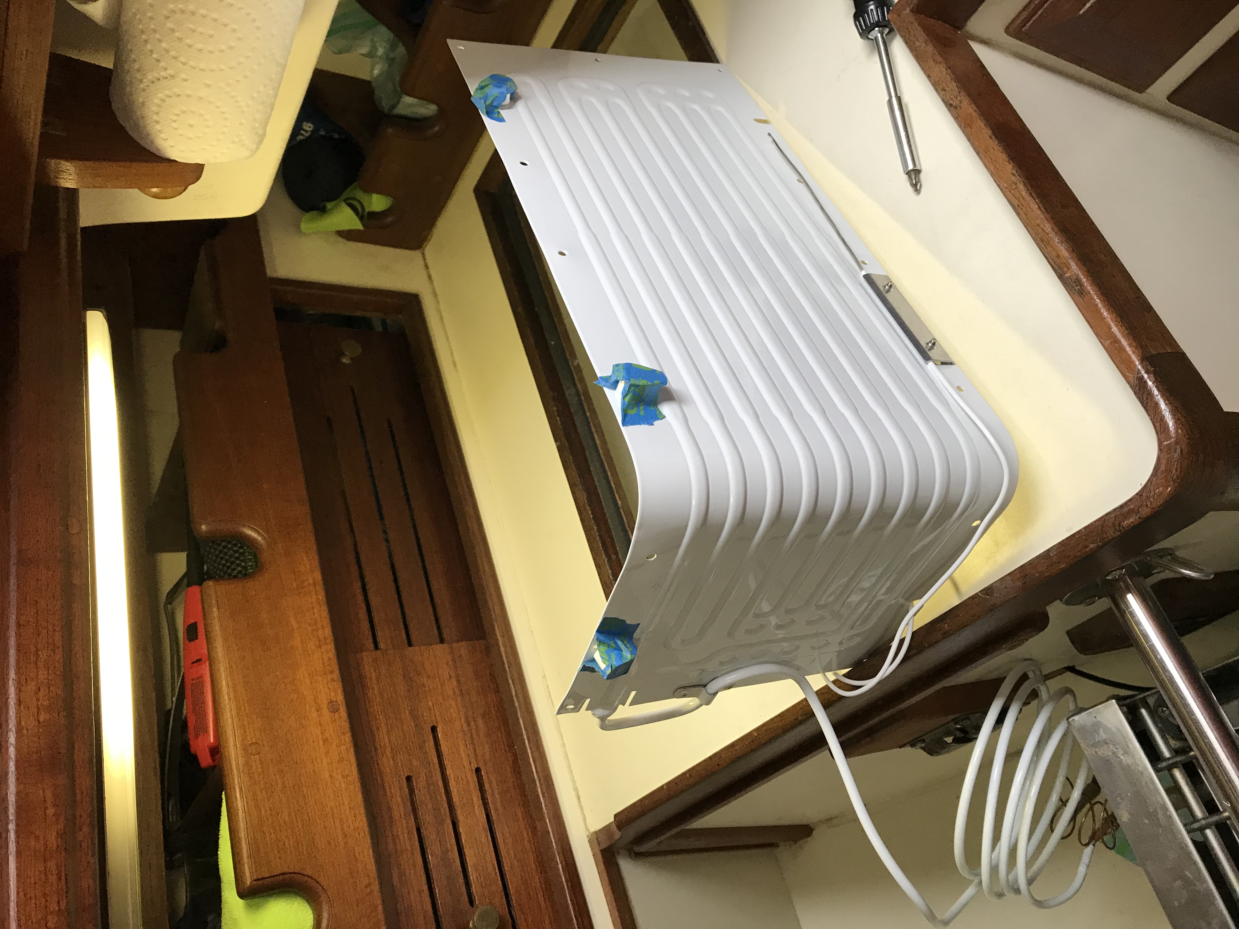

- Evaporator ready to install.
- B1C8D1E2-3860-4416-9D09-6645D638F668.jpeg (2.65 MiB) Viewed 1833 times
- Evaporator installed.
- 157DD973-9450-432A-91A0-DDE4E819FE22.jpeg (1.71 MiB) Viewed 1833 times

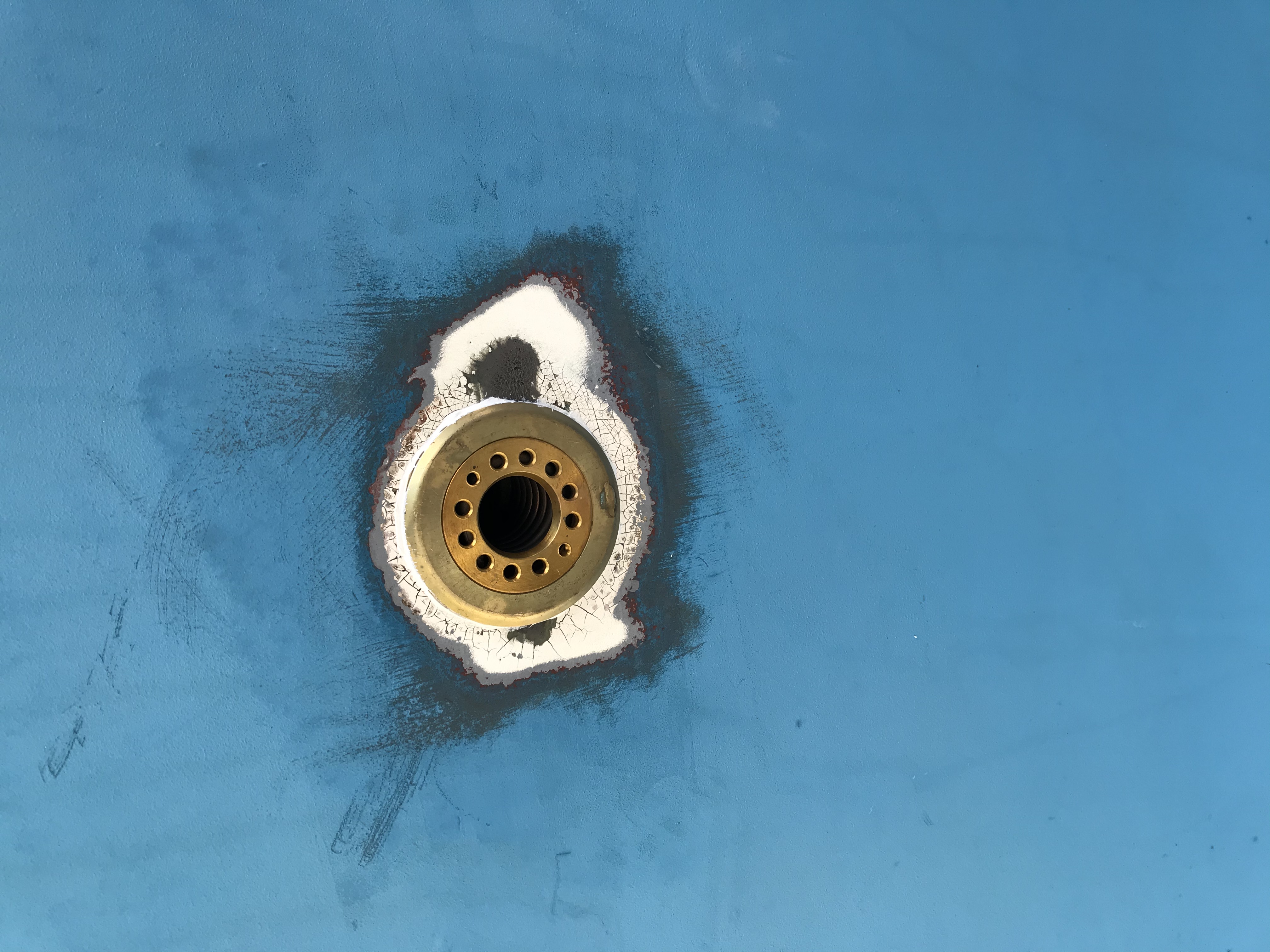

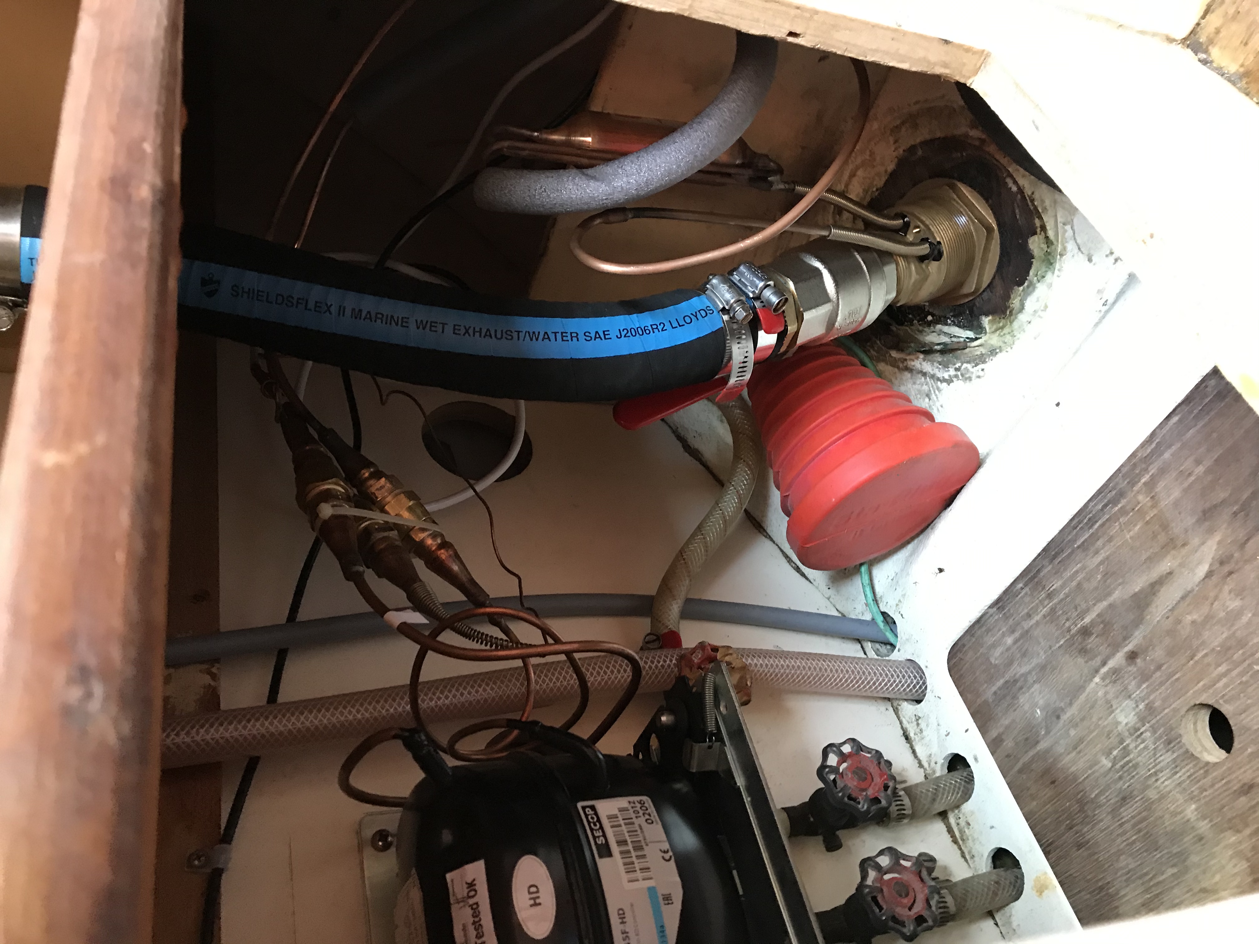

- Seacock and throughhull removed as one unit.
- 74C6AA39-1DA1-4027-8317-9CE6493556A4.jpeg (2.88 MiB) Viewed 1833 times
- New “heat exchanger” throughhull installed.
- 72BEAF02-B113-461C-A7D3-74CB6A6D9F50.jpeg (2.59 MiB) Viewed 1833 times

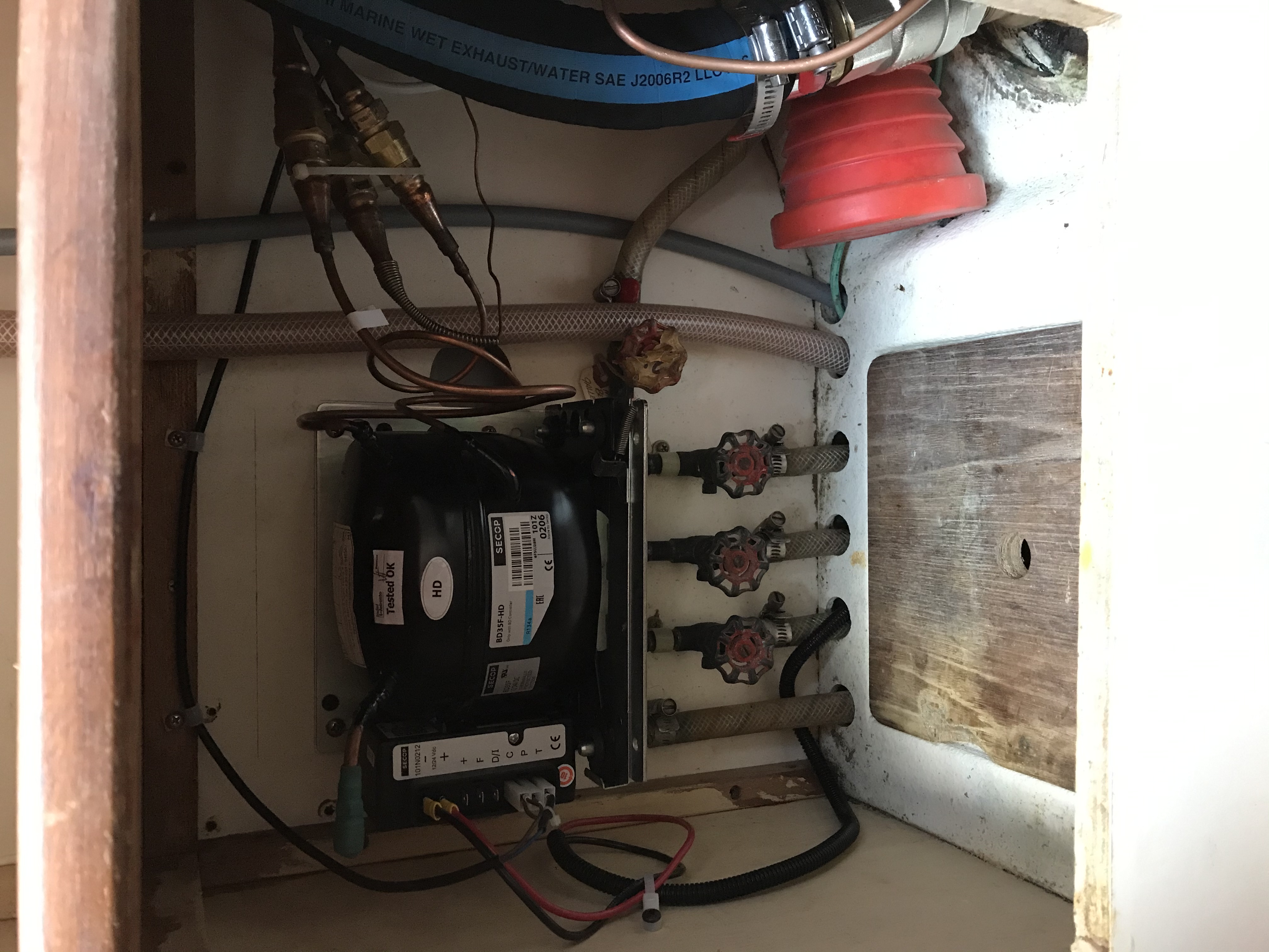

- Compressor, new throughhull, new ball valve seacock, and new sink drain hose installation complete.
- E0F4F86C-82C5-46E9-9CEB-1BCC78254293.jpeg (2.29 MiB) Viewed 1833 times

It’s the same compressor used on the air cooled models, just lacking a small fan. Testing it out of the water it hit 3.9 AH for short periods then it went to zero. Once the box has something in it and it’s in the water in use for a few weeks I’ll have some real info.John Stone wrote:Nice work Jim. You made a hard project about as reasonable as possible.
I’ll be interested to know how well it works and how many ah per day to the u it uses when you are in Bermuda. The compressor looks very small. Is that because it’s water cooled?
Thanks for posting.
- Better photo showing the compressor in actual use.
- 94DCEE01-D775-4A20-8498-37B34B343639.jpeg (2.21 MiB) Viewed 1823 times

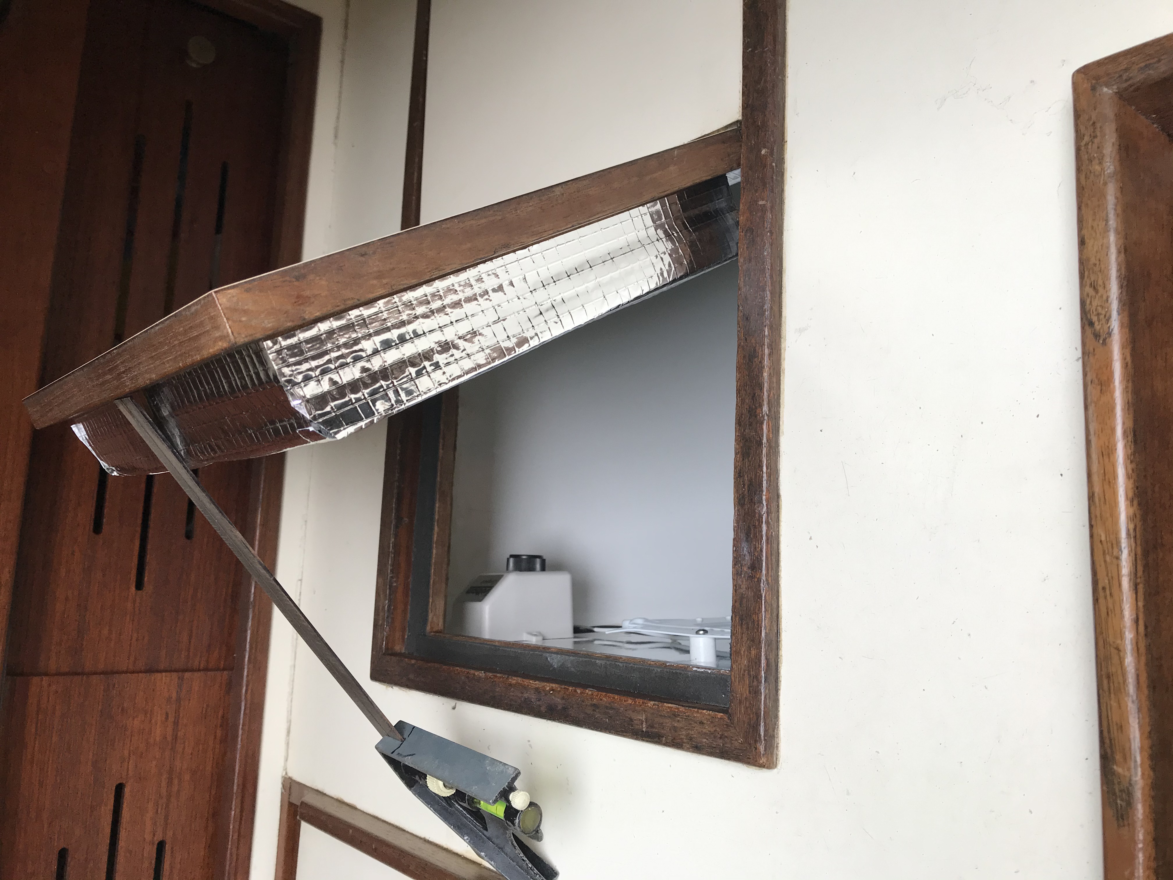

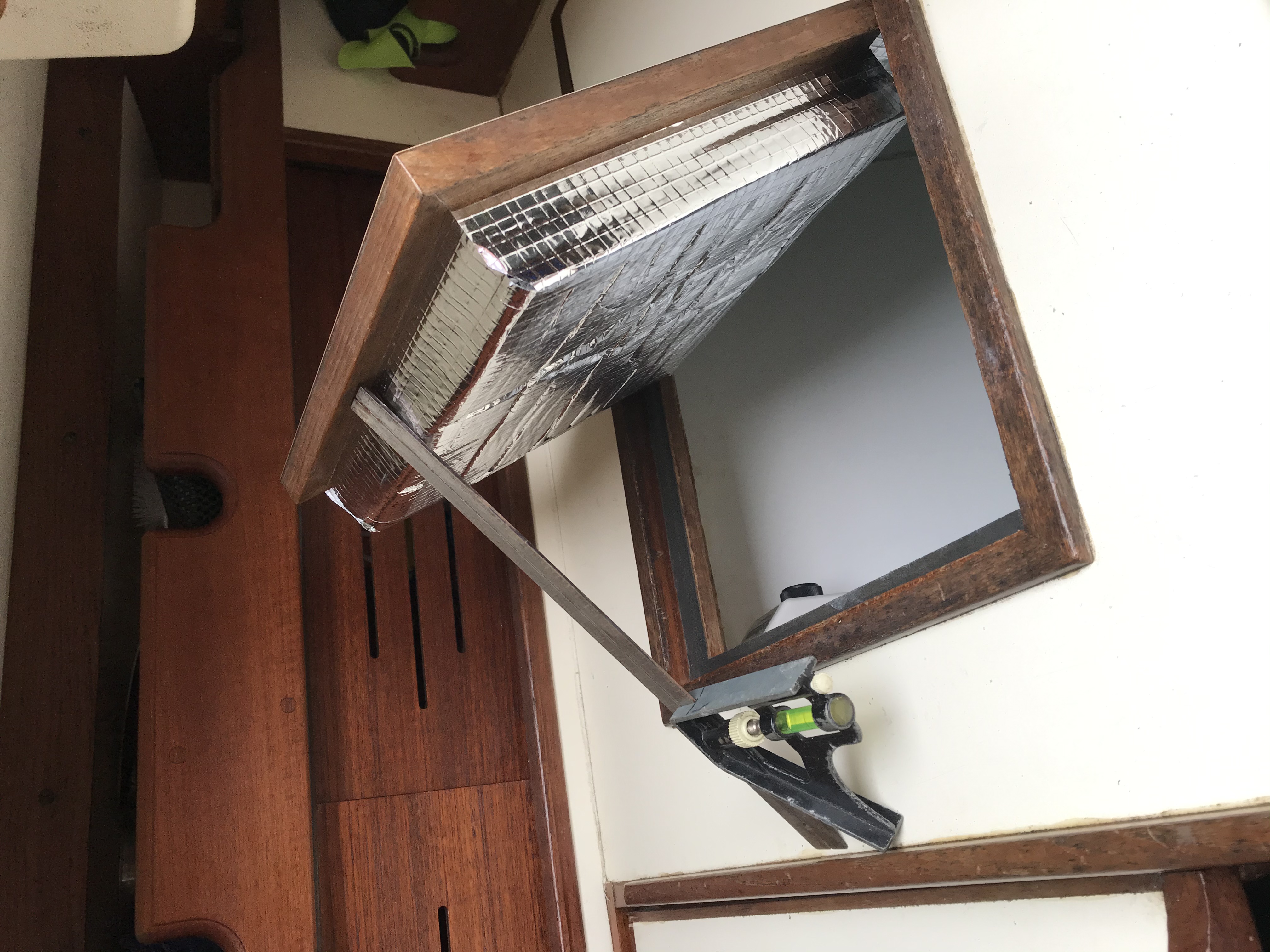

Finally got around to insulating the lid. I wanted to retain the original so a major modification was not considered. I thought of using the same closed cell material I’d used to insulate the box but covering it with fiberglass would have added too much weight. A friend had just added some insulation to his engine compartment with some very light sandwich type material that he said is very effective. I asked if he had any left over....I needed less than two square feet...and he said yes. He was kind enough to offer his remnants and the tape he had left.
It was a simple matter to cut a couple rectangles out and I used 4200 to glue them to the lid. The next day I taped the edges.
I’ll find out how they perform next summer. If nothing else, I’ll have the quietest fridge in the fleet
- Lid insulation.
- 16F33ABF-B4B7-4461-86FD-31559DEB6D4A.jpeg (2.54 MiB) Viewed 1761 times
- Lid insulation.
- E91835F0-82CC-44EA-93D1-B90F3AB5D0F9.jpeg (2.34 MiB) Viewed 1761 times
