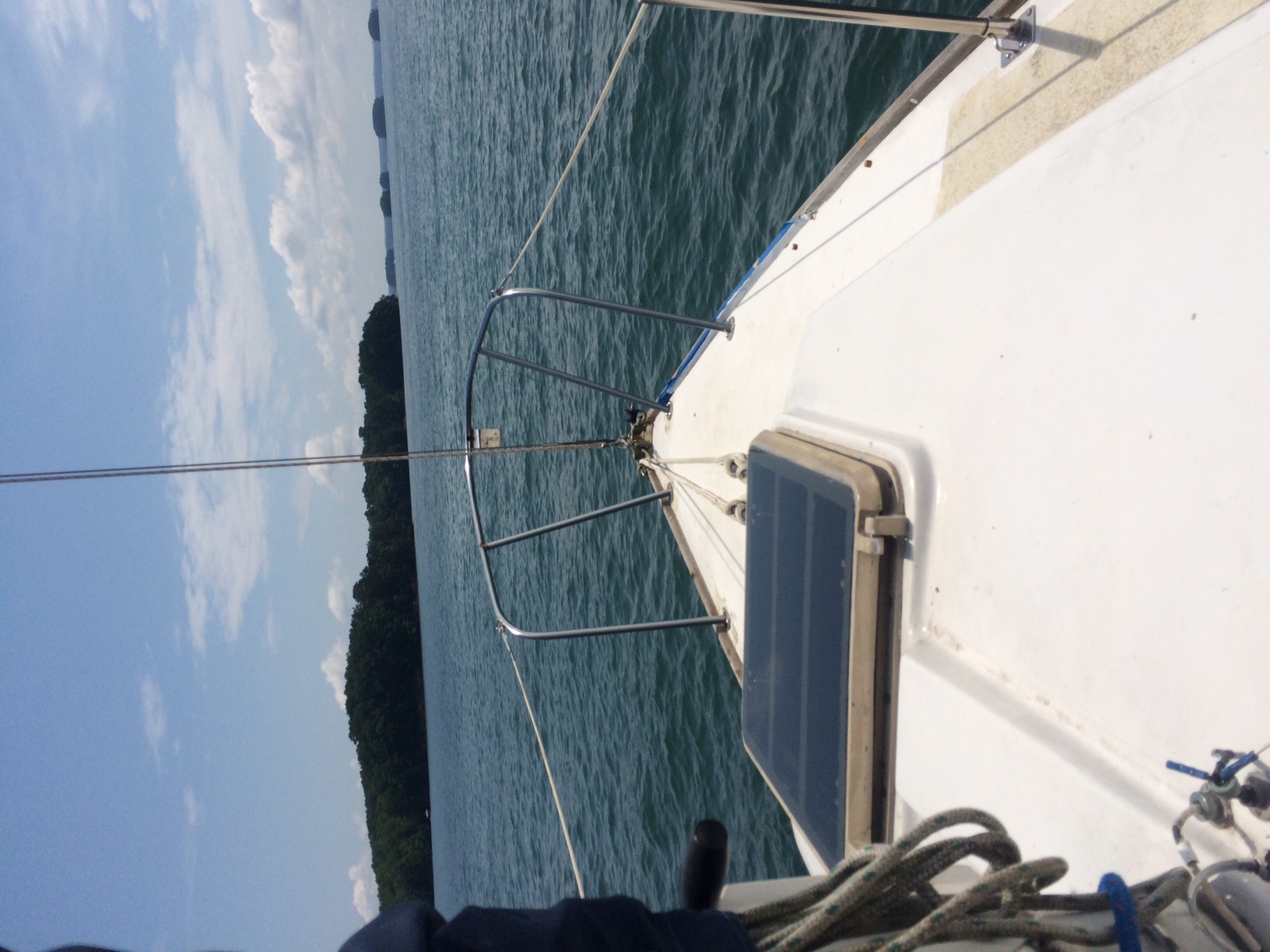

So I am a relatively new cape dory owner having bought Glissade last year from another Cape Dory Board member. As such, I am still learning and dealing with the repairs associated with my learning. In this case, I damaged and bent the Pulpit when returning to the dock earlier this spring. This required a little tube bending and welding to repair. As it bent, one of the feet of the pulpit damaged the fiberglass deck. I cut out this area and found wet core.

- I have removed the pulpit for repair
- IMG_0501.JPG (922.61 KiB) Viewed 1494 times
