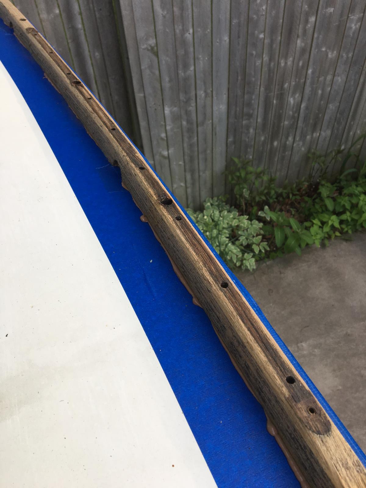

My spring pre-launch project to rebed the toerails on my Typhoon has metastasized and is now encompassing other parts of the boat. I'm rebedding the toerails because I was getting water leaking down through the mounting screws. Once I had the rail off, it turned out that these had been replacements, and the holes for the old rail had been filled with wooden dowels, which had mostly rotted away and were probably causing most of the leaks. I drilled those out and filled the holes with epoxy.
Then, I squeezed myself back into the seat locker to tape off the nuts for the genoa track (so that they didn't fall down between the hull and liner--ask me how I learned that trick) and while I was there I poked my head back into the lazarette area and noticed that one of my stern cleats was missing a nut. Whoever installed it used bolts that were about 1/2" too short, so one nut had already come loose and fallen off, and the rest were about to do the same.
I pulled the cleat and sure enough, the installer had also not done anything to seal the core around the holes. Luckily they were still dry but since I was in there it seemed like a good idea to take care of that problem. Dug out some core and filled the hole with thickened epoxy, so the next step will be to re-drill and re-mount the cleats.
While I was at it, I addressed another stern issue. A PO had installed a traveler and removed the factory mainsheet blocks. Those holes had been patched properly, and the filler (whatever it was) was coming up. I redrilled those and it looks to me like the core here was also unsealed, likely from Cape Dory. So if you've never pulled your mainsheet blocks, you might want to do that and make sure your core isn't getting wet!
In order to get the toerails off, I had to unmount the bow pulpit. Now that it's off, I think I might leave it off, so I filled the holes. I'll sail without it this summer and see how I feel.

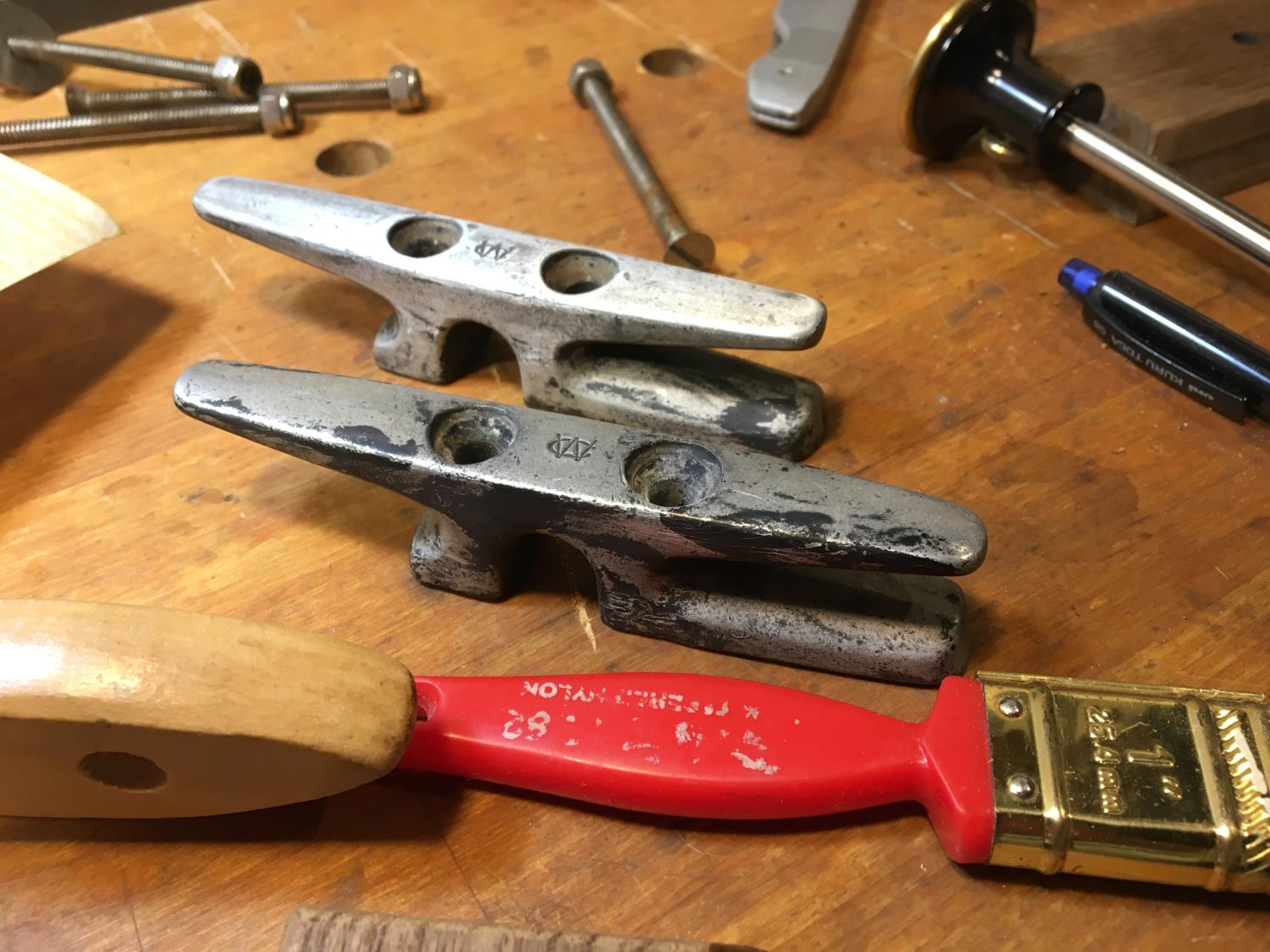

Lastly, I pulled the two cleats that were mounted to the cabin top. They're Wilcox Crittenden Marinium (aluminum alloy) cleats that have long ago had their anodization worn away. I'm going to sand off the remaining coating and just go with bare aluminum. Should be a big cosmetic improvement!
All this fiddling around is delaying my launch, but I'm going to feel much better about the state of the boat when it's all done.

I made some good progress yesterday! With the help of a friend, I got the toe rails re-installed on the boat, well-bedded in some teak-colored Life Calk.
I still have to plug the holes and remount the track for the genoa lead. How would the board recommend I go about doing that? It doesn't look to me like the previous installation had any sealant under the track or its fasteners. That would be easy enough to replicate, but is it the right way to do this? Should I bed the track in some caulk? How about the machine screws that hold it down?

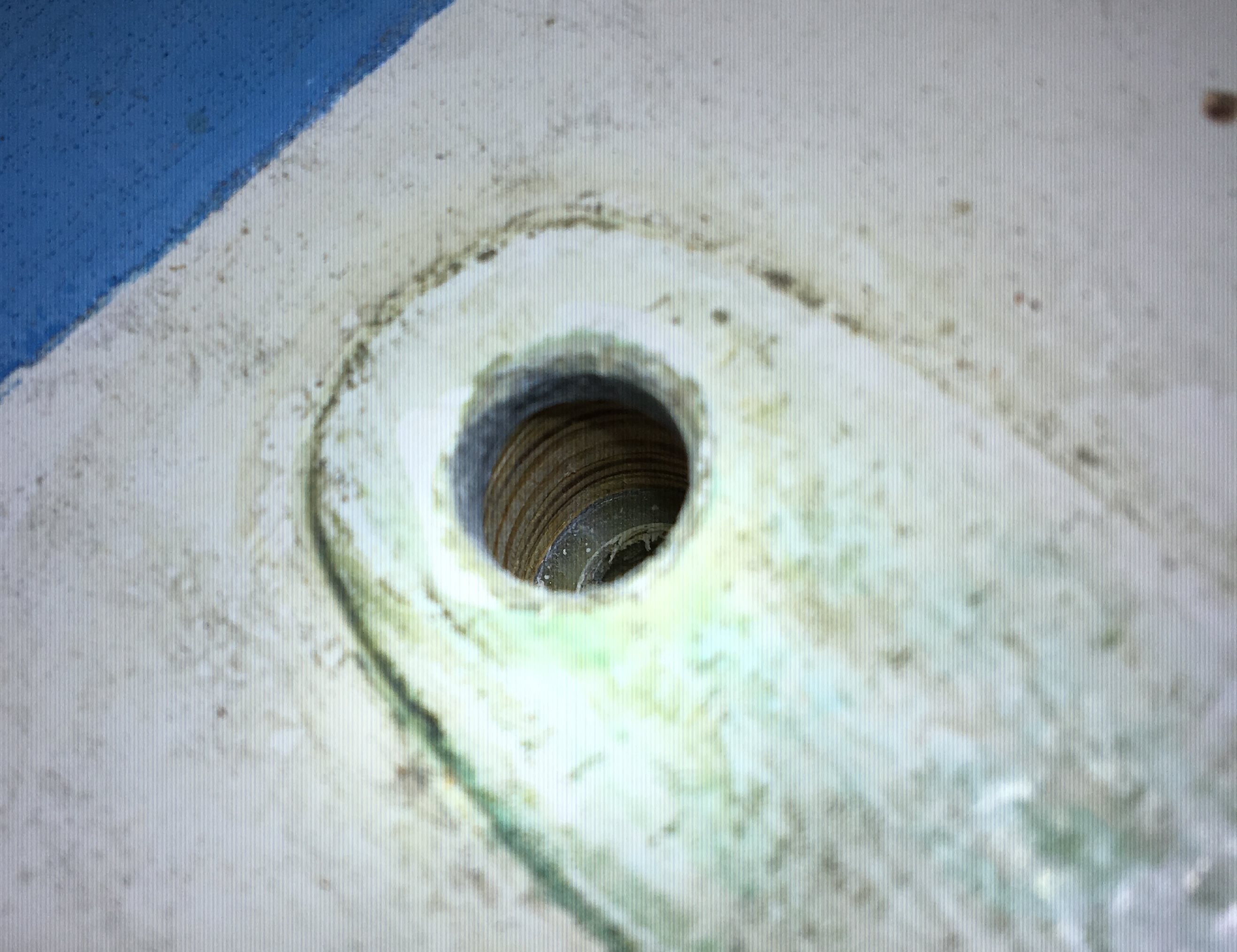

Continued adventures with my deck hardware! I decided this spring to do some more re-bedding. I haven't found any wet core yet, but I've found plenty of dry crumbly sealant, so I'm sure I'm saving myself (or someone) trouble down the road.
I pulled the foredeck cleat, mast step, and the two cabin-top jib tracks. I'm digging out the core and potting the holes with epoxy, as detailed in Maine Sail's how to.
One thing I thought was interesting was that the foredeck cleat has different core material in the aft mounting holes than the forward ones. Aft is plywood: Fore is balsa: Not something I'm worried about, and they're all well-sealed with epoxy now, but I will take care not to gorilla down the forward bolts too much.

I've had the same with an aft cleat. It appears that they inserted plywood to strengthen the deck for the cleat, but then missed the mark when installing the cleat (or maybe the plywood).Ben wrote:One thing I thought was interesting was that the foredeck cleat has different core material in the aft mounting holes than the forward ones. Aft is plywood:
Your comment about not to gorilla down makes me wonder if there is not a backing plate underneath?

There's some kind of reinforcement built into the deck. I'm not sure what's under that bump, and I've already filled in the holes with thickened epoxy, so I've kind of missed my opportunity to see what's in there. I'm guessing some extra layers of fiberglass?hilbert wrote:makes me wonder if there is not a backing plate underneath?
