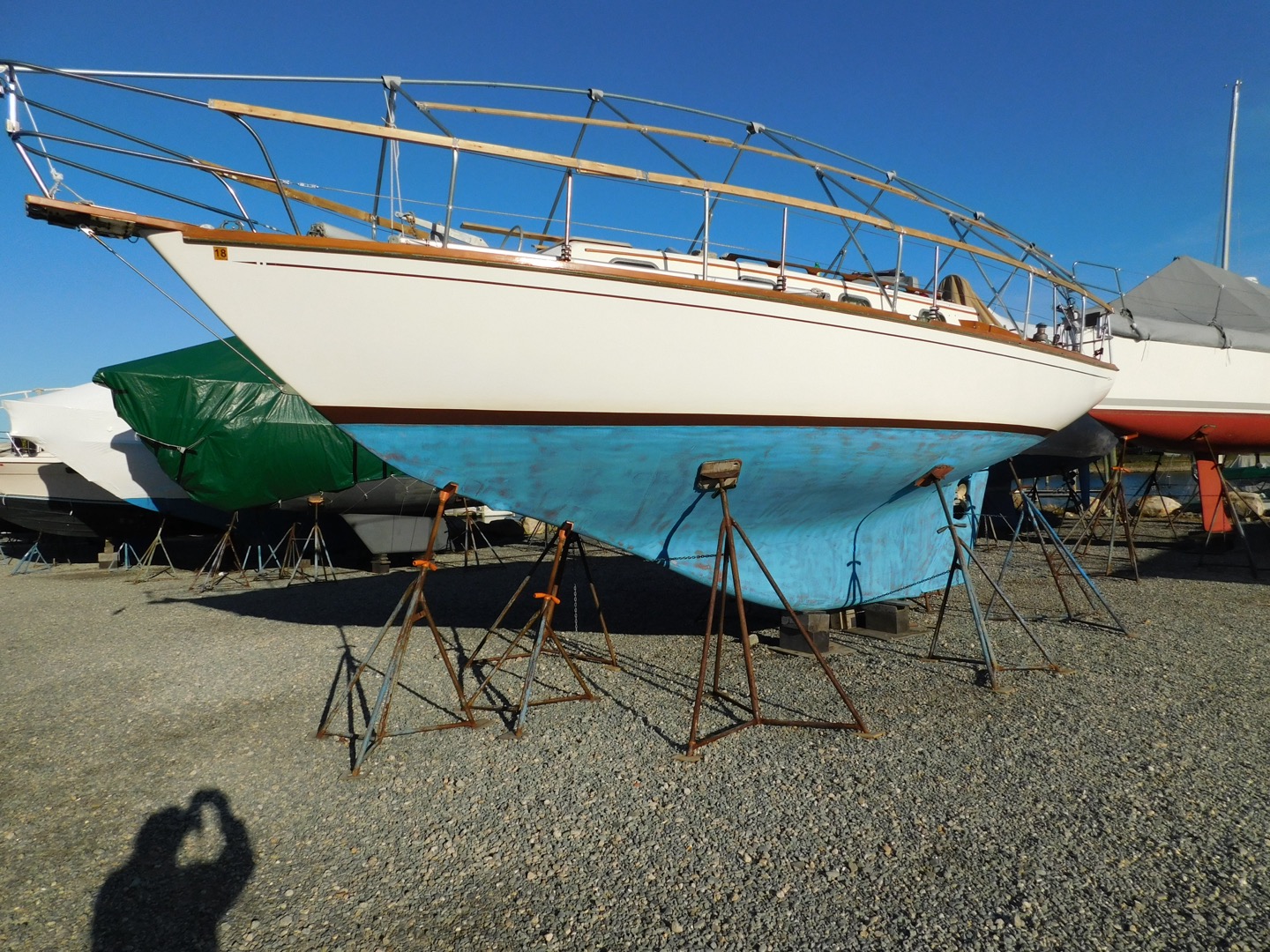

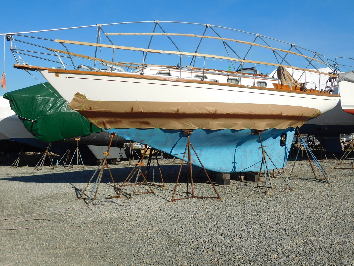

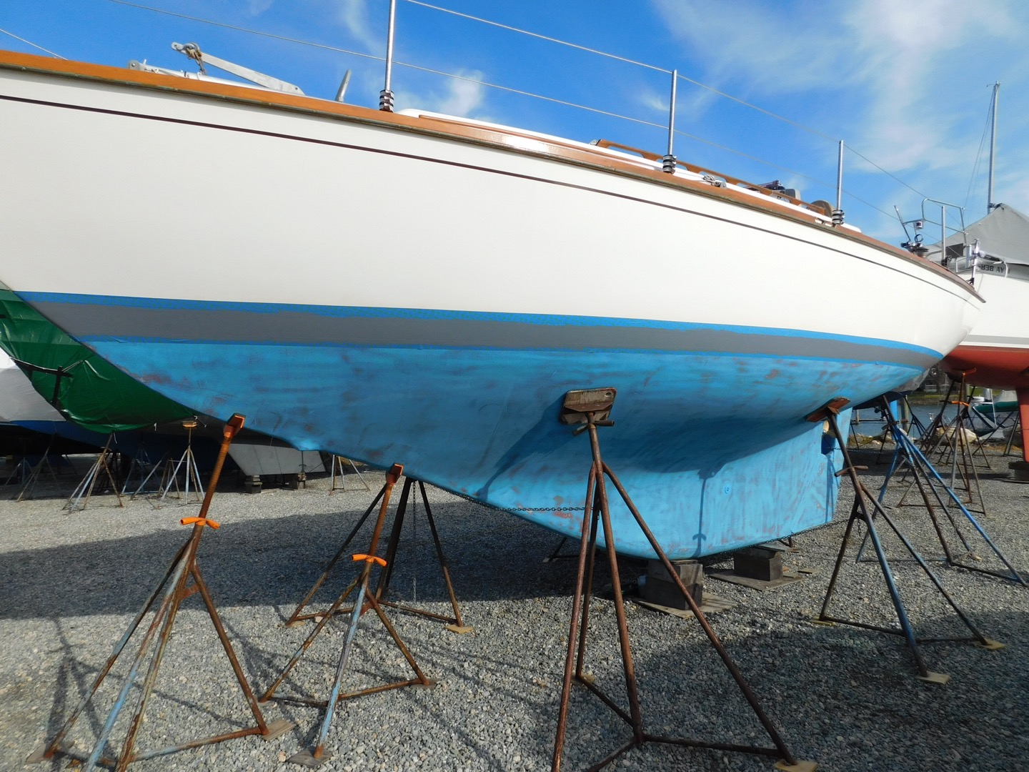

I masked above and below the boot top and used an oscillating tool with progressively finer grits to remove all of the existing paint. I then wiped the area down with mineral spirits. Next I masked 3" above and 2" below the boot top in preparation for primer application. The primer used was Interlux InterProtect 2000E. It was applied with a small roller. Three coats have been applied. Next I have to sand the primer with 320 grit paper to obtain a perfectly smooth finish. That will be done in the next couple days.

- This was the starting point. Ablative boot top paint.

- The result after many hours spent with an oscillating tool and progressively finer grit sandpaper.

- Three coats of InterProtect applied with a roller. The masking tape won't be removed until I finish sanding smooth with 320 grit paper.

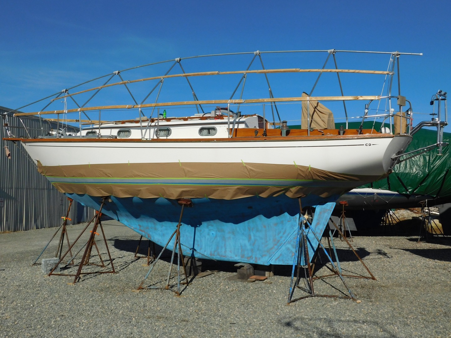

Done! Since this project was completed outdoors the weather was the controlling factor. The temps were in the mid 40s but the breeze was very light today. I helped the painting pro mask the boot top and watched as he sprayed three coats of sable brown AwlCraft paint.

- Boot top masked and ready for the AwlCraft application.

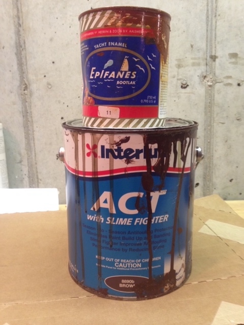

When I purchased MOON DANCE 8 yrs ago the boot top and bottom needed a lot of work not to mention everything else. I'm not as fastidious as Jim but the results work for me. Here is what I use for paints. I choose them more for the color than the manufacturer. Both have worked out very well over the years.
- 2018 Launch.JPG (139.58 KiB) Viewed 703 times
- Bottom & Booot Top Paint.JPG (112.68 KiB) Viewed 703 times
