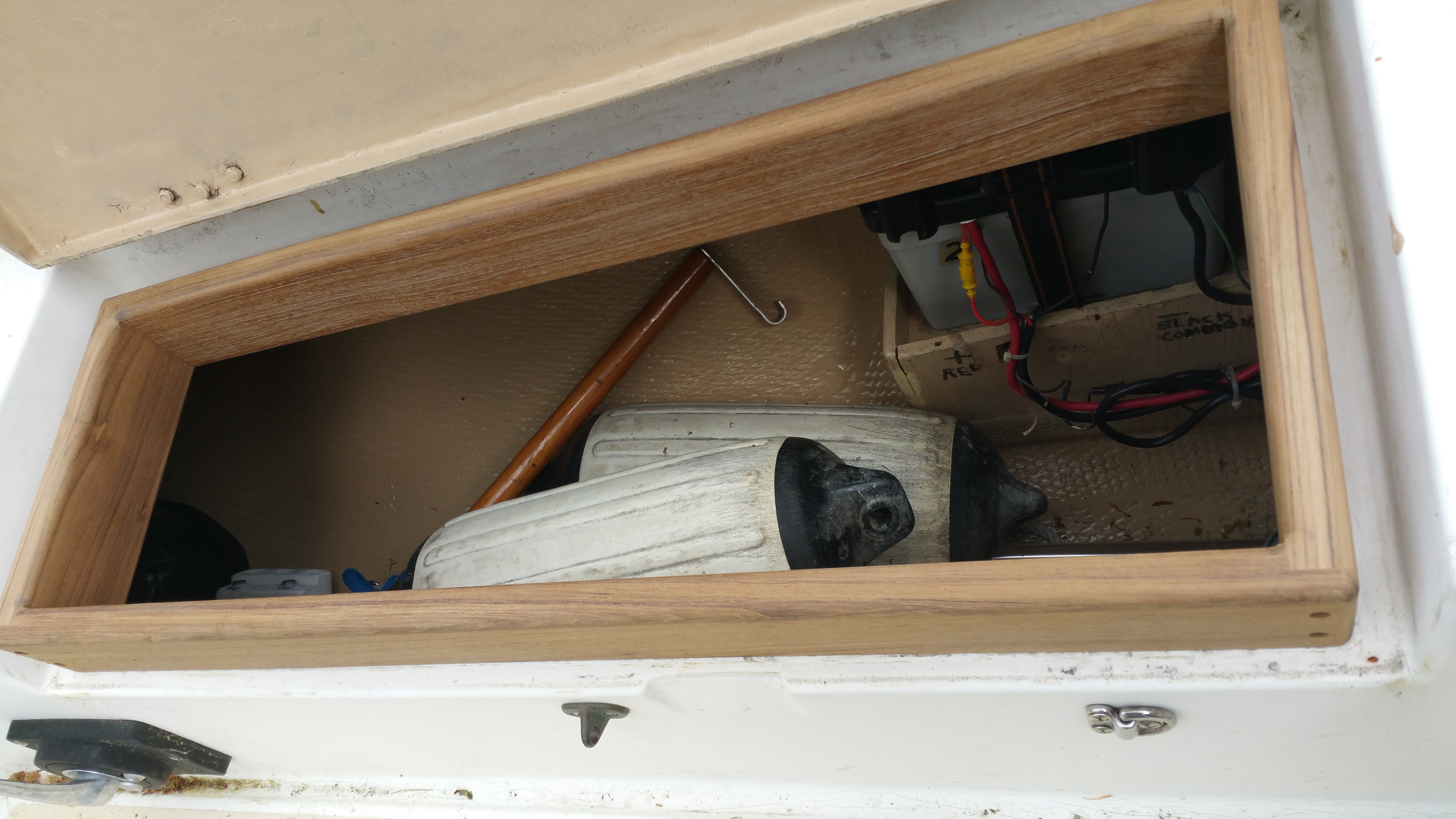

Hello All,
Welcome to "Spring" (in the North East anyway)
Since it is raining hard around here today I noticed that I am getting water under the teak boards in the cockpit lockers.
Does anyone know the trick to removing those boards so they can be resealed?
Any insight would be a great help..
Thanks
Thanks

Re: How do you remove those Teak Boards from lazarettes
They are attached by screws from underneath. You'll have to climb down into the locker or use a mirror and remove the fastenings from topside. If you look carefully at the posted picture you can see the bungs which hold the teak components together. With luck it should not be necessary to completely disassemble.
Rustoleum makes a product called Leak Seal which is less than half the price of the "as seen on TV" product.
I put a bead of caulk around on the outside and liberally lathered the bottom from inside the locker to reduce the drips to a tolerable level rather than dissembling the whole unit.

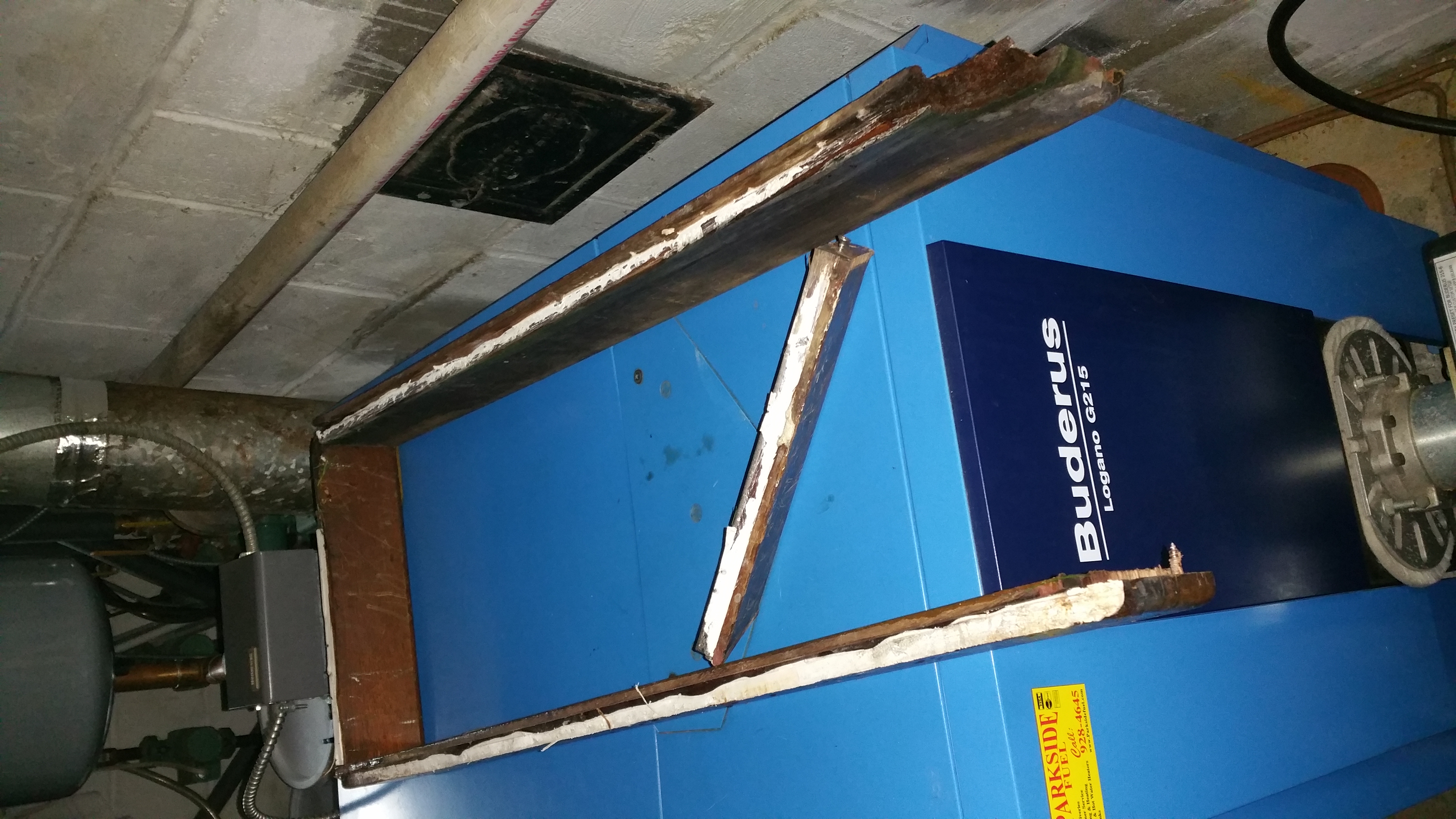

Well, The answer is in.
As I started looking in to "sealing" the outer edge with 4200 or the like, a quick poke with a screwdriver showed the wet corners of the fiddles were rotten.
Having nothing to loose ( but another weekend) I removed the boards.
After pulling out the little screws the boards are in fact only held in by whatever caulking the installer chose at the time.
Mine were installed with a few thousand pounds of 5200.
SO... they did not survive.
The rotten areas let go but the rest came up.

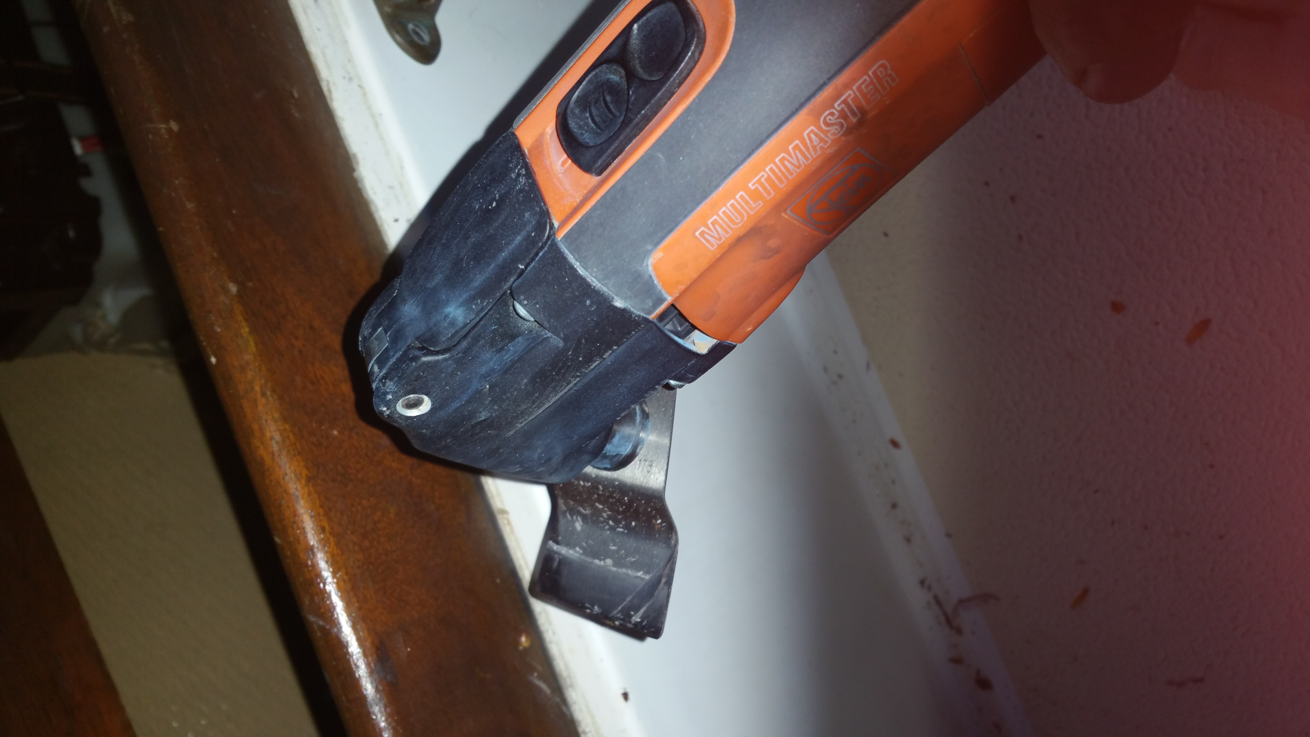

I used a Fien Multitool with a flat tip that came with the set-up. It worked great to loosen the caulking.
I have attached some photos to show the effort.
I'll send a few after the fix.
Thanks for all the help.

- Multimaster Tip
- 20170426_195001.jpg (3.75 MiB) Viewed 854 times

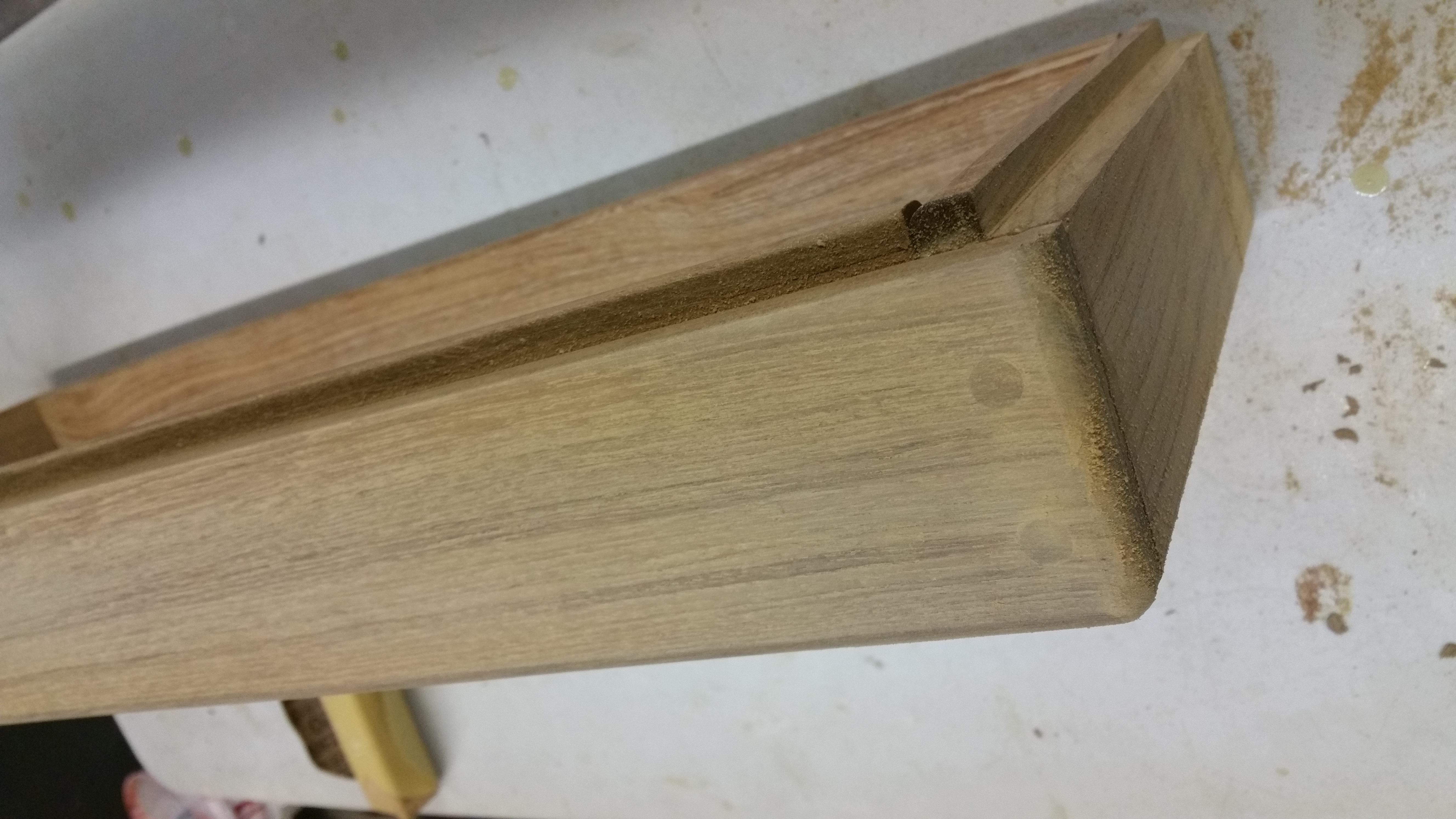

Just wanted to post the result of the new teak for the rotten boards
New Joints
Installed
Good for the season...
New Joints
Installed
