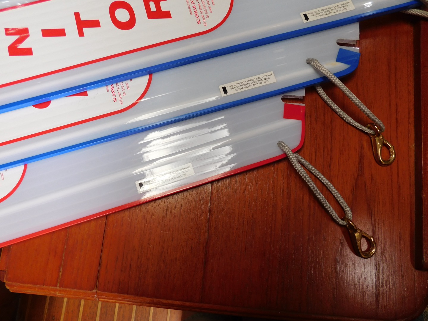

The air vanes on my self steering gear are attached with a simple compression fitting. There is a hole in the air vane which is an attachment point for a safety line. I recently had the compression fitting loosen, the safety line failed to live in to its name, and my air vane is riding the Gulf Stream to the British Isles. It was time for a better mousetrap.
I had some left over Dyneema (Amsteel) and a couple bronze snap hooks so I decided to use a continuous loop to improve upon the offending safety line. The following photos illustrate my project.

Permanently attached safety line

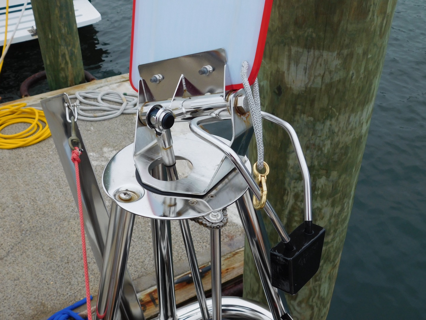

Safety line attached to self steering gear
Success
Success

Not a bad idea. No end of clever solution with dyneema.
