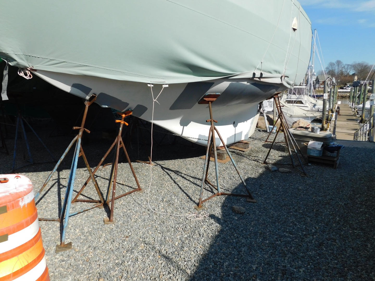

Exceptionally warm and calm day today. The pro in my yard watched me scrape and sand all the bottom paint off last December. He stopped by to see me working on my furling gear yesterday and advised me to use his labor saving technique to apply my barrier coats and bottom paint. He recommended I apply barrier coats and bottom paint to all of the areas adjacent to the jack stands first. Then they can all be repositioned only once while the remainder of the hull is barrier coated and antifouled.
Here are a couple pictures I took this afternoon. I managed to get three applications of barrier coat done since the weather was so cooperative.
- image.jpeg (380.56 KiB) Viewed 1497 times
- image.jpeg (494.51 KiB) Viewed 1497 times

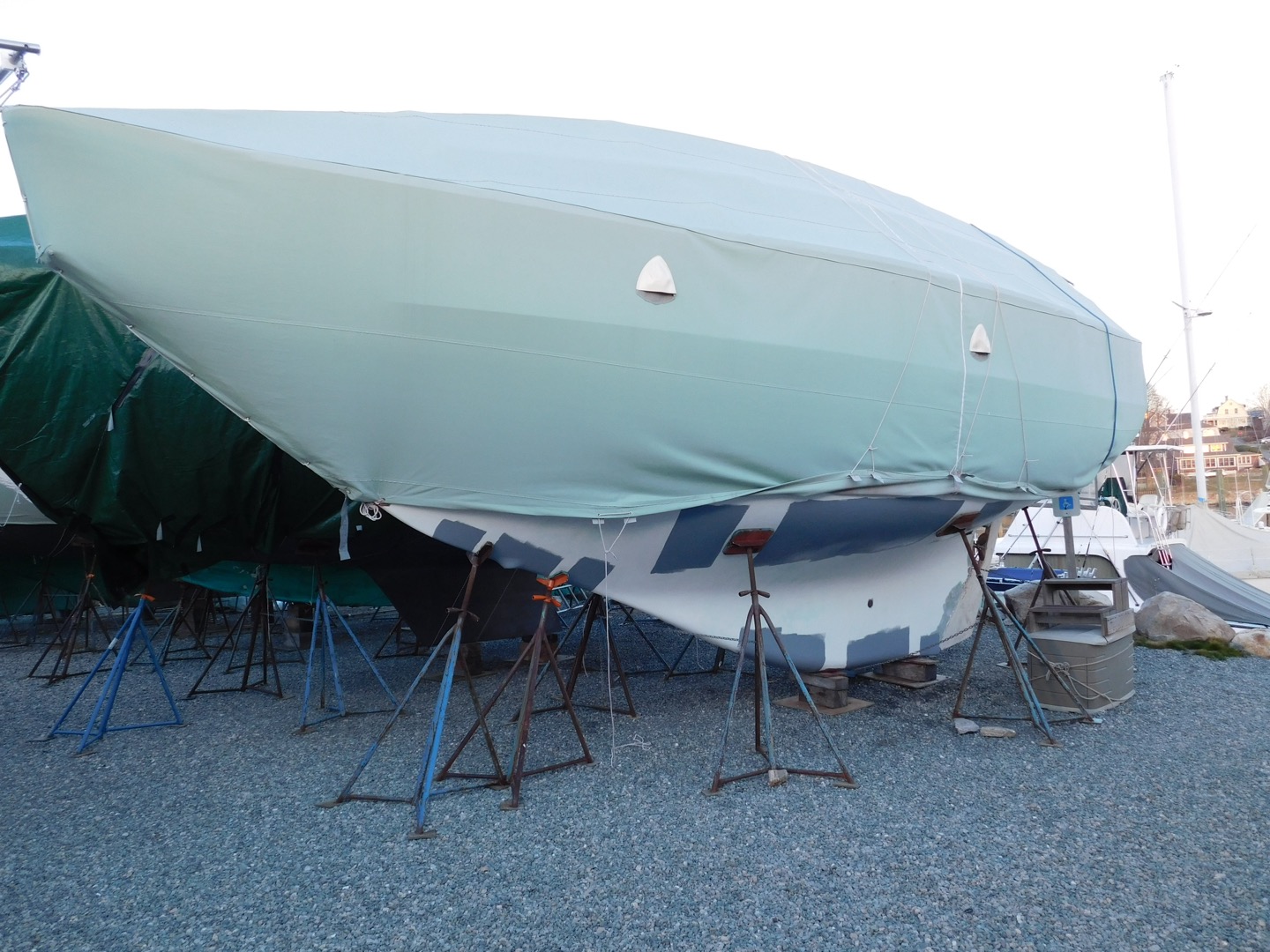

Still making progress. All the barrier coats are done and the stands have been relocated. We have 8" of snow forecast overnight but it should warm up enough by Wednesday for me to finish up by the weekend.
She looks faster already. I no longer have a bottom which resembles the surface of a golf ball.
(When I say "I" I mean ORION, not I as in me)
- image.jpeg (589.31 KiB) Viewed 1370 times

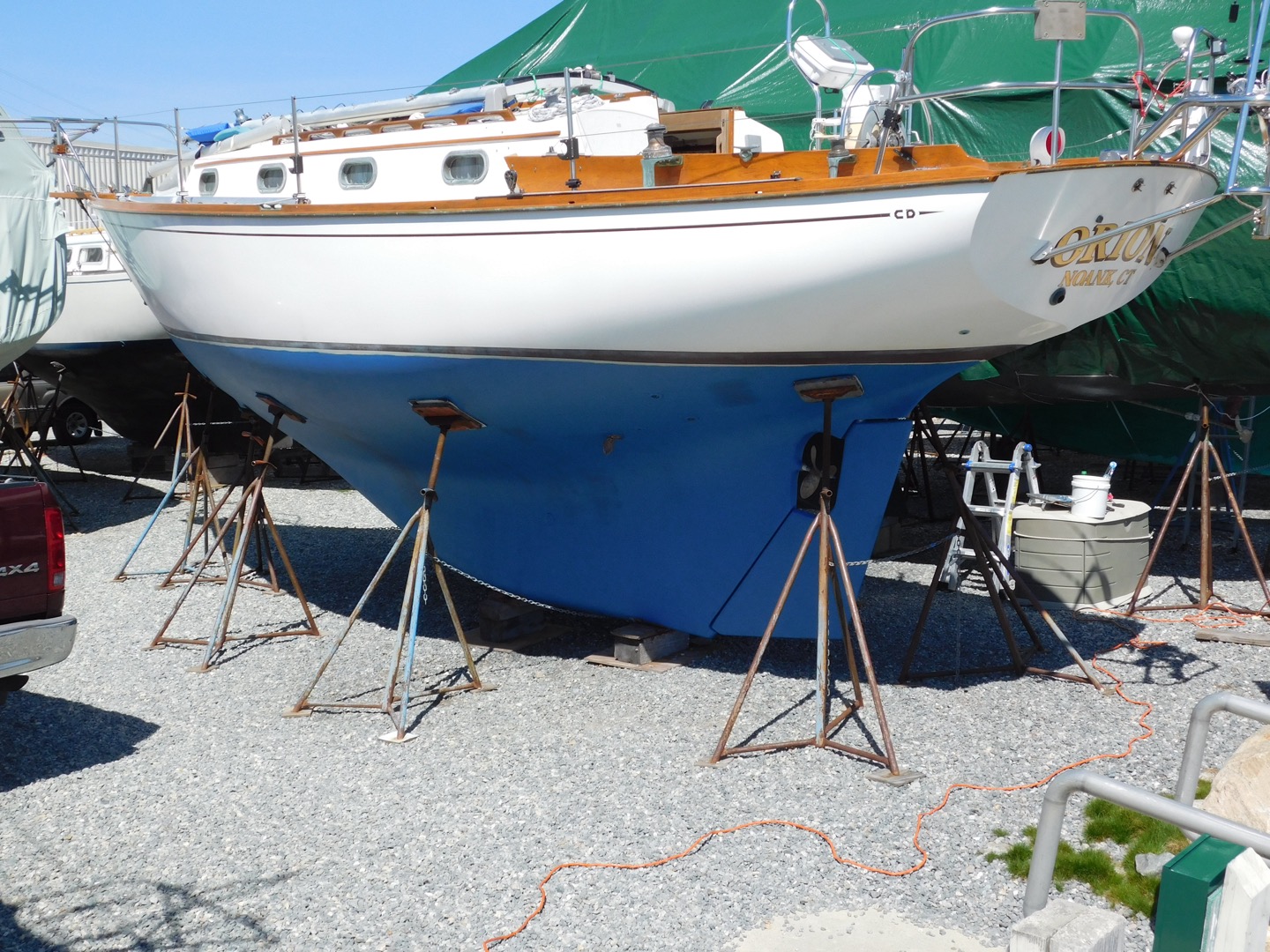

This job is drawing to a conclusion. All the barrier coats applied. The initial coat of red ablative was applied. The first coat of blue ablative is in the next photo, and my final coat of blue ablative is in the last photo. I was pretty sure I was going to change my bottom paint color to teal but I decided to go with blue. Going forward the only time I'll be applying more blue paint is when the red undercoat is showing. I intend to keep my "racing" bottom. As you can see I still have to paint my boot top, I'll knock that out on our first sunny day.
- Red ablative undercoat applied directly to the epoxy barrier coat
- image.jpeg (466.21 KiB) Viewed 1325 times
- 1st coat of blue ablative
- image.jpeg (521.55 KiB) Viewed 1325 times
- 2nd and final coat of blue ablative
- image.jpeg (363.97 KiB) Viewed 1325 times

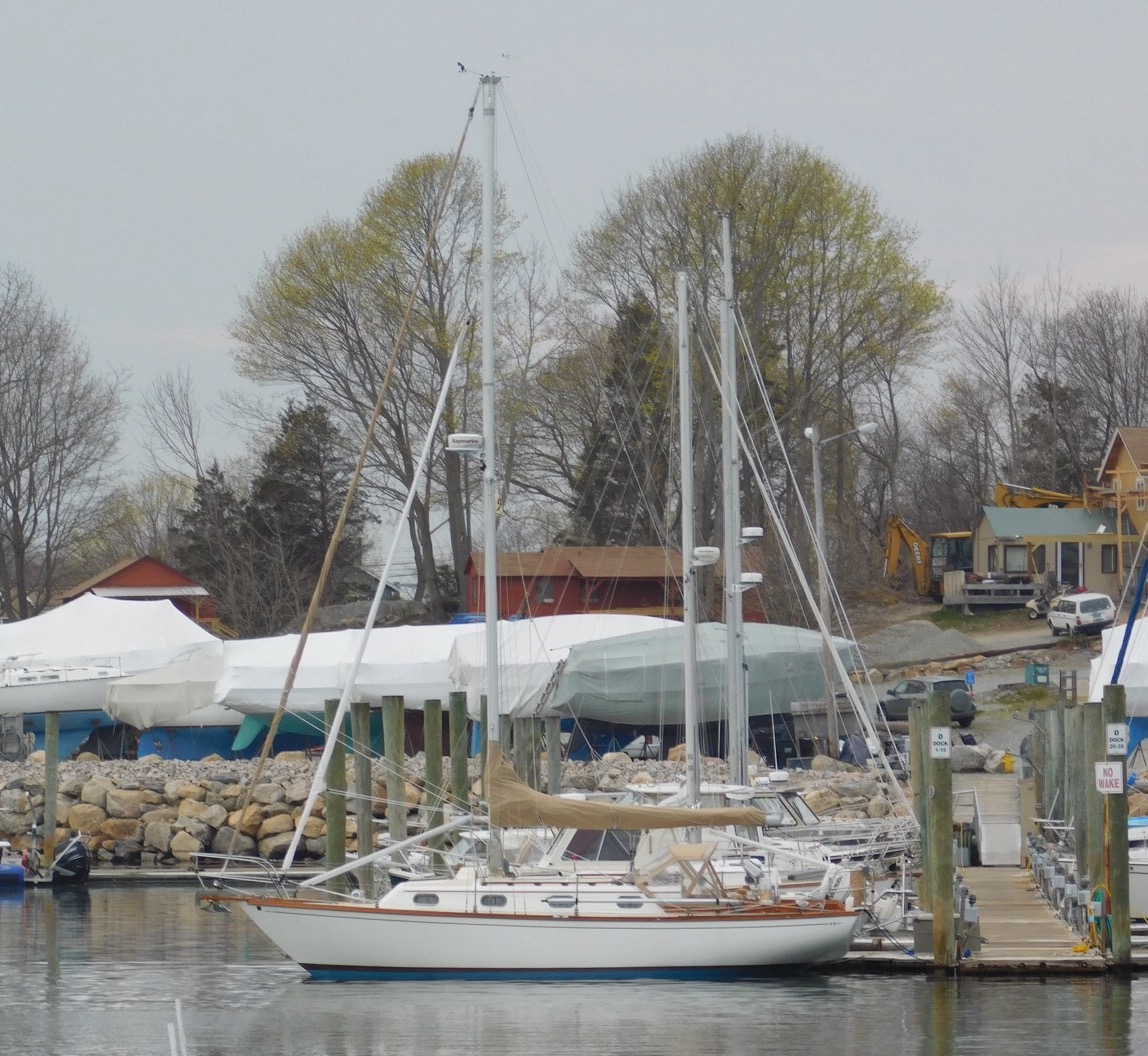

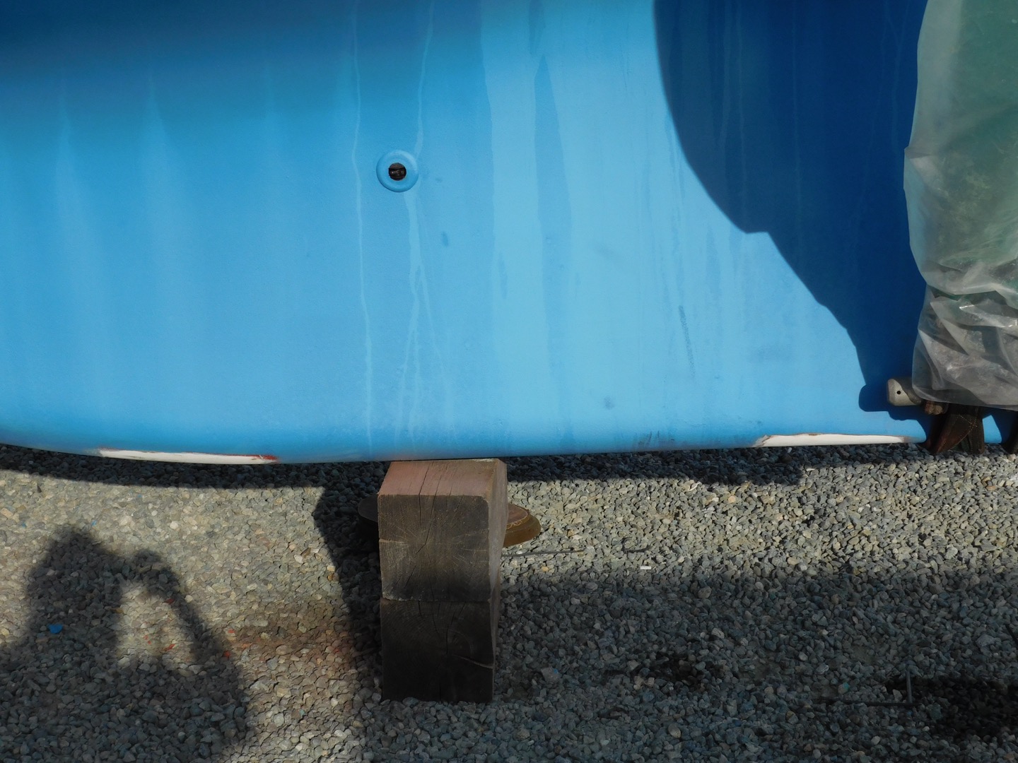

My yard kept me suspended on the Travelift overnight which gave me the opportunity to complete the areas which had rested on the blocking. I sanded those spots right down to the gelcoat, applied 4 coats of barrier coat and three coats of ablative in less than 16 hours. My aim was to not inconvenience them any more than absolutely necessary. They were very accommodating and I really appreciated their help.
I was launched as soon as the paint was dry to the touch. What a great feeling to complete a big project.
Over the last few days I have taken advantage of our clear but blustery weather. When that wind is piping up over twenty knots over that forty-eight degree water it gets bone chilling cold. I would walk down the dock to shore and it was t-shirt weather. At the end of the dock on the boat it was sweatshirt and foul weather jacket weather! Today it was calm and warm. I tuned the rig, bent on and furled the sails, and all those dozens of things necessary to be ready for that first sail. I can't wait to try out my new staysail furling unit. I still have to commission the auxiliary and I'm going to wait a week or so before activating my water system. That first sail is very close
- Here is ORION suspended by the Travelift overnight so I can barrier coat the two spots on her keel where she was resting on blocking.
- image.jpeg (364.92 KiB) Viewed 1246 times
- ORION in her summer home. This shot was taken from the opposite shore of the cove.
