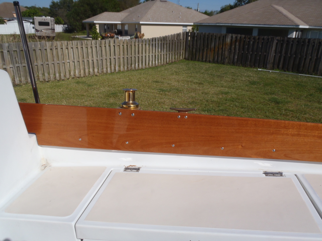

Thank you, the coaming boards are all on now. Really getting excited to splash her. I have a Memorial day completion date.
Keeping my fingers crossed.LOL

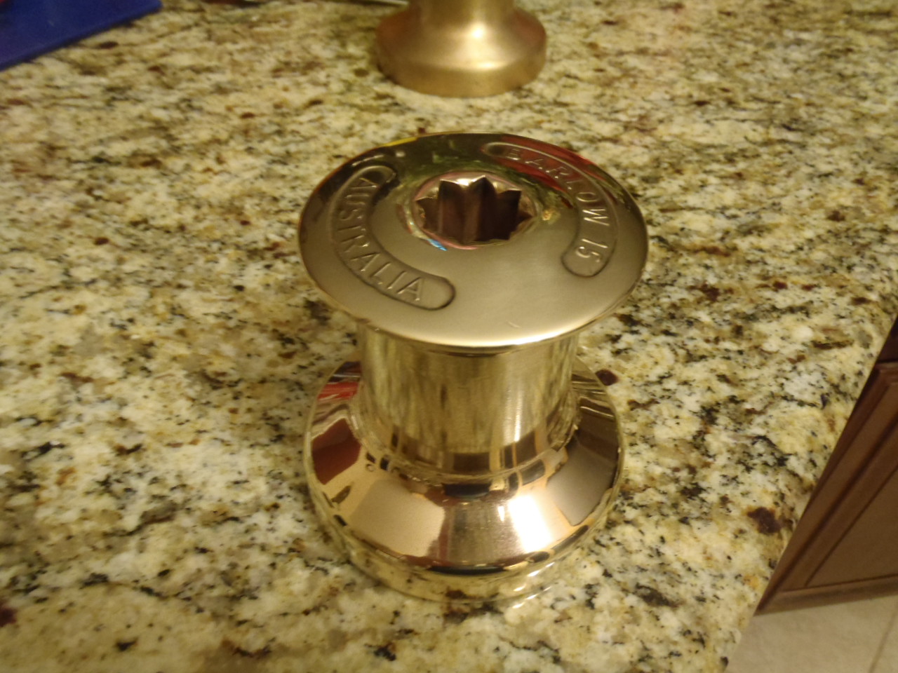

The original winches were nasty chrome that I had stripped and found solid bronze. With a little elbow grease they cleaned up nice. I like the polished bronze look better, just more upkeep.

Nice winches!
They do look better without the chrome.

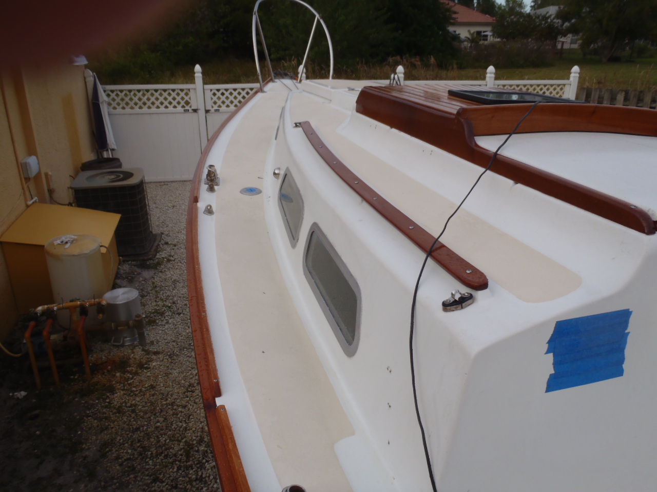

I like the wood and bronze look. The non-skid is GRIPTEX from Awlgrip, non skid particles you mix in with the paint. I was pleased how it turned out. All the exterior wood is solid mahogany. I have about 12 coats of sprayed on Awlbright wood finish from Awlgrip, really turned out nice.

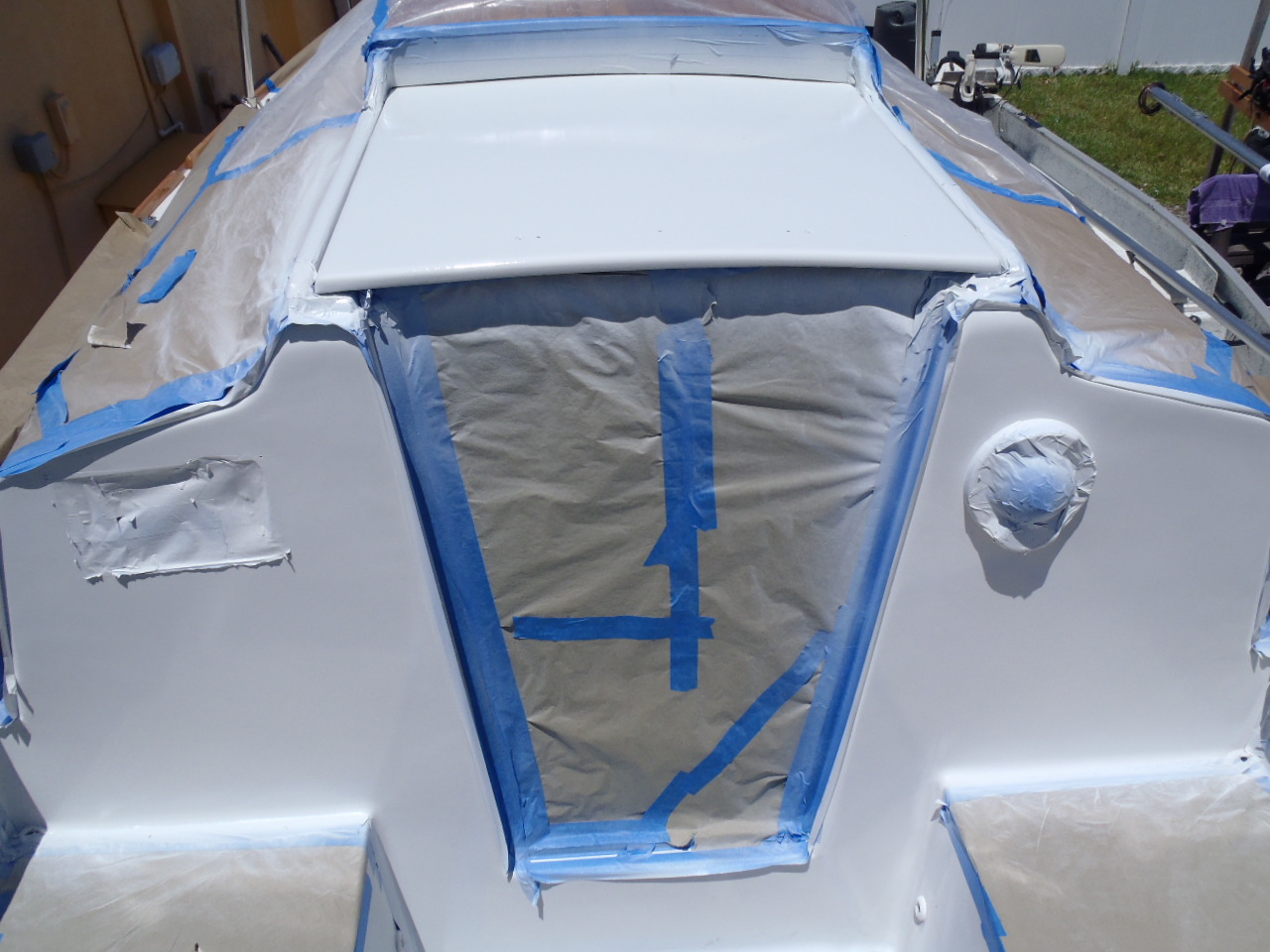

getting ready to splash, stripes are on companion way all re-painted, rigging is new.

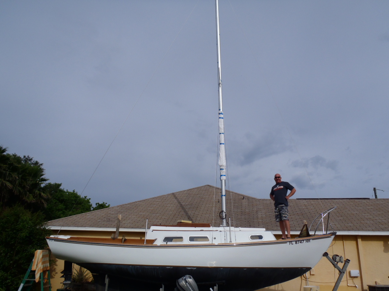

I had a productive weekend, we got the mast up. Everything fit well. Boat is going in the water this Friday.

Amazing! Your work had paid off. What a great boat. If you perma lac those winches you shouldn't have to touch them for several years my bronze is going on three years now.

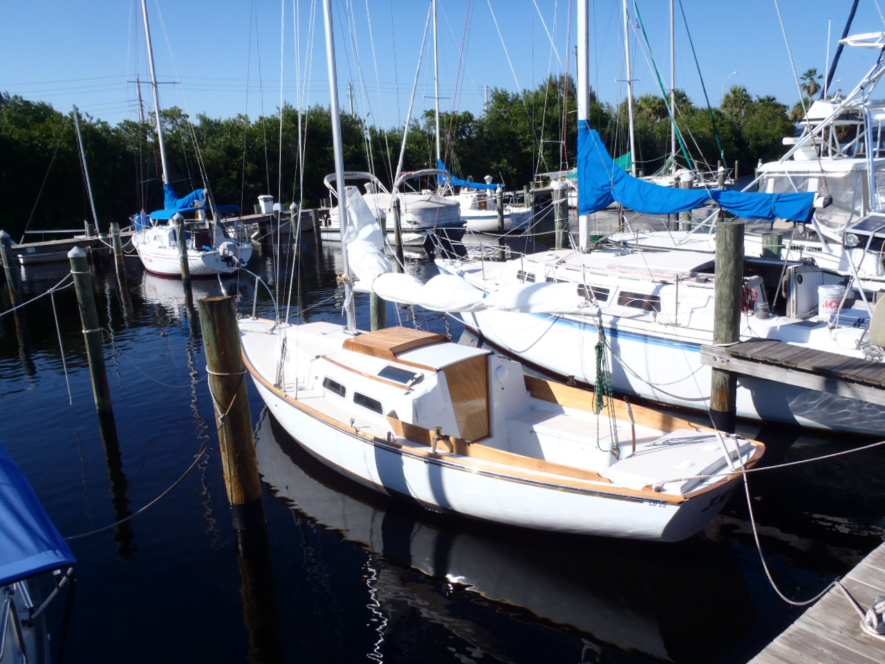

Boat launched and sails really well.
