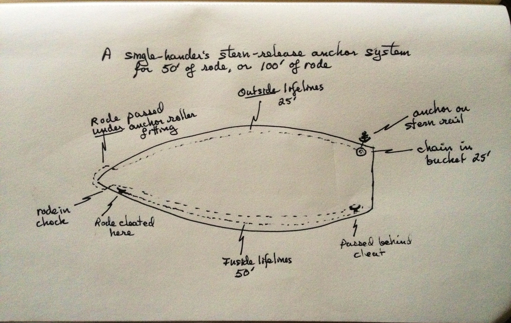

As a single-hander new to extended cruising (on saltwater only since 8/1/12) I sometimes semi-independently discover what others have known for generations, probably. Here is my system for a stern-release anchor that allows me to put out either 50' or 100' feet of rode without leaving the cockpit, depending on the depths. The anchor is a manageable 16.5 lb Bruce, suitable for these grounds, unless there is grass. The chain is 25' of 1/4", kept in a 1 gallon bucket. Everything must run free. If planning to use the 100' length, I release the loop from the port stern cleat before letting go. I've been told recently that there is a magazine article about something like this in Good Old Boat or Wooden Boat, but I've not found it. I can't always easily or safely leave the cockpit to release my heavier anchor from the bow. When I need a second anchor, this one is ready to add quickly to the bow anchor. I like having an "emergency brake" as well. While not for everyone, this arrangement has worked for me many times, for I rarely dock or moor. I hope my simplistic drawing conveys the set-up.

David:
Great idea
A few questions.
1. You have a notation on the starboard side at the bow that says "Rode passed under anchor roller______". What is the missing last word
2. What do you use to secure the anchor to the stern rail
3. I think I understand why the rode is passed "inside" the shrouds and lifelines on the port side but I would be grateful if you would explain the reason(s).

Robert, you asked:
The missing word is 'fitting,' the idea being not to have the rode tangle with an anchor carried on the roller. You would need to run a line on your own boat to see what works. My small Bruce hangs on the stern rail securely. I'll send a photo if I get a chance. It is very secure, though when anticipating rough water I have put a sail tie around it. Wouldn't do to have an anchor suddenly spring off the boat. The rode on the port side hugs the cabin top on my boat (this set up can be reversed, as I may do when I have repaired a piece of my rub rail to port...don't ask). Notice that the rode is cleated at the port bow cleat, any excess leads into the anchor locker. Lifted over the stern cleat, the rode will run out of that port chock and snub at the cleat. Couldn't happen as gracefully if the run was outside the lifeline. The nylon line would also stretch and sag down the hull. Not shipshape at all. The rode to starboard, on my boat, tucks along the toe rail, necessarily outside the lifeline. Otherwise the anchor would hang up at the stern. Get 75 feet, or about three times your LOA, of line and arrange it. You will quickly see how it needs to be run. If the boat is moving minimally, letting go the anchor and chain streams it out. Need to practice it a few times to be sure it runs freely. The chain doesn't touch the hull. The boat snubs and turns, often setting the anchor. Sailing-in the anchor may not be a technique for a crowded anchorage. With the boat at rest, you can simply lower away, then back in as usual. It is gratifying to watch the rode run out, whether using half or all of it. Once the anchor is down adjustments are easy. Etc. I hope I haven't just confused things. This really is a fine technique once tried. A relief to anchor from the cockpit, often. I'm sure things could go wrong but so far so good. You could mock it up on the garage floor in minutes, probably.

By the way Robert, I pass that port rode loop through the winch base support on its way to loop over the stern cleat. When you look at your boat you will see why, and how nicely it can work. There are little refinements to work out if you give this a shot. Try it a few times before you reject it. I keep cleating the rode backwards even now, for example, to no ill effect so far. I just feel foolish repeating the same mistake.

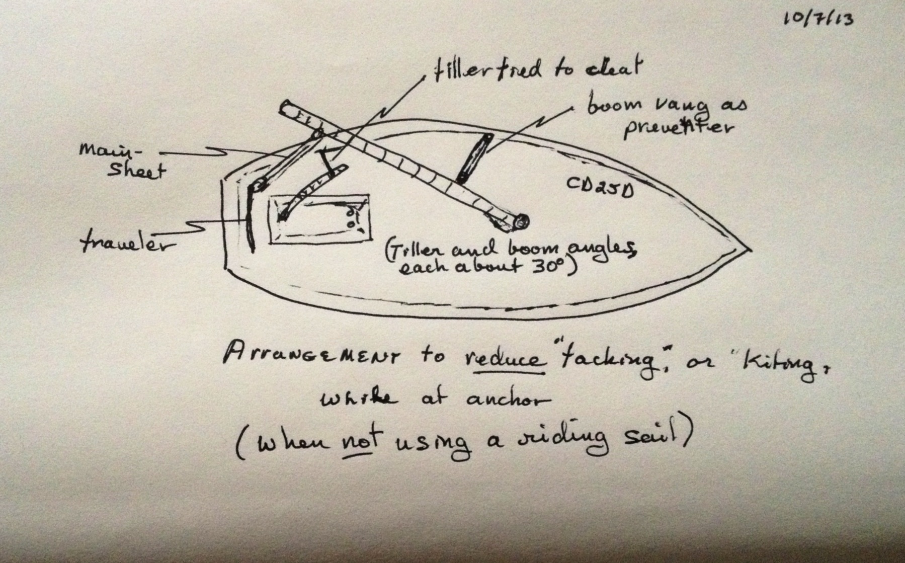

Another crude drawing to illustrate a possible anchoring solution. Having a good light air sailor like my CD25D, with its cutaway forefoot, means it tacks competently in light airs. Reliably. However...she will also tack back and forth against the tether of her anchor, when in an anchorage, even sailing up past it. We've all seen boats do that. How to lessen that? A riding sail steadies a boat. I don't have one (yet). I could use the main, if I had a third reef and was willing to invite the sun to age the top of my main. Here is my current experiment, which I was able to test in Force 1 through Force 5 winds over the last few days. It diminished frequency, amplitude, and duration of her swinging. Essentially, the boat is hove to on a starboard tack (ignoring a backed jib). She favors the starboard "tack" as I expected, but will go to the other, though not far. Very easy to set up and break down. Hopefully my attempt at a drawing shows the arrangement adequately. I'd appreciate knowing any other solutions, or what happens for anyone else on their boat. Each boat, I suspect, behaves differently due to its particular underbody configuration and windage. I know a heavier chain rode can help, but I don't have a windlass.
