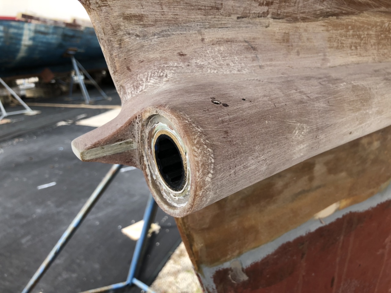

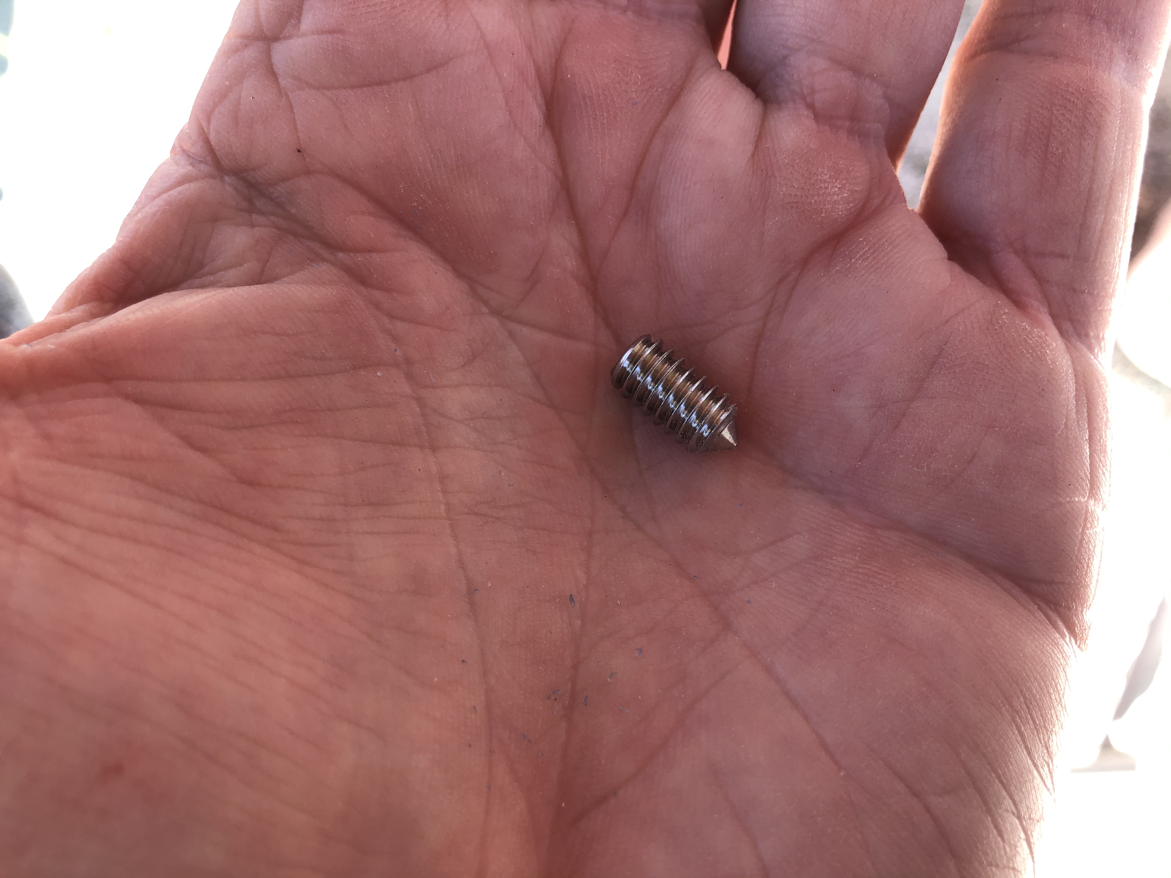

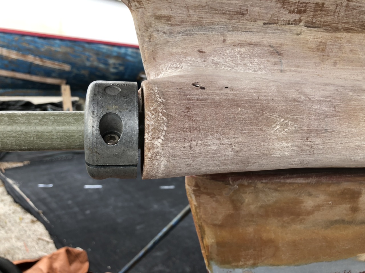

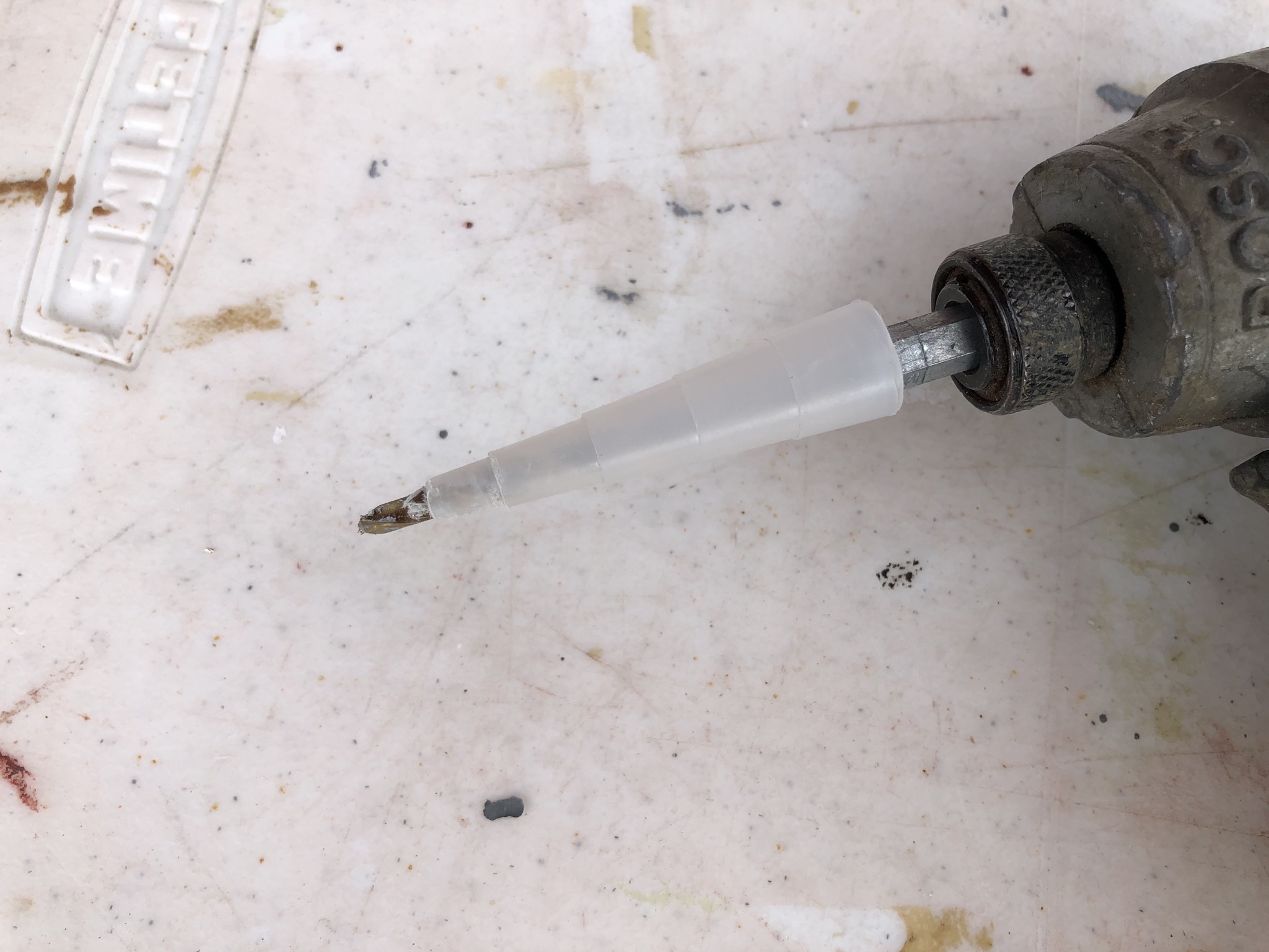

Cutlass bearing installed. Lightly coated aft 3” of bearing with 3M 40000. Then used light taps from dead blow to drive it into place. Next, I used a caulking tip to center the drill bit in the tapped hole to keep the bit centered but also protect the threads from getting boogered up. Just lightly drilled dimpled holes in bearing sleeve. Secured the 316 SS cone set screws in place.

A couple more photos of cutlass bearing installation.

Caulking tip drill guide.....I’m going to have to file that one in my aging memory bank. Great idea.

X2Jim Walsh wrote:Caulking tip drill guide.....I’m going to have to file that one in my aging memory bank. Great idea.

The caulk tip is a great idea.
I have a set of these that I always used for cabinet hinges. They work great but will cost you more than a caulk tip, Steve.
https://www.amazon.com/QWORK-Centering- ... 5963&psc=1
Steve Laume wrote:The caulk tip is a great idea.
I can see having a set of those. Nothing like having the exact right tool for the job. The caulking tip was an excellent solution for on the fly work. I wish I could say I thought it up...alas it was suggested to me by a boat builder. Just a smart simple clever keep moving forward solution.

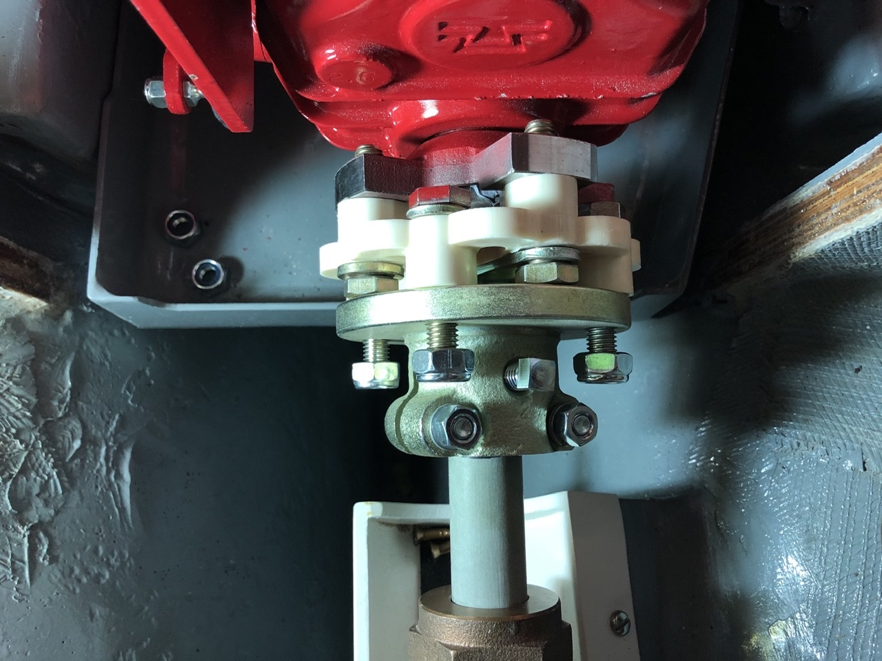

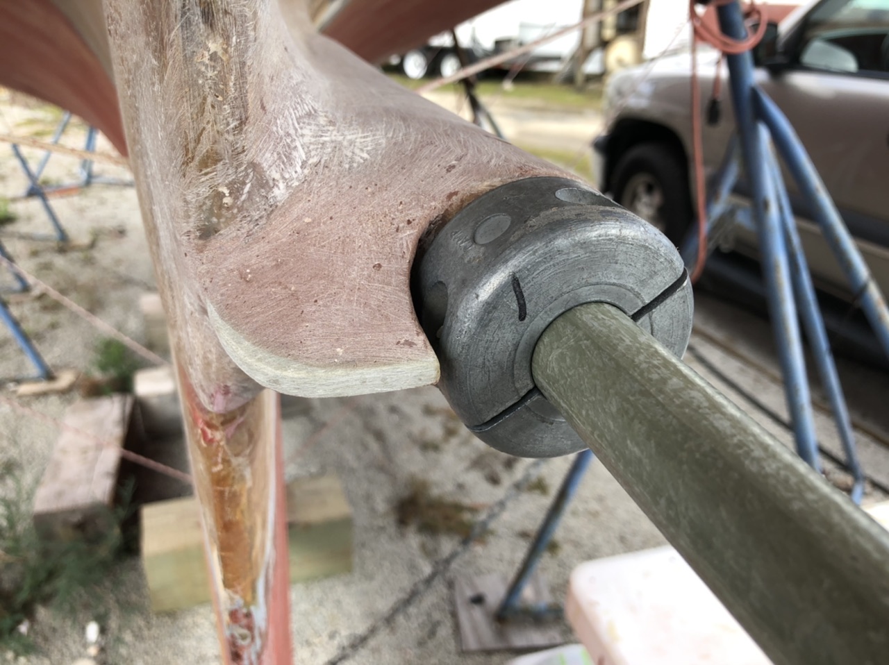

Today I intended to assemble all the parts to accurately measure the propeller shaft so I could go by Bircher Marine tomorrow to get the shaft build started.
I assembled the flex coupling and connected it to the tranny and the flange. I inserted the fiberglass shaft mock up and installed the zinc. But I felt like I needed to tighten the nuts to pull it all together for a really accurate measurement. I only had the nylon locking nuts and I didn’t want to use them. Much too difficult. The ships store where I have a commercial account was closed by the time figured out I needed some simple metric nuts—8 or 10 mm. So I stopped. I’ll reattack tomorrow.

Dropped off the shaft mock up, drawings, measurements, prop hub and flange at the machine shop. Should have the prop shaft back in two weeks.

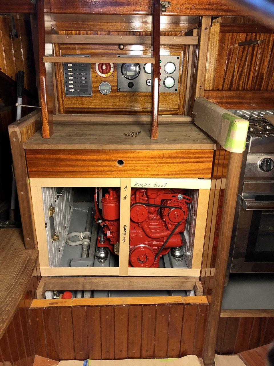

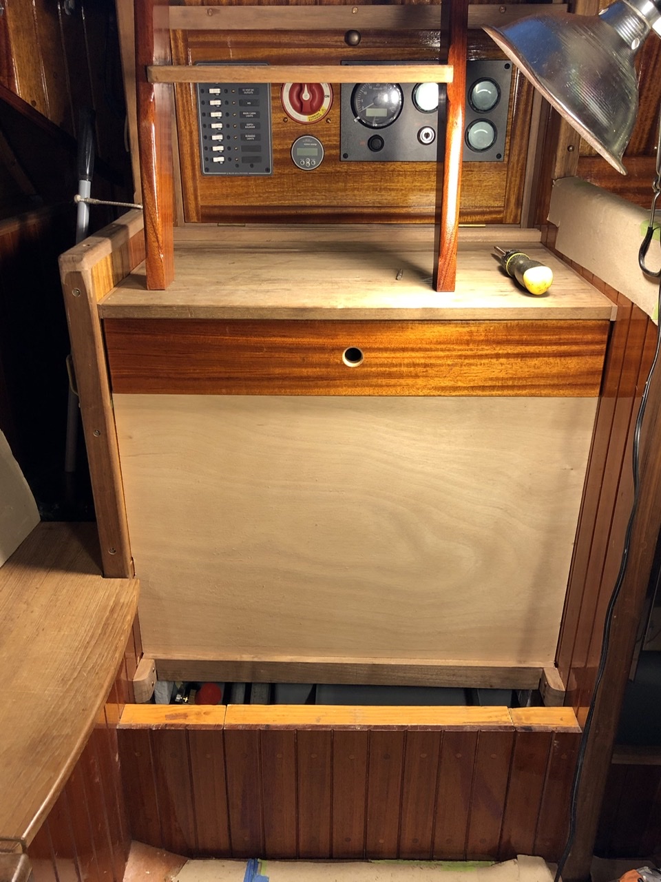

Slowly putting my ship back into fighting trim. Working on the front engine box panel. Made a template from doorskin ply and hot glue gun. The photo is weirdly distorted. Everything is all square and plumb. Will cut some okume marine ply and then epoxy African mahogany staving to to it. Same as the rest of the boat. Still thinking about the latches and such. Very glad to be put things back together.
Not finished though. Still need to install the vetus shift/throttle mechanism, staring battery, waterlock muffler, exhaust hose and some fuel and raw seawater hose. But getting closer. No doubt about it.

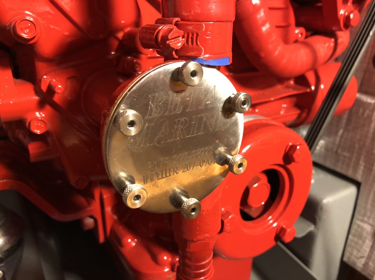

Replaced the the little screws that secure the water impeller cover plate with knurled knobs. Still have a lot to learn about the engine.

One more picture: I test fit the okume 1/2” ply panel. The African Mahogany staving will be epoxied to the ply. Then I need to add the bottom hinged step and the middle step with supports.

John,
McMaster Carr for the screws ?
Also, I'm surprised you've got your engine control panel where it is Sometimes when you want engine power, you want it asap. Kind of a safety thing ?? Or can you reach the key from the companion way ?
Fred

Here is the link.fmueller wrote:John,
Fred
https://www.mcmaster.com/92957A160/
I have sailed all these years without an engine—I don’t think I need to have the key to an engine at the tip of my fingers now. Better to have it protected and out of the elements. I can reach through the companionway and back under the bridge-deck I guess. But, if I needed to suddenly do that I would not be doing a very good job planning and thinking ahead. I don’t think of the engine as a safety device. Just a tool, like any other.

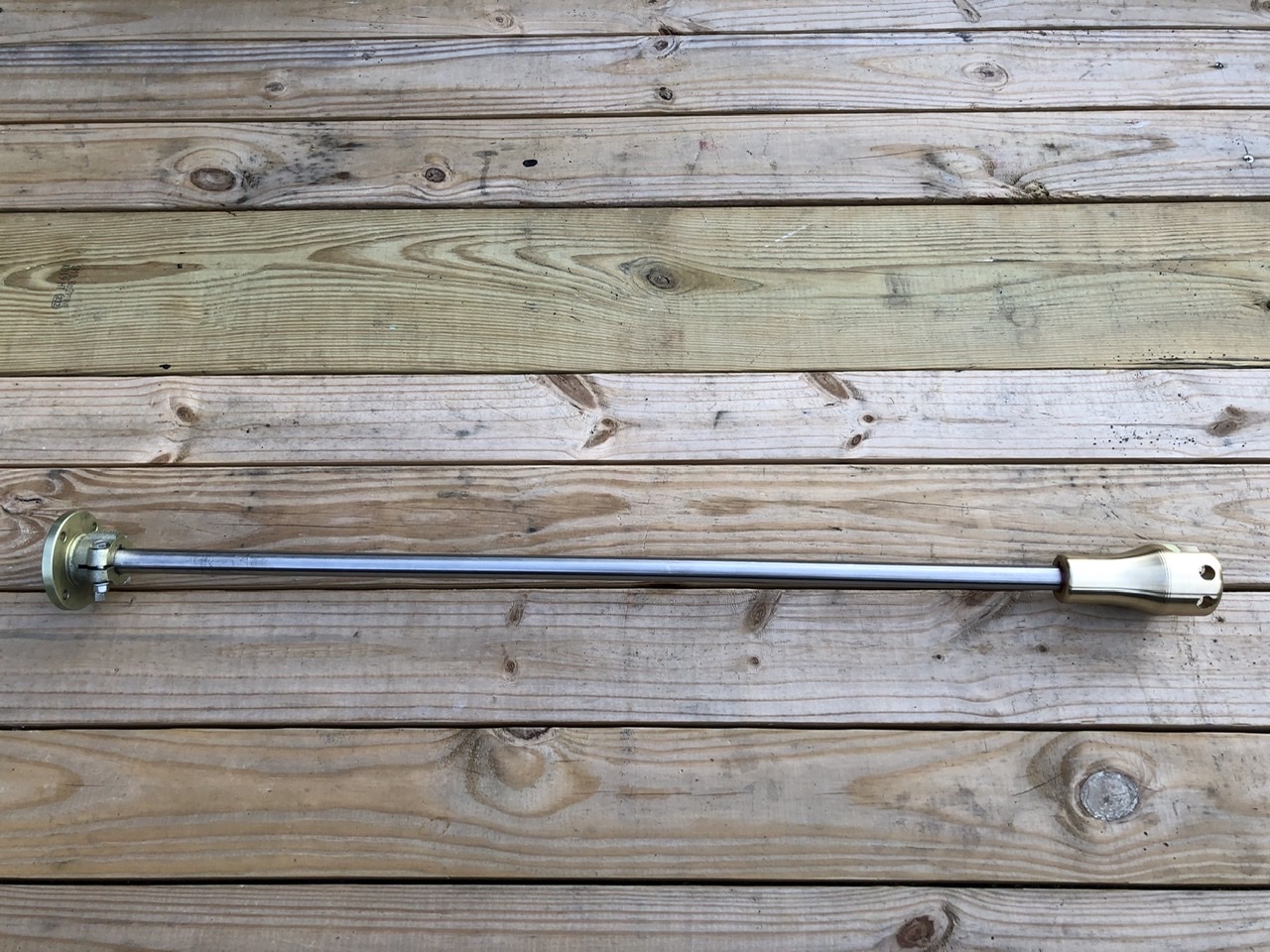

I picked up the prop shaft. Looks great. Aqualoy 22. Supposed to be very strong with great corrosion resistance. Jim Bircher does great work.

Here is the prop shaft.
- The prop shaft, machined for the Flex O Fold hub and the transmission flange.
