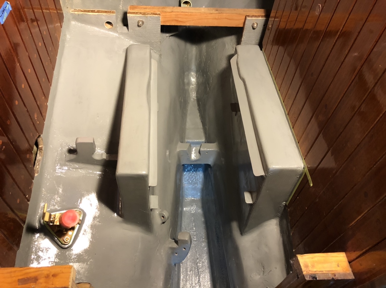

First coat of Interlux Bilge-Kote on new engine beds.
I order the engine compartment sound/heat insulation tomorrow.

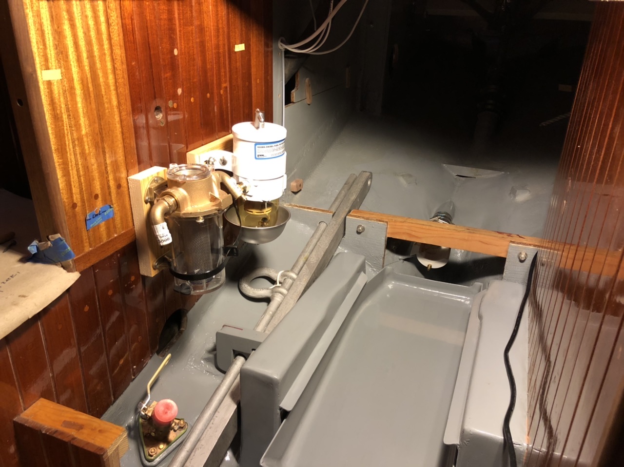

The “Soundown” insulation arrived. I needed to offset the strainer and Racor filter 1” to allow the insulation to fit properly. Used 1” cypress that I had on hand. The fuel filter looks tilted in the photo—it is as I have not tightened the bolts. Just a positional fit. I need to build templates for the insulation. Maybe I can get started tomorrow.
I spent some time today gluing rubber pads to key points for the drip tray and spare anchors to reduce likelihood of rattling.
The installation is starting to come together.

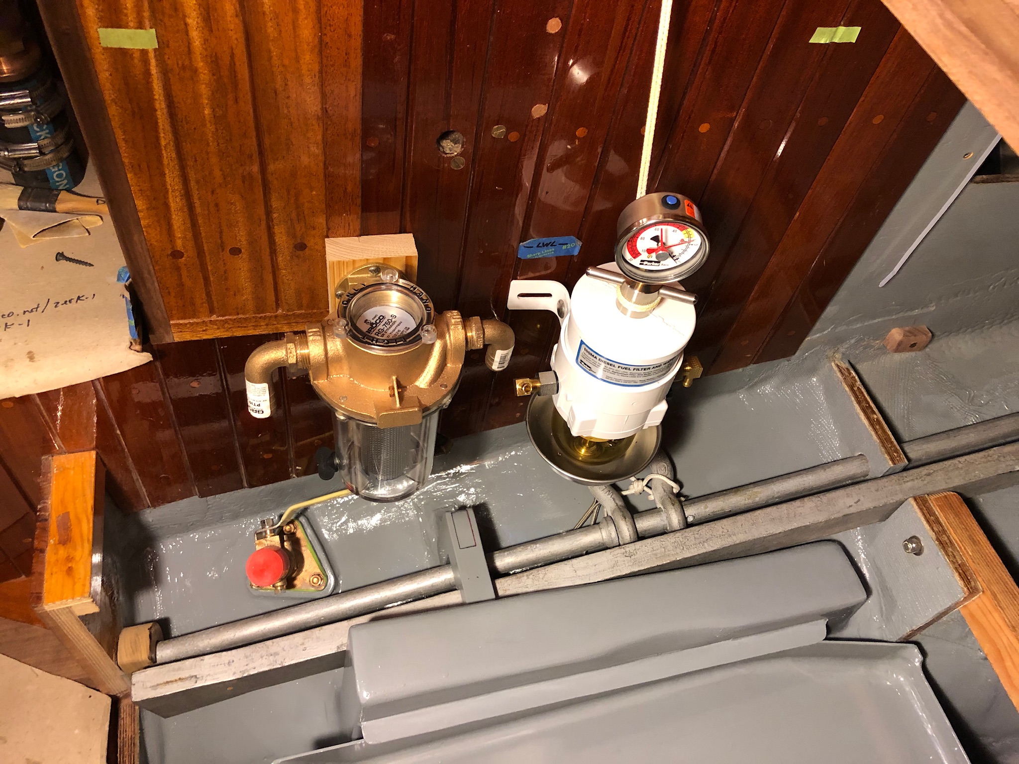

I know you don't have any of the fuel hoses installed yet, so maybe this question is premature, but have you considered putting a vacuum gauge in the fuel system? Mine fit on top of my Racor, and I don't see one on yours, so that's why I ask at this stage. With the location of your Racor it may be difficult to see a gauge, so you probably have plans to mount one somewhere that is more visible. If by some chance you haven't considered it, I highly recommend one.

Ha! Funny you should ask. I actually put one on but took it off and returned it.
It was a tight fit especially once I add the petcock on the bottom of the bowl. Tim lackey and I corresponded about it. His feeling was as little as I will use the engine and as clean as my system is it would be of questionable value for my boat. He felt like routinely changing the filter instead of trying to extend its life was a simpler approach. I trust Tim as the ultimate in practical simplicity. So I returned it.

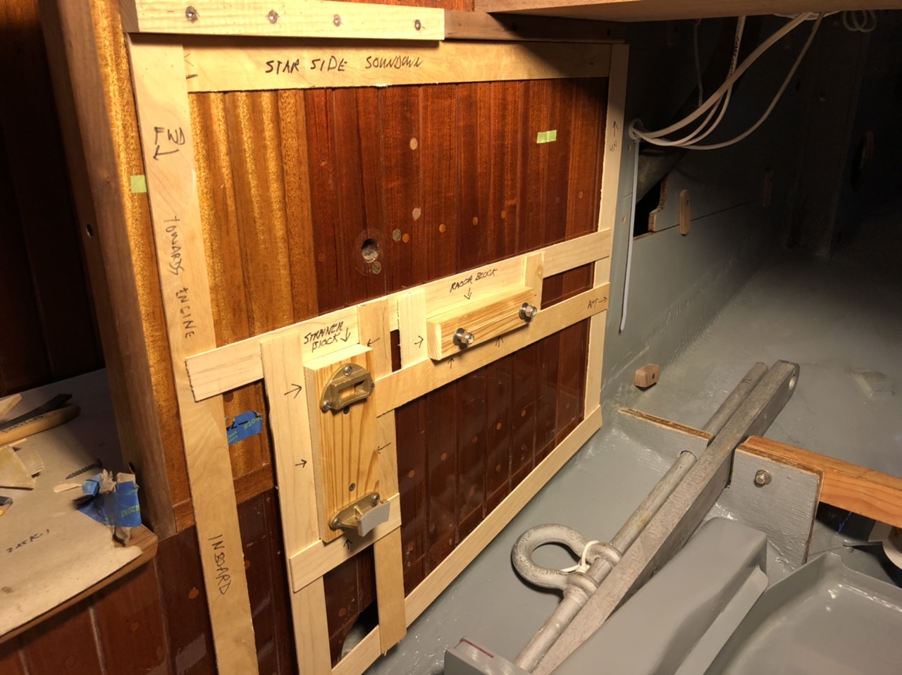

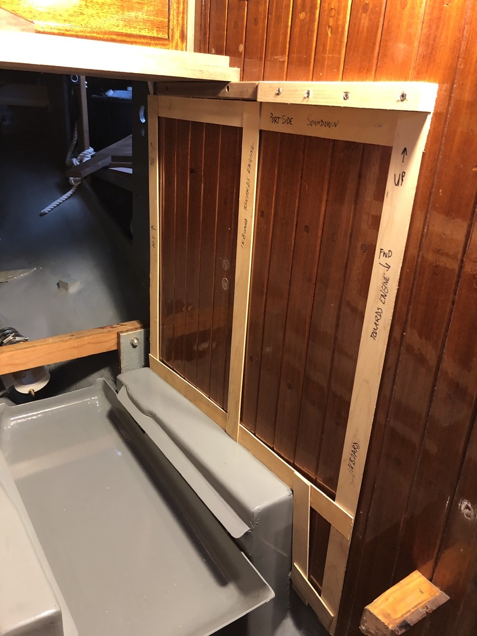

First two templates built for Soundown engine box insulation and noise reduction. Built them same as always—doorskin ply ripped to 1.5” and a hot glue gun. I need to make the overhead template as well as extend the insulation aft on starboard side along quarter berth.
Once the Soundown is installed I should be clear to install the engine.

I would actually argue the other way from what Tim said: if you are rarely using an engine, a vacuum gauge is more important. A diesel engine that is heavily used polishes the fuel tank by itself as the overflow fuel gets dumped back into the tank; an engine that is rarely used doesn't pump enough fuel through the system to do any appreciable amount of fuel polishing. So you are more likely to collect algal growth or other crud in the bottom of the tank than someone with a heavily used engine. Bad fuel can clog a filter in a matter of hours, so even if you never use your engine and change your filter every month you could still wind up with a clogged filter that one time when you do need it. When that happens, taking a quick look at the gauge and seeing the maximum vacuum ever pulled tells you whether your fuel system is the problem or not. Saves hours of troubleshooting when you need to get that engine going quickly.John Stone wrote:Ha! Funny you should ask. I actually put one on but took it off and returned it.

If you decide not to do the gauge, then good fuel hygiene--pre-filtering your fuel as you fill your tanks, treating it with a biocide, always keeping your tank full, and being careful of where you purchase fuel from--will be critical.

I totally agree with Jim and posted some similar ideas on the Racor filter thread.
If location or the ability to read the gauge is an issue there is no reason it has to be mounted directly to the top of the filter. I have an elbow on mine. You could also add a length of hose and put it anywhere you want.
I have heard those horror stories about bad weather stirring up enough gunk, or even one glob of growth, in a fuel tank to clog the filter. Once you figure out what the problem is and replace the filter it could happen almost immediately, once again. Without the gauge you would assume the problem was not the filter as you had just changed it. With the gauge you would know, one way or the other.

As usual lots of good advice. Lots to think about. Appreciate everyone’s thoughts and opinions. I like Steve’s idea about a length of hose and elbow.

+1 on that. Definitely remotely mount the vacuum gauge on your setup, John, based on where your Racor is. On the Racor I had with the gauge mounted on top, it replaced the hand-twist nut for opening the Racor with a nut that could only be turned with a wrench--a real pain. Having the gauge mounted elsewhere removes that impediment to opening the Racor.Steve Laume wrote:If location or the ability to read the gauge is an issue there is no reason it has to be mounted directly to the top of the filter. I have an elbow on mine. You could also add a length of hose and put it anywhere you want.
I had a problem with the engine quitting on a previous boat. When I checked it after the engine died, the max vacuum arm on the dial always showed a much higher vacuum than the normal running vacuum. The filter was always clean or reasonably so. I couldn't figure it out for a long time. But because of the vacuum gauge I knew it was a fuel problem. Finally I drained the fuel tank and opened it up to see what was going on. The tank was beautifully clean--except for a few small pieces of aluminum slag that must have been left behind by whoever welded the tank together. It turned out that the slag only occasionally got caught in the fuel suction tube and blocked the fuel flow. When the engine stopped it fell back to the bottom of the tank and everything worked perfectly for a while, until the exactly wrong random boat motion caused the slag to get sucked up again. When I opened the tank and saw the slag it was a huge "aha" moment, and the vacuum gauge readings suddenly made sense.
I would never have another diesel engine without a vacuum gauge on the fuel intake.
