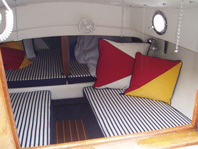

Ariel Photos

Thank you VERY MUCH for the post and the pictures. I did not raise the main. I had planned to do that during a sea trial - if I make an offer, etc.
I have noticed several things right away in your pictures that tell me something is very different about the SS 23 I looked at.
First, you have a port and starboard "countertop" with a sink -similar to a CD 22. The SS 23 I looked at has none of this. Just a cabin cushion port and starboard
Second, you have a dedicated space for a porta potty. The SS 23 I looked at does not. In fact, it has what I call a "compression post" in the area where the porta potty would be - sort of like on some of the Ty Weekenders that experienced deck compression and had it corrected with a "jack-like" compression post. When they do that, there is no where to put a porta potty forward. Interestingly, the surveyor in 2005 noted a high moisture reading and flex in the deck area. Not good.
Third, you have a dedicated step into the cabin. The SS 23 I looked at does not. From the pictures it also looks like your cabin space is a little taller (higher :?: ) than the one I looked at.
I am beginning to think that with the other differences I noted in earlier posts - round portals port and starboard, chainplates affixed to the outside of the hull (probably a good thing for inspection purposes), this may be a SS 23 that was built at home using either a kit or a basic hull mold from C.E. Ryder, Inc. It certainly does not appear to be a "stock" SS 23.

I always thought that this was a nifty layout actually. Although we use the icebox on Ariel we only use the sink to store junk. The water tank never got reinstalled. The opening ports are very nice!
We use the cabin to sleep and this seemed like a more sensible layout. For cooking, I used a single burner stove on the bridgedeck. We usually ate in the cockpit (as we still do on the 25D). Tables, lockers, etc. down below are just not that useful if you're stooped over to use them. We have a friend who lives on his Cape Dory 25, but he is single!
As for the potty, we keep our PP in the aft portion of the quarter berth on the Typhoon as we discourage its use! Because of the compression post on most Ty's the PP space with the cute wooden front/lid becomes unusable.
As for the yard... Ryder finished a lot of the final Wickford hulls when they got sold. That is also pretty normal in the SS23 world. Our 25D has lots of 1984 markings, but it is listed as a 1985 on the HIN.
