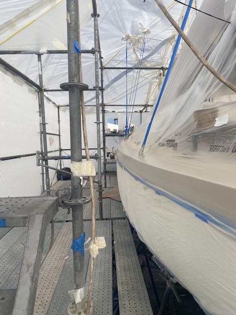

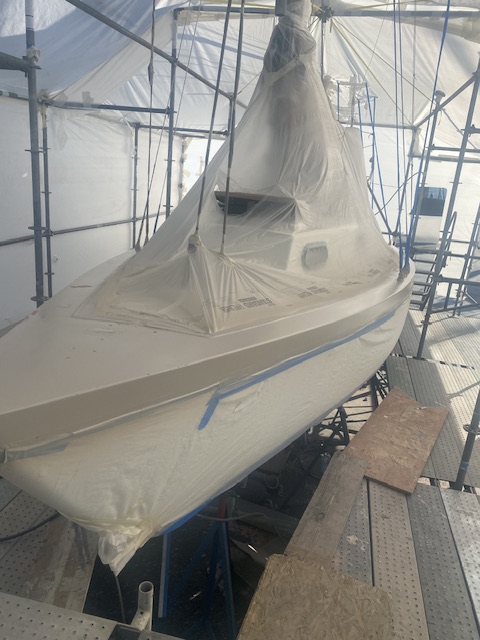

A couple guys spent the week with fairing compound and sandpaper then yesterday put two coats of high build primer. I think they will finish painting this week. I may have to cut back on some metal work. I need to see my bill after paint. We will see

So you are doing this in Mexico? How far down the coast? You are staying ashore I assume? Have you decided about the toe rail or bulwarks? While I would have preferred they do this with a couple layers of biaxial I am sure it's going to be great. I learned about this from Hal Roth on his Spencer 35 Whisper. I don't think he used biaxial. I also don't think it really matters they didn't remove the chainplates. They are set far enough inboard there should be plenty of cloth and epoxy or resin to strengthen the joint.

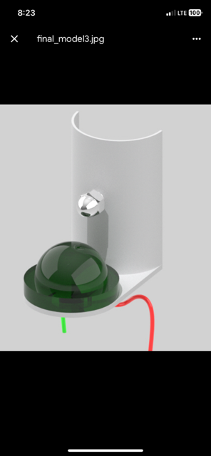

I wont be putting a toe or rub rail. And don’t have enough money to finish the bulwarks. I will install the modified stanchion bases and reintaall the old temporary bulwarks that I made out of DF from HDepot. Here is my design for the stern light that will mount on the windvane tube

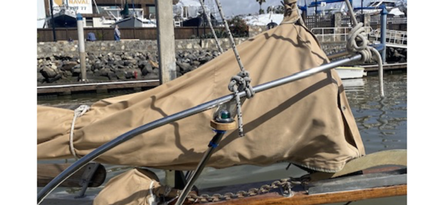

They are welding now and have started the finish painting. I haven’t decided how to make the mounts for the sidelights. I want them to be super nice and mount on the pulpit. But I will use the deck mount lights that were new last year. I can’t afford to buy anything.

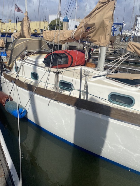

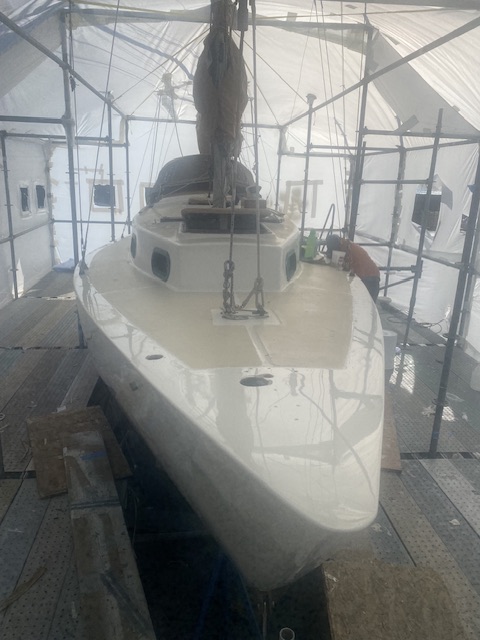

Painting finished. Just need to wet sand a little ridge at the tape line. I’m really glad I had them finish the bow triangle and the stern deck. They weren’t going to do that. Stanchion bases are ready just need to work on the pulpits a little. Ill install the bowsprit tomorrow.

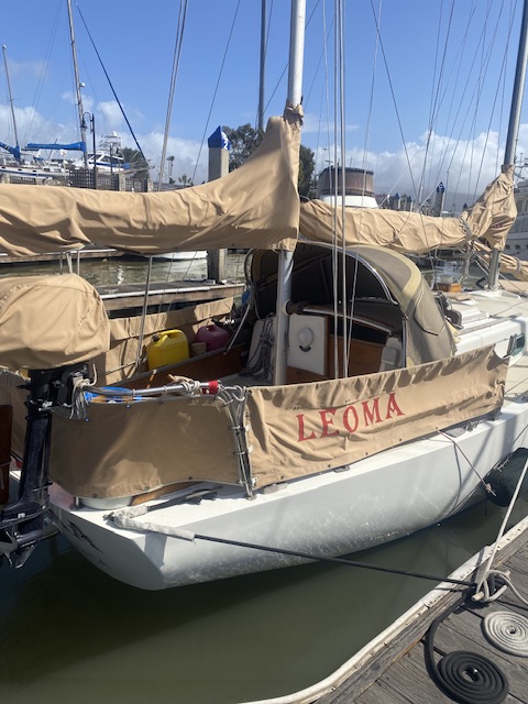

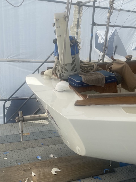

Finished at boatyard!!! Yay!! Im dissapointed in them but I guess It won’t help to complain. I installed the temporary boards as bulwarks. It’s really lacking without the wood toerail and rub rails. I think If I do a good job with the finished bulwarks this summer it will look much better. Main thing is I can use the boat like this till then. I got the sidelights mounted on the pulpit.
Now I have a tedious job of cleaning all the cruddy goop they tracked all over the decks. It’s the butyl tape that came up with the hardware. I dont really trust their work bedding the hardware. They asked me how I wanted to have them bedded. I thought they were the experts? Ideally I would have preferred they hold the bolts stationary on the deck and tighten the nuts from underneath to get a perfect seal. They didn’t do that. They just tightened from on top with the impact. It took them two days to install 7 base stanchions. So I finished all the hardware and pulpits myself.
I basically fired them. It seemed like the workers were trainees and they were always standing around talking or using their phones. So many times one guy would be working and two or three supervisors were giving advice. Paint and glass work is great. Total invoice$17,000
