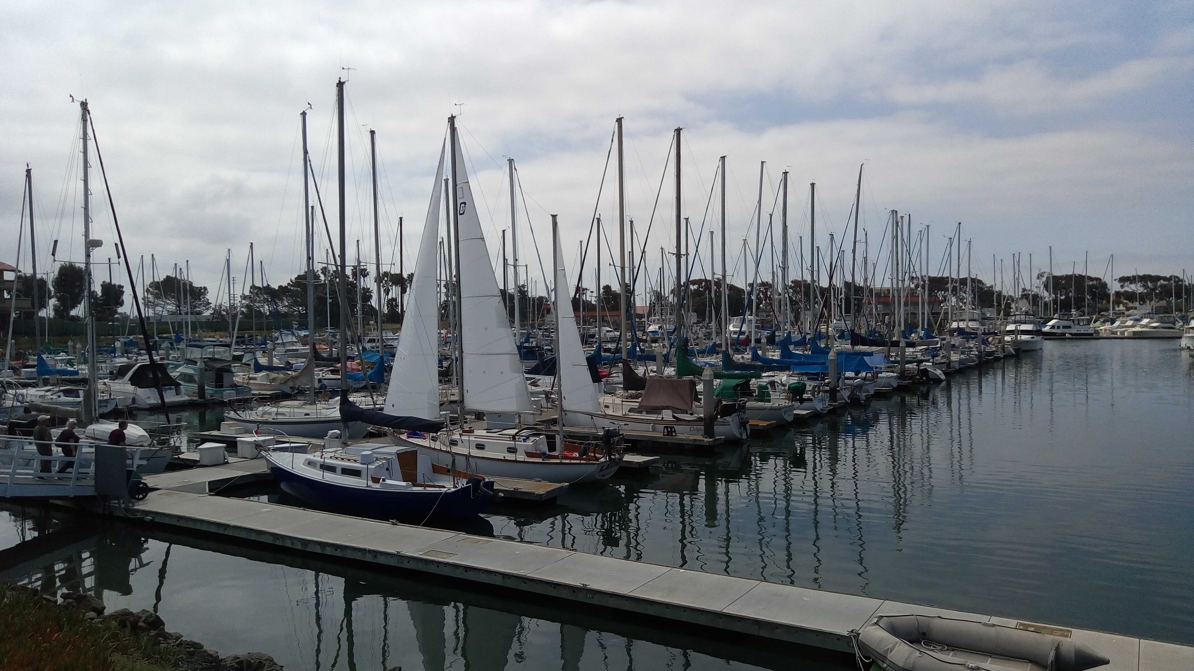

Thanks Hilbert. I'll try the vented loop. I was too cheap last week and only bought the check valve (Stupid). Yea, I'm a little worried. That little 3/4" fitting will clog easy.. Here is a photo of my new sails. Canvass is ordered as well as splash guards for the cockpit

Nothing beats "crispy" sailsJD-MDR wrote:. Here is a photo of my new sails. Canvass is ordered as well as splash guards for the cockpit
