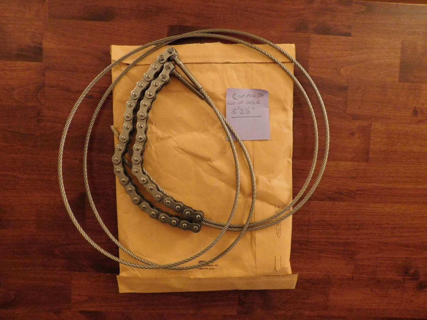

The process continues. I delivered my chain and cables to Rigging Only. I asked that the cables be replaced and that the rigger assess the condition of my chain. He see's more steering chains and cables in a week than I've seen in my lifetime and I value his opinion. The following morning I received a phone call informing me that the cost of the replacement cables was $49.00 and the chain was reused as it was in fine condition. It was overnighted to my home.
The pedestal was being sanded last Friday so steady progress is being made toward the day I can begin reassembly.....not that I'm looking forward to folding myself up under the cockpit, but it would be nice to get everything installed before the bitter weather arrives.
- New steering cables!
- image.jpeg (327.48 KiB) Viewed 935 times

I know you take a lot of photos.
I assume the photo above was taken "after" cleaning/soaking with xylene. Any chance you have a "before" photo of the chain and cable
If not, could you please dirty up the chain and cable to look like they did before treatment with xylene.
Thanks
Thanks
Re: Wheel steering pedestal removal and replacement project
Sorry Roberto. I didn't take a photo of the chain and cables "before". My hands were way to greasy to touch my camera.
I can't bring myself to "dirty up" the cables just to satisfy your curiosity

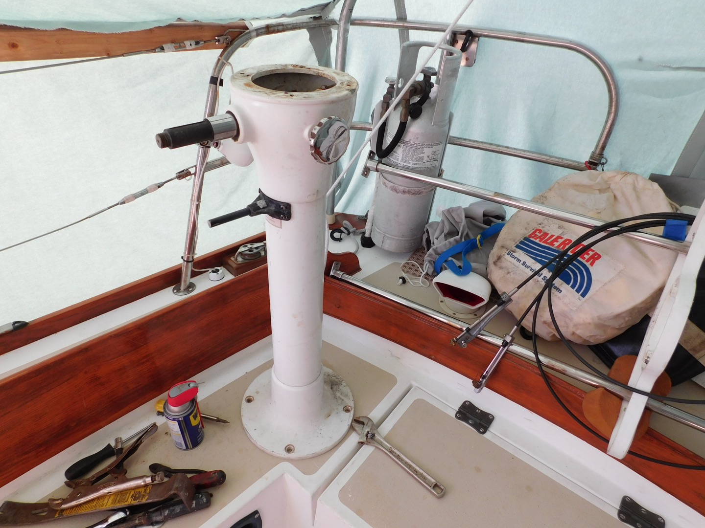

- The used pedestal waiting to be "dry fit" and professionally painted.
- image.jpeg (371.5 KiB) Viewed 893 times
- The replacement Yacht Specialties pedestal gleaming in its new paint.
- image.jpeg (404.88 KiB) Viewed 893 times

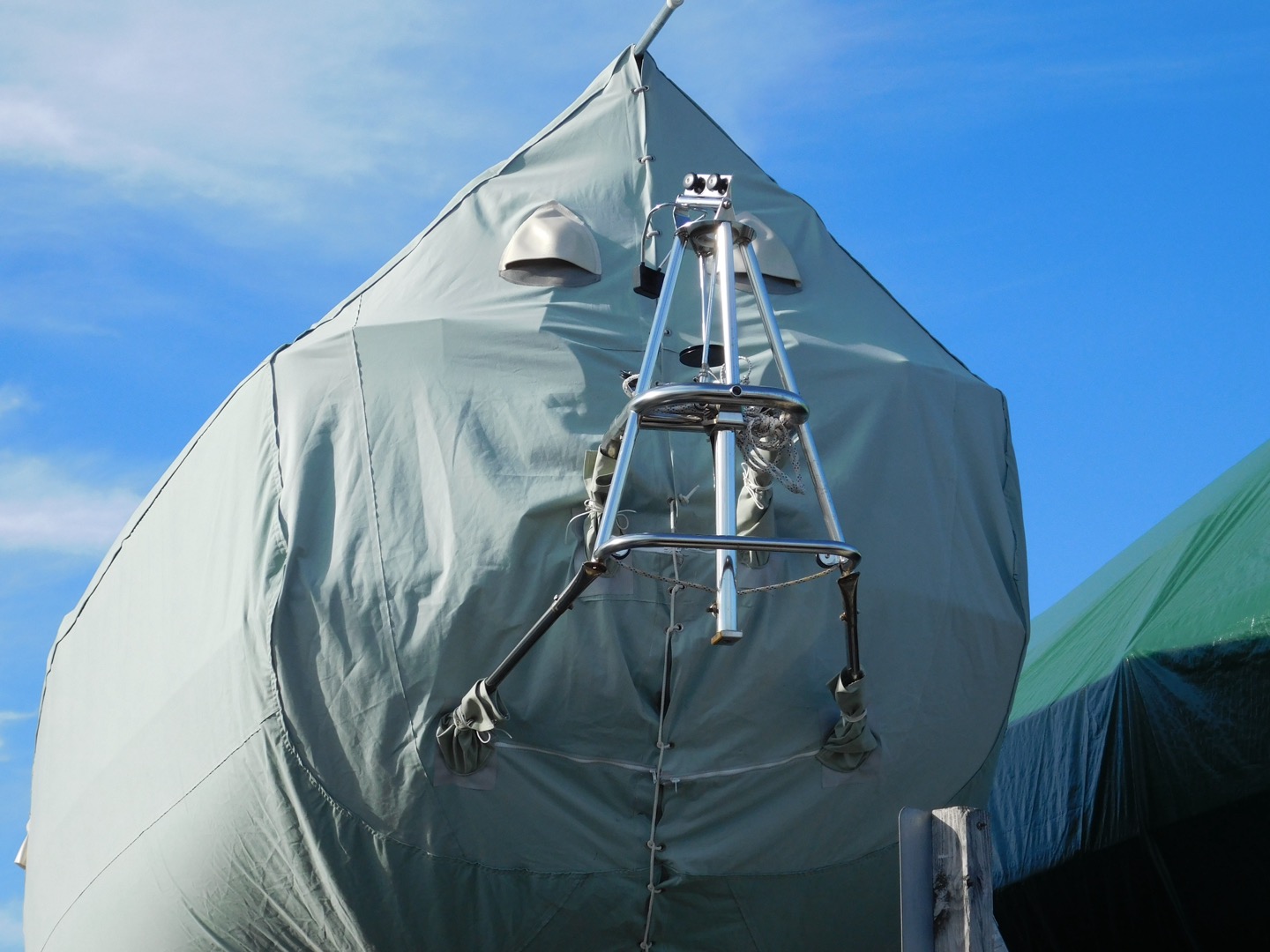

Have you written about your winter cover before? What is it like? How is it constructed? Are you happy with it! Got any pictures?
It's a Fairclough cover I've had since 2011. I'm very happy with it. I have an athwartships zipper which effectively breaks it into two sections so I can relatively easily lay the cover in place after I've assembled the frame. I always do it myself so it would be a snap for two to do. When disassembled the whole thing fits in my Outback so transporting it is no big hassle. Once its in place it hugs the hull. The lines which go under the hull are just tight enough to remove slack, not bar tight. I have a zippered door on the starboard side right where my boarding gate is in the lifelines so access is easy. I had the stern section made to fit around my wind vane like a glove. It is completely waterproof and is light inside as you can see from my earlier photos. I have six screened cowl vents so I've never had any mildew issues. I wanted the hull protected right down to the waterline but they can customize a cover to make it any length. They also have covers for those who leave their masts in place and their boats in the water.John Stone wrote:Excellent work Jim.
- image.jpeg (1.94 MiB) Viewed 847 times
- image.jpeg (260.97 KiB) Viewed 847 times
