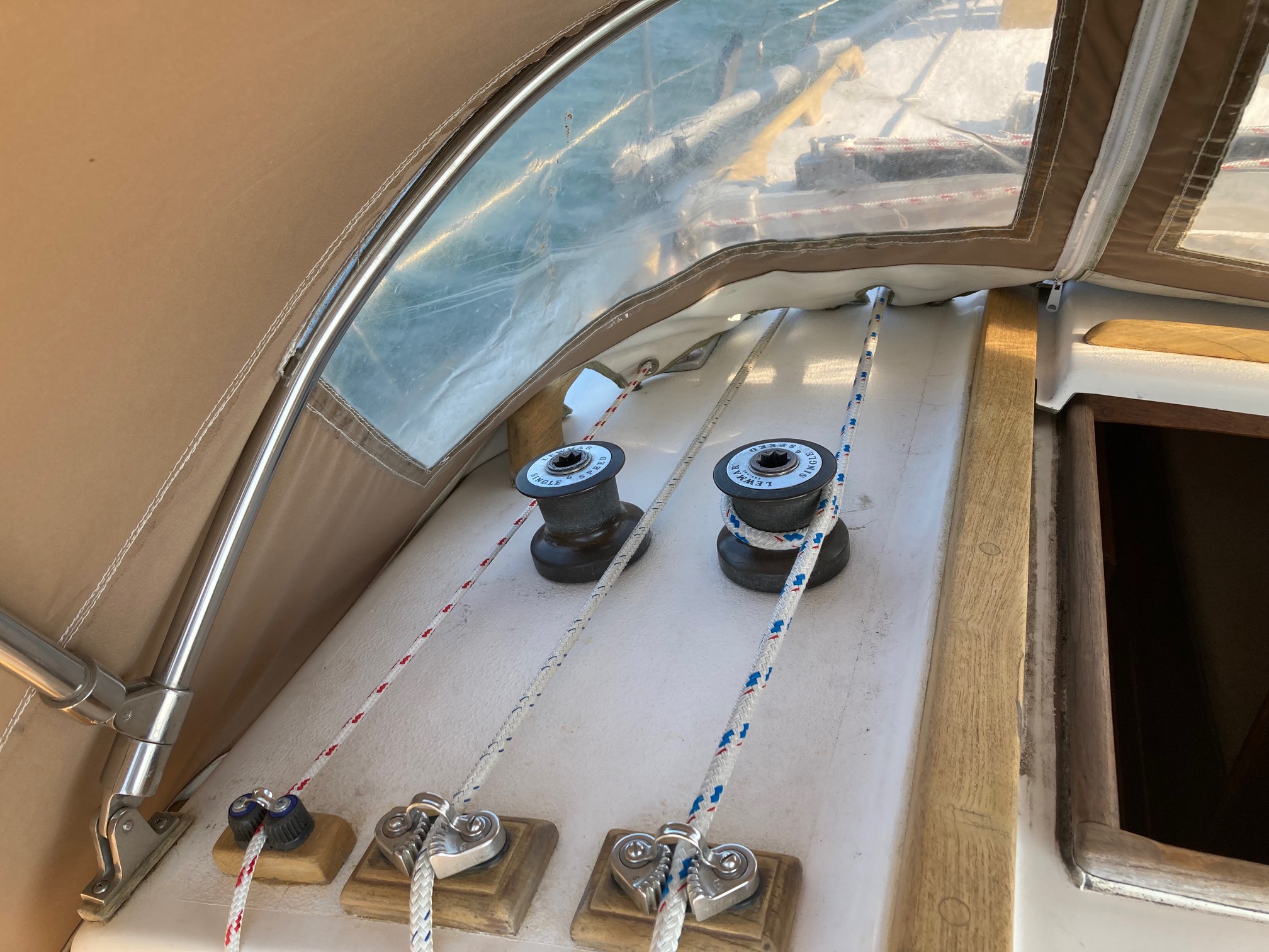

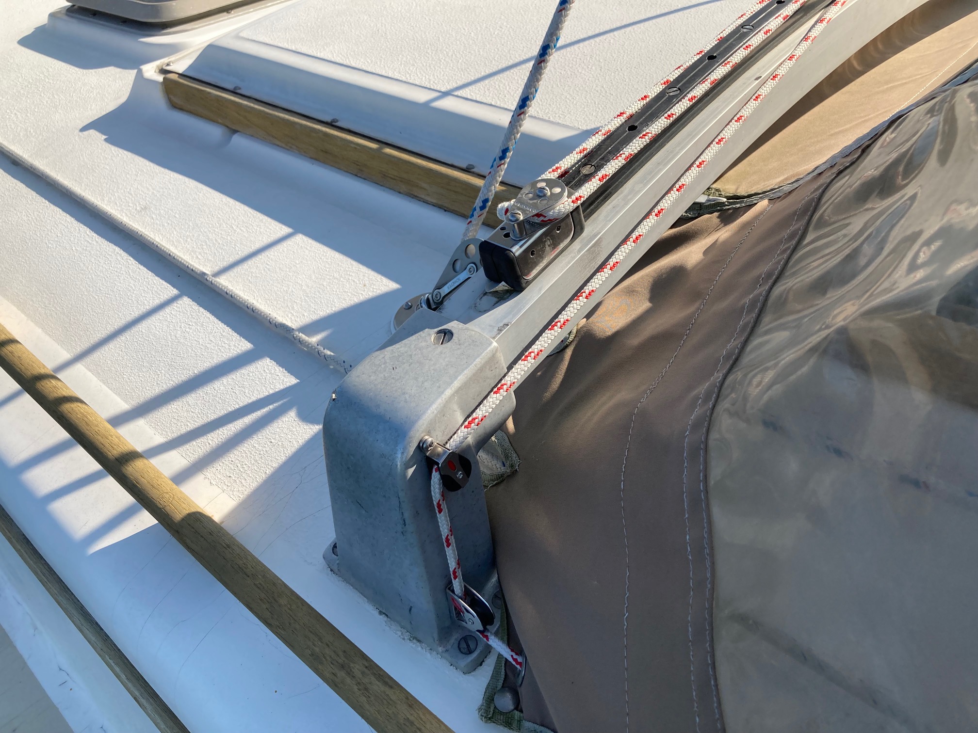

I did keep the original track. The approach was based on another CD30 with a similar configuration. Following are images, info from Ronstan (I sent them a picture of the other CD30 traveler) with part numbers and parts purchase info. I opted to keep the existing Nicro Fico traveler to see how it worked which has been fine over the last 2 seasons.
Thank you for reaching out to Ronstan International. Happy to help here – this setup is based on the lineup we have in our Series 19 I-Track Traveller system. The RC61914 is indeed the traveller car pictured here. Attached to it looks to be two of our Series 20 Double utility blocks (on either side) for your traveller control lines. These can handle up to a 6mm line. For control ends, we recommend the Series 19 Single sheave control. As for the mainsheet block, it’s a bit hard to tell in the photo but our Series 50 Utility (double) block would be the best bet. This can handle up to a 12mm line. I’ve copied all of this below with included links for each product.
Series 19 Traveller Car, Channel Top RF61914
(Qty 2) Series 20 Utility Blocks, Double RF20202
(Qty 2) Series 19 Single Control Ends RF61985
Bought the hardware from AnchorExpress (best pricing/availability at the time)
Ronstan Series 20 Ball Bearing Block - Double - 2-Axis Shackle Head - RF20202
Product ID: 55139 2 $22.99
Ronstan Series 20 Ball Bearing Block - Single - Cheek Rivet Mount - RF20151A
Product ID: 55136 2 $15.99
Ronstan Series 20 Ball Bearing Block - Upright Lead - RF20171
Product ID: 55137 2 $16.99
Ronstan C-Cleat Cam Cleat - Small - Blue with Black Base - RF5400B
Product ID: 55240 2 $19.99
Ronstan Flared Top Saddle f/Small T-Cleat & C-Cleat - RF5003
Product ID: 55245 2 $5.99
Hope this helps. Thanks

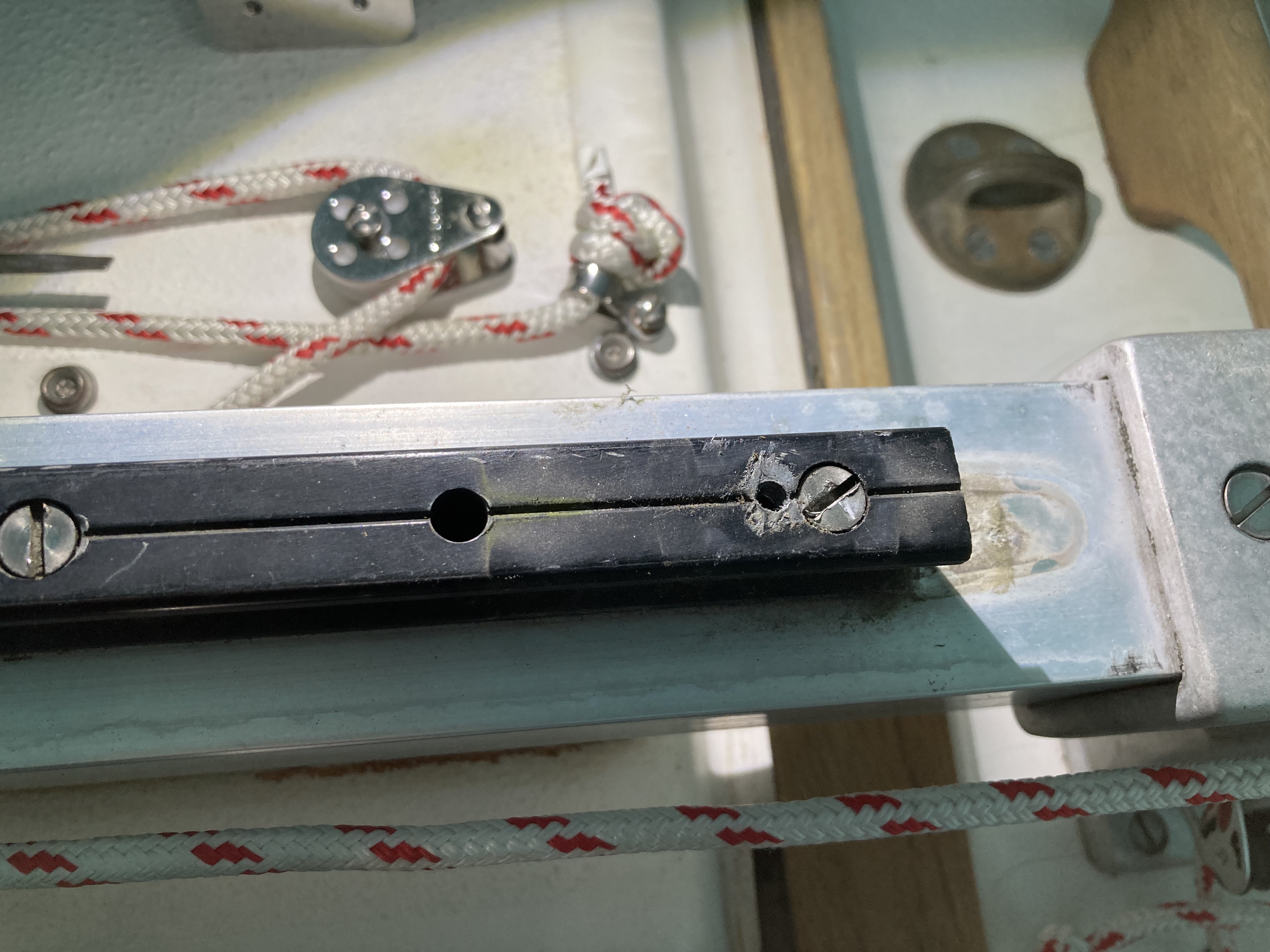

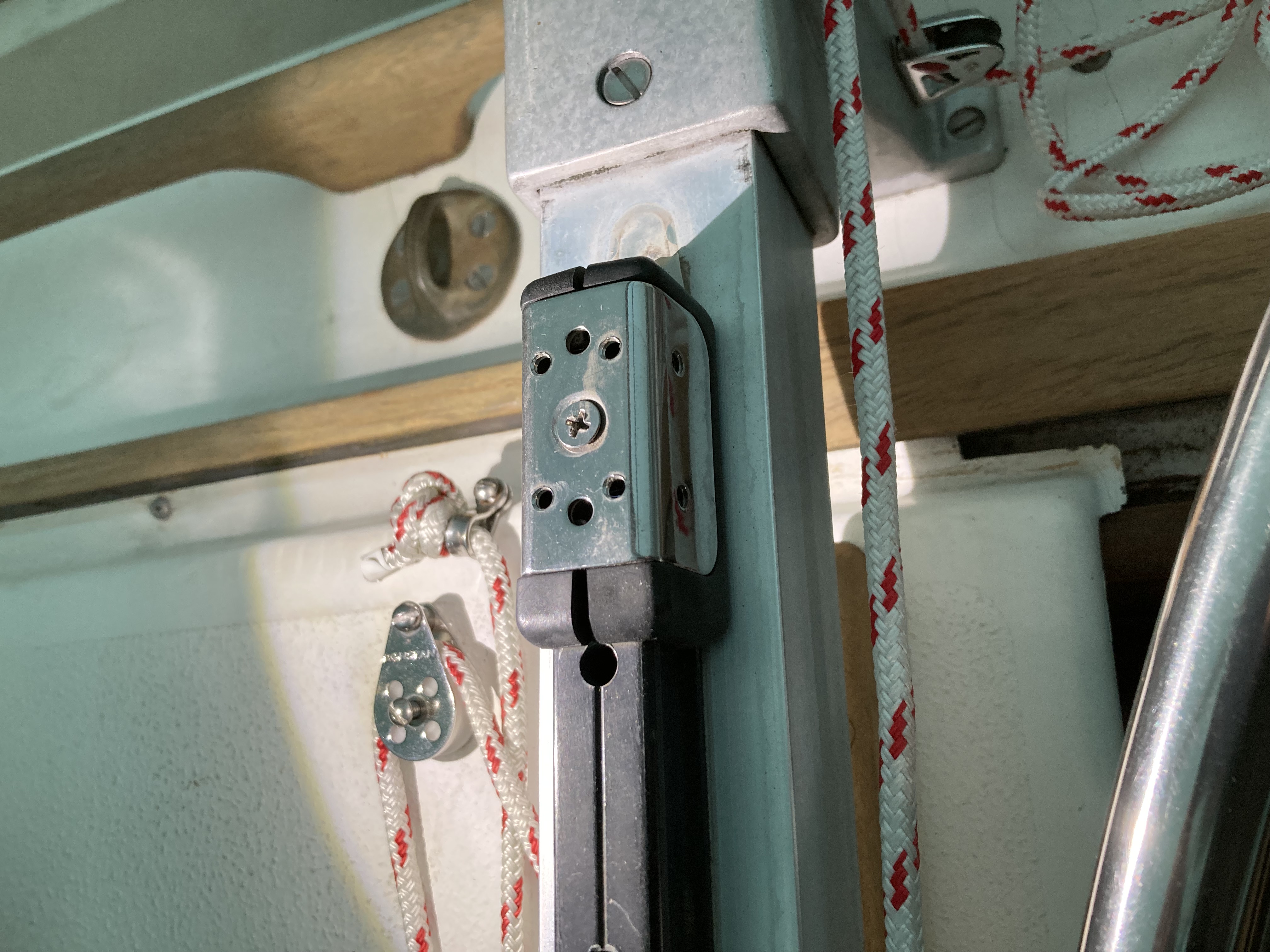

How did you attach the end caps to the T-track? It looks lie they have #4 or #6 threads. I don't see any fasteners in your photos except on the cheek blocks. Did you drill or tap into the T-track and use a machine screw on the forward side?

Attached the end pieces, drilled/tapped on the top of the track, with #10 Philips head machine screws 3/8” length.
