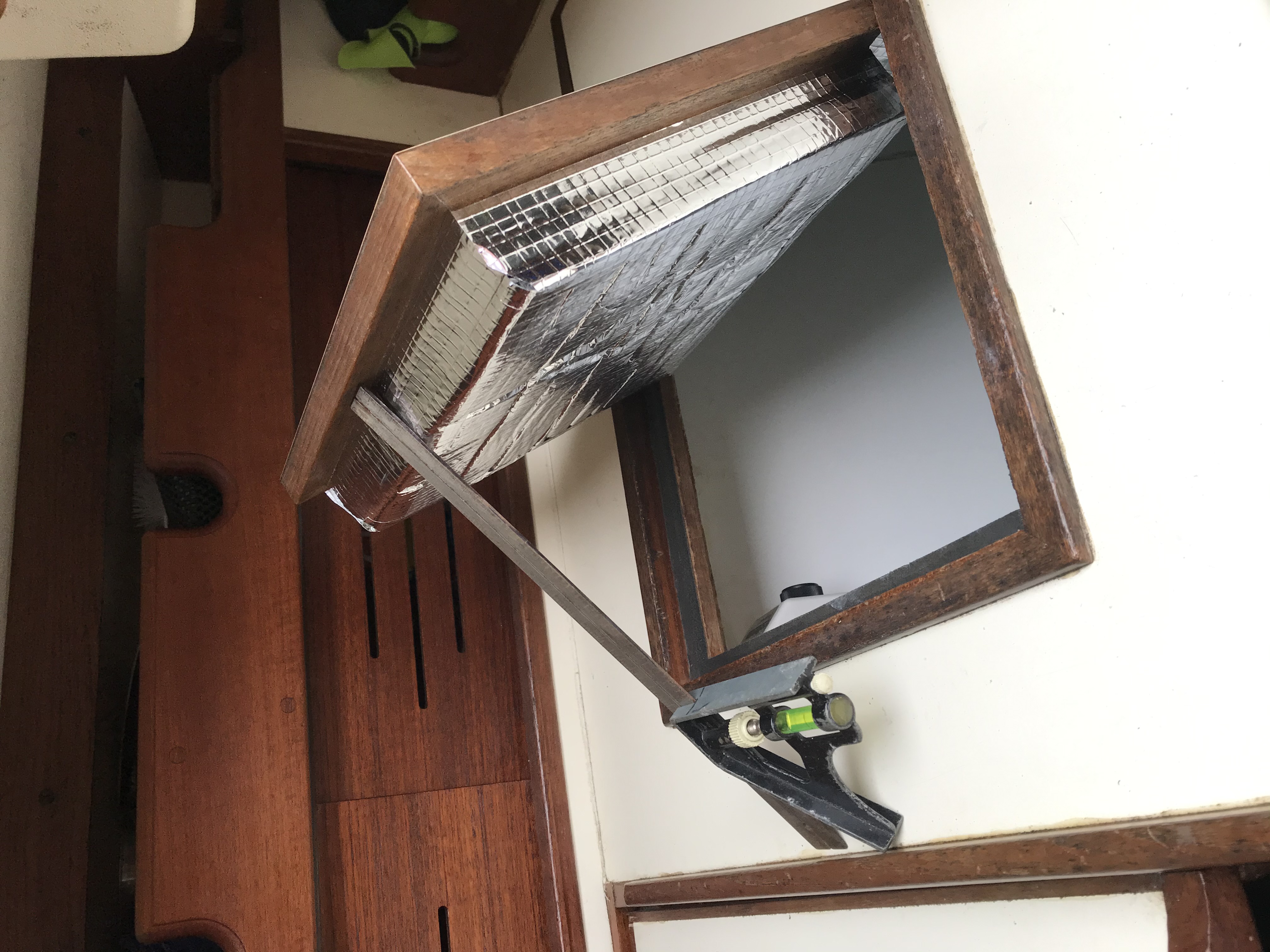

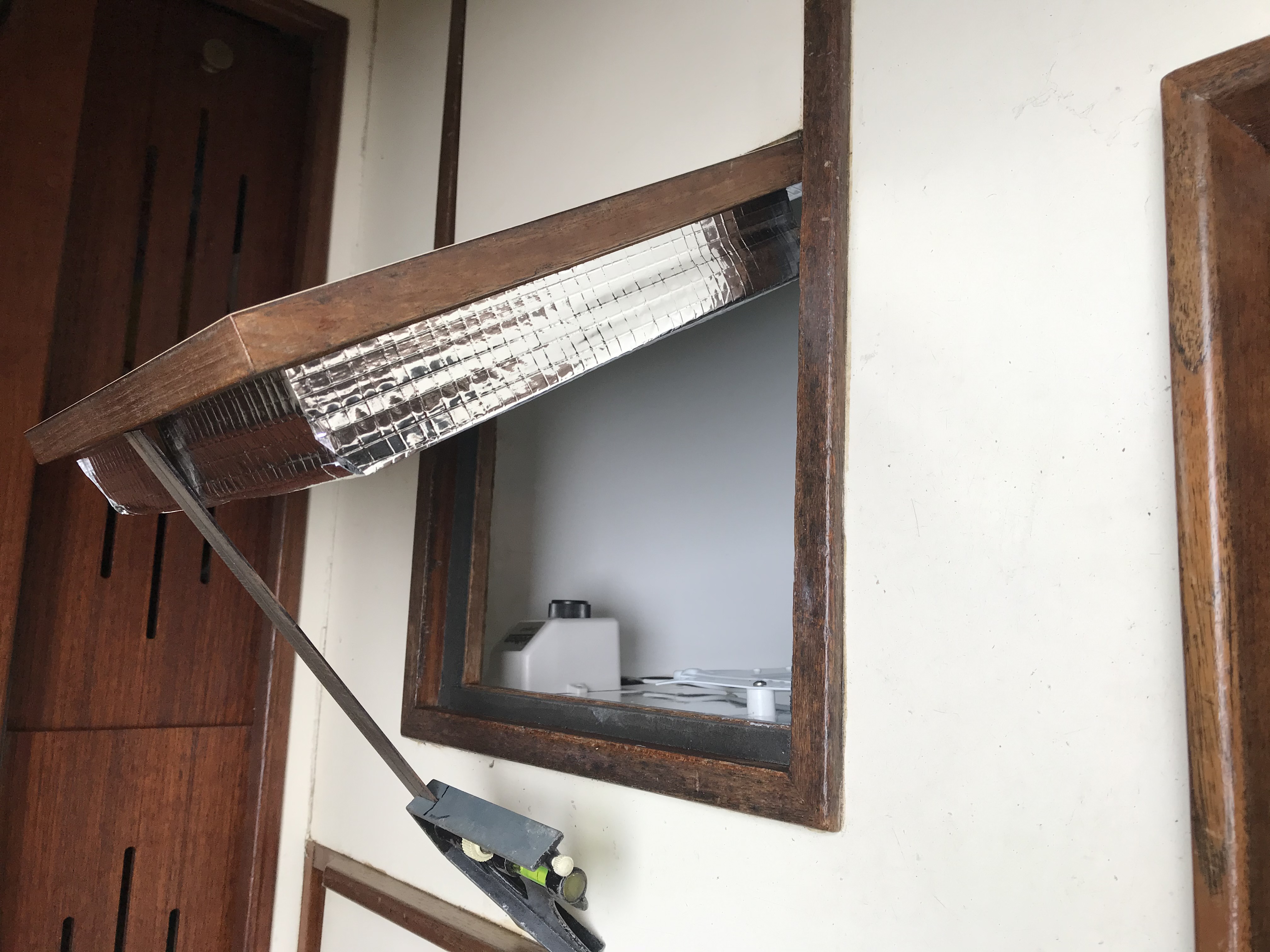

Here’s a couple pics of my solution for insulating my original “butterfly” style icebox hatch. I used the same foam sheets I insulated the rest of the icebox with but I doubled them up so it’s 2” thick (it already had some insulation). I used 4200 to glue the insulation to the cover and I used the reinforced alumanized tape to make it easy to keep clean. I didn’t know if the tape was up to the task but it adhered wonderfully. It’s the tape which is used on the seams of sound insulating panels in engine compartments. Not the most elegant solution but it really is up to the task.jbenagh wrote: ↑Mar 5th, '24, 09:49 I went and looked at the data I took on our 3 week Maine cruise in '22. I saw 0.7A per hour which is 16.8Ah per day. It was pretty warm that year, the water was often 70F and air temps were often over 80F during the day.
If I did it again, I think I would skip the drilling holes and expanding foam. It was a lot of additional work and made something of a mess when the foam escaped through gaps in the cabinetry. With all the insulation I added inside, I'm not sure it made much difference.
Note I did not insulate the top or the hatch because it seemed to difficult. We laid a blanket or towel on top many days, like 60%.
Jeff
When you tap or double click on the images they turn right side up…if you’re lucky

Very neatly done Jim.Jim Walsh wrote: ↑Mar 6th, '24, 23:42Here’s a couple pics of my solution for insulating my original “butterfly” style icebox hatch. I used the same foam sheets I insulated the rest of the icebox with but I doubled them up so it’s 2” thick (it already had some insulation). I used 4200 to glue the insulation to the cover and I used the reinforced alumanized tape to make it easy to keep clean. I didn’t know if the tape was up to the task but it adhered wonderfully. It’s the tape which is used on the seams of sound insulating panels in engine compartments. Not the most elegant solution but it really is up to the task.jbenagh wrote: ↑Mar 5th, '24, 09:49 I went and looked at the data I took on our 3 week Maine cruise in '22. I saw 0.7A per hour which is 16.8Ah per day. It was pretty warm that year, the water was often 70F and air temps were often over 80F during the day.
Jeff
When you tap or double click on the images they turn right side up…if you’re lucky![]()

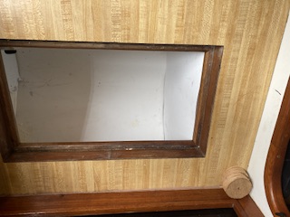

I Insulated the ice box with 2” foam R-10. I ended up sheeting it with the polymer plastic stuff. I didn’t like that stuff cuz it stains and looks very dirty. I did insulate the top but not the butterfly hatch. It’s 2” thick with nice bevel fit. Maybe it’s good. I can’t wait to see the difference it makes.
I really lost a lot of pantry space.
I also rebuilt the base of the battery compartment. I used 3/4” oak set on strips of oak cleats. Now it’s supported on all sides. I think I need better hold down straps or brackets
