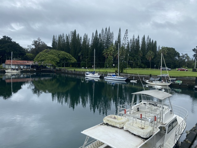

Here is a photo of Hilo Bay sampam harbor. I don’t think there are any more sampams here. They used to unload their catch at that fish market for auction. An old Hawaiian guy lives on that Pearson 30. He lets me tie my inflatable off his stern. He said I could bring my boat in if I want as his guest. I dont want to It’s to shallow. He gave me his card. It says Kingdom of the Hawaiian islands Harbor Master. There is so much algae. I cleaned it all off my water line this morning. I’m really gonna have to scrub the dinghey. I always wash and dry it so I can keep it in the v-berth. It’s 12 yrs old and still like new

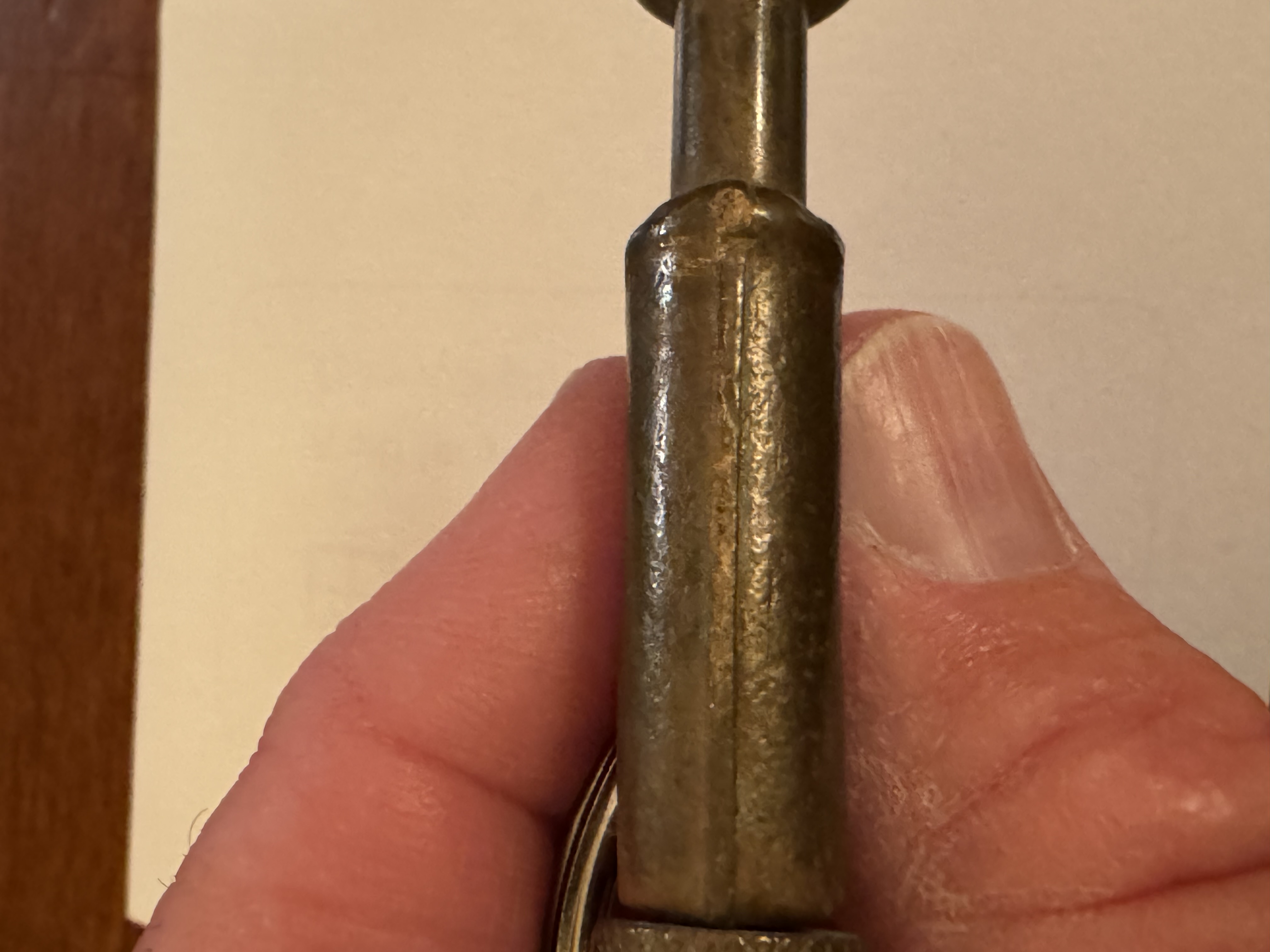

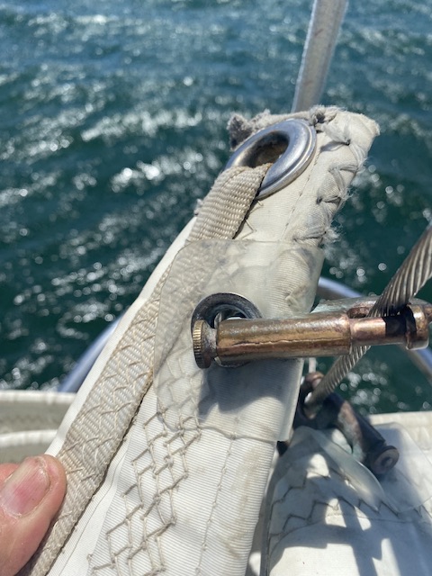

Got my headsail (club jib) back the loft guys sent it to the wrong place so it had to go back and resend here. At least I’m not in a hurry. I would expect a sailmaker to go over the whole thing not just what’s obvious. It cost half the price I paid for new. I lubed all the hanks with an anti corrosion stuff and noticed several hanks look like they are cracked. I looked at my other jib and they seem to have a seam there. Are these cracked or is that how they are made???

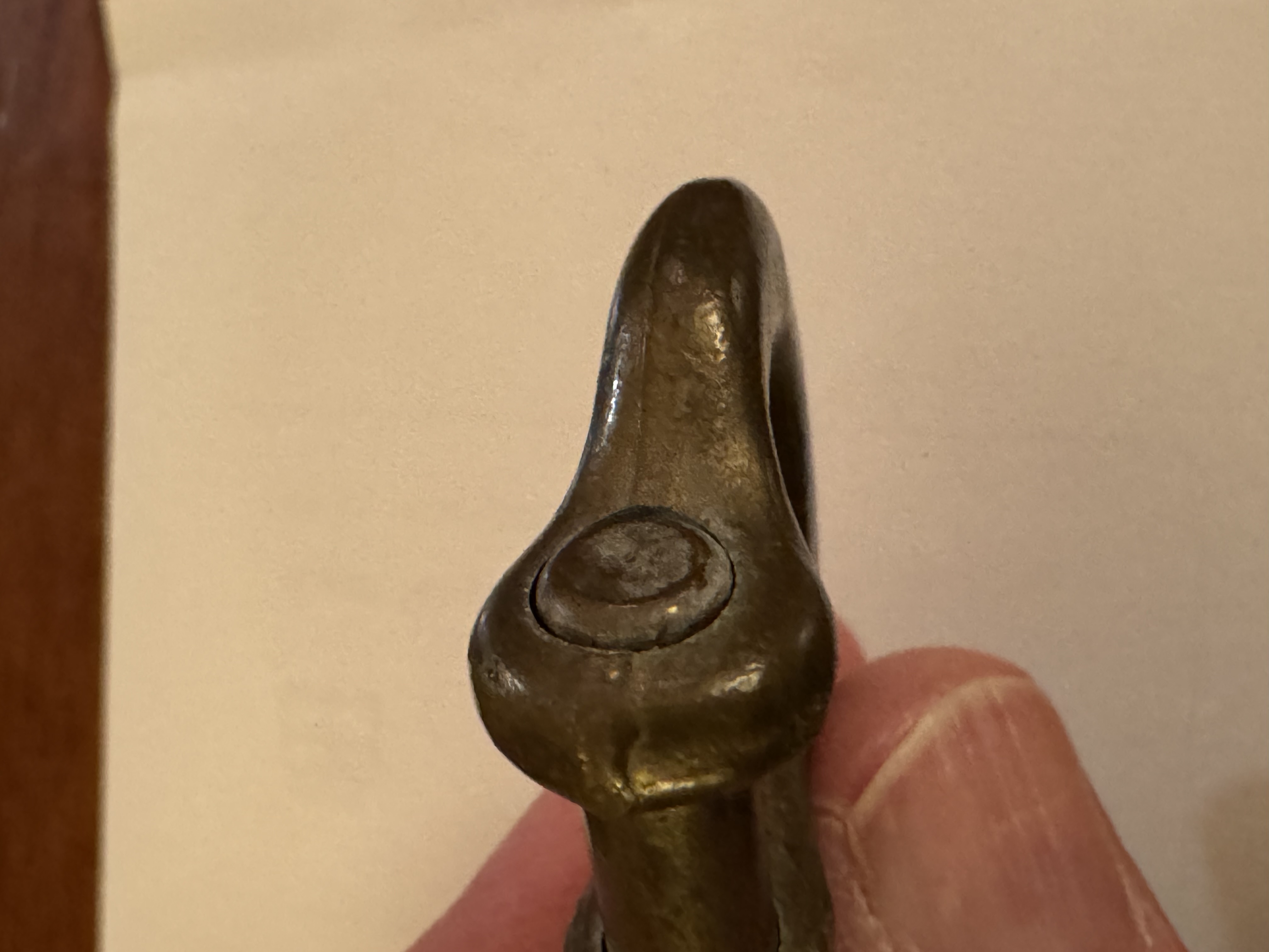

It appears that the hank body is cast or forged and that is a seam which was not deburred cleanly. If you look closely at these photos you can see the seam is evident all around on an old hank of mine. You can file the seam lightly to ensure it is not a crack.

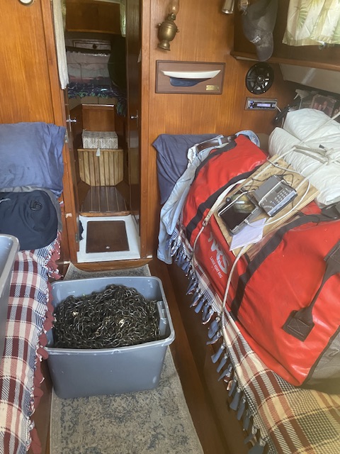

The trip was pretty uneventful except about 8 days calm. I use the engine. The noise doesn’t bother me. I used to work in engine rooms with screaming Jimmys and never bothered with the ear muffs. The reason I decided not to go to Kodiak is because the boat is not ready. I was on close reach for 1000 miles. Leaking everywhere from the hull/deck seam. It has to be that. Ive bedded and rebedded the hardware so many times it just looks like they are still leaking. I can’t be that stupid. Ive watched every utube video I could find and followed the directions exactly. I’m getting ready to schedule work back at Ensenada to reseal the deck joint Probably March. Also the bow was dipping too much so I pulled the anchor chain back into the bilge alley and the inflatable to the main salon. When the water tank up there is empty I can put the inflatable back on the v-berth.
