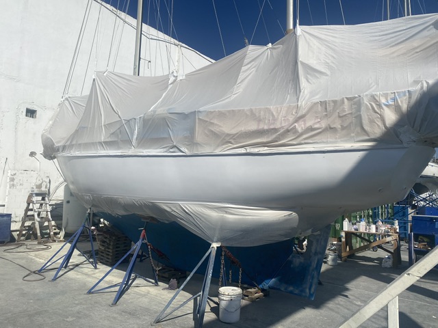

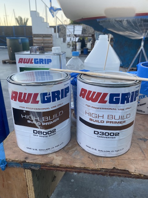

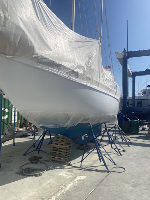

Prices are 1/3 of California so I let them paint the sides. They ground out and filled every little blemish then primed and sanded 4 coats with this high build primer. I’m so glad. I didn’t try this myself. I would have just lightly sanded and started painting. It looks so nice. They are recommending a color that can be easily identified for later touch ups. I think it will be oyster white. Also they are trying out Awl Grips newest products on my boat. They promised a discount. I think they are not charging for the paint and primer. I only had to agree to send them photos in three years but I think I will be back then

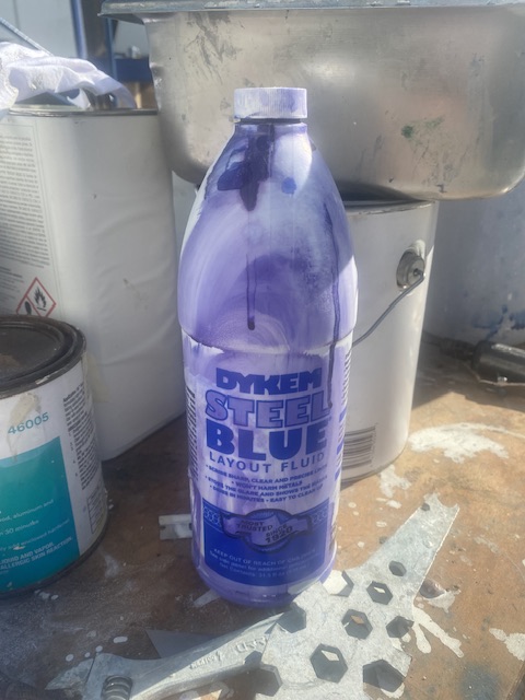

They put this blue stuff on this morning. It makes the flaws stand out so they know where to sand. I think the finishing primer next

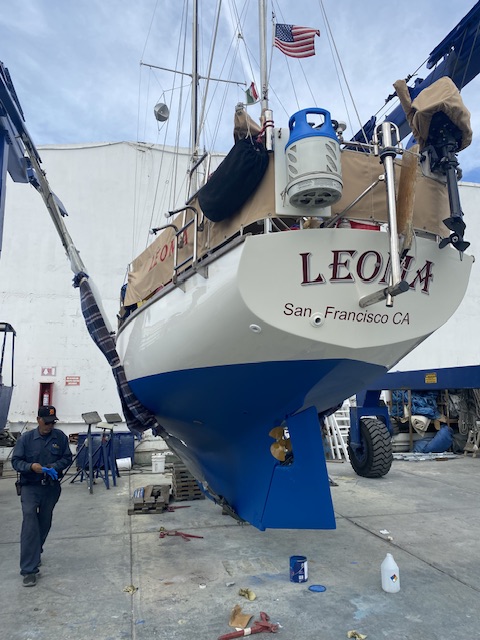

Launching now. I can’t believe the invoice was only $6500. Includes topsides. Bottom paint. Raise water line two inches install thru hull and coat prop. And lettering. They do excellent work. Evan the water line. They sanded, applied fairing compound then barrier coat and primer and three coats of anti fouling paint. I love it I attached a before pic also. They also repaired the rudder. The mechanic who installed the engine set the prop to far out at first. his diver put epoxy on it and told me it was only scratched( Not) It was a lot worse than the let me believe

That looks fantastic…and all for a bargain price. Congratulations!
