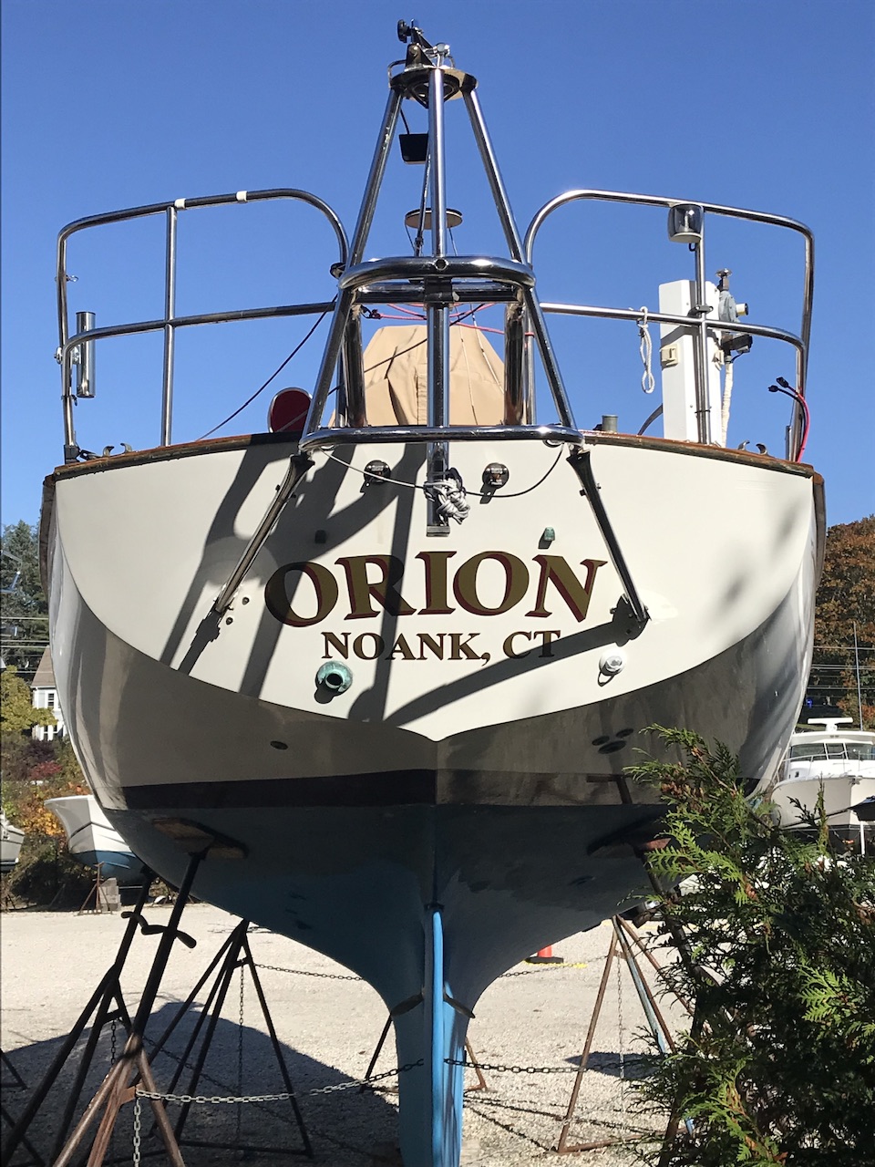

Orion’s sixteen year old name and homeport were looking a bit scruffy so I ordered replacements through BoatUS. The name selection app has numerous choices and the software has a realtime image so you can see what your choices have resulted in…seems complicated initially but very easy to work with.
Orion’s existing name and homeport were removed with a hard plastic putty knife onto which I ground a sharp edge. It worked great but the glue residue still remained. Acetone made short work of the final cleanup and leaves no residue.
Applying the new name is a bit intimidating because you want to avoid creases and bubbles but it’s one of those jobs that’s far simpler than imagined if you follow the application instructions.

Catching up on the forum. Looks great Jim.
