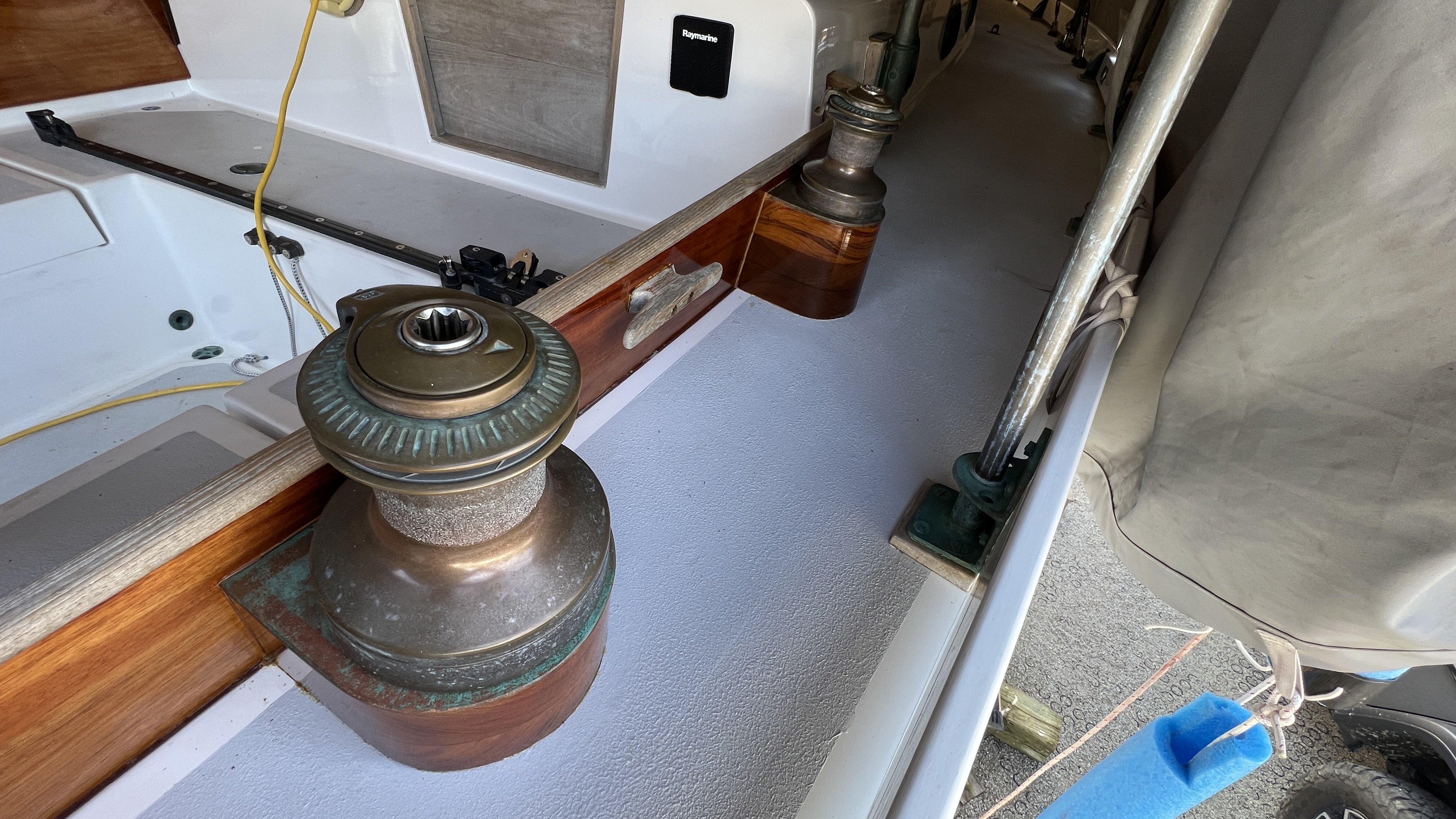

Here is the link to the winch pad build that fits into this thread for the coaming build.

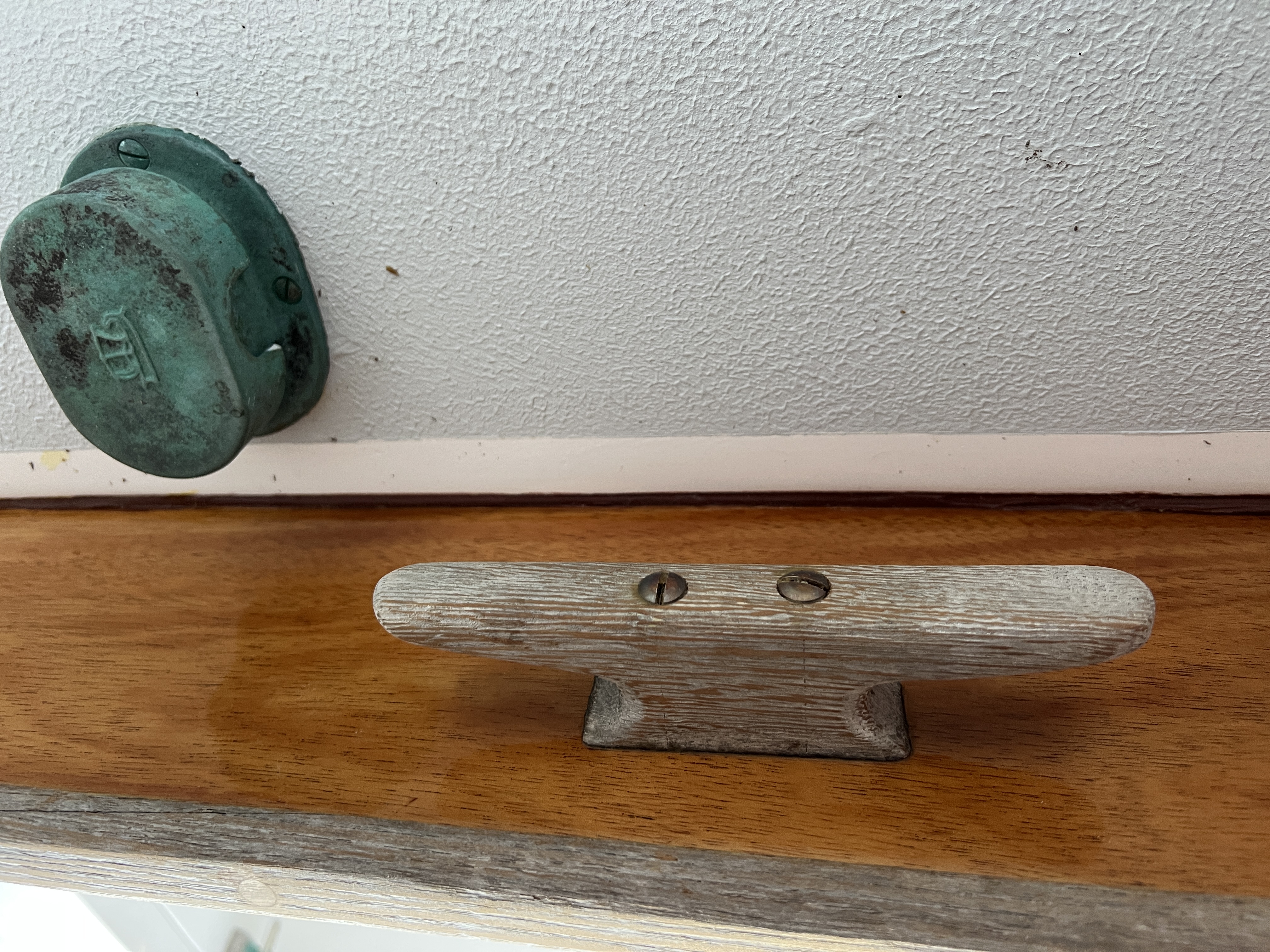

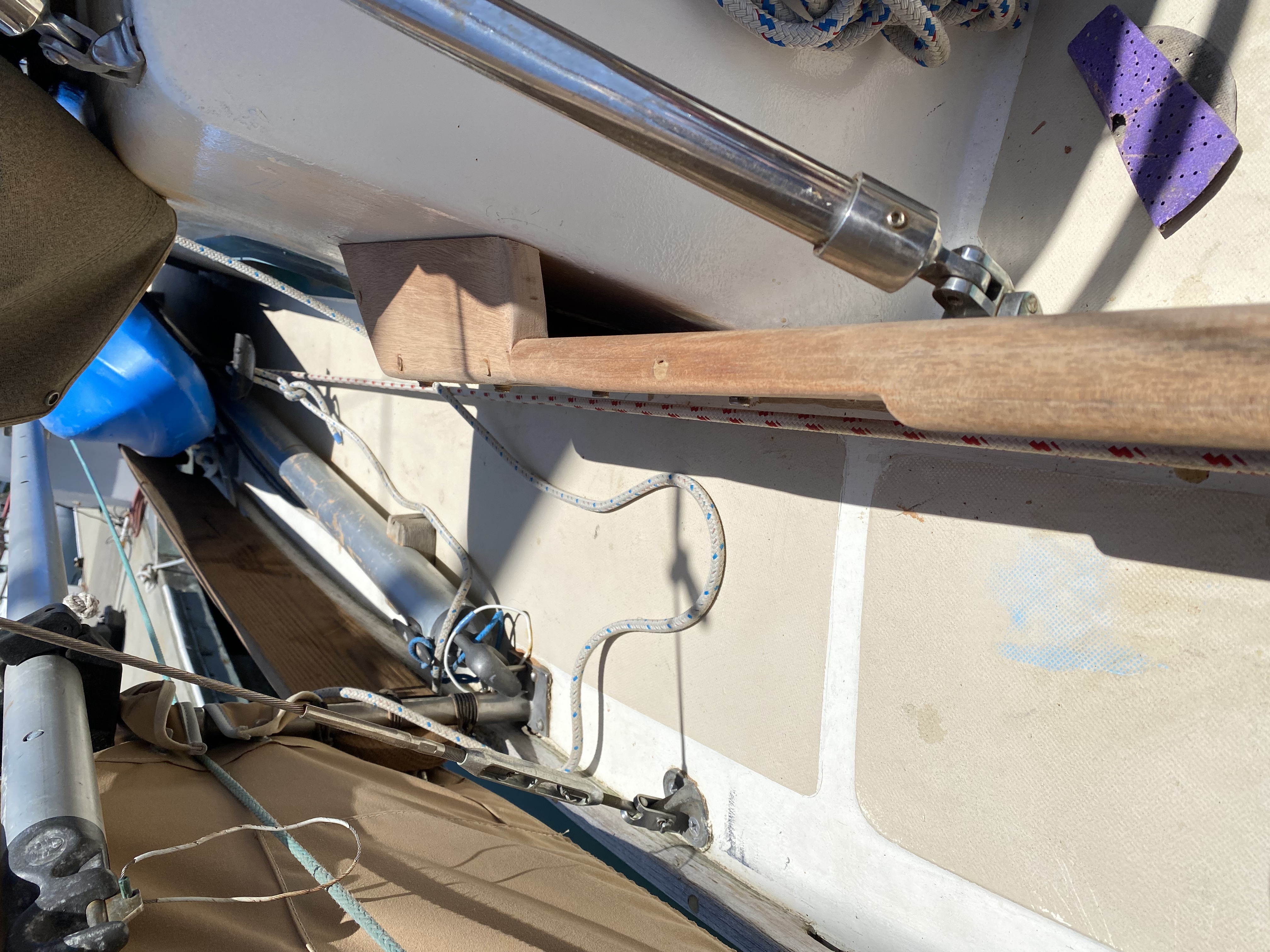

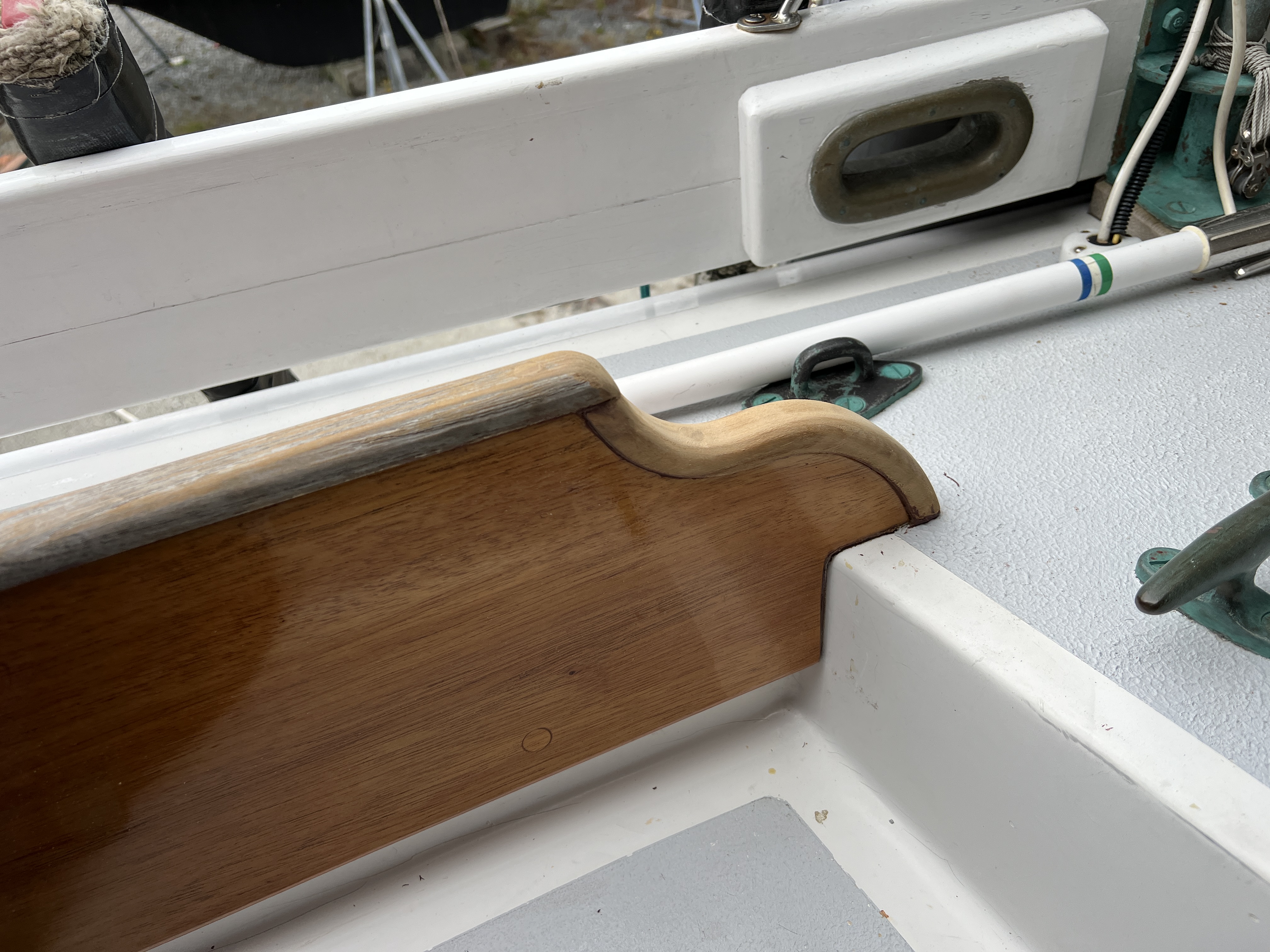

Re: Cockpit Coaming Rebuild

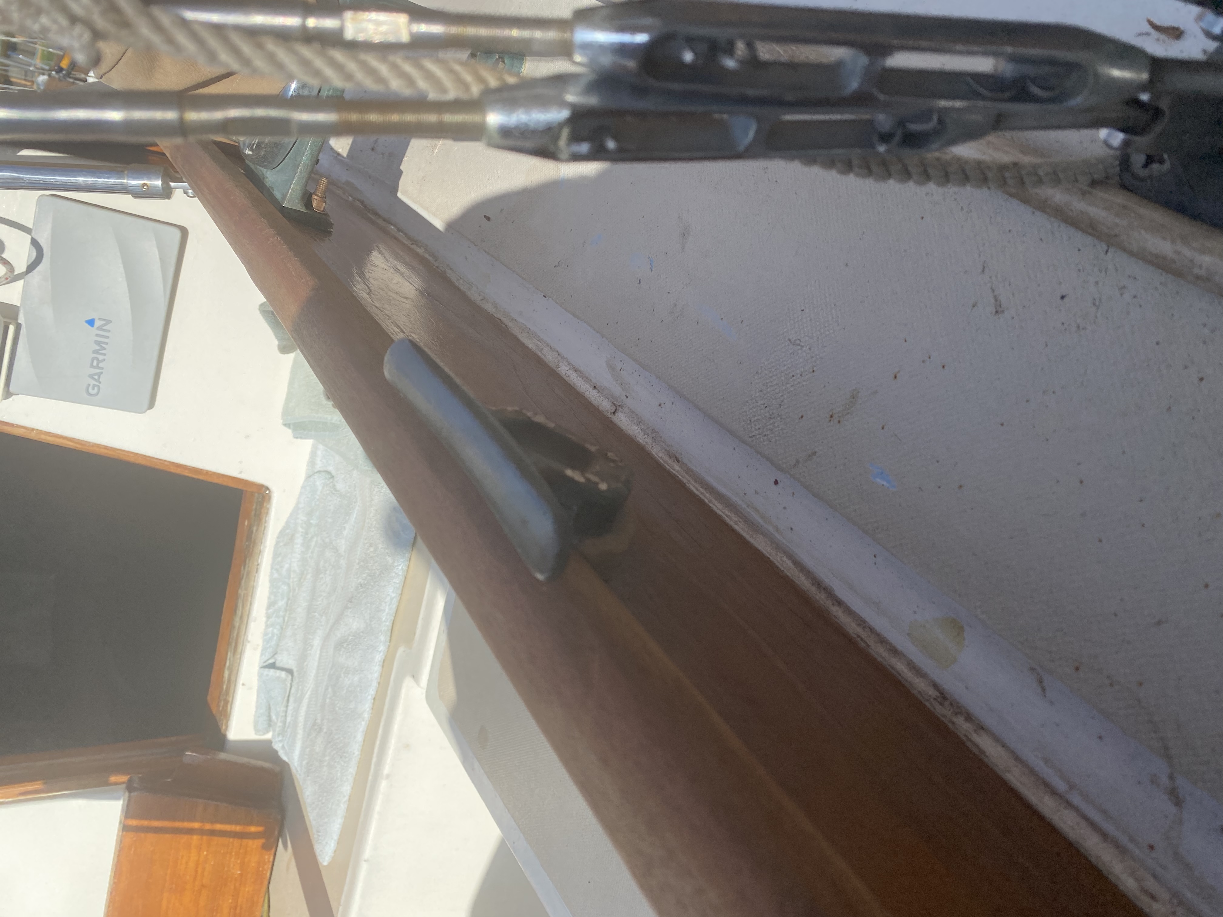

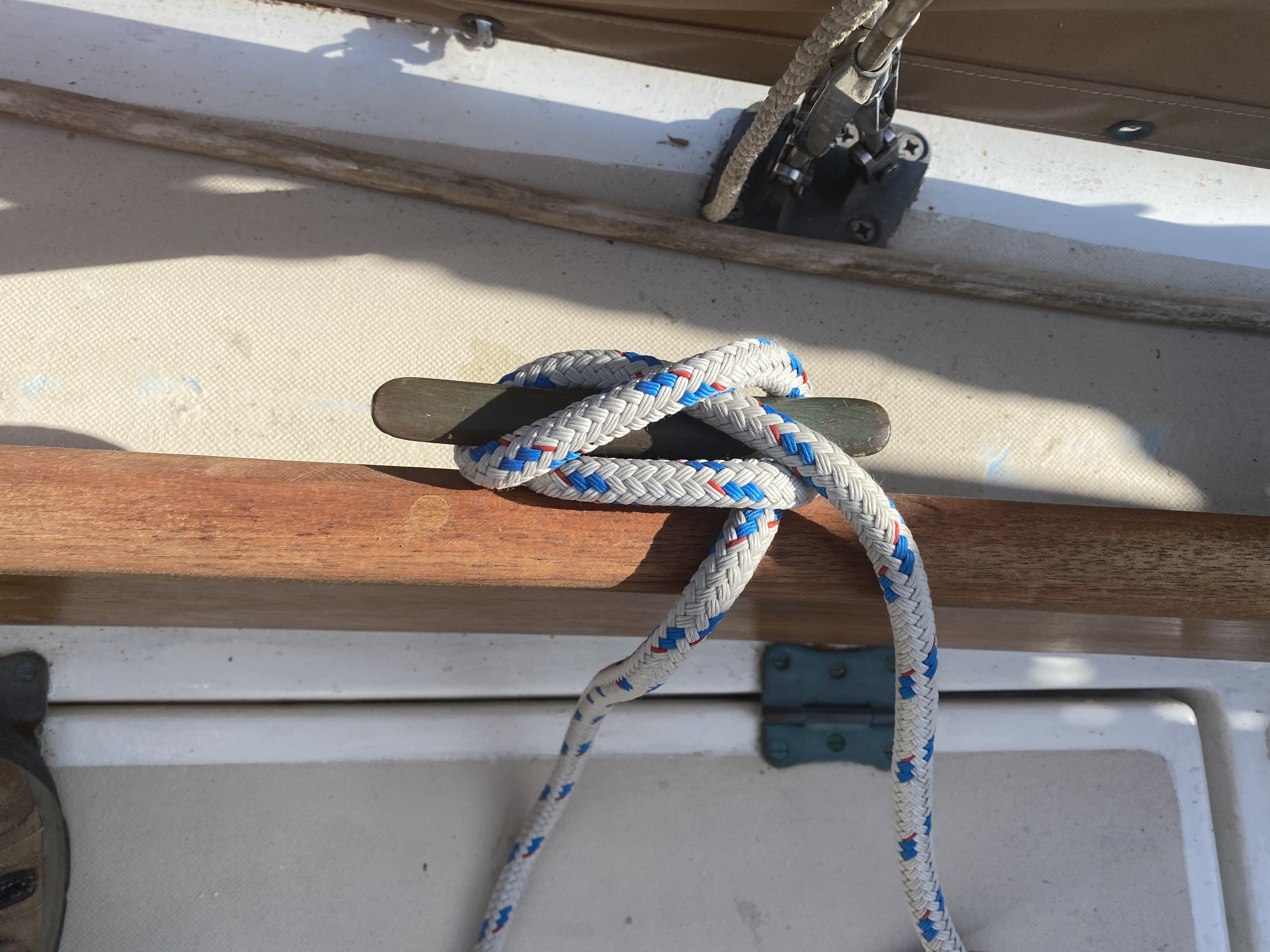

I’m a little careless now since I’m working with one arm in a sling but I used a piece of scrap teak for the return. It will be ok for now. It’s tricky because the dodger needs to snap down there. I have an idea to redo it with a mahogany block/cap that covers that whole void there where it meets the cabin. Anyway the dodger covers all that corner. I used a teak spacer for the cleat and sanded a little so the 1/2” line would fit. This will do for a while. I know it all looks pretty terrible (return piece and the calking etc) but the coaming boards have some rott and splits. hopefully some day I can redo it all brand new and perfect. I just want functionality now.

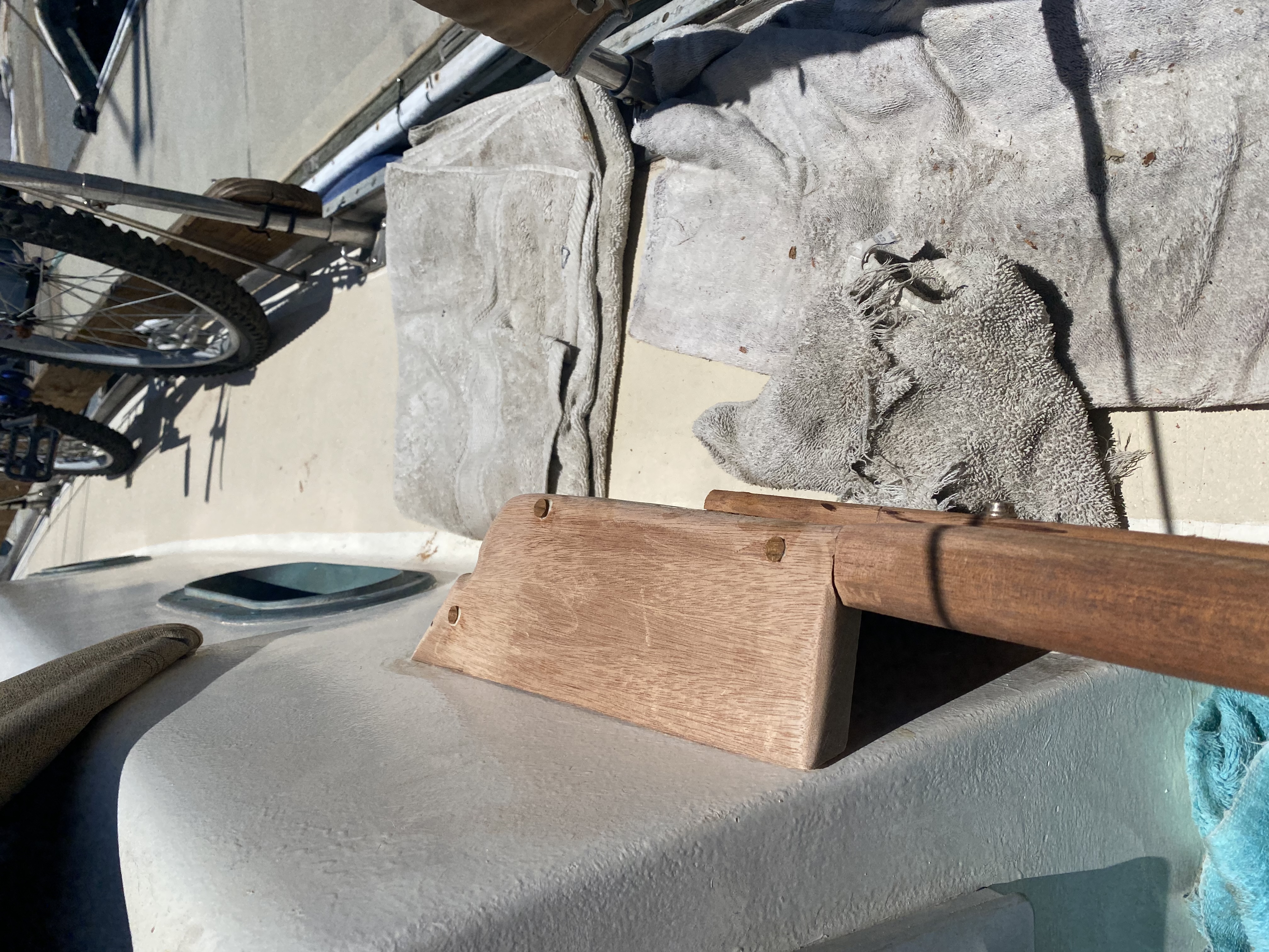

I was surprised how inexpensive the Afrikan mohoghany is compared to teak. I decided to refinish the forward end of the coaming cap. As you see it had to be grinded so the dodger will snap But Im ok with it like this. I'll clean it up a little and oil it.
Looks great. I never liked the way that Cape Dory built that area, hard to clean, even harder to varnish.
What is going to go into those inaccessible areas that can never be repainted, I am picturing little birds nests or perhaps, as we have here in the Midwest, wasps.

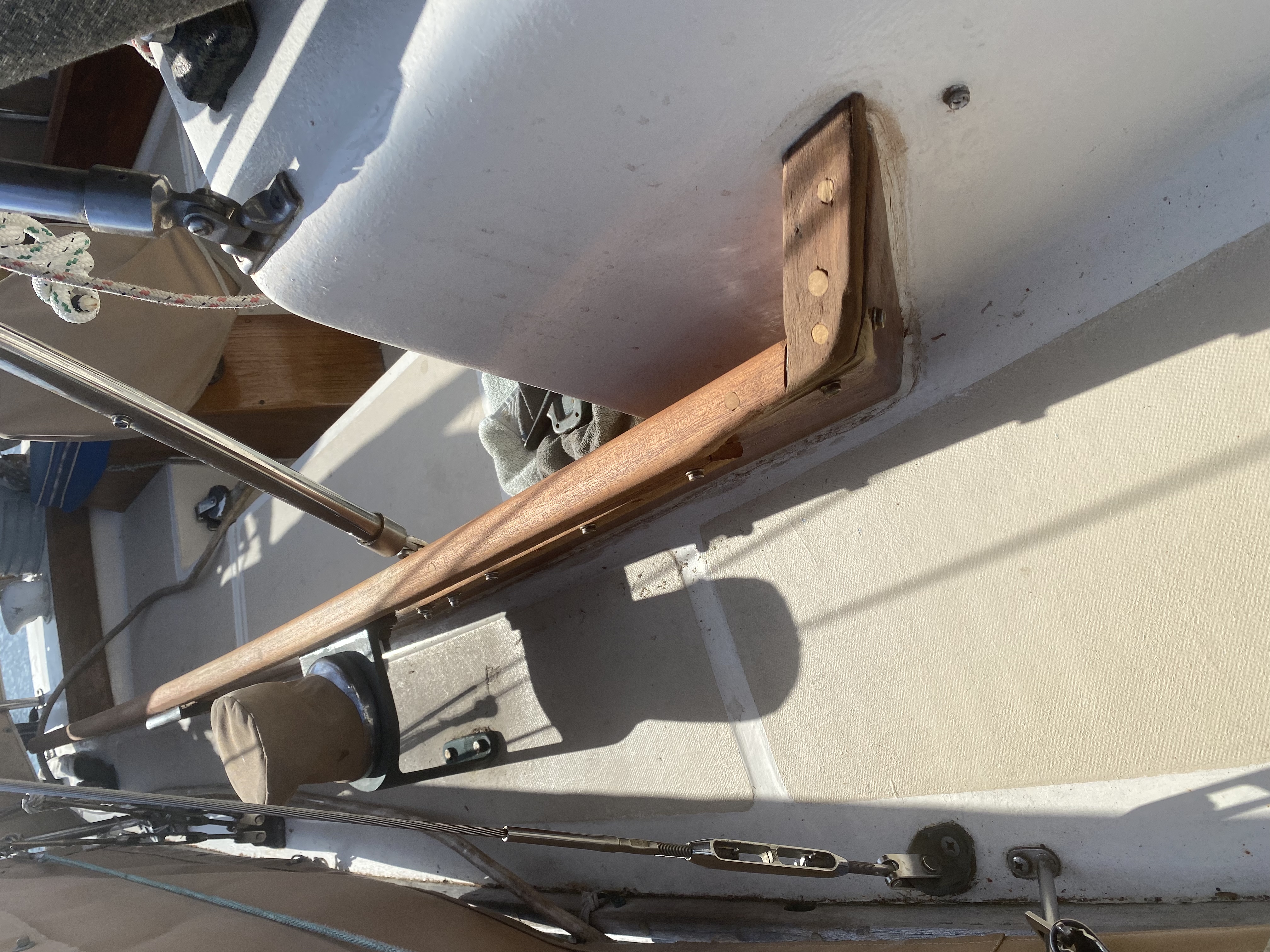

Port side came out much better. I sanded the outboard edge so the dodger would snap without that strip that is on the other side. I am reworking the starboard side now

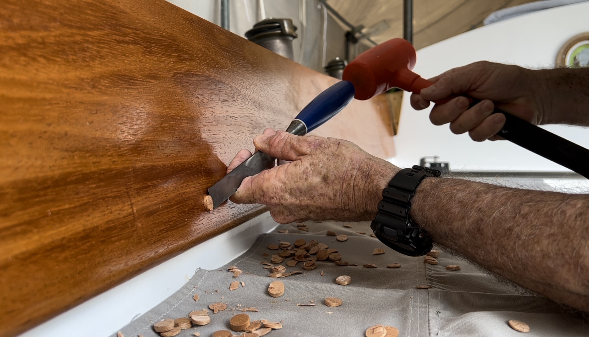

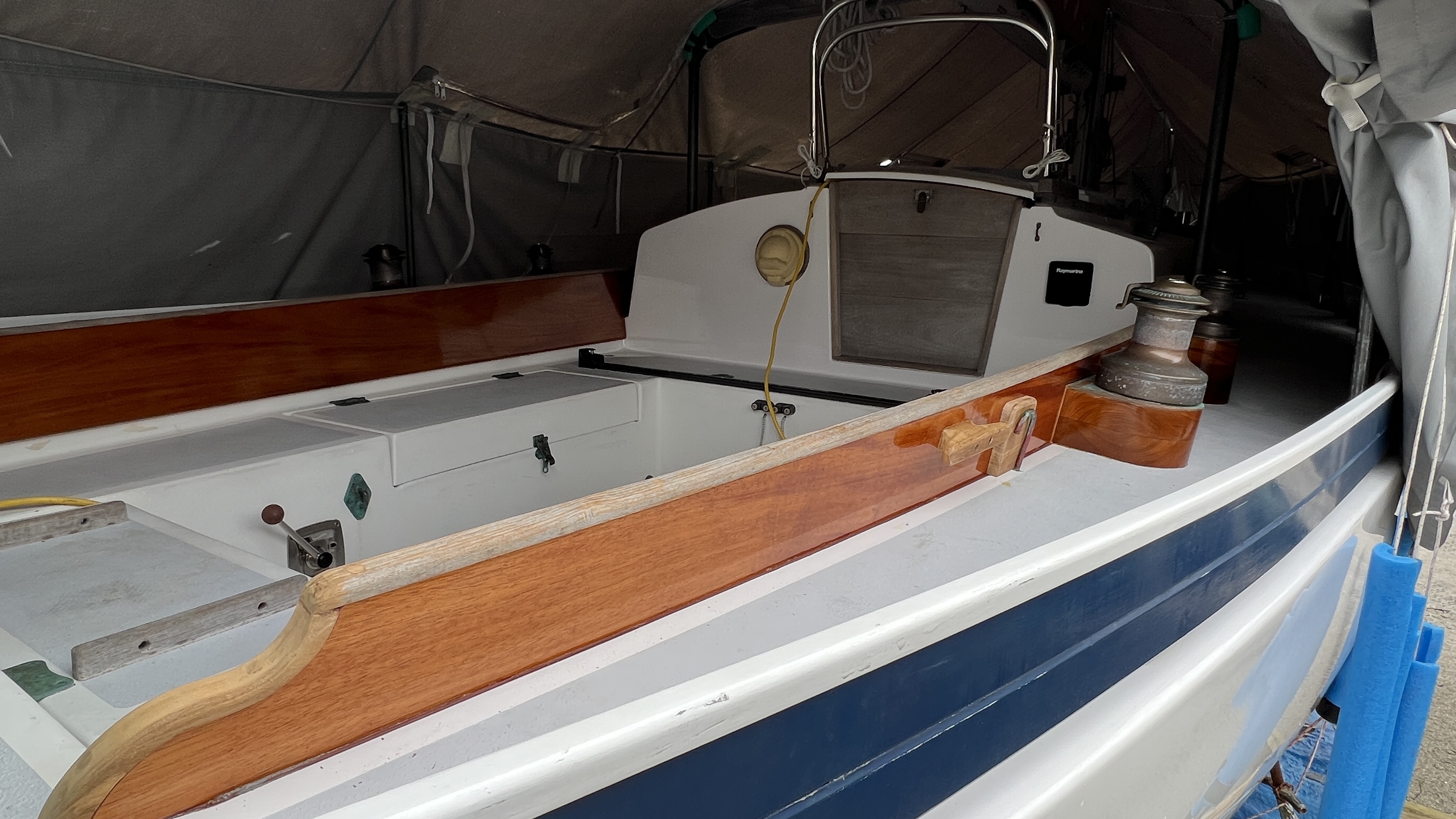

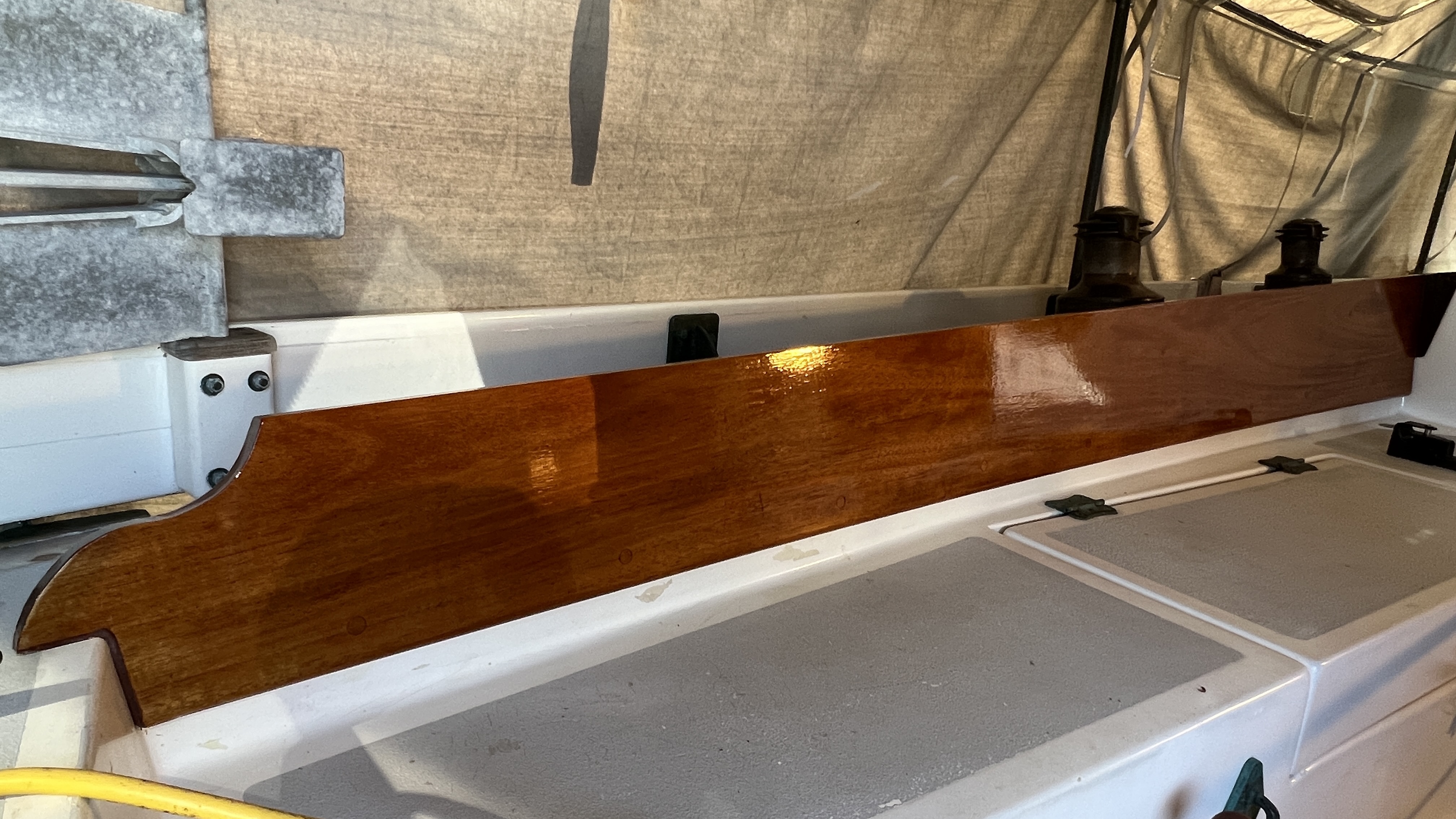

Now that the forum is back up and operating it is time to update the thread in the coaming rebuild. It's complete. Bare cap installed. 9 coats of varnish. Turned out well I think. Some photos below. Will look for a better overall photo with the cap rail.
Cockpit coamings complete. I also posted a video on the complete project to include the teak cap rails.
