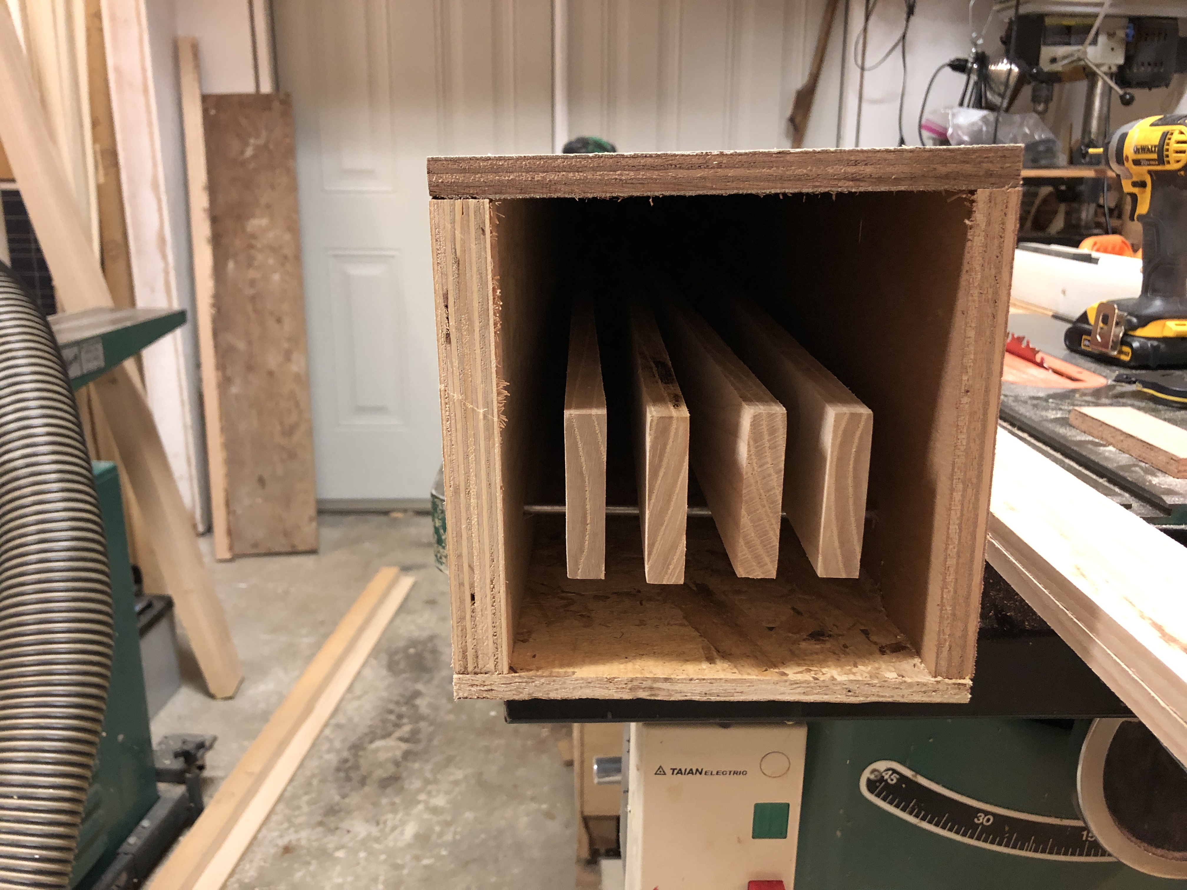

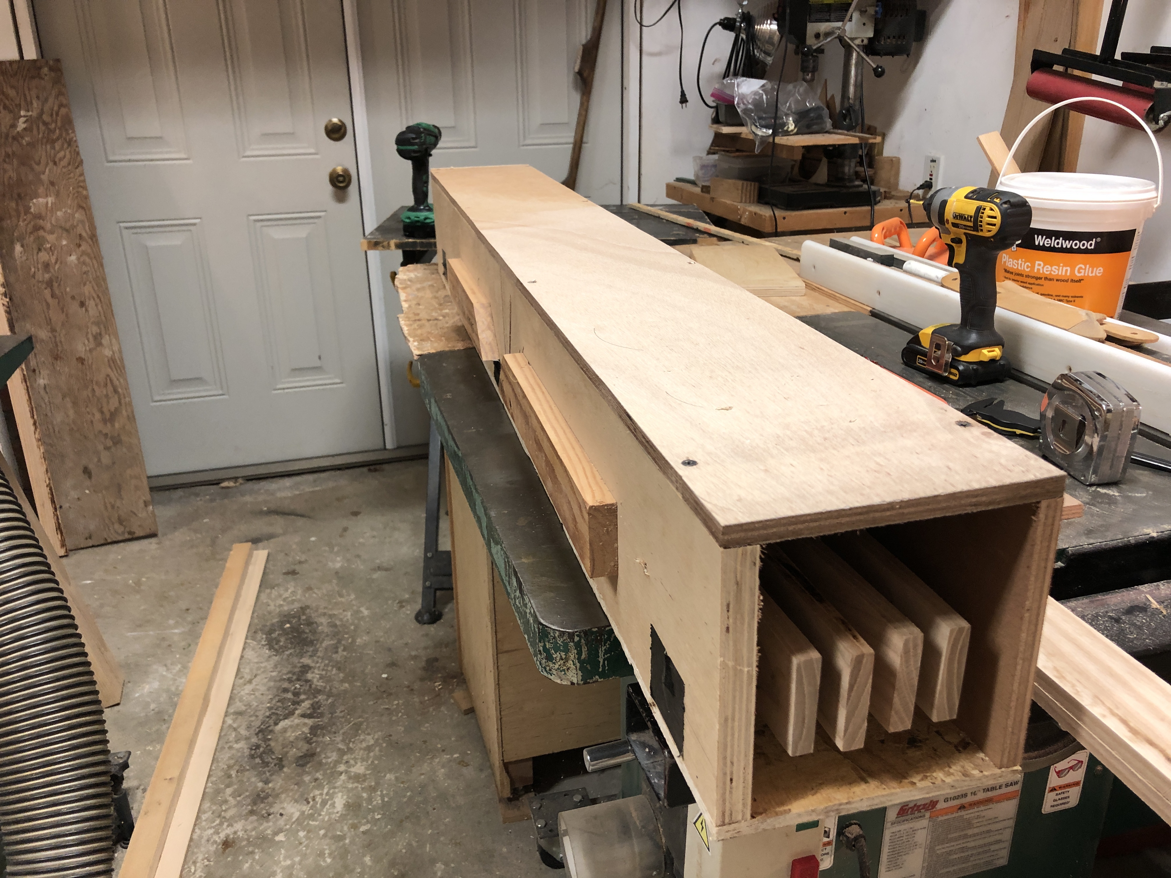

Steam box almost complete. I used scraps of siding from our shed build. On the side I used a plywood jig I keep for crown molding. LOL. A piece of 1088 scrap. A piece of 3/4" birch ply from 10 years ago. Dry wall screws. Some old 3/16" rod. I'll get a cheap hinge tomorrow. I don't think the tea kettle holds enough water.
5/8" on thick end so stem at 200° + for 40 min. Sound about right? I'll make hole in bottom for steam inlet. Maybe drill a hole in top for temp gauge.
What's a cull? Is that like a support block to keep it flat to the jig as you bend it around?

Should have a little vent hole in the top. I wouldn't worry about the temperature. Just start your timing when you get a good show of steam, coming out of the vent hole. put the whole set up, somewhere where it will be okay if it drips. The tea kettle would probably work. I didn't seem to use a whole lot of water to make the steam.
Now you will think of all sorts of projects that will need bent wood, Steve.

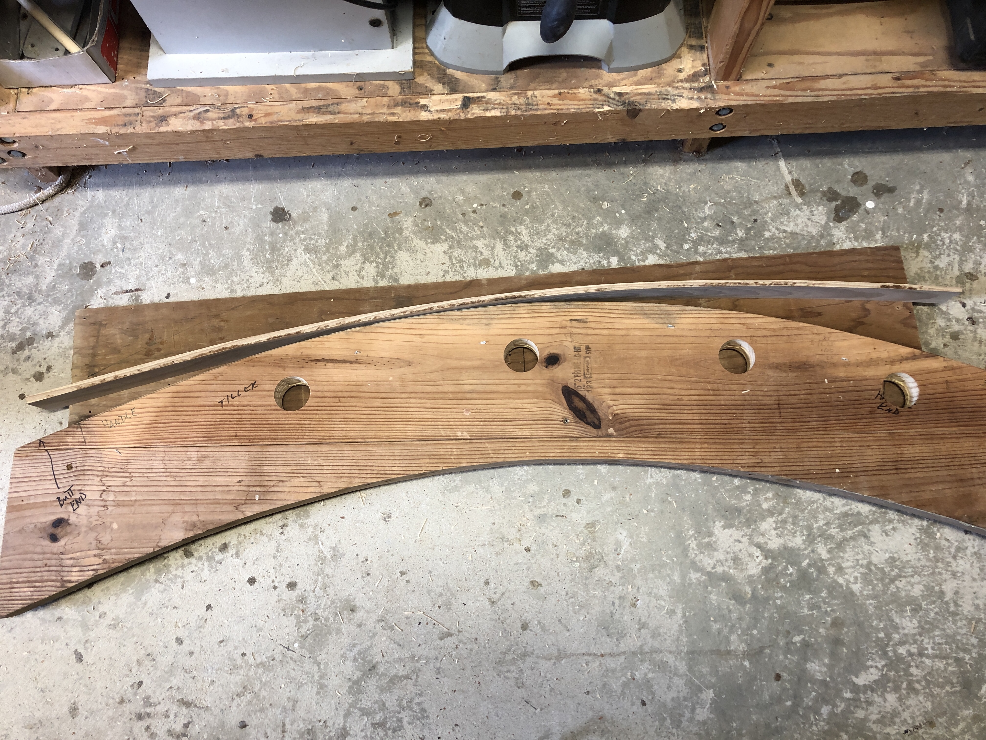

Got distracted with other projects. I unclamped the steam bent ash. Significant spring back. Not sure why. Not hot enough? Not long enough? The rule of thumb I have read suggested 1"=1 hour steaming. I steamed 1/2" thick for 45 min. So I have to extrapolate my next move.
In the meantime I made a better adjustable tapering jig. I also used double side tape to hold the wood against the jig face while cutting. I ripped five more strips. The new jig produced a flatter more consistent tapered strip.
I am contemplating whether I should put a little more bend in the jig to compensate for spring back or not. Maybe steam longer. Probably run another test resteaming the previously bent strips.

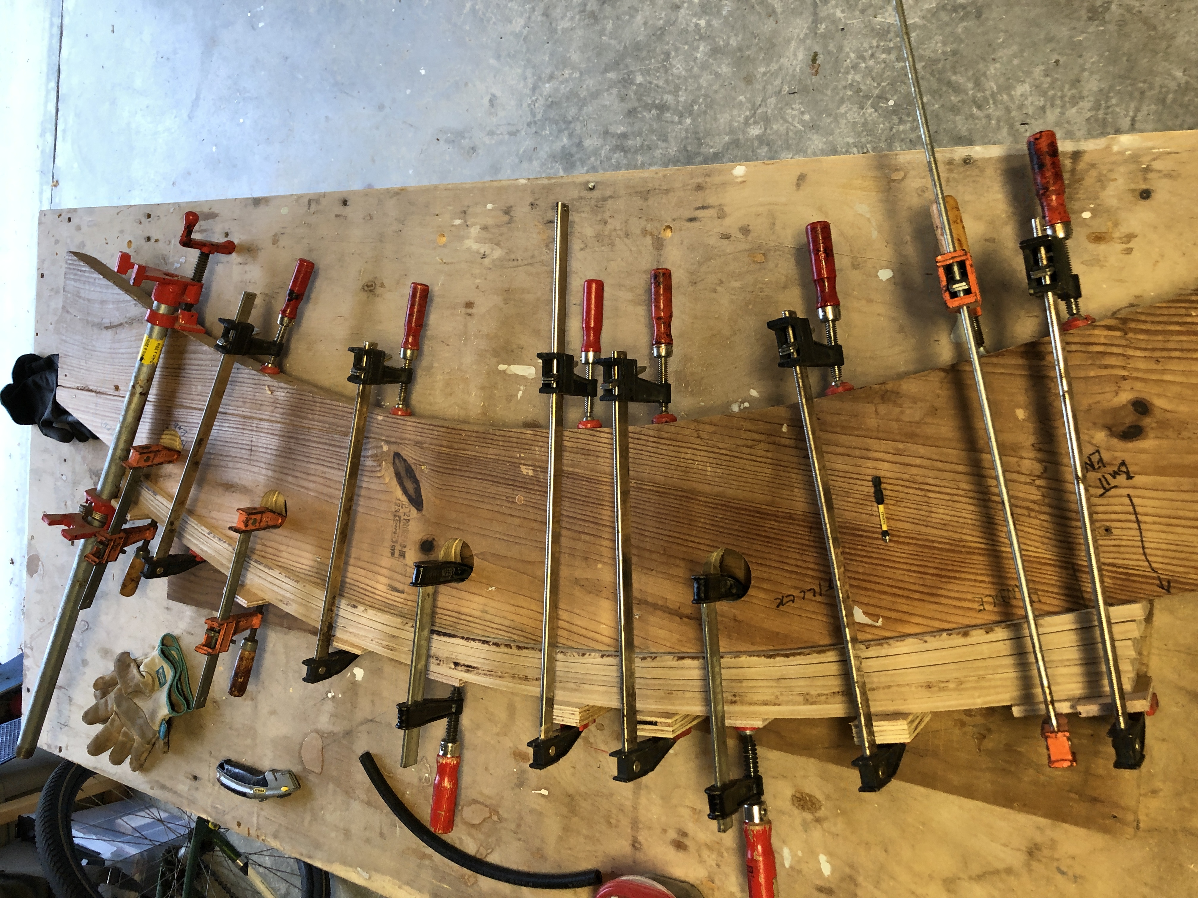

Giving it another try. Resteaming and bending two strips of ash. Let's see how they do. I have new ash strips ready to go if I get better results.
- Resteaming and rebending. Let's see how it goes.

Once you glue and clamp the strips, they should retain the shape. I have aways heard that you should use, air dried wood, instead of kiln dried for bending. Most of the wood, l have is local air dried stuff, so l have no direct experince with kiln dried wood.

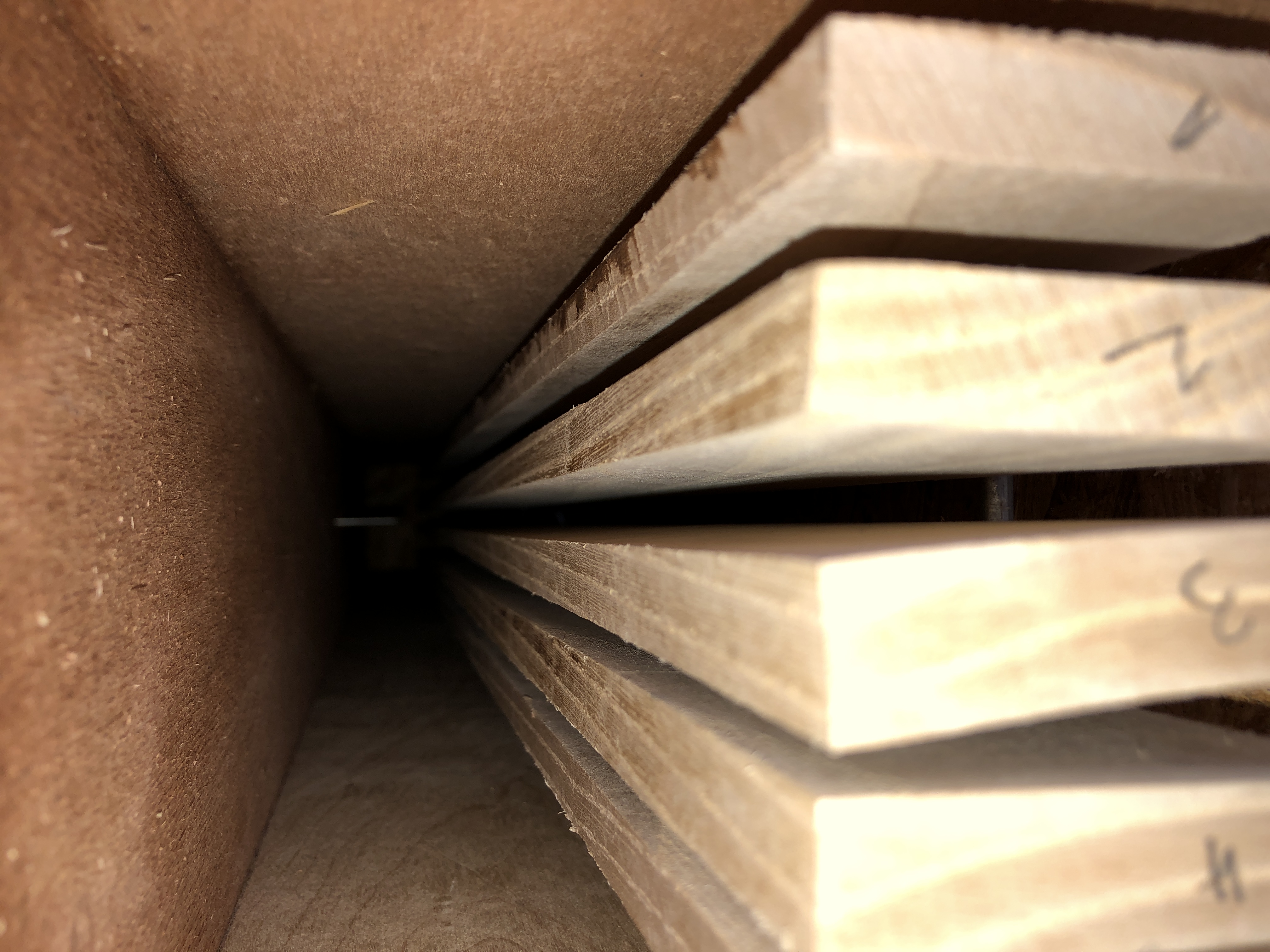

Thanks Steve and Bill for taking the time to comment. I read a similar article a couple days ago also in Fine Woodworking. I spent a little time today with a cabinet scraper removing saw tooth marks from the wood strips. I coated the ends of each piece of wood with shellack as the other article stated it would prevent excess water in the ends. Tonight I'll put them in the tub to soak for three days. Then steam and bend them. I also read adding ammonia to the water in the steamer helps make the wood more flexible. I read some negative comments about that step so not knowing any more than I do I'll skip that step. All this seems a little excessive for a laminated tiller but perhaps it will payoff. It's an interesting experiment. I am always up for learning something new. I'm not in a hurry. I have a fully functional tiller on the boat.

Regarding the laminated tiller build--the wood is soaking.
