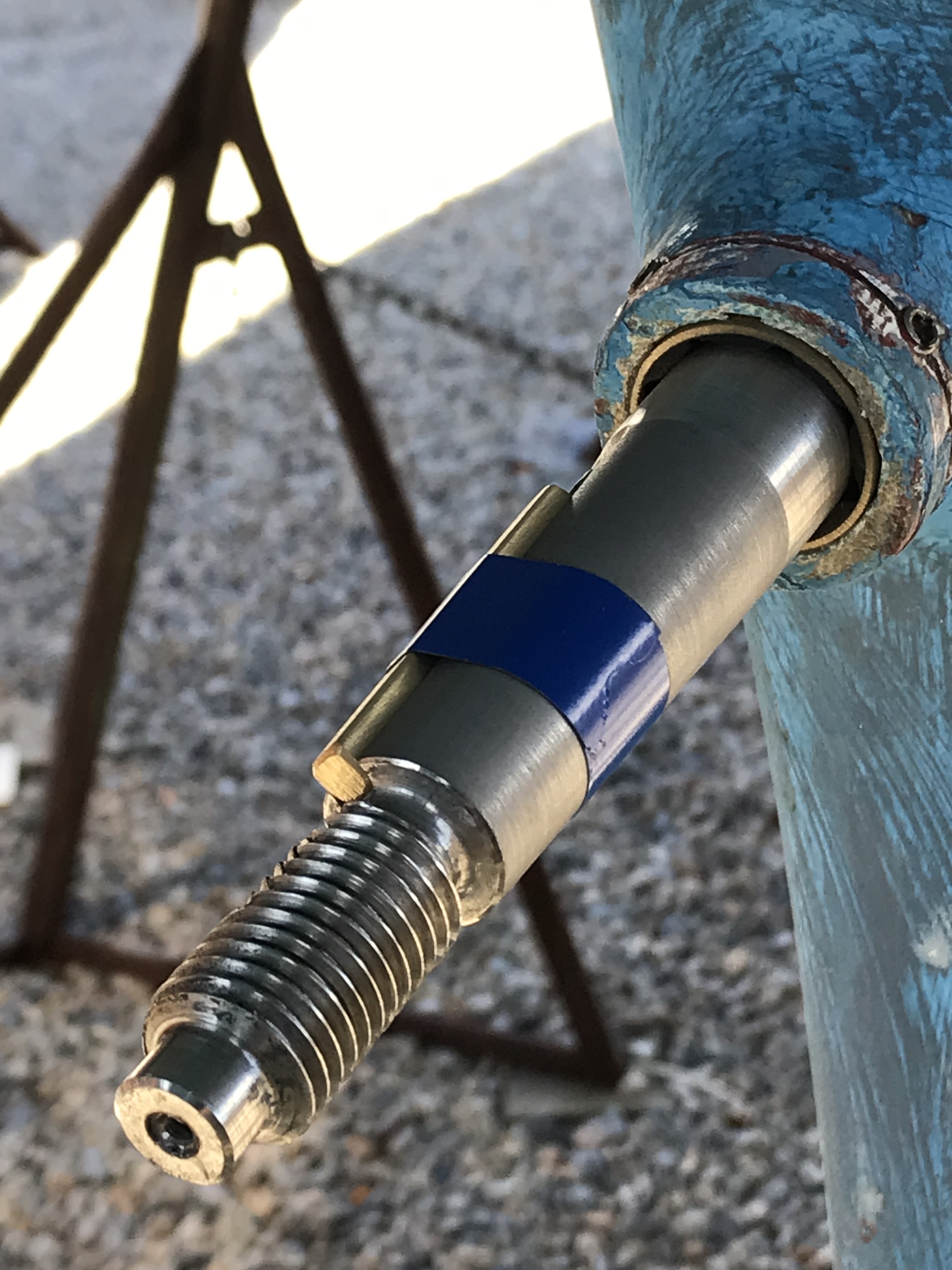

This project is completed. The shaft was shortened, balanced, faced to fit flush with the coupling, and the shaft was relieved to accept the coupling set screws. The prop hub and shaft were lapped for a precise fit and the keyway broached to accept a slightly longer shaft key. The PSS shaft seal was replaced with a PSS Pro Shaft seal, the latest iteration of the product. My original was about a dozen years old. The cutlass bearing was also replaced.
Shaft in place. Notice the lapped portion of the taper.
Prop in place. Centered in the aperture and plenty of blade tip clearance.

Pretty! Shiny! You're going to love the feathering prop.
Tip: Right after you launch the boat, find a spot of flat water with no current and log your speed through the water under power at 100 RPM intervals from idle speed to wide open throttle. You can use that information as backup "knotmeter" for speed under power should instruments fail, and also later on as a benchmark for how bad your underwater fouling has become to spur you to clean the bottom and prop as necessary. Also, compare your maximum RPM at wide open throttle to the engine manufacturer's specs to help determine if the prop is pitched correctly.
Smooth sailing,
Jim
