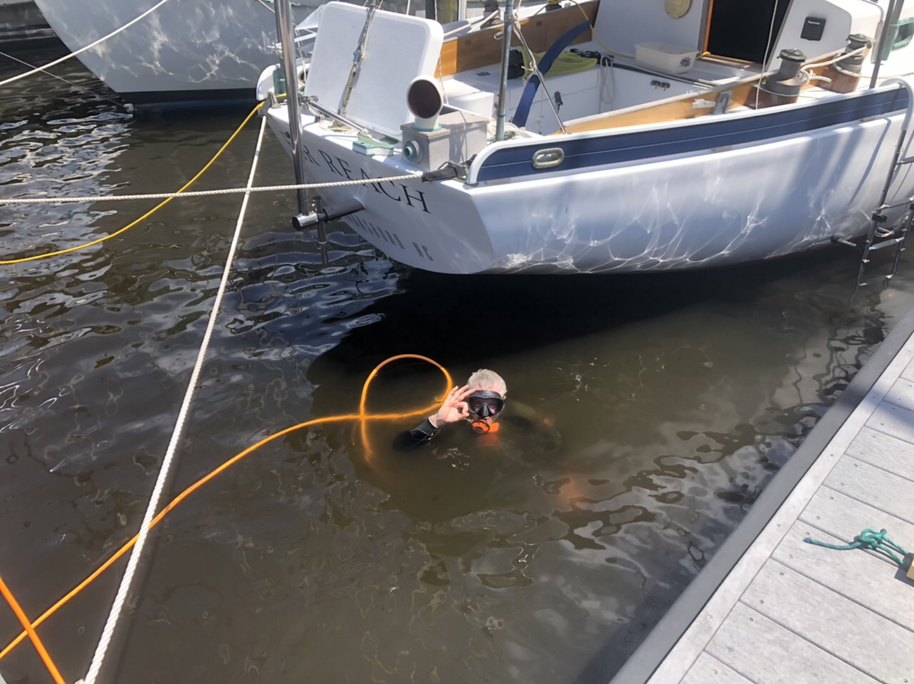

Gayle and I took the Far Reach out on a test run Saturday morning. We ran her across the Neuse River perpendicular to a light wind and mild current. We motored her at selected RPMs checking the Instrument gauge tachometer against the digital photo optical tachometer I purchased. Gayle steered a compass heading and worked the throttle while I compared the two tachometers being careful not to get my hand sucked into the water pump/alternator belt. The bottom line is at wide open throttle our Beta tach was 320 RPM low. So our Flex O Fold prop was actually attaining 3,280 RPM vice the ideal 3,600 RPM. The error rate was low at idle and increased in a linear manner as the throttle was increased.
I shared the info with Flex O Fold and they recalculated our prop specs. They report their computer calculation still shows 16X12 is right for boat and engine but also said that is not the reality so they have recommended we change to a 15X11. They are sending us new blades free of charge. I just have to return the old blades.
They told me one inch change in diameter corresponds to 250 change in RPM and one inch in pitch corresponds to 125-150 change in RPM. So we may end up about 50 RPM over 3,600 which Beta Engines says they prefer rather than be under on RPM.
Flex O Fold has been great through the whole process. It’s just one of those things.
To remove the prop I needed to get in the murky brackish water in our marina. We have alligators there. Most of the ones I have seen are on the smaller size of about 8’. But the wildlife officers told me there is a 12 footer just up the creek from our marina.
Yesterday, I donned my 3mm wetsuit, weight belt, and fins and rigged up the hookah and eased into the water. Gayle kept a lookout and handed me tools. I was prepared for a struggle with the prop but the two bolts I needed to remove to get the blades off came out easily. Even though the visibility under the stern was about 12” it was a simple event. We did not see any alligators. I don’t know if they saw me.
So, now I am waiting for the new blades to arrive from Denmark. In the meantime I will install the pram hood and pull the water tanks out of the boat to wash out the bilge. I also need to paint the bulwarks this summer. Can’t wait to get this project complete so we can start sailing.
