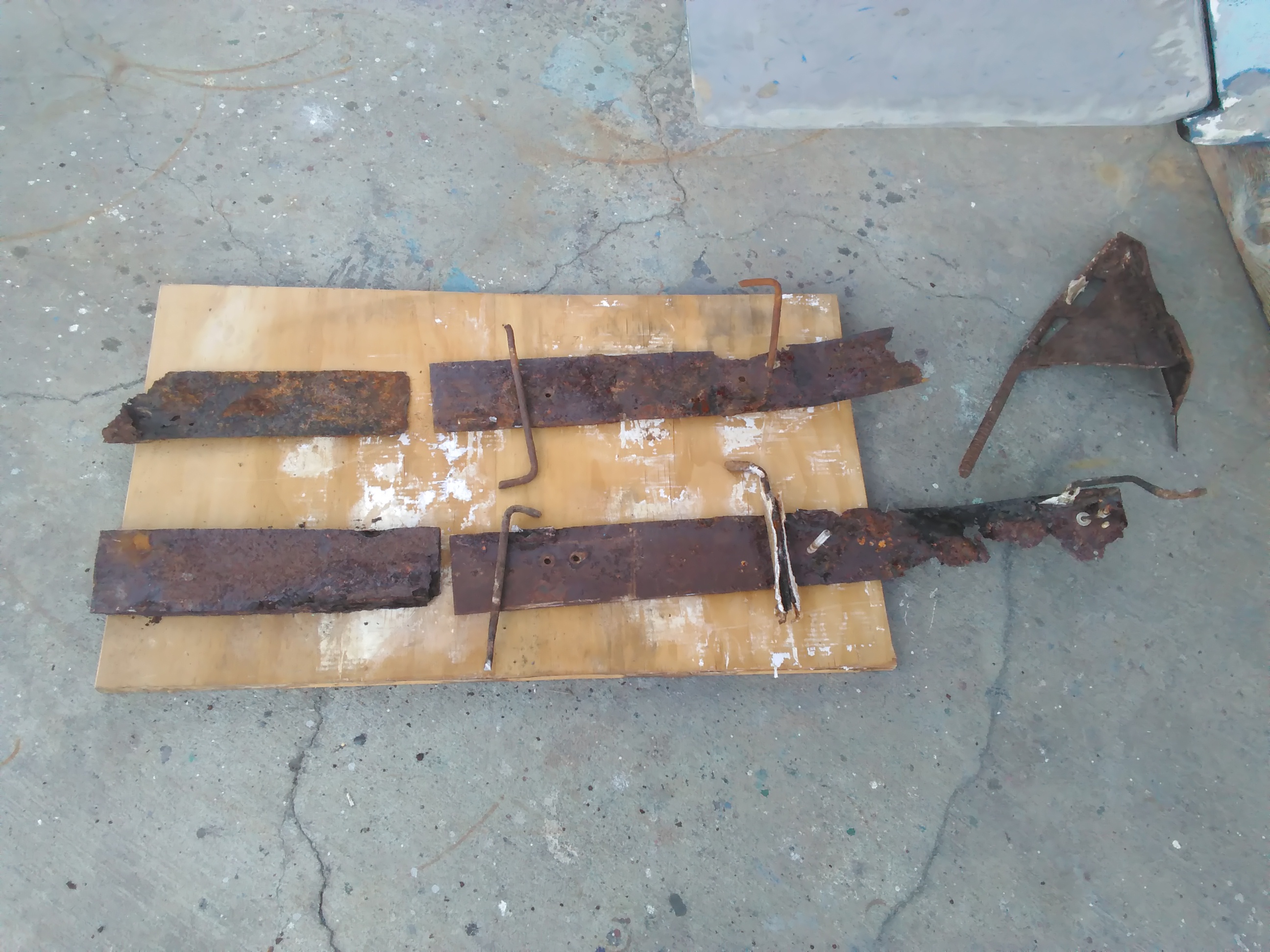

Re: Fayaway winter projects: chainplates, dodger and more
The plates on mine came out easy once I broke the bars that go down free. The plates are not bonded to the top very hardSVFayaway wrote:Thanks Jim.
. The other challenge will be figuring out how to remove the steel plate under the deck, as it passes through the bulkhead. I think cutting it in half is the solution, although I think it may be corroded enough on the port side that it'll just come out in pieces. It's in much better shape on starboard, but the access is better there for cutting it apart.
- iron plates.jpg (1.27 MiB) Viewed 1717 times
That's reassuring. Were they already in two pieces like that?

[quote="SVFayaway"]That's reassuring. Were they already in two pieces like that?
I don't remember cutting them. I think they were so deteriorated that they just tore apart but it looks like a clean cut. There is no way I could have gotten in there to cut them. I wonder how important it is to be so long. since there are no bars going down on that side of the bulkhead?

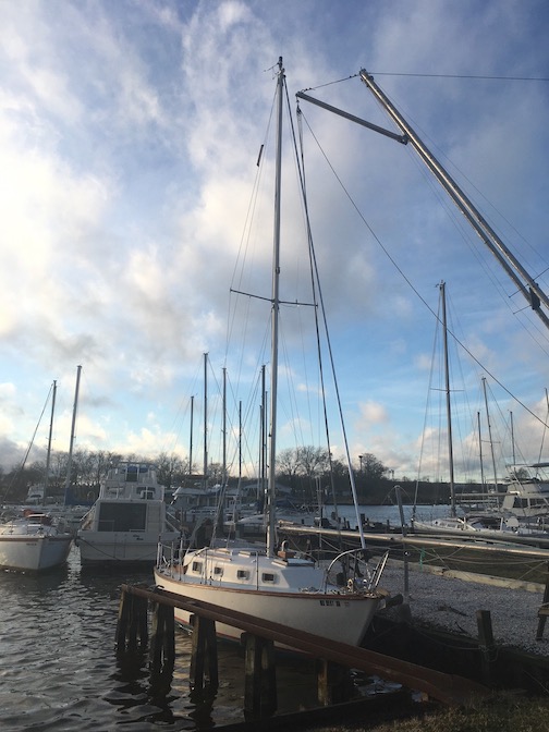

That's what I was wondering as well. I can't yet see on the main cabin side of the bulkhead how long the plate is. I've considered several ways to get it in two pieces, since there's no way a grinder will fit up there and using a grinder in such a confined space is scary anyways. The best approach I've come up with so far is to perforate it with a drill and large bit and then use the multi-tool to cut through the remaining material. We'll see.
I'm still out of state for the holidays but I got a text from the Ant Steward at Young's saying he'd hauled my boat. Now the real work begins!
