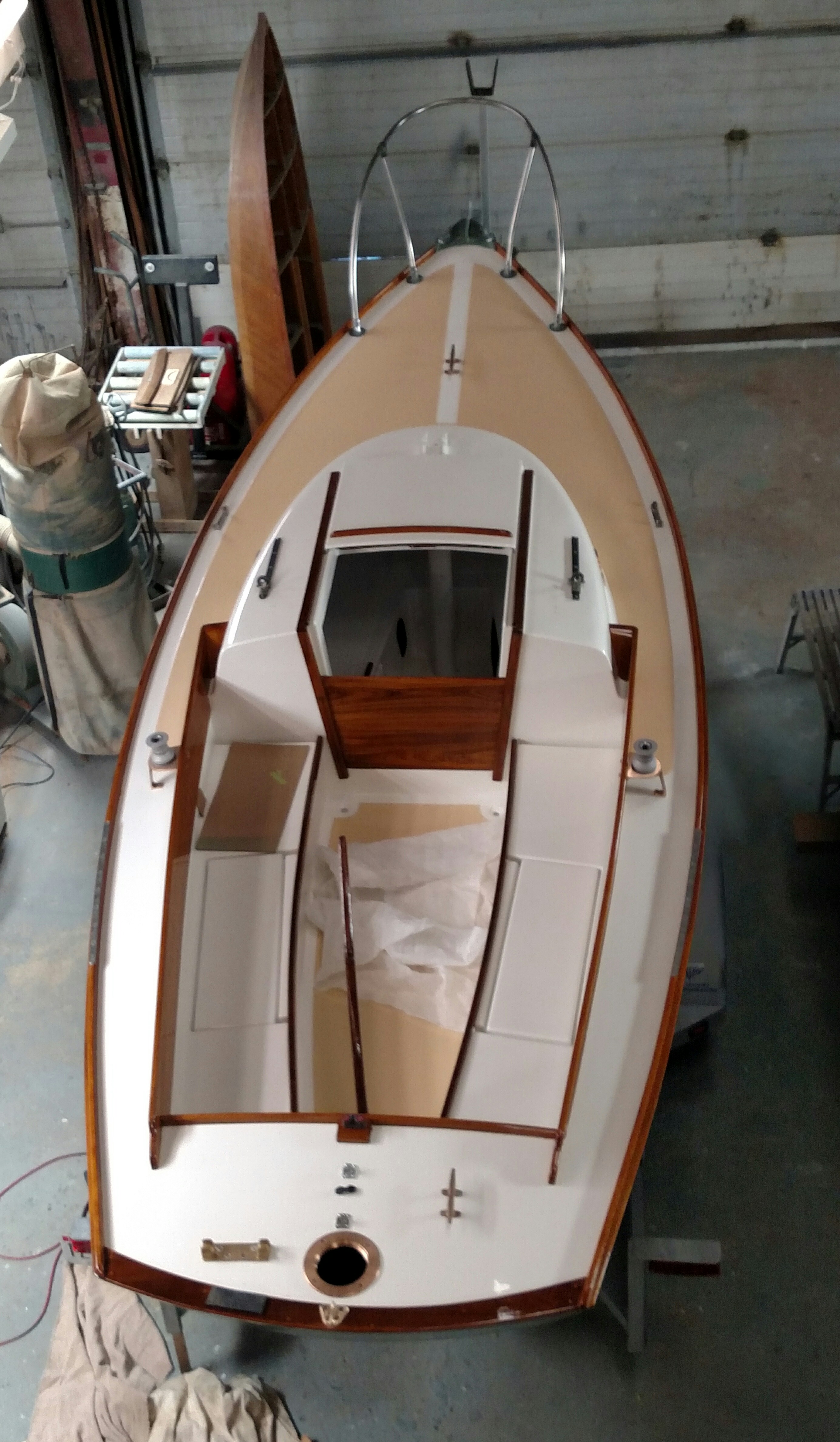

I've been restoring a 1974 Typhoon over the past year. She's almost done and will see water for the first time on over 15 years. I've attached a few before and after photos. I have some hardware from the project if anyone need them. Cleats, port lights, chock, aft deck outboard bracket (early type) blocks. Etc...

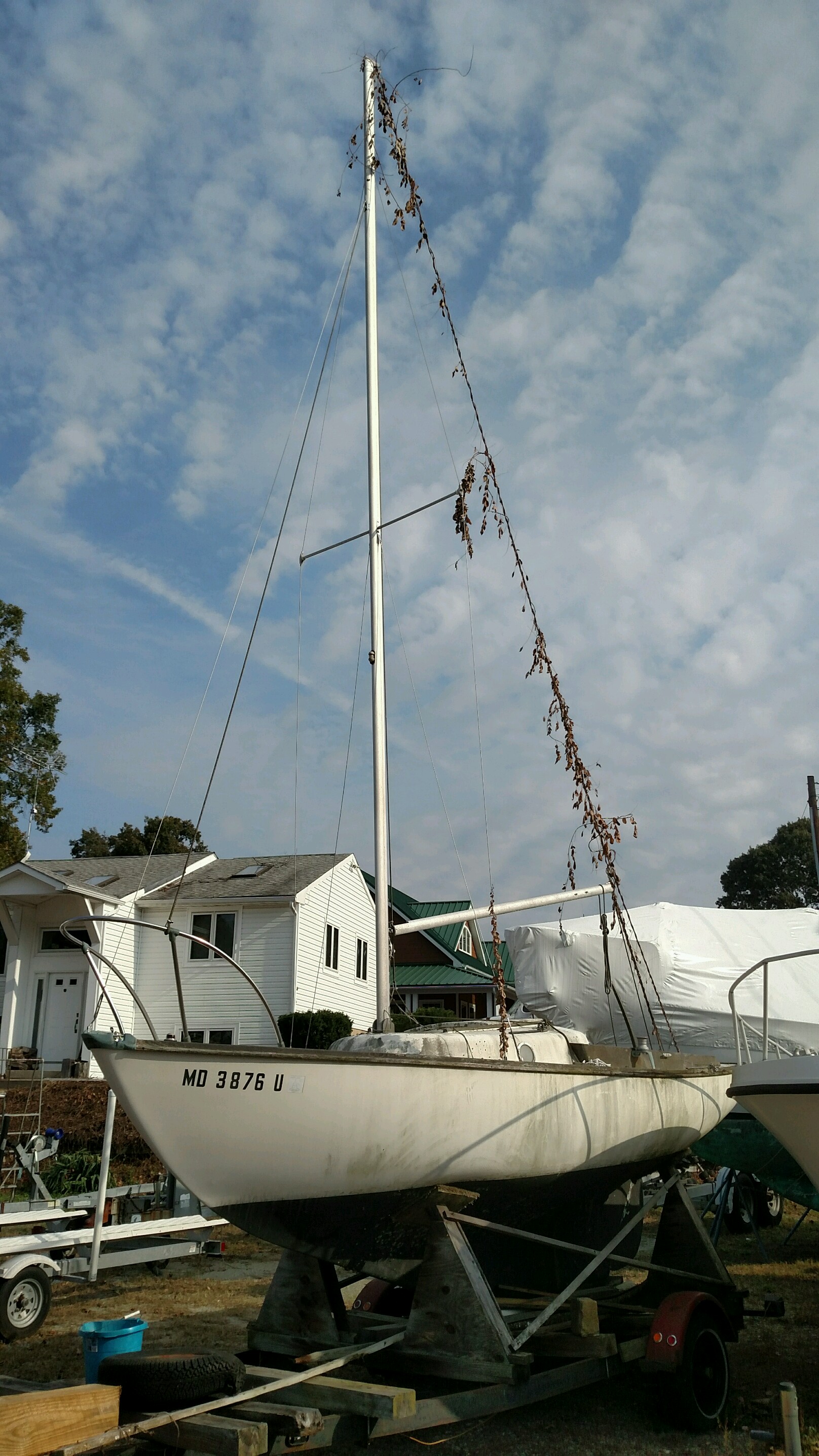

That looks phenomenal.
Will you be retaining the ivy topping lift :D

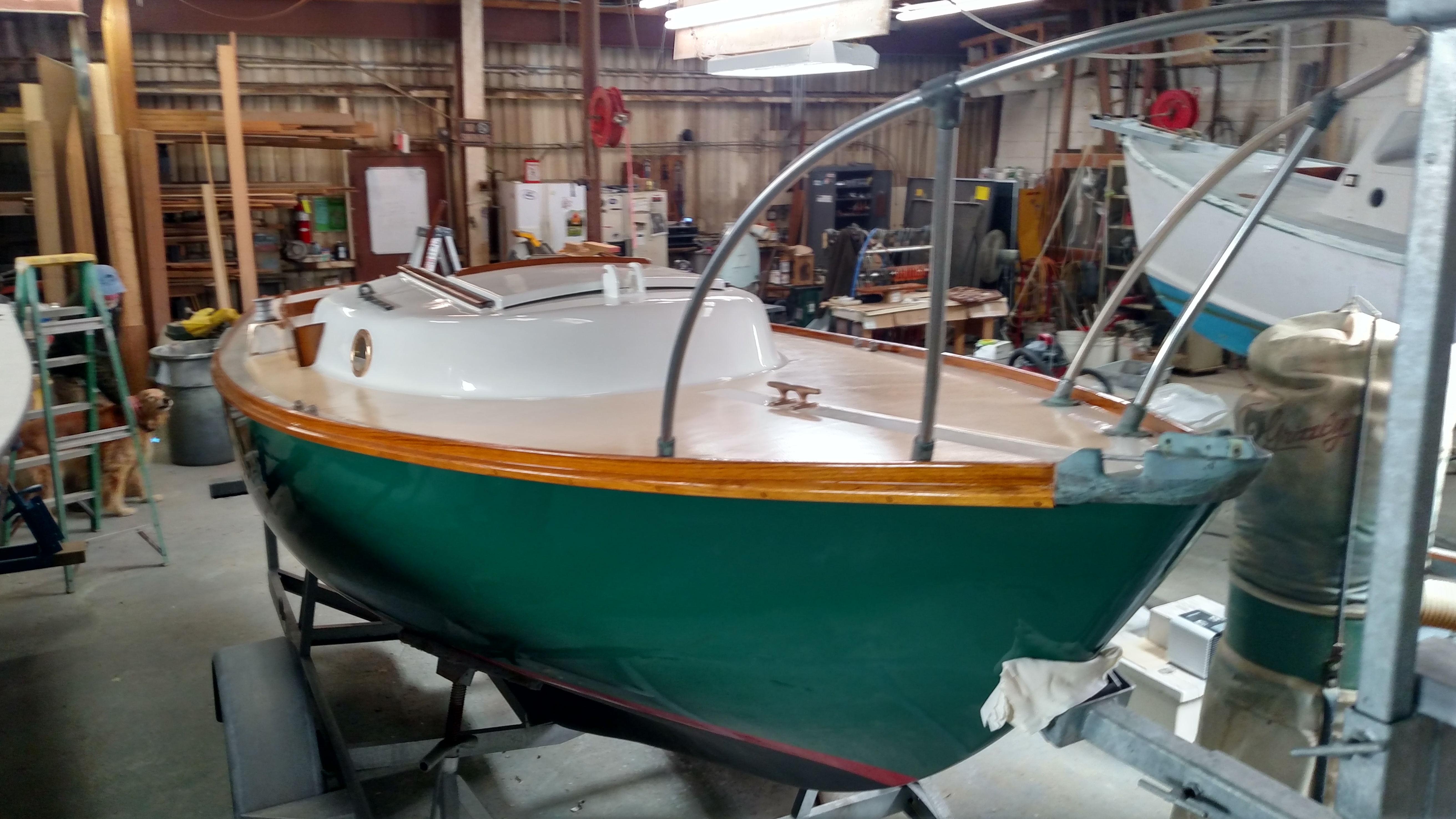

Hey! Looks amazing! #730 here. What varnish did you use for all the brightwork?

Thank you there's a coat of interlux dealer followed by eight coats of Epifanes. She'll get one or two coats every year.

Stunning! What is that hole on the aft deck above where the back stay attaches?
Also, were the original toerails in good enough shape that cleaning and varnishing were all they needed, or did you get new ones custom made?

I added a bronze inspection port to easier access to the backstay and outboard bracket mount. I also fabricated a mast crutch for it. The mast sits level over the boat with a winter cover on top.

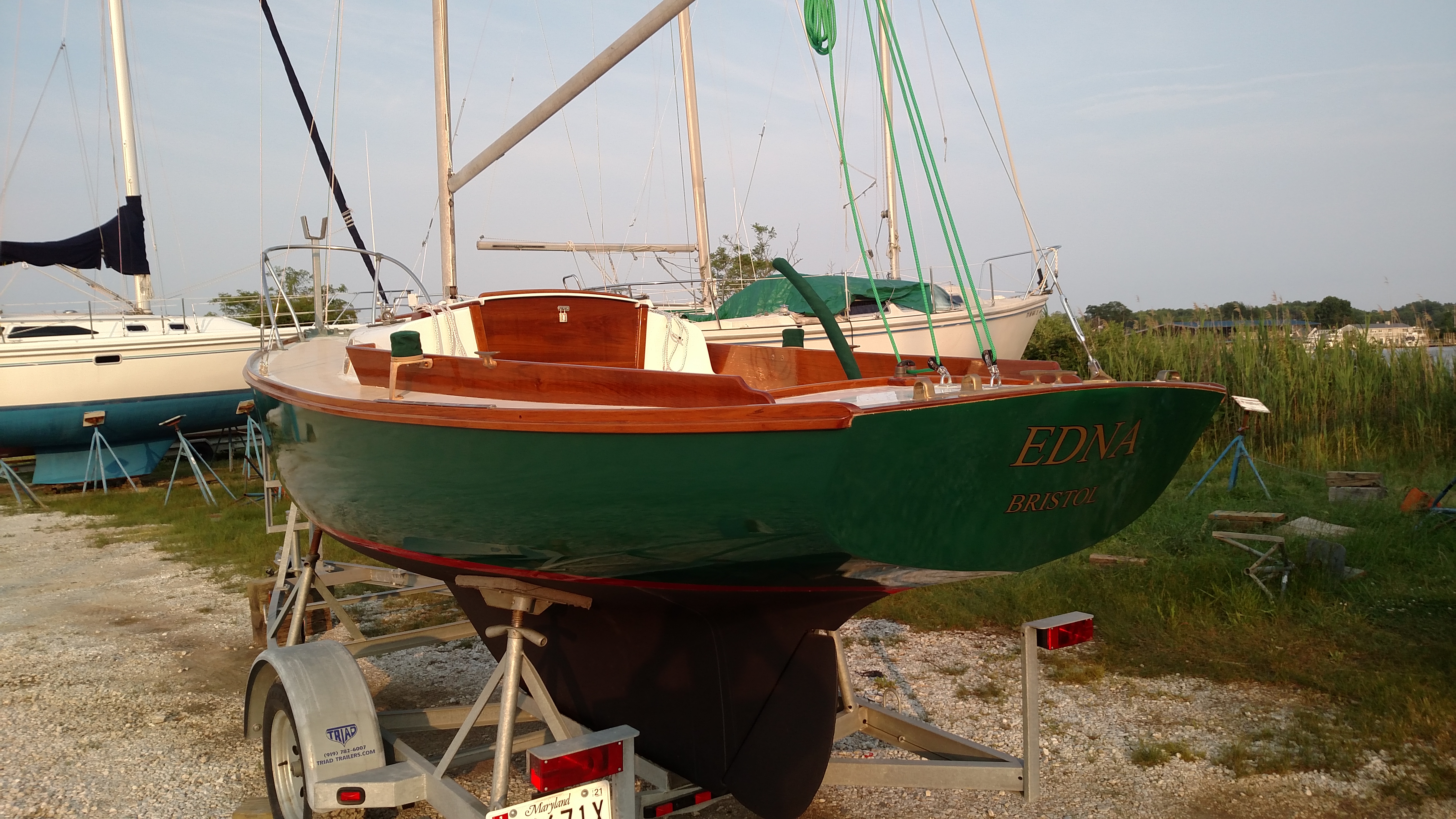

I couldn't salvage any of the original teak...the rail was too far gone to refinish. I decided to replace all of it. It was a lot of work but the results are outstanding. I'm waiting for the new sails so she should be launched in the next week or so.

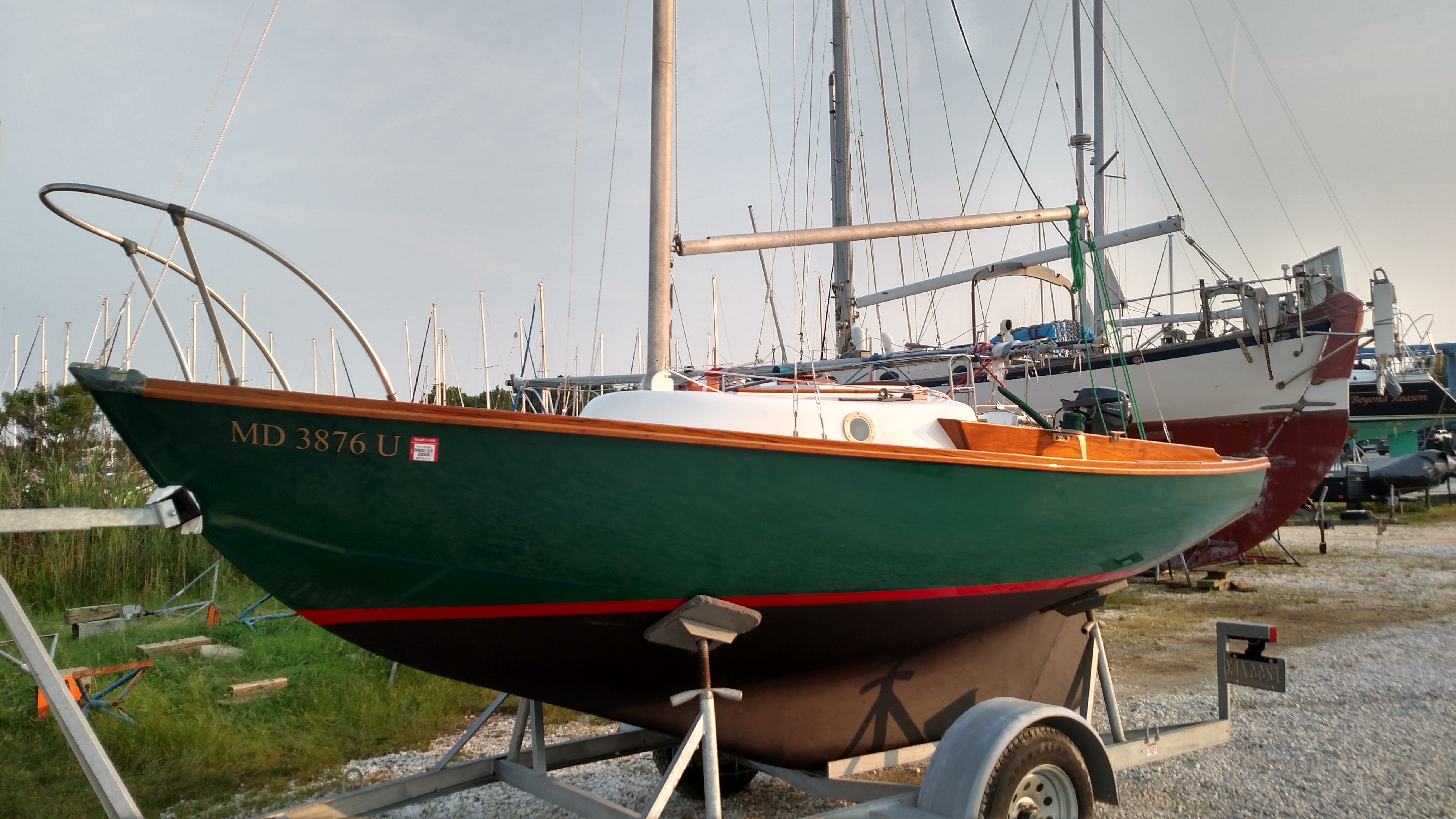

Current photos
