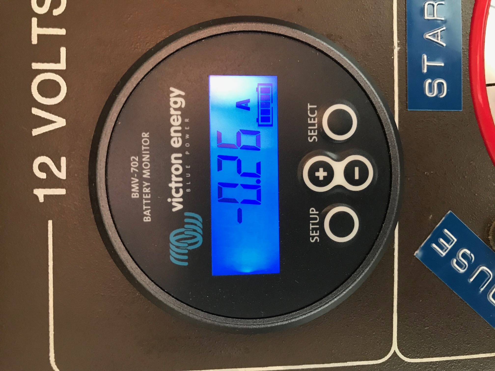

A couple weeks ago I was checking my running lights and found my stern light out. I popped one of my spare bulbs in and everything was fine.....except that it looked tawdry in comparison to the bow lights. I removed it the following day and replaced it with the same make as my bow light. What a dramatic improvement. With my running lights and my compass light in use (which is also LED since I had it rebuilt last spring) I only draw .26 amps. They are amazingly efficient.
