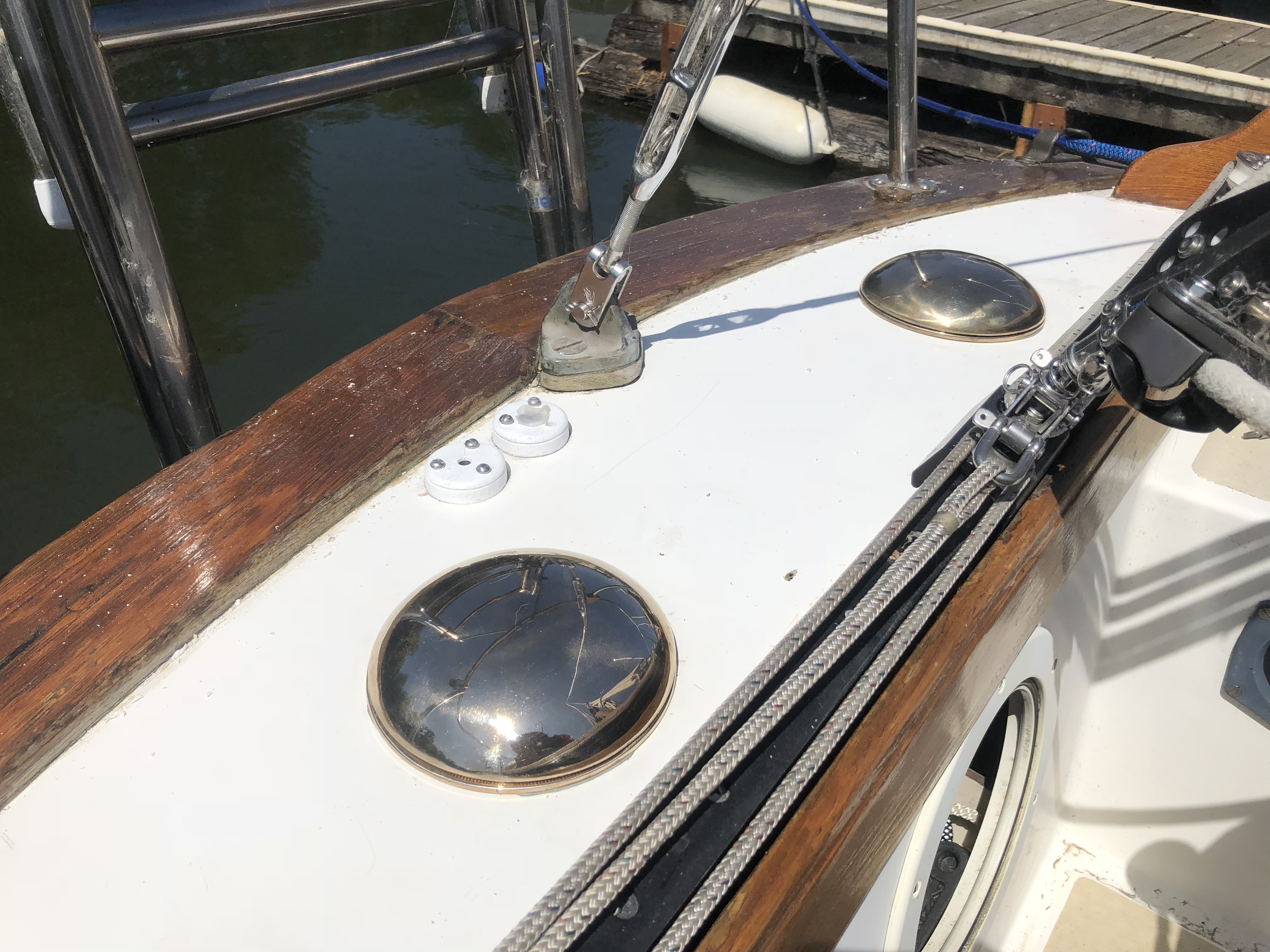

John, All your projects turn out beautifully and the Davy vents look great! I bought the same vinyl vents for Grayce Avery, but they looked horrible after only one season. We found these bronze vents being manufactured by Port Townsend Foundry, here in the Northwest. They are drop in replacements for the vinyl vents. Like the Davy vents they have a handwheel underneath and an o-ring to seal when closed. I liked that they are flush when closed and can be ‘aimed’ when open. Personal choice...
- Vents open and aimed
- 11CF94F2-C437-43A6-A7C9-1338D0833EC2.jpeg (3.44 MiB) Viewed 1433 times
- Vents closed
- 43AC7A21-3DCB-4A23-A25B-715136712184.jpeg (3.13 MiB) Viewed 1433 times
Dave and Kathy
