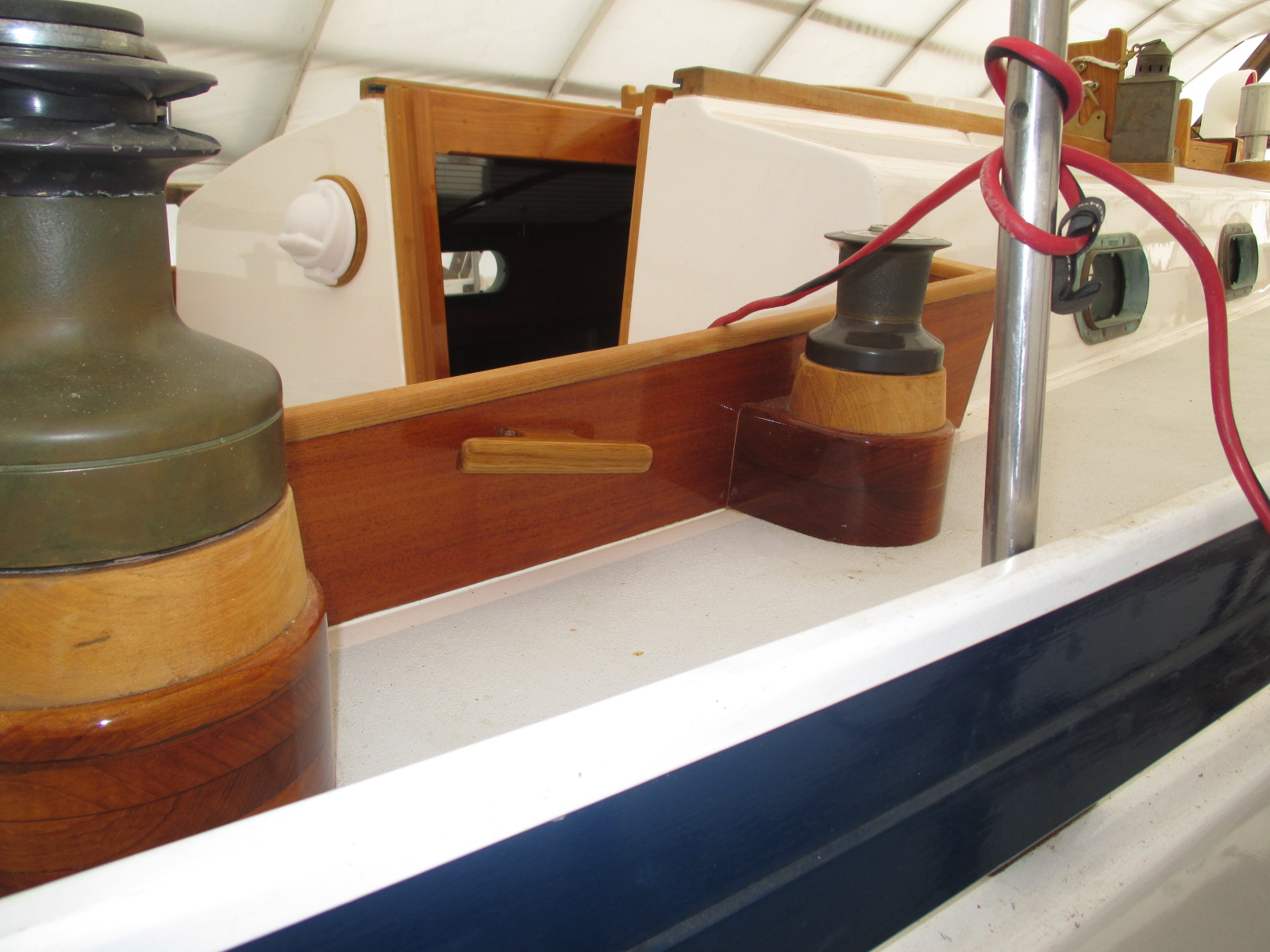

Here is a picture of the two different colors of bedding compound juxtaposed. Note that I used white 3M 4000 along the bottom edge of the coaming. Crisp white and it matches the gelcoat. But, several years later, and an additional 10 coats of varnish--'cause you have to keep varnishing those coamings--there is some varnish staining on the bedding compound. And, I am very careful about taping. Plus despite the fact the 3M4000 has a UV inhibitor it still turns kind of chalky.
But, note along the bottom of the winch bases and under the bare teak pads on top of the winch bases and between the winch bases and the coaming. I used teak colored Boat-Caulk. You really can't see any caulk. It blends in. Imagine what the white caulk line would look like between the teak joinery. The teak colored caulk looks just as good today.
So, choose wisely. When I someday remove and recaulk the coamings, I'll use a teak colored caulk.
