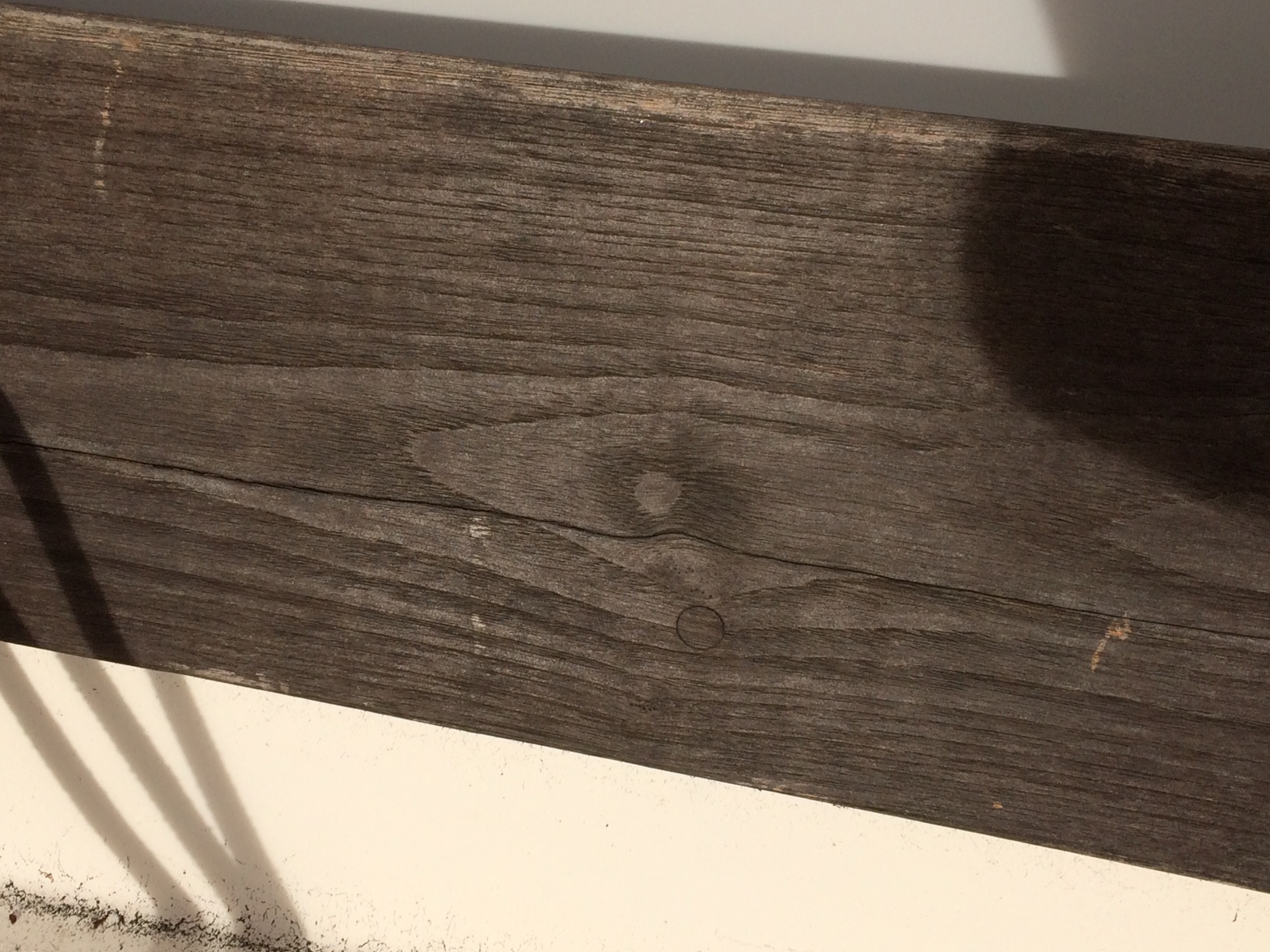

Greetings, the long New England winters give me plenty to think about restoring a Typhoon Senior and tonight's thoughts are about the teak coamings. As you can see below, the port teak coaming has a crack in it. I'm not sure if it can be repaired, or if it will need to be replaced. If it needs to be replaced, should I stick with teak, or switch to another wood such as Mahogany (and perhaps upset some purists)? A good part of the decision comes down to how the wood will be finished. I don't want to have to constantly maintain it with teak oil, so that means either using something like Epifanes Clear Gloss Varnish or Cetol Marine Light, as I've read that teak doesn't hold varnish well. Wondering what you have found that produces great looking brightwork but is also durable in the intense summer sun. Thanks!
- Split Teak Coaming.JPG (659.36 KiB) Viewed 1867 times

I had a very similar issue with my CD28. The port side combing had developed a crack all the way from the stern to the winch stands 2/3rds of the way up. I didn't want to switch from teak, or I expected to be annoyed by it not matching starboard combing. Pricing teak replacement was NOT cheap, since its a 8 ft length with 7" to 10" wide.
Basically I removed it from the boat, drilled the end of the crack to stop it spreading, and then filled the crack with wood glue and teak sawdust. I was paranoid, so I slapped a couple of metal bands over the crack to hold it closer together.

That's a tough one. You can repair it but you need to remove the coaming first. That's a pretty grimy coaming so you'll need to clean it with a two part teak cleaner like Te-Ka before you repair it.
You can try using thickened epoxy to glue it back together but you'll need to varnish it as epoxy does not do well in direct sunlight. The epoxy will also discolor from UV if not varnished. You need to paint it or varnish or use some other coating. Or you could cut the cracked section out and glue in another piece. That's probably what I'd do, but I can't say for certain without seeing it.

I suspect it cracked because it dried out and was held secure by fasteners in the deck and the winch bases. The wood could not expand and contract. If left bare, the teak will do better with a saltwater washdown every couple days. The salt holds the moisture in. The general rule is to never use a scrub brush on any bare wood.

Rob and John, thank so much for taking the time to post replies. Rob - I like your idea about drilling the end of the crack to stop it from spreading further, and then filling the crack with wood glue and teak sawdust. John, thanks for the advice and link to your website - very impressive! I am partial to finished wood, so I find your approach of a bare teak coaming top interesting.

Can't save the plugs to reuse. By a Fuller 3/8" tapered plug cutter and you can make your own plugs if you have a drill press--even a very small one.
You can't sand all that out, not should you. A two part cleaner like Te-Ka will make the teak look like new. Then sand it smooth.
Forget the purist. Make no apologies. It's your boat. Classic style fits best with our boats but anything you change can be corrected later. Teak is not necessary. Though I happen to love teak, lots of great classic boats never used teak. Doug Fir was a standard decking material, and still is, in the the NW. Lots of wood boats had canvas covered decks. I think they are making a come back.

A quick response to the original post. I had similar splitting of my coaming boards. Last season I carefully drilled vertically from the top down the center through the split in five locations using a 10” long bit. I then inserted a SS rod smothered in two part epoxy in each hole. This has held up pretty well after a year so I plan to sand and varnish the coamings this summer.

That is a very clever solution.adamganz wrote: Last season I carefully drilled vertically from the top down the center through the split in five locations using a 10” long bit. I then inserted a SS rod smothered in two part epoxy in each hole.

I second the rod solution (combined with the hole at the end of the crack to keep it from spreading). I reused the drill bit and leftover rod to shore up a wonky teak cockpit grate.
