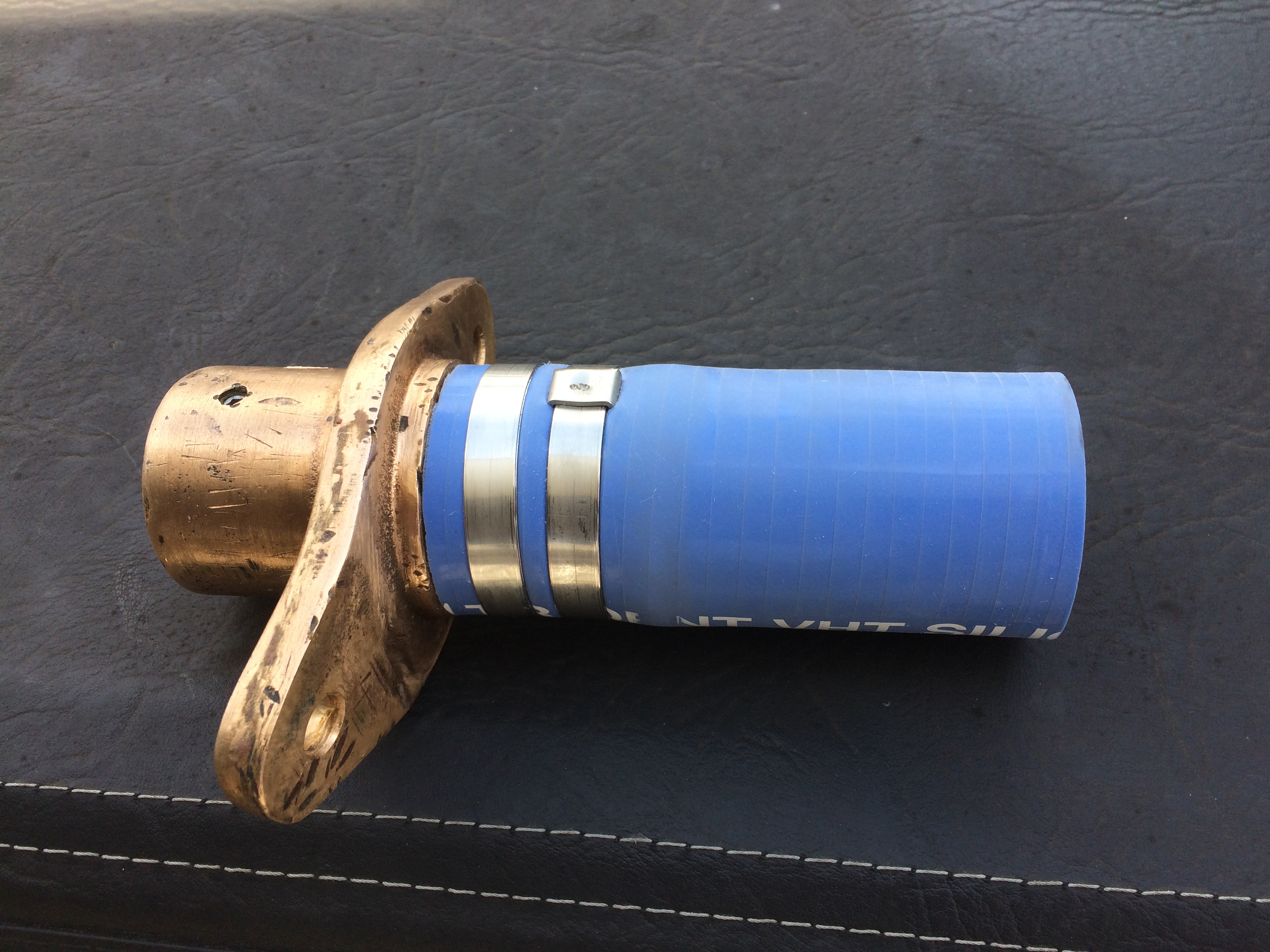

I found a stern tube from an earlier CD 36. It's a bit rough but can be cleaned up. Looks like someone hammered on the threaded end to get it out of the boat. Will need to trim it back to make a smooth surface for the packing. Removing the old Cutless it always a bitch too. Definitely replacing with one that has a synthetic shell.

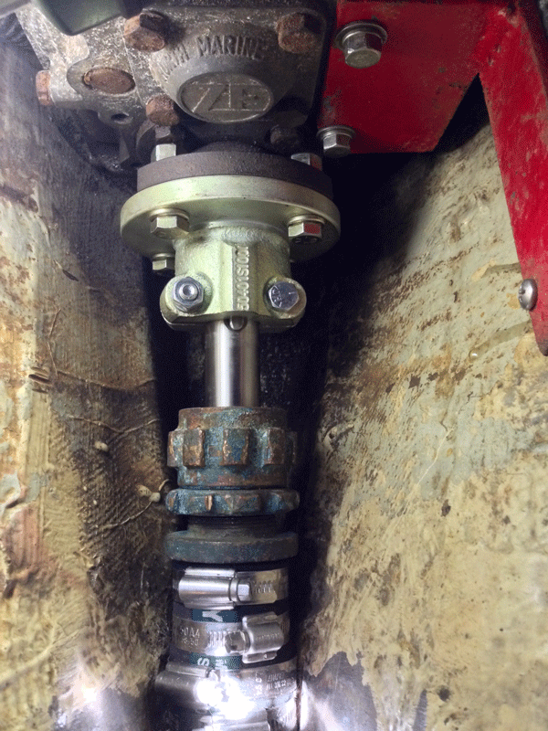

It took a while, but I finally got around to cleaning up the drive train in Tiara (CD36 #135). I found that a 15" Max prop fits & works great. There is no need to modify the aperture.
I removed the drive saver, replaced the coupling with a shorter split head design, cut the shaft down to 18" (before bobbing the aft end for MaxProp classic), and all fits well. Of course, gotta replace the hose & cutless while in there, and use proper 316ss AWAB hose clamps.. Compare these images to my earlier post in this thread.
The boat does sail faster with a feathering prop.

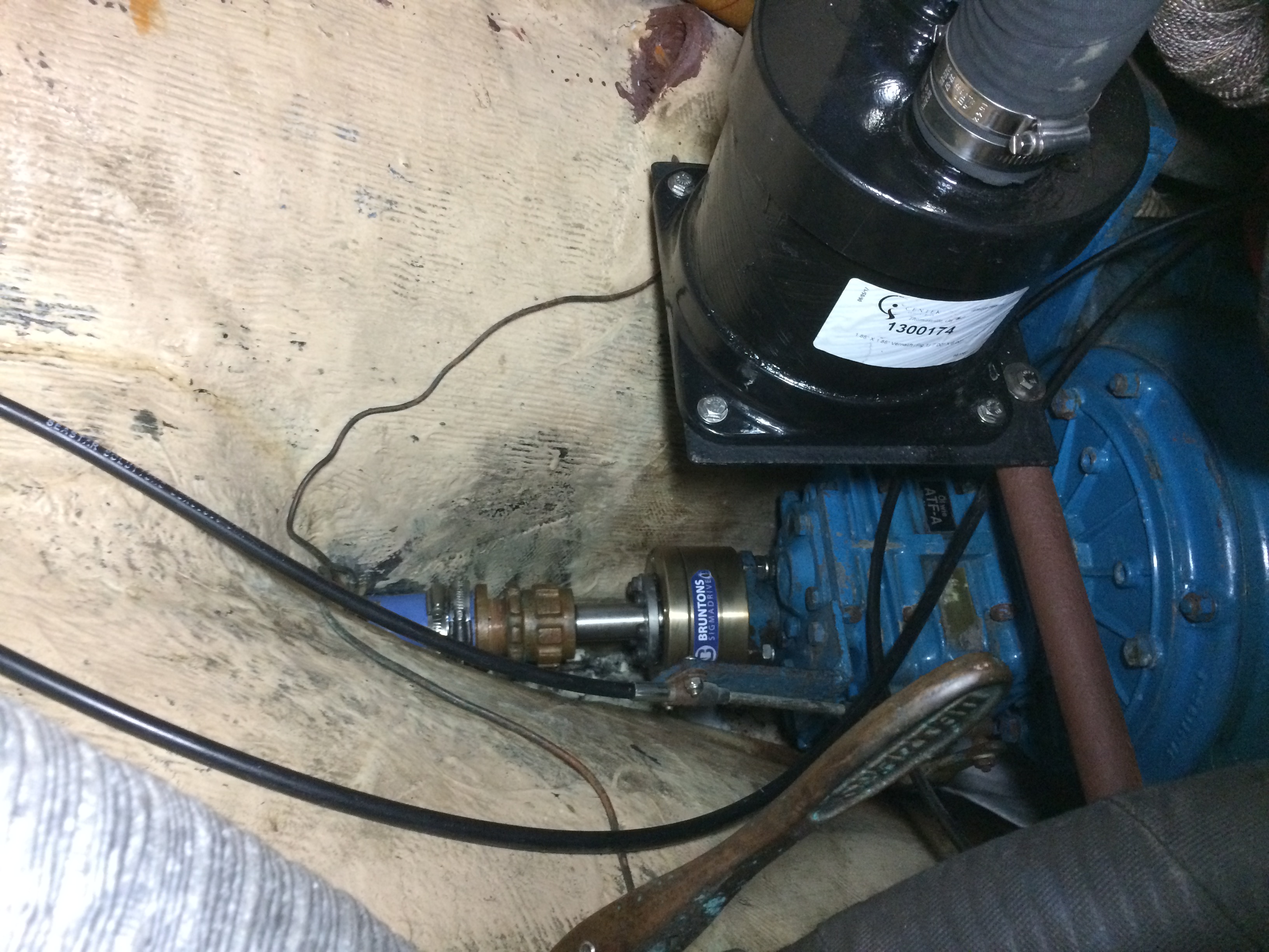

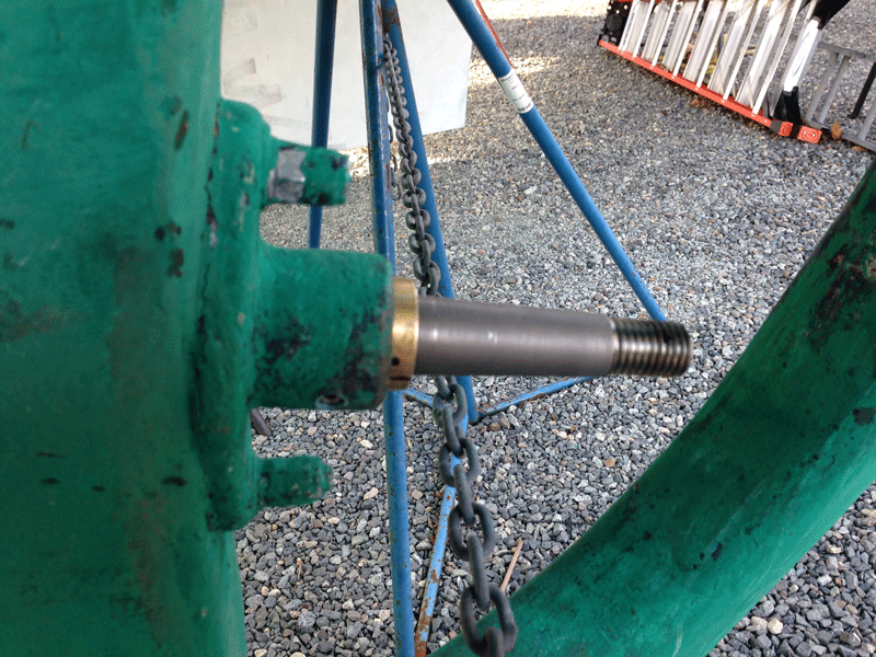

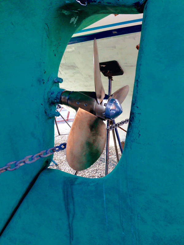

My apologies, it's taken a long time for me to update this thread. The short story: Skylark was hauled out at Swan Point Marina, at Sneads Ferry, NC in April. While commuting to the boat from DC, I was able to complete the work and splash Skylark in August. We've made our way back to Annapolis.
- Reused the original shaft tube
- IMG_2190.JPG (2 MiB) Viewed 2221 times

- FeatherStream propeller 16x12
- IMG_2201.JPG (2.11 MiB) Viewed 2221 times

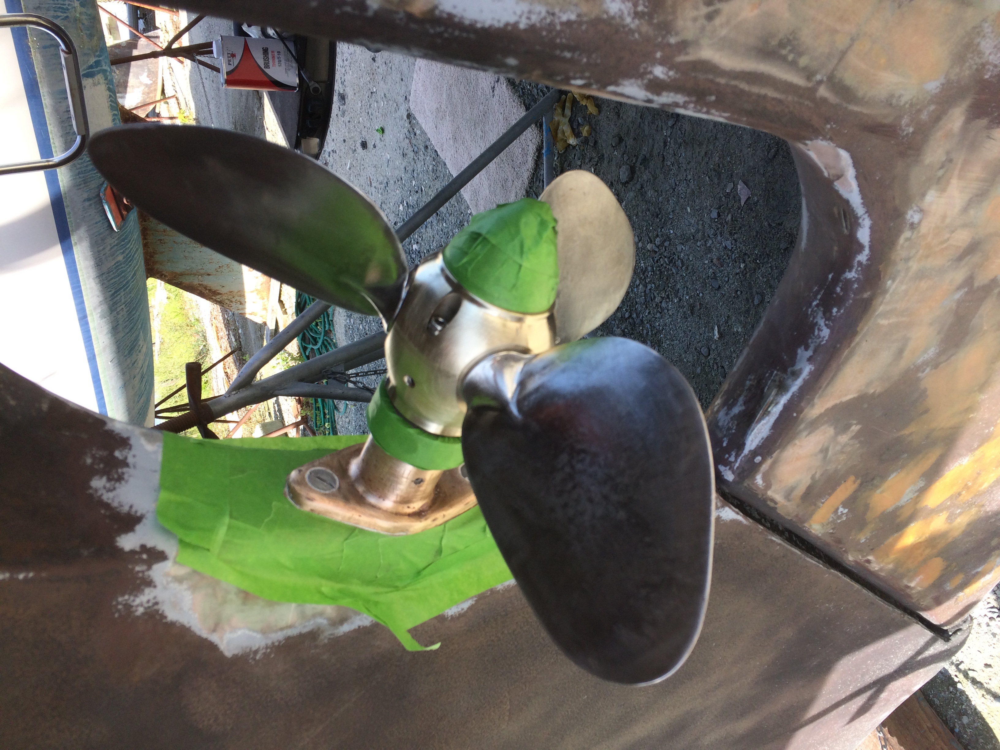

It's a FeatherStream propeller. The larger diameter provides more thrust. Very manuvarable at low speeds. Sailing in light winds faster. Yes, the Sigma drive avoids dealing with most of the alignment issue.

I completed my coupling/shaft/prop project about a year ago, shoehorning a MaxProp into my CD36 hull #135. The MaxProp is a mighty close fit; your FeatherStream is a better fit for the small prop aperture. The VariProp (DF4 Hub) I put on my CD28 years ago was a great fit in that CD28 too.

Glad to see the featherstream prop fit well. Looks like you had to shorten the propeller shaft an inch or so?
What size is the propeller? I am considering installing a featherstream myself, and would like to know how your performance is and what size they recommended.

The original shaft was 1" longer than the CD36 manual specified. Most likely because it did not have a flex coupling also specified in the manual. The new shaft was 18 9/16". I also installed a Bruntons CV coupling. Might have been better to add an an additional 1/2" to give more room for the shaft zinc.
The prop is a 16" diameter and set for 12" pitch.
I don't remember the brand of cutlass bearing. It is a brass shell type. I soaked the tail piece in paraffin (to heat it) and kept the cutlass bearing in the freezer for awhile to make it easy to insert.
